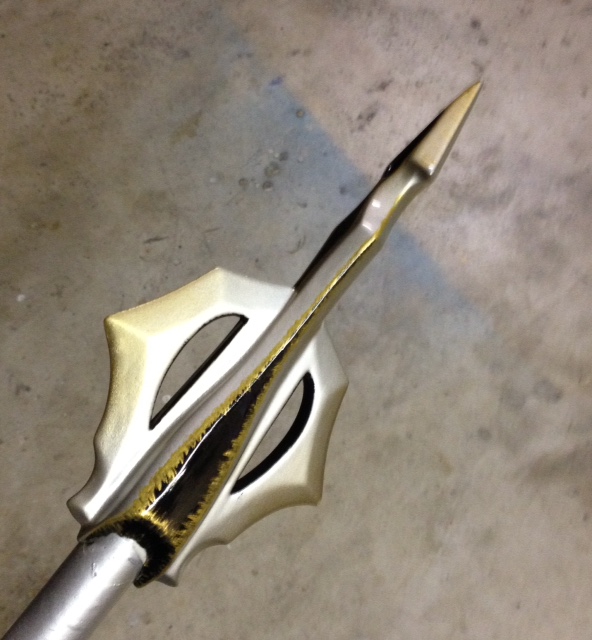

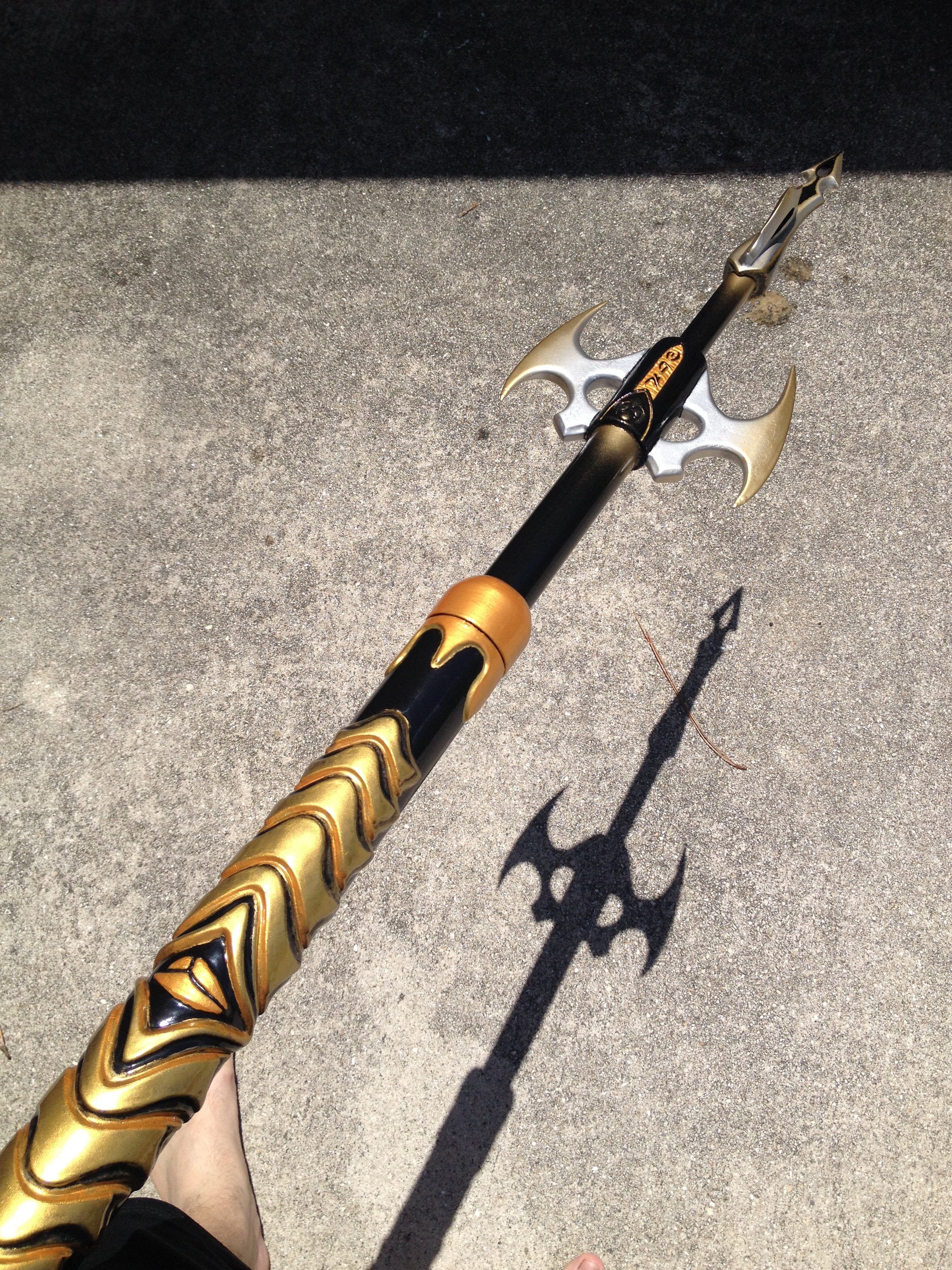

The week before the con was spent tweaking and reworking. With the spear finished.

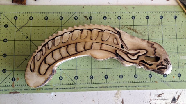

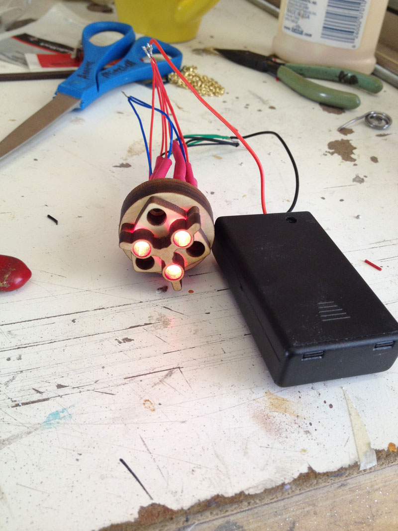

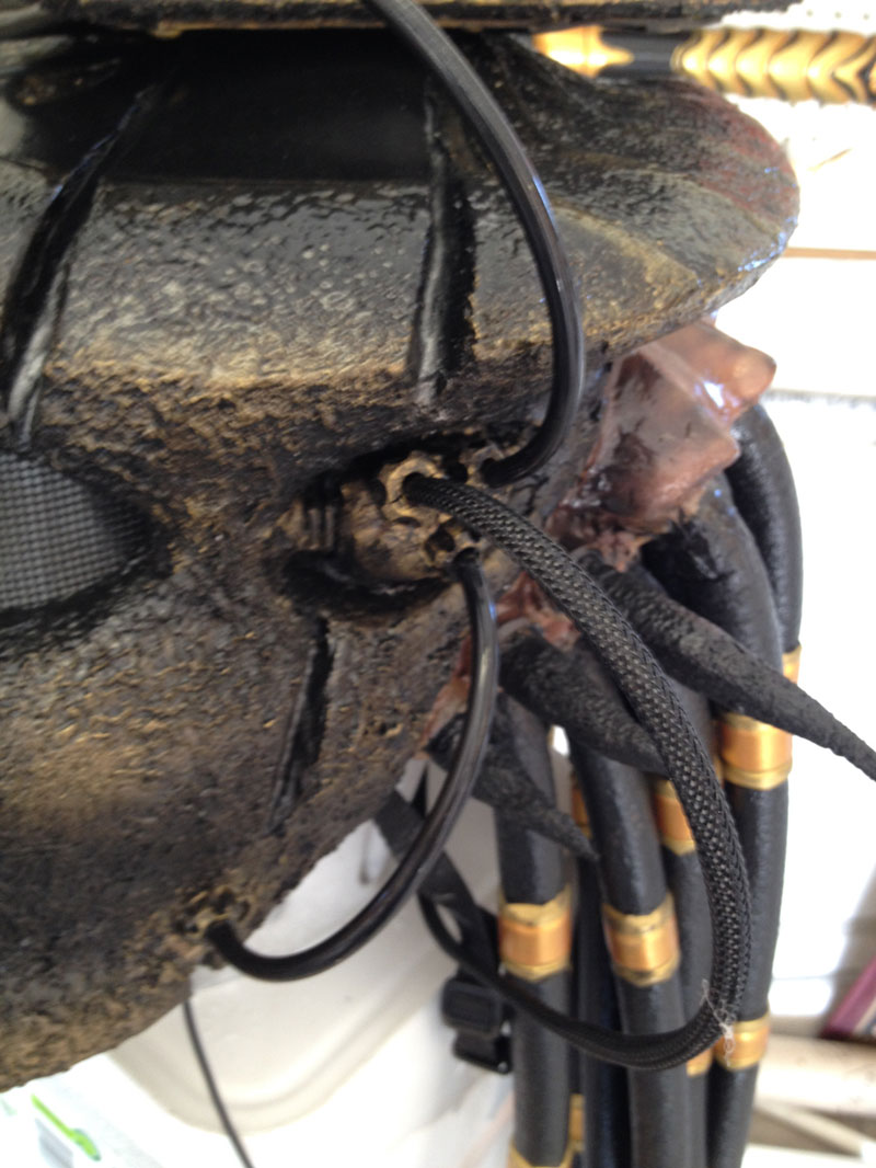

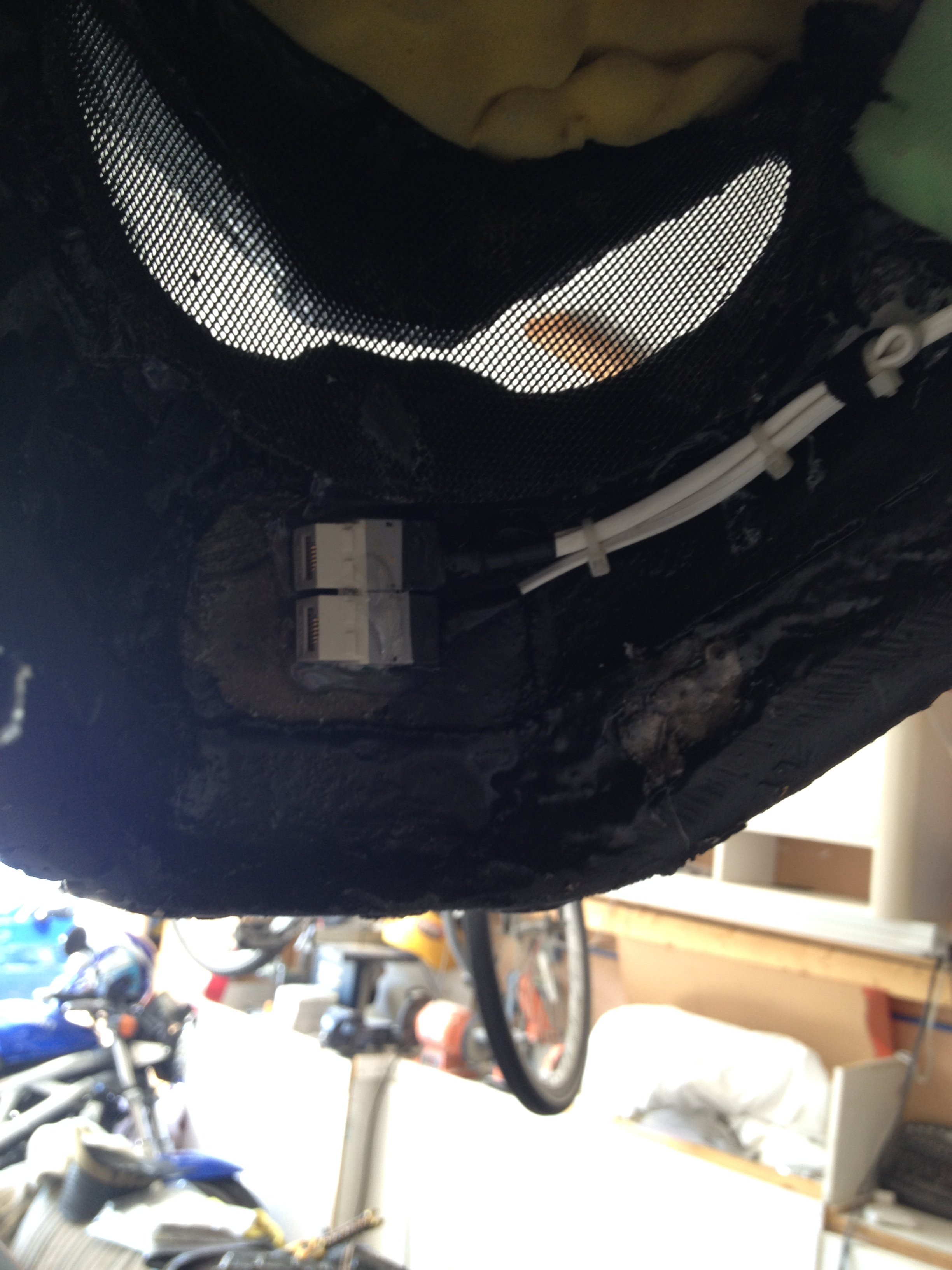

I turned my attention to my bio. After reading the rules of the Megacon I got worried that my lasers would not be allowed. I spent the next few days completely remaking the laser housing and wiring everything up. I add red/blue leds along with the lasers.

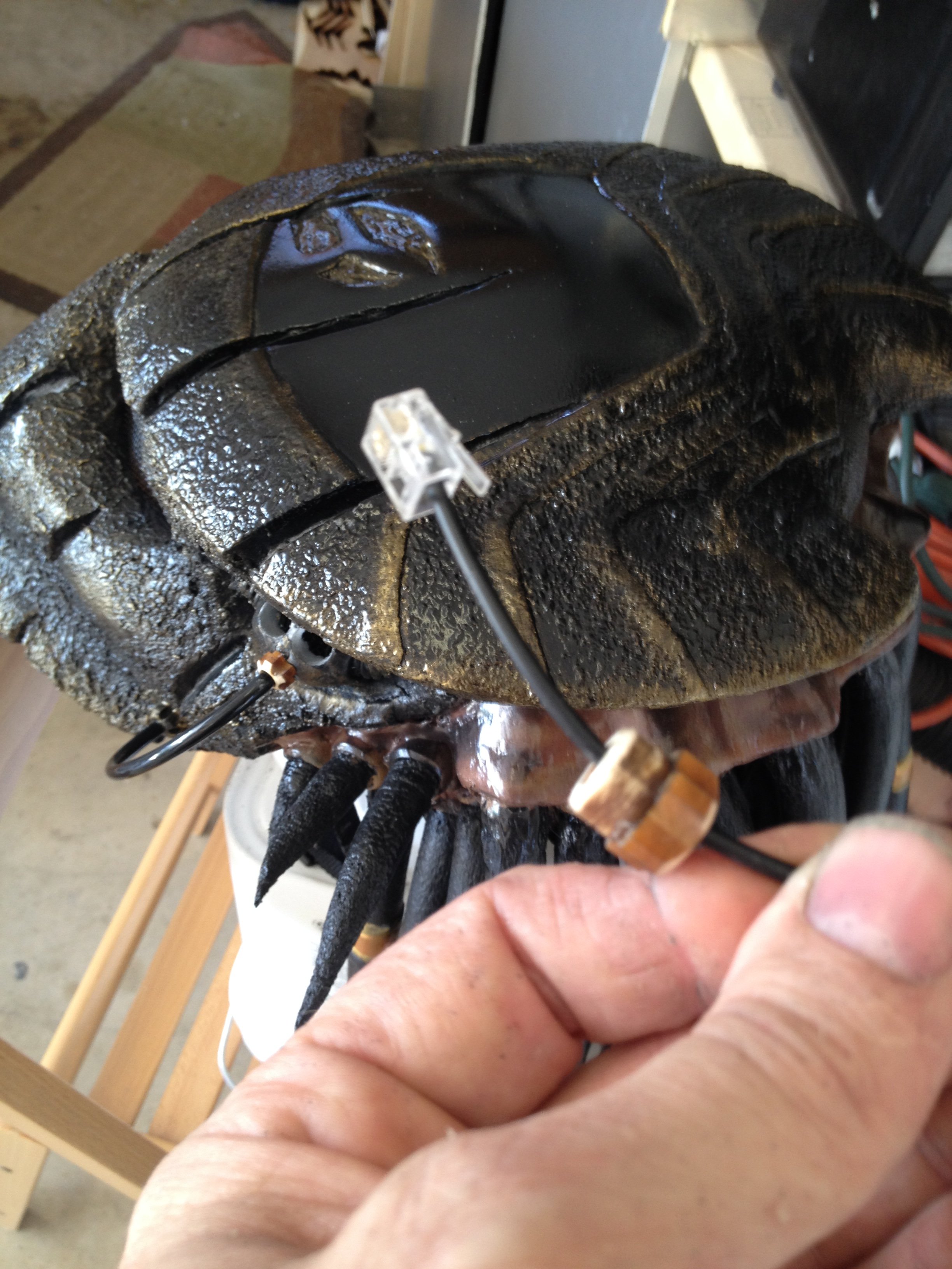

The switching of the leds and laser was accomplished with switches in my computer gauntlet. I ran the wire up my arm under the morph suit. I used phone plugs. These were the smallest wire and connector combo I could find locally to make all the connections. The bio laser/led housing was 1 connector and the 2nd was for the led I installed in my Plasma caster.
I was not able to find a small enough connector to fit thru the side of the Bio so I had to sheath the wire and make some plugs. This is were things got complicated. To put the bio on I had 1 foot of wire I had to feed thru the holes then push the outside sheathing down the wire and then put the plug is to close up the big hole and make everything look good. The was a problem when I wanted to take the Bio off. I had less the 1 foot of wire to lift it off my head and hold it close to me. Needless to say I did not take it off to often. I have to think that there are smaller connectors I could use to just plug directly into the bio. The overall effect was work it. I could switch between red led, blue led and laser with my computer gauntlet.
Here is a pick of the final wiring with the caps installed.
