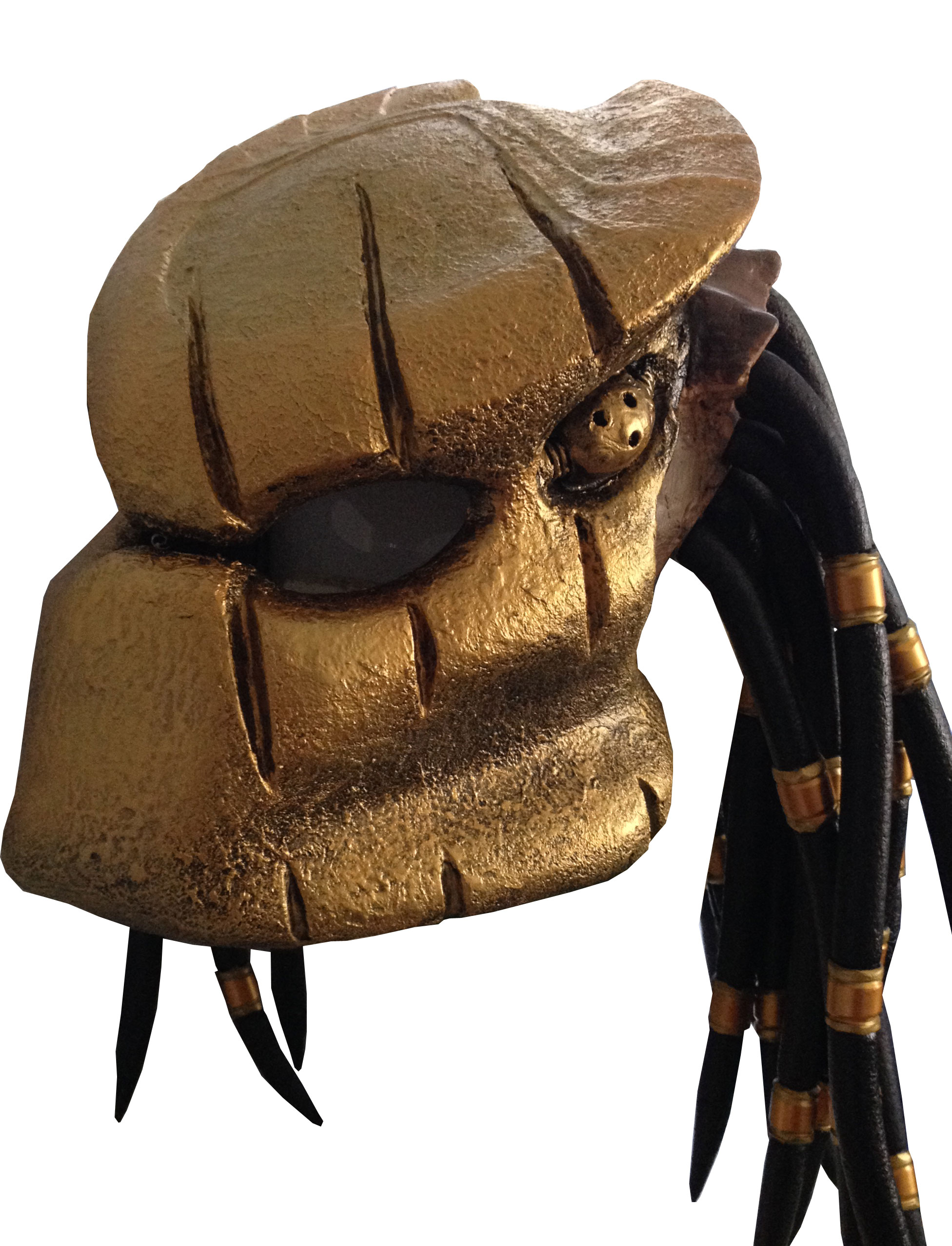

BIO MASK:
Sorry no pics of the work in progress.
Started with some u-foam sheet for basic form and carved out the shape.
Once I had it right I followed up with a coat of fiberglass.
Next a texturing coat of Bondo.
Gloss black paint followed by a dry brush gold.

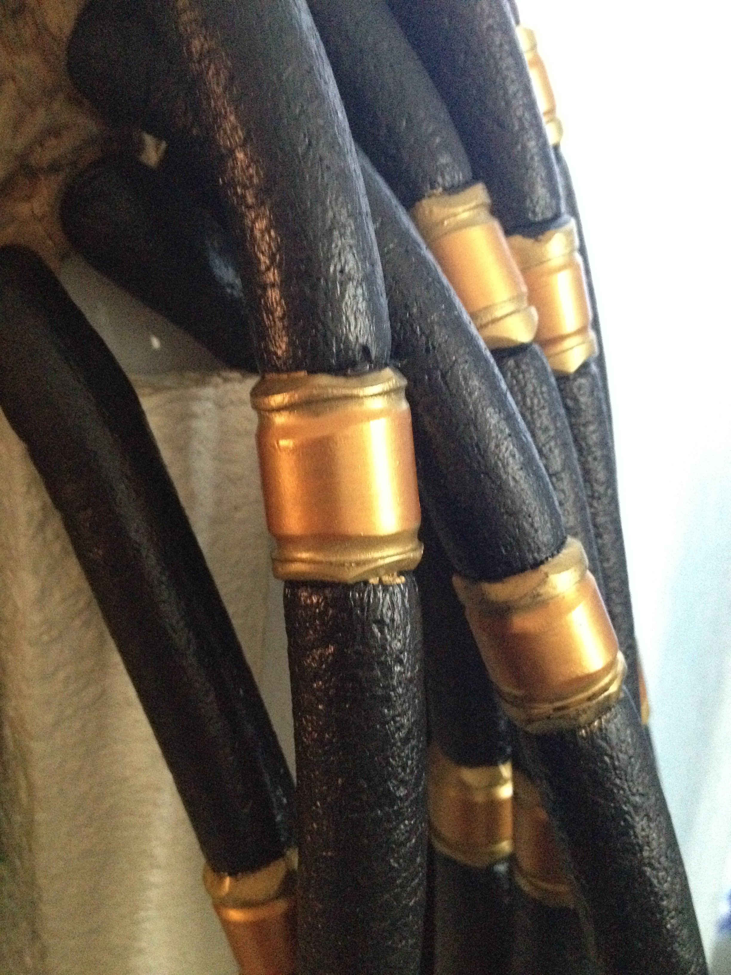

DREADS:
5/8 and 3/4 backing rod with plasticoat and gloss black coat. Tapered ends are done on a belt sander.
beads are PVC, I hit edges and 2 grooves on belt sander for a rugged look.
beads are painted gold and antique gold.

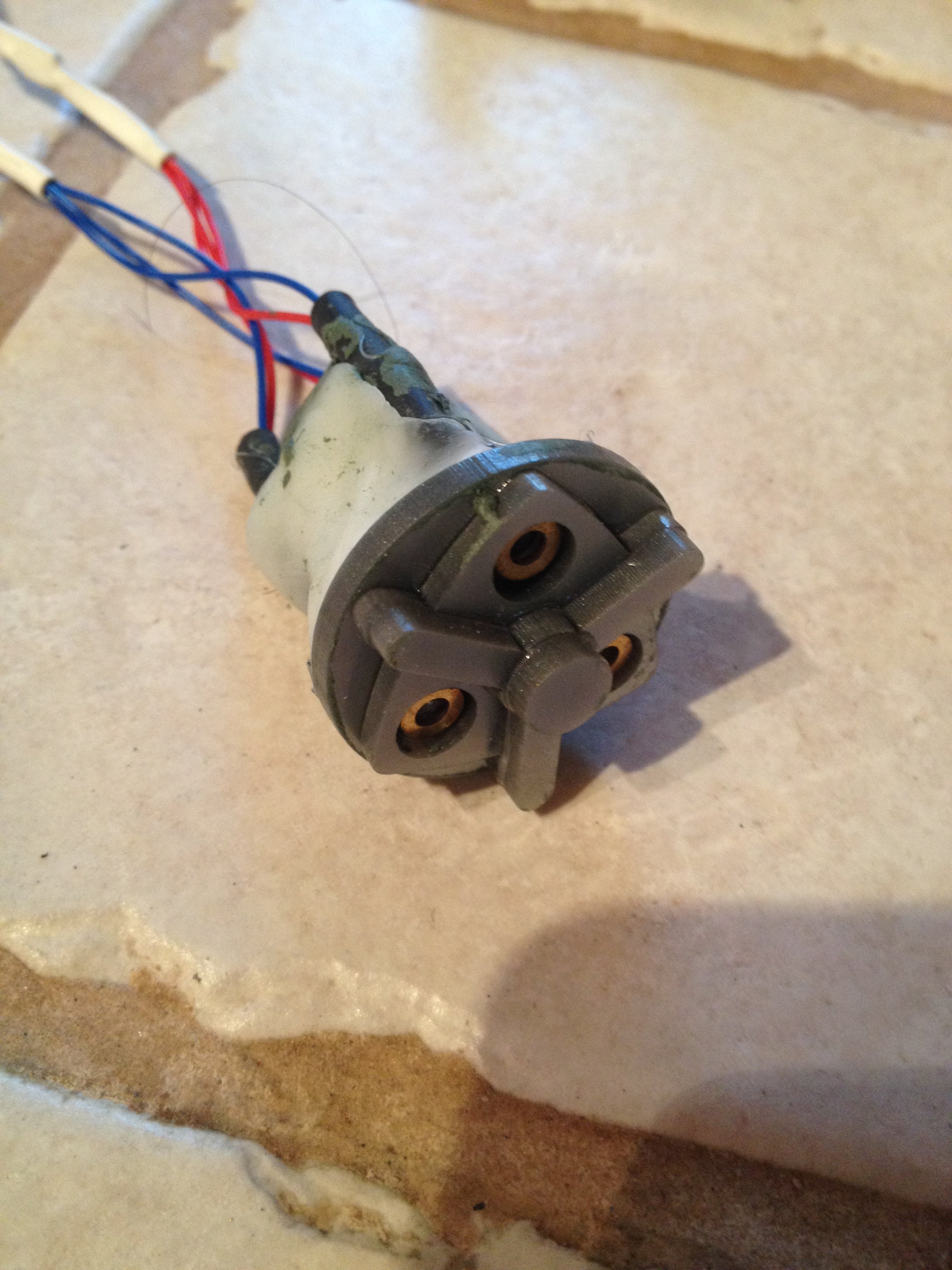

TRI LASER: Still needs mounting in mask.
Laser cut from 1/8 thick silver acrylic
3v laser diodes - I use funplastic to hold the tri laser alignment. What a pain to get this right !

I was looking at my bio a few days ago and I did not know what I was thinking ! I must not have really looked at it. It
Looks like a storm trooper helmet !?!? Big and bulky on the sides and really low. So it took the hacksaw to it. Now with a fresh prospective, better reference pics and some Bondo it think it looks a lot better. I will post some pics soon and see what everyone else thinks.

Here are some pics of my bio after the rework. I cut the sides down a lot. I think it looks like a Predator bio instead of a Storm Trooper helmet. It still needs more sanding before paint but it just wanted some opinions before finish , so I get it right this time.
[sharedmedia=gallery:images:7573]   [sharedmedia=gallery:images:7572]
