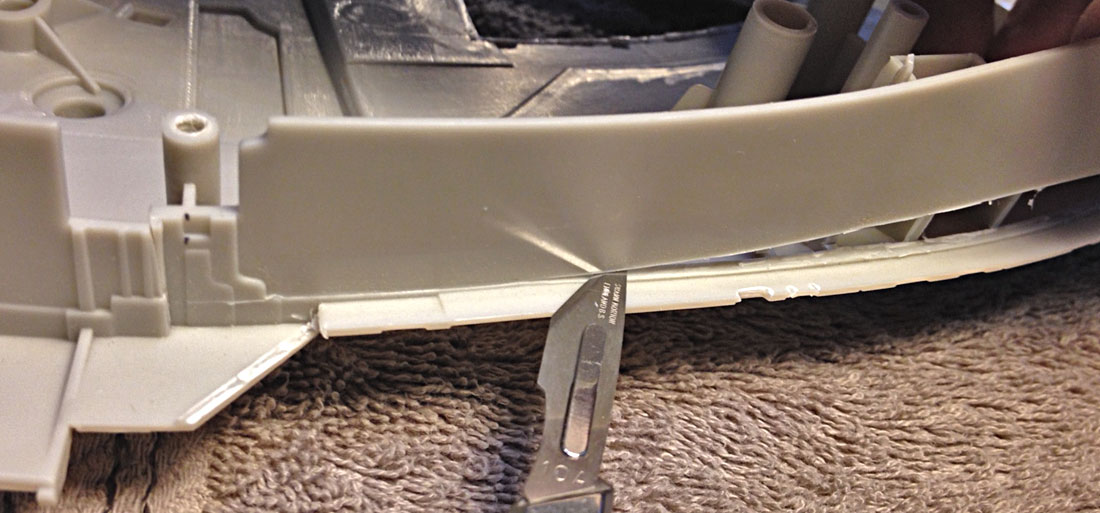

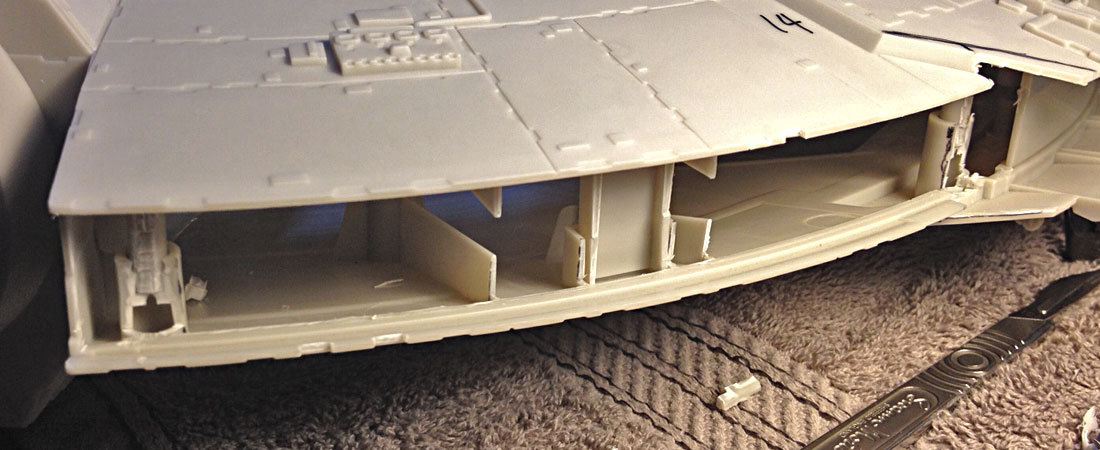

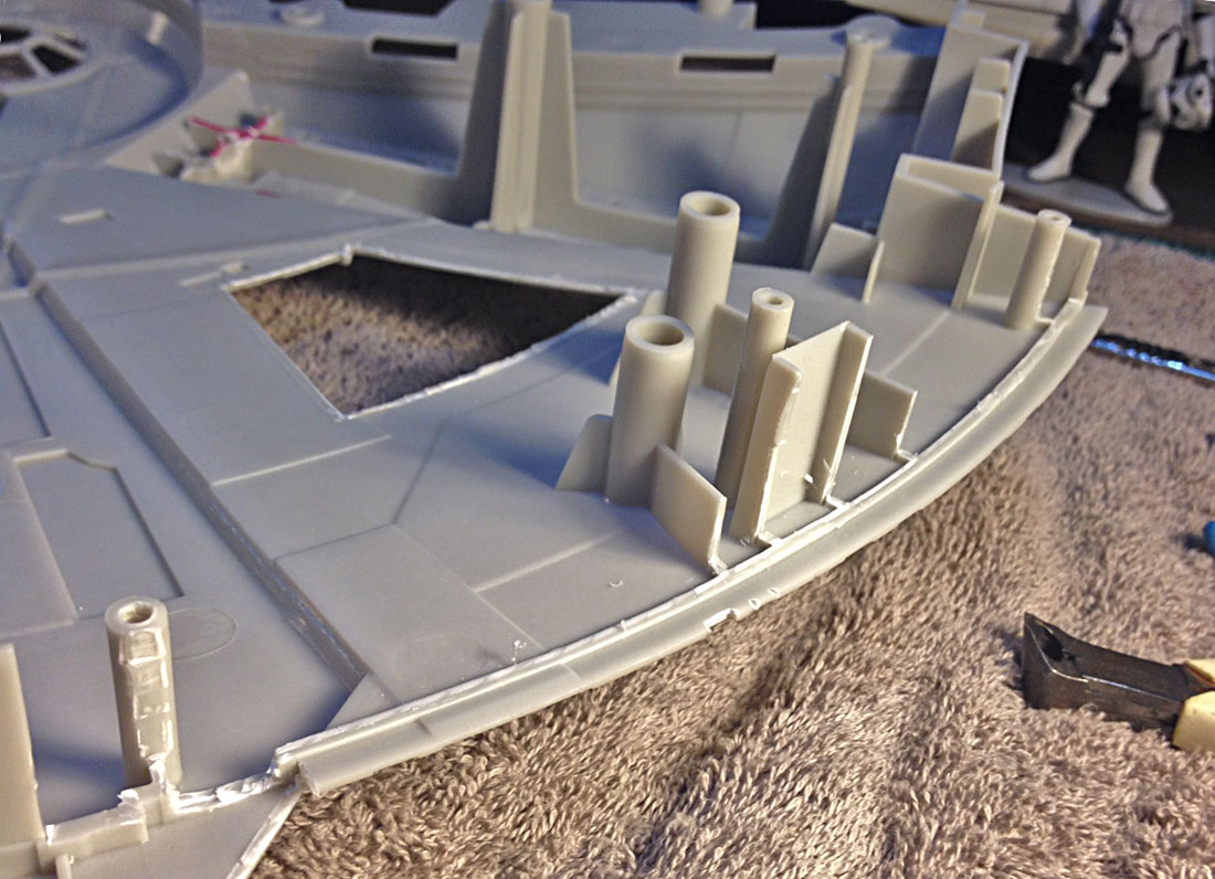

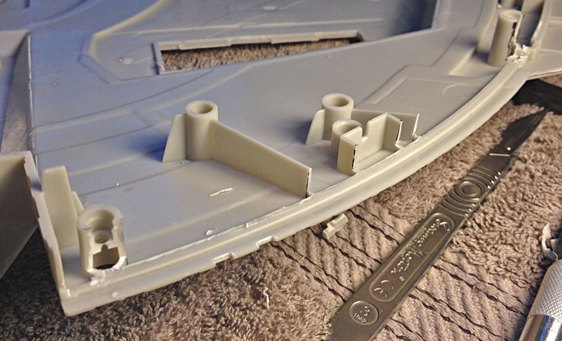

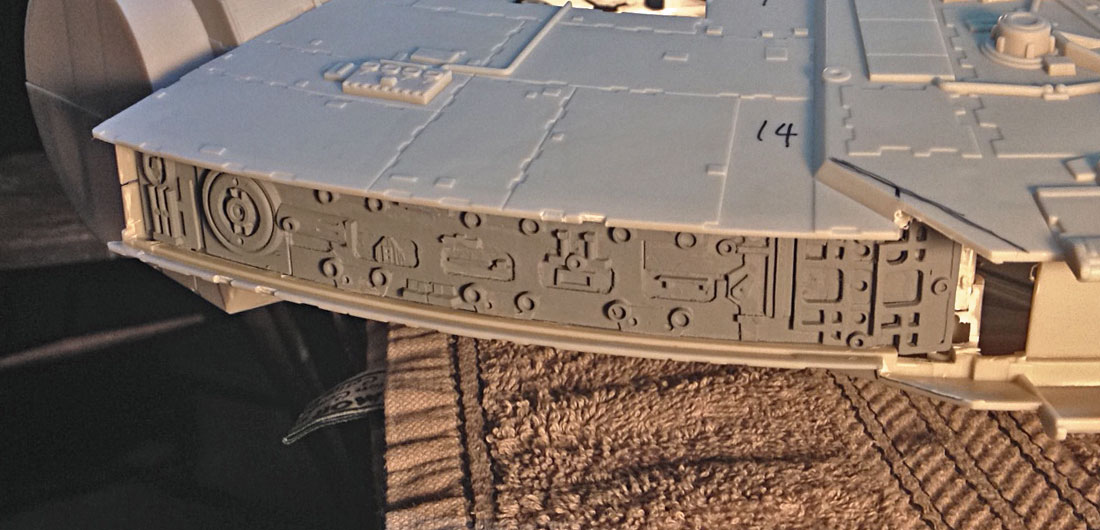

Its choppy time for the rear side walls, I’ve been putting it of for about a week but it turned out to be less trouble than I thought it was going to be :)
First I cut right tight to the back of the wall itself.
Then cut the whole thing away neatly keeping the line that is there as there is a similar line on the real studio scales.
On the top part I cut back 3mm to give a new flat back.
On the bottom part its already stepped back 1mm to let the original wall fit so I only cut back 2mm on that piece to give the same flat back.
This gives all in a further recess of 4mm which is as far as I dared to go because I want the screws to still work and besides it looks about right to me.
It seems like it is going to weaken it but if you are careful to not go to far it is quite strong once it is back together.
And the scratch built sidewall it fits in nice and snug,
I will strengthen the remaining panel areas but not until I have finished all adjustments as it bends to easy at the mo when cutting.
Not to shabby, three more to go.
