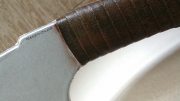

The paint job is sloppy, I got brown spots on my Bat'leth and streaks and spots, I got two little masking tape residue, that I can't remove.

Wow! Mine had the slightest bit of overspray where the two colors meet between the brown of the "wrapped" handle and the silver of the "blade" and a modest seam showing where the two halves of the mold meet, but nothing like youre showing here. I would say this is a quality control issue. I hope that they will respond and replace your item.

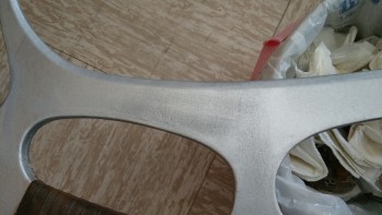

As promised to TomVDJ, I made some pics to document the touch up process.

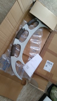

I received the Bat'leth one day after I bought the silver paint for foam and the reclaim of my item:
As I told, I got a 5 € discount for all that:

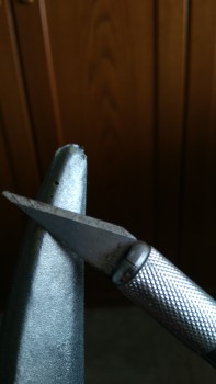

Next thing I did, was trimming the few excesses, that was on the bat'leth. Fortunately, it was so soft enough to cut, but hard enough, that I won't make a mistake.

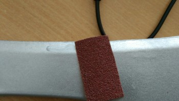

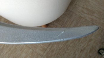

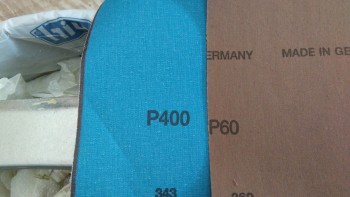

I used 60 grid paper to get rid of the droplets, but later chose 400, that was much softer on the paint and not taking too much off the foam:
Spots that aren't well, I sanded dry it down, wiped it wet off with kitchen paper and then dried it with another sheet.

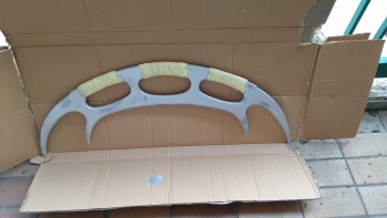

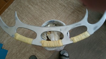

I masked the grips with painter's masking tape:

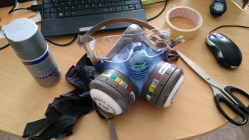

Prepared myself for the painting:

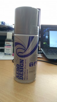

This spray paint is really good - it evenly paints and covers the spots and dries very fast and is good for foam!
The silver is more shiner than the actual paint on the bat'leth.

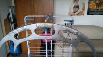

I just have a balcony to paint, but used the shipping cardbox, that came with.
Good thing, that I got a new laundry rack with coat hanger extensions.

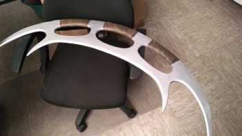

After 2 spraycans later and about 2 hours drying, tadaaa, a much better looking bat'leth:
