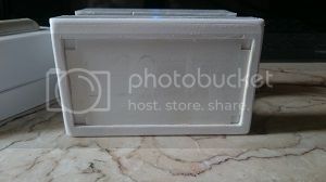

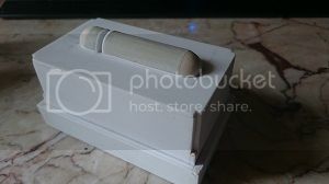

And small up date. I started making a clip. For me it will be power source as well as I'm planing to hide in it the battery pack. Not a big thing but still a step forward:
Mike
The mag is done, some tube, smoe 1mm sintra and putty:
Also the other side of magazine slot, I dediced to replicate the mag shape on it, athought it still require some work.
And that is how parts come thoghter.

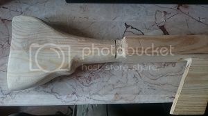

And finaly stock. For now it is very rough machied shape (and I don't have well equpied woodworkshop) so lots of hand sanding and detail work awaits:

And the stock, need a little more sanding, and black paintng but shape is quite good:

The stock is sanded, painted with wooden lacquer and primer, I even used putty but still some wooden structure...

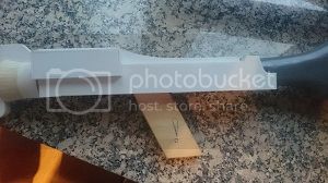

The grip part was harder then I expected. Sure it is simple and square in shape but the wooden part under caused some problems, It was to high so I had to sand it down but keeping in mind that it have to hold the barrel in secure way. So I guess some details maybe off there but I had to compromise.
Mike
It is almost done! Just few more details to add. And the scope under the barrel but that part I'm going to order to be machined. I don't like to risk it will break into pieces and it seems it will be most comfortable point to hold rifle.
