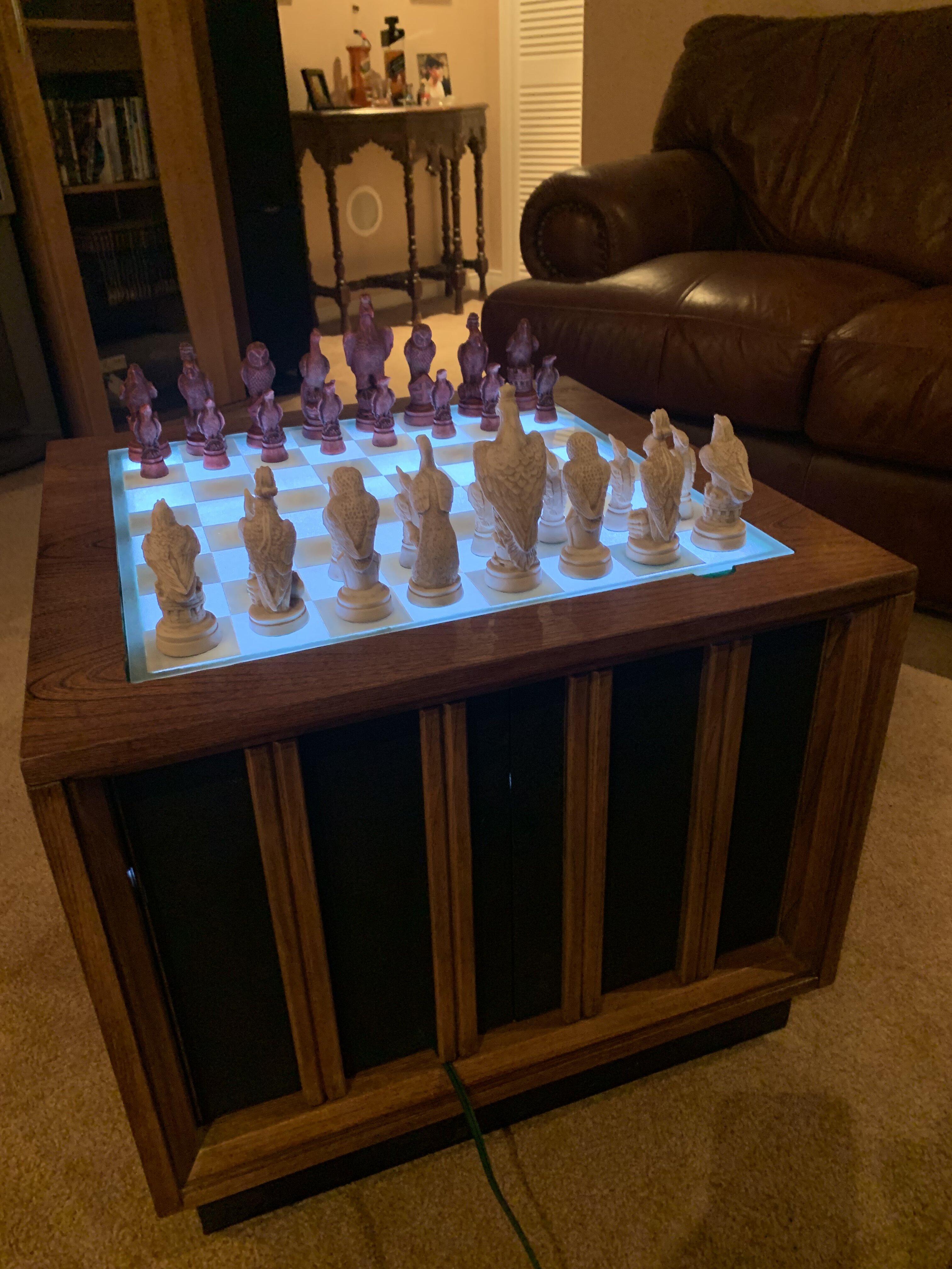

Was able to get a deal on E-bay for a British Birds chess set which prompted me into this build.
The set came in by mail and 8 pieces were broken as well as a few missing bits. I was able to repair using some molding clay for the missing parts and stick the broken pieces back together with contact cement. I added some oxblood to the brown pieces to get closer to the right colour.
I know its not the right set so I will be on the lookout for the one with the wrens and the different King and Queen.
While walking my dog I saw this mid century piece of furniture on the curb and couldn't resist. Perfect size and the look seemed to fit in the BR scheme of things.
I cut and routed a 20 in square piece off the top so I could recess in a piece of 6 mm glass which I covered with frosted covering, cut out 2.25 in squares and painted the clear parts with a sand colour spay paint using a template.
The table was sanded and refinished with Minwax. I added some green felt to where the glass was going to sit. Finally I added a white tablet to house and reflect the LED strip which I can control using a small remote, change colours, dimmer etc.
Birds Chess set: $55
Paints: $20
Table: Free
Glass: $35
LED kit: $36
Green felt: $4
Total: $150 CAD / $120 USD
Happy camper, going to play a game tonight with BR Running in the background along with a glass of Johnnie Walker :)

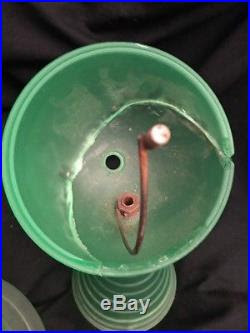

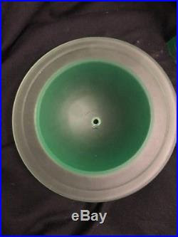

The Globe is made of two pieces of glass that form Saturn, one piece is the half sphere with the ring band the other is the other half. There is a stepped metal base in which the light fixture is attached and the two mounting points that hold the sphere together.
So the Globe that makes Saturn is translucent and the base that sits below the metal bracket is translucent.
Only the Globe light up.
I think I can find some pics of the lamp disassembled.
Height: 11.5 in. (29.21 cm)
Diameter: 8 in. (20.32 cm)
