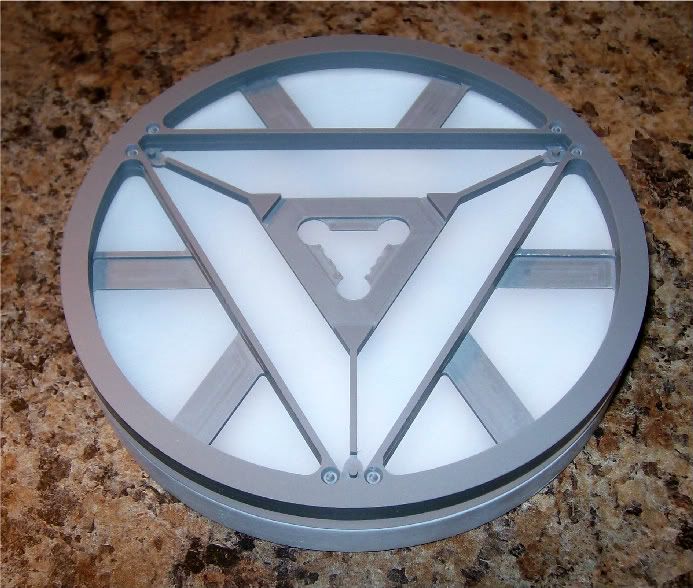

Alright, finished my design and cut the first prototype.

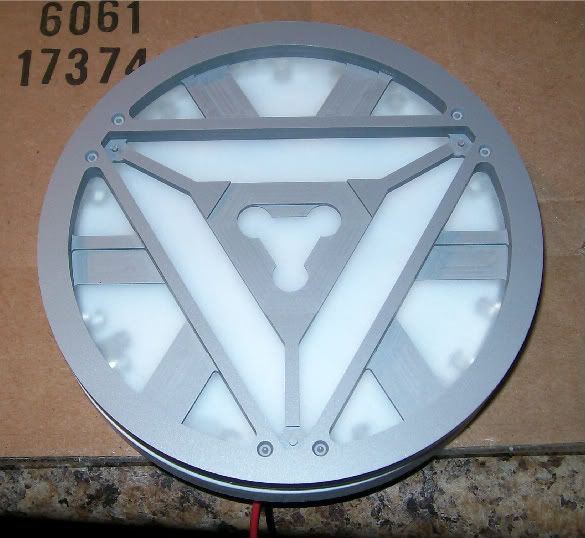

Definitely some tweaks to be made and have this recut before the final version, but turned out pretty good at this point. This picture is just the parts sitting together. There will be plenty of sanding, painting, wiring, and gluing to get it to a fully assembled state.
The very bottom layer was cut a little too thin and I lost some material on the edge of the innermost triangle area. I'll recut that piece for sure.

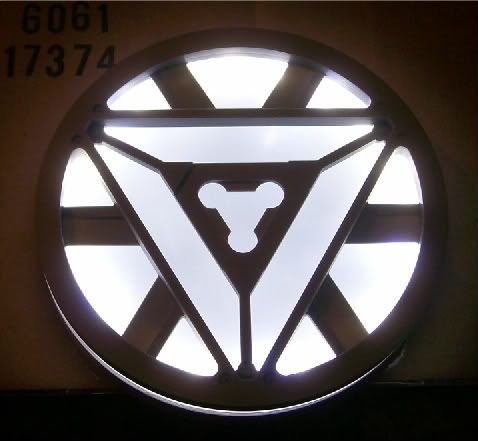

I have the led's all wired up and installed. I still have to do a bunch of sanding to diffuse the light better, but it already is crazy bright. Here is all the pieces together with the re cut top layer. The changes turned out really well, this is a solid version.

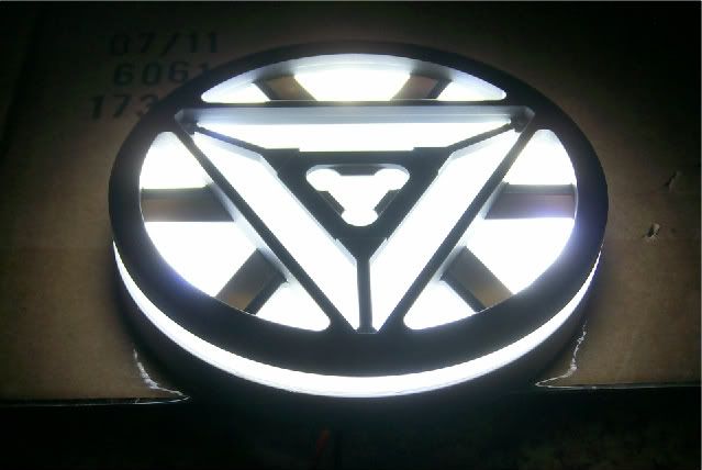

Now to show off the goods. Here is it turned on. There are 20 white LEDs in there along with five wide angle blue LEDs to give it a slight blue tint. The white is so bright you can only barely see the blue. That's alright, its mostly white in the movies with just a hint of blue, so its pretty close to what I was going for.
