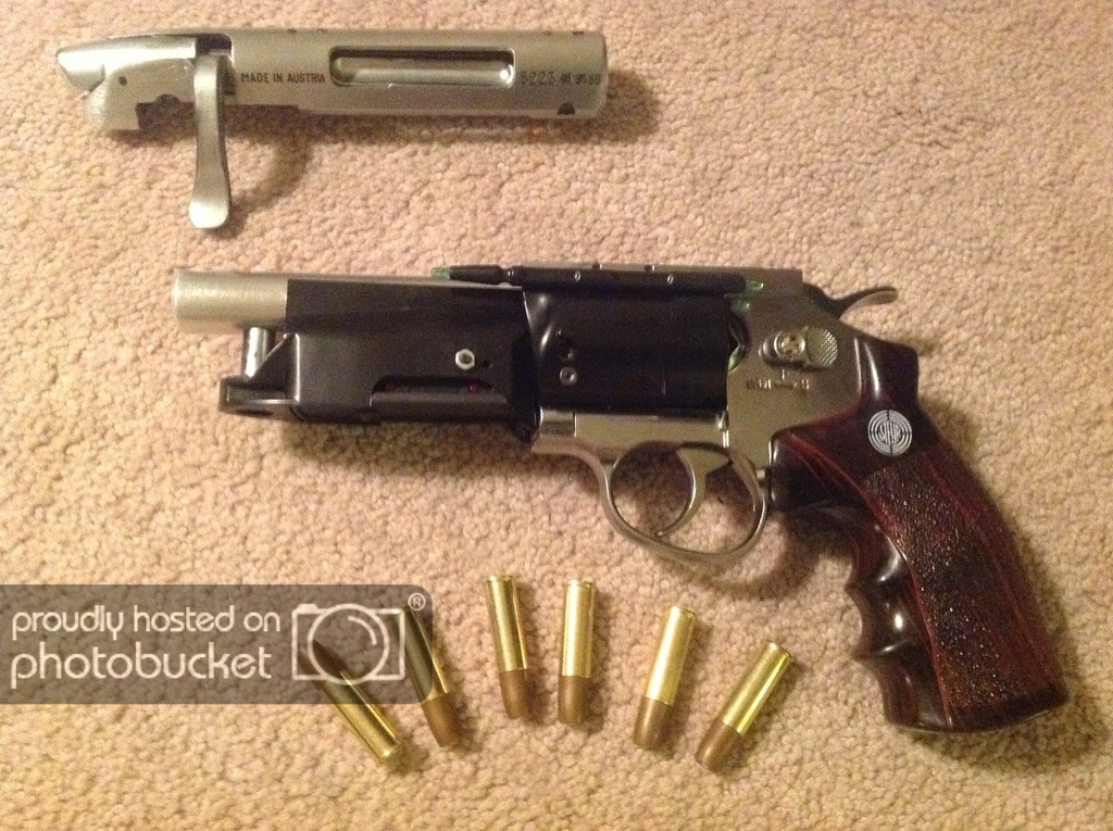

Day 1 of work -
The M2019 blaster arrived today and I immediately began stripping off the black anodizing on the upper receiver. I spent the rest of the evening fitting parts to the Airsoft gun, drilling and tapping holes, and doing minor machining on the gun frame in various places as needed to get the parts to fit.
I still need to cut the trigger guard off, trim the hammer, and machine slots forward of the hammer to mount the upper reciever assembly to the pistol frame and barrel. I also need to machine a slot for the forward trigger, and mount the trigger and trigger guard.
Here's what I got done today:

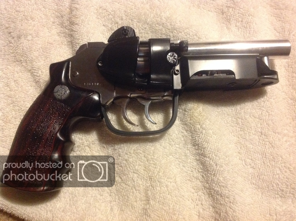

Day 2 of work -
Removed original trigger guard and mounted the new one. Trimmed down the hammer. Completed about half the work reshaping the top of the frame to allow mounting of the upper receiver.
Day 3 of work-
Machining the slot for the forward trigger...
Forward trigger mounted...

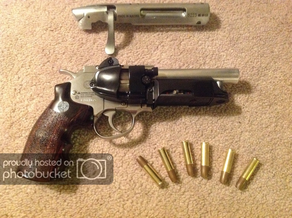

Day 4 of work-
I'm going for a "well maintained service pistol" look so I won't be doing any weathering. I will also be keeping the faux wood grips on it since A. I like them, and B. I can't modify the the grip frame to use the film style grips without damaging the Co2 cartridge mount.
Just finished polishing things up and reassembling...
Next up is finishing the machine work on the top of the frame and getting the upper receiver mounted.

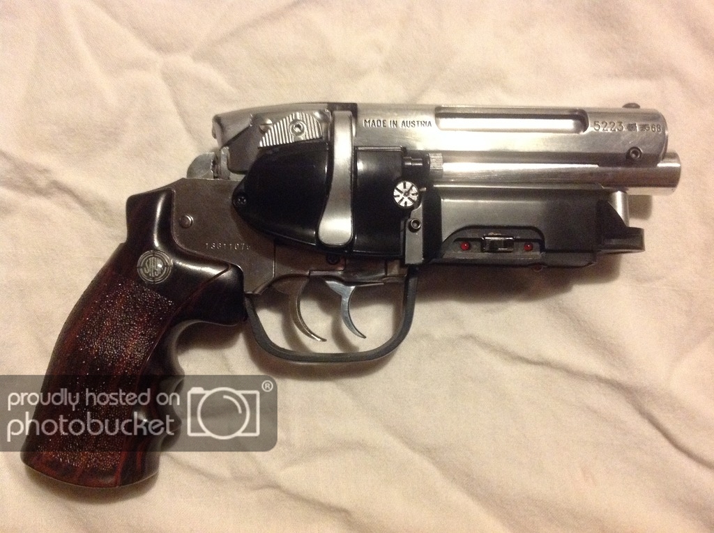

I finished the machining to fit the upper receiver to the frame. There is still some clean up work to do at the rear end of the upper receiver and on and around the hammer. It's slightly different from the original due to to differences in the airsoft gun but I'm pretty darned pleased with the way this is turning out.
Gwen

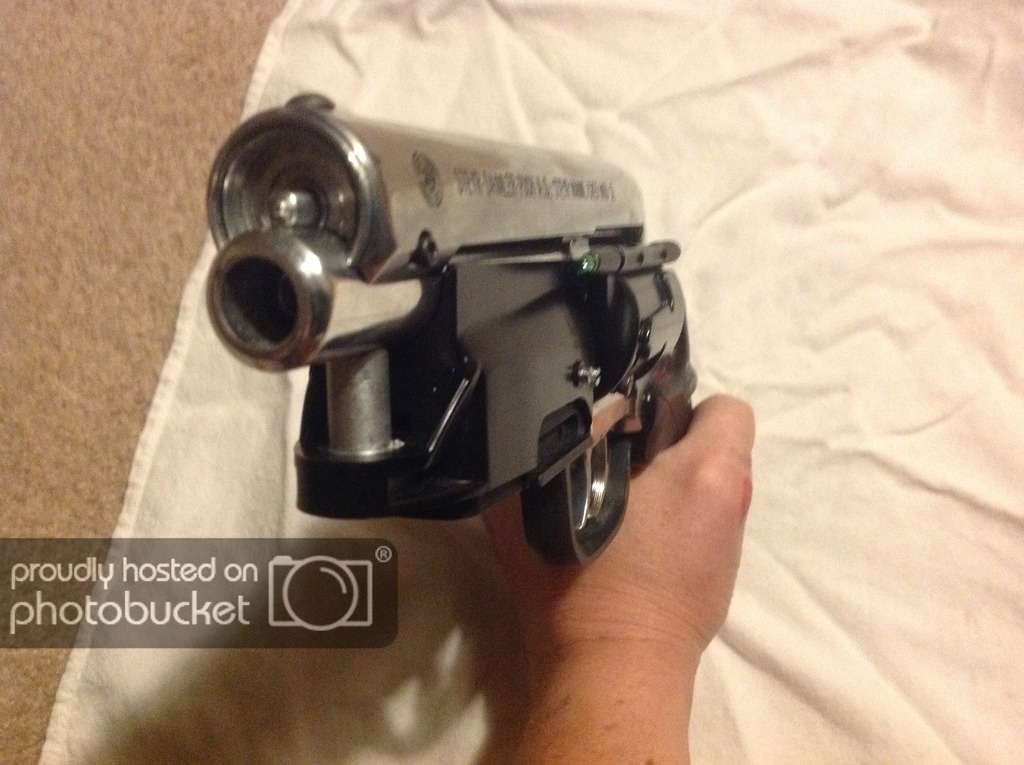

Gwenydd
My new holster from Phil Steinschneider just arrived today so I thought I'd post some photos. This holster is beautiful, I highly recommend Phil. I also included my ID I made with my plastic card printer...

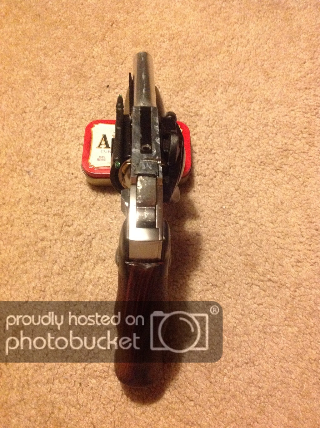

Gwenydd
Added an aluminum shroud behind the hammer to try to preserve the overall outline of the original prop and to clean up the frame areas I had to cut off. I still need to file it down a bit and polish it but this is the last of the work I expect to be doing on this project.
