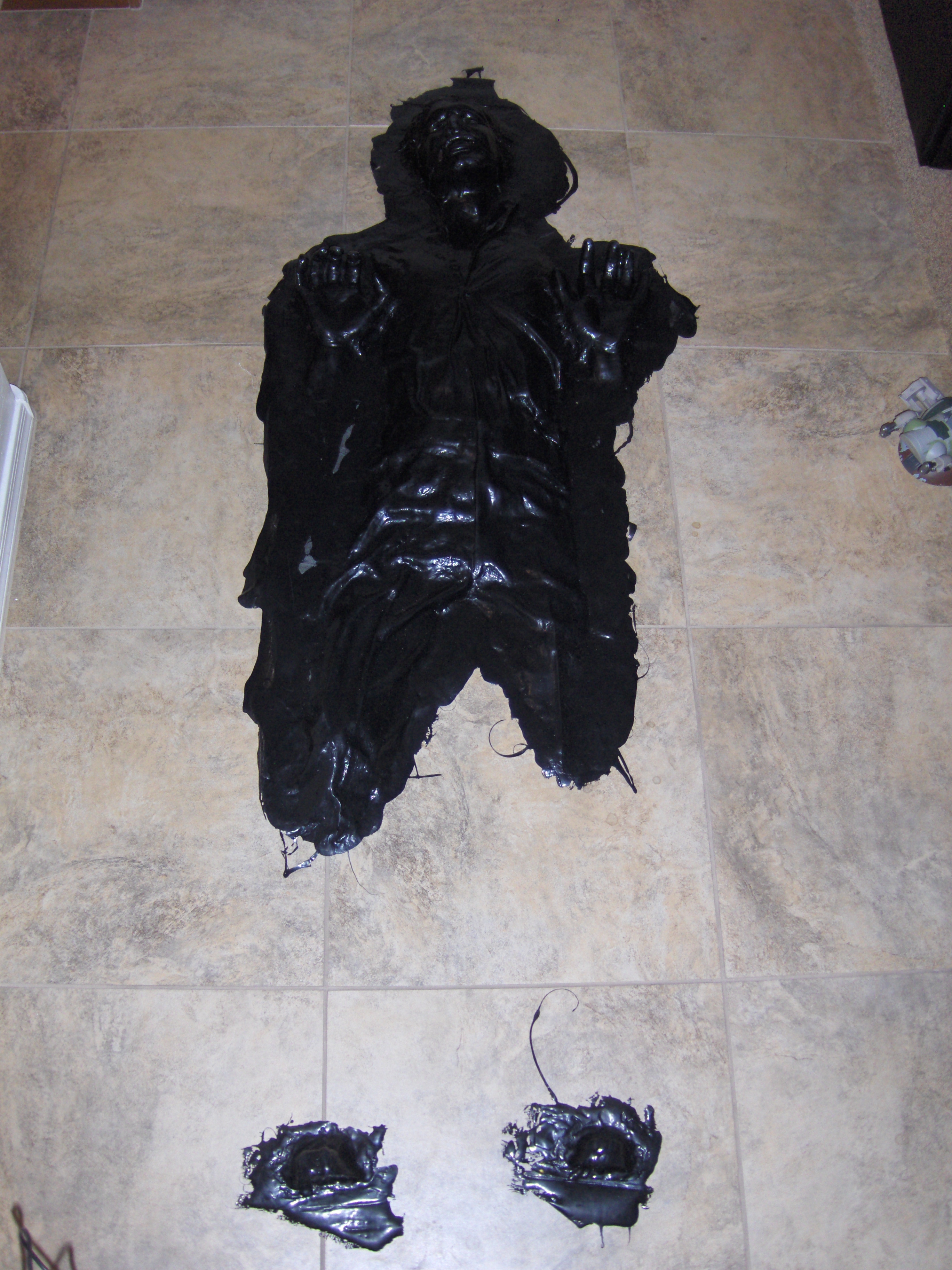

I am starting up my second attempt at a life-sized Han Solo in Carbonite. My first attempt came out OK and cost around $350.00. But since I have some more detailed pieces, an increased budget, and a bit more experience, I am hoping this one will be nicer and more authentic. Here is what the first one looked like, mostly built from scratch.
On this new project I will am using a front panel cast made out of rubber instead of piecing it together like my first attempt. I also have a set of VashDStampede's side panels which I have probably been holding onto for over a year. These are the best panels I have seen. Also have a set of panel greeblies to add.

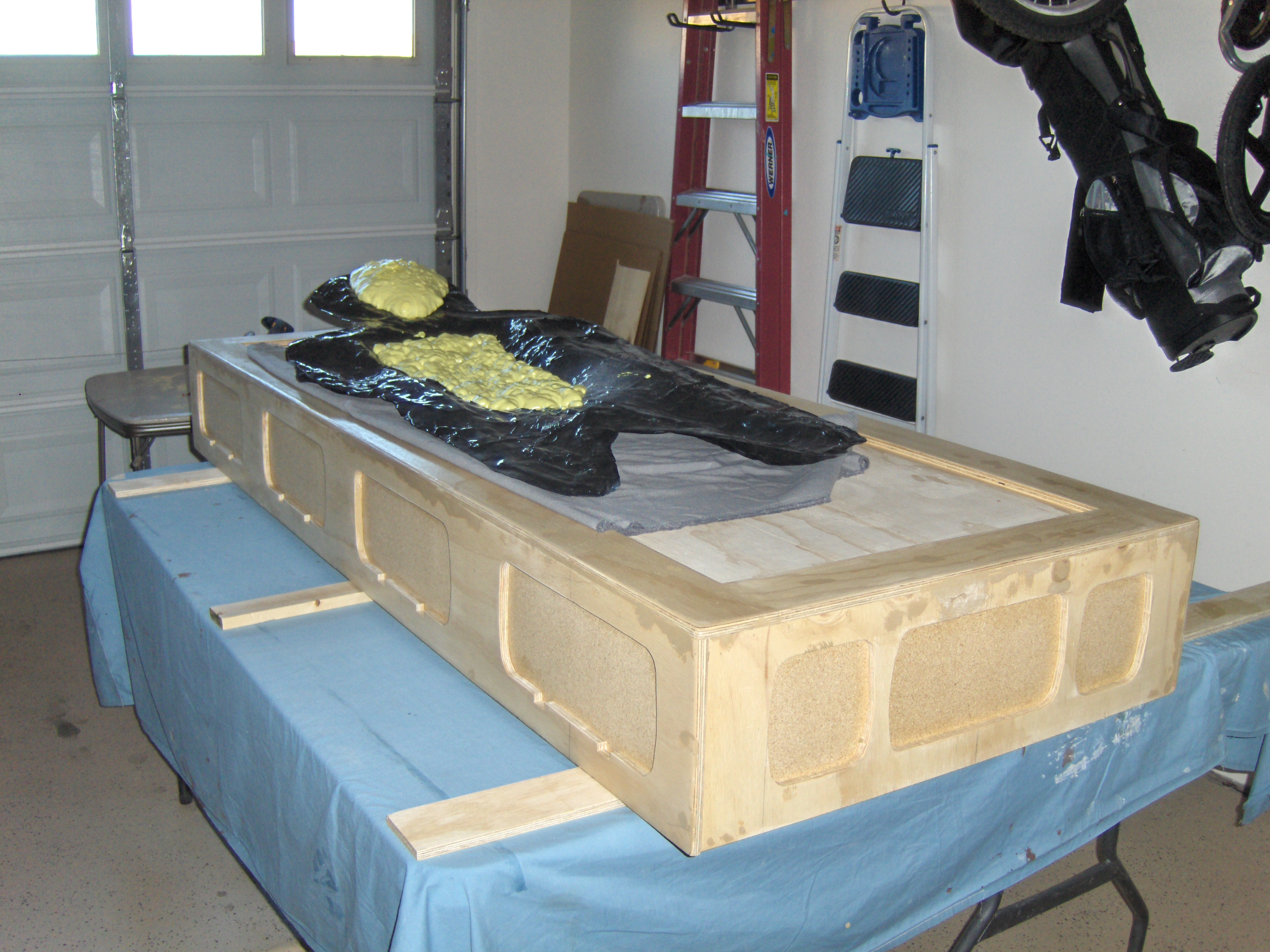

Bought my lumber and started mocking this up.

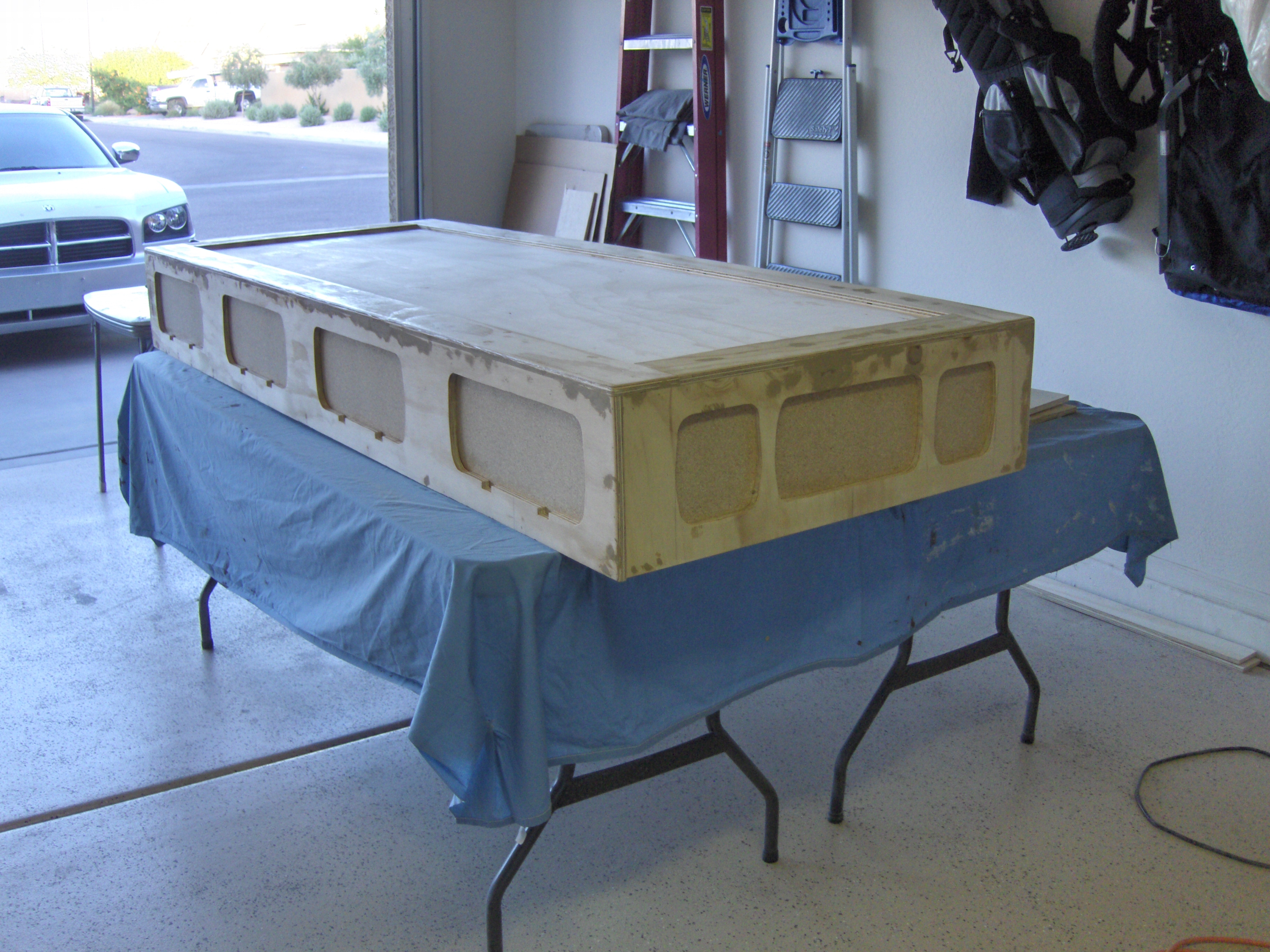

Finished up the box and rough cut the holes for the panels. I still have the holes to do at the base and the top, then I want to seal this and get working on the front panel.
I also rounded the outside edges and will do the same to the inner edges around the front panel.
I cut out the details on the top and bottom of the case. I don't know the exact sizes, so I improvised. You wont really see these anyway when I mount this to the wall.
I used 1/2" MDF for the panel backing. It was cheap and has a nice smooth surface. I also put a few coats of sealer on the wood.

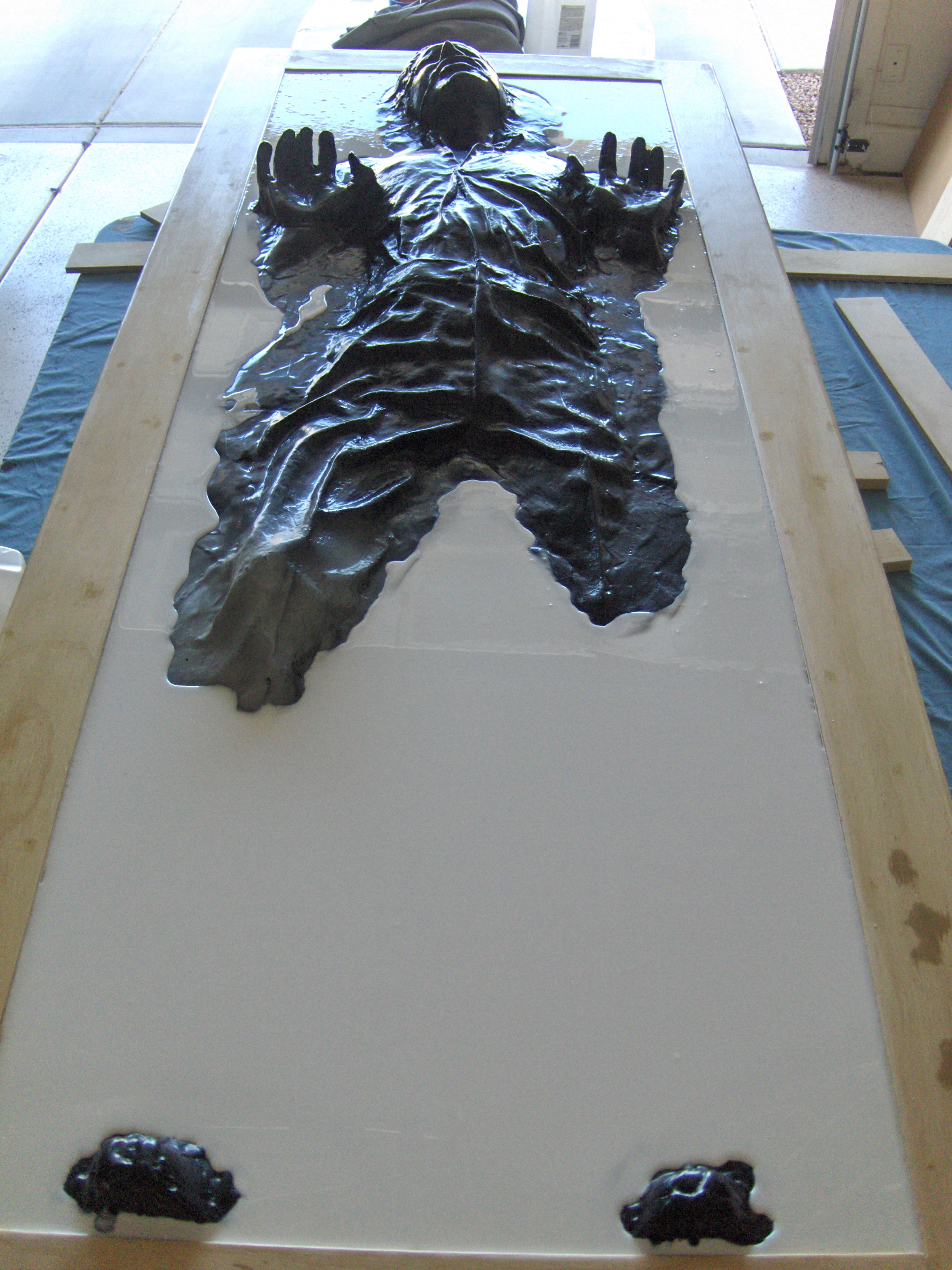

I am using expandable foam to fill in the voids of the HIC cast. I decided to do this first, just because I thought it would be easier than cutting the panel after it was glued down. Also did not want to run the risk of the expanding foam popping the panel off. I'll trim the excess once it fully dries.
Yesterday I started working on securing the Han front panel to the box. I used a polyurethane adhesive that works well with plastics/vinyl/rubber/etc. I also secured the edges with 1/4 inch wood screws, which helped get a tight bond. I wasn't worried about putting a few holes in the panel since they will all be covered when I pour the carbonite. I checked everything this morning and it's on there pretty solid.
Next I poured the carbonite base. I am using a technique I used on my first HIC build, Elmer's glue with a little hardener/accelerator mixed in. Once this base coat hardens up, I will start pouring several smaller patches to build it up and give it that uneven/frozen look. I figure I will do that 3 times or so.

Looking great. If there's still time I would suggest that you pull the feet and the rest of the body closer together, otherwise it seems he'll end up with exceptionally long shins. Just a thought.
lol, yeah I always wondered in the film why he ended up in that pose after his hands where shackled. must have been a blooper
Actually, I think that is just an illusion from the photo. Before I placed these I measured from my knee cap to the tip of my boot, both legs, one slightly bent as in the picture and one straight, and the dimensions are exact. I am 6', which is what I built the box dimensions to.
The camera angle may be causing that, but in person it is not quite as dramatic as it looks in the picture.
Good catch...I see what you're talking about too but it is hard to tell with camera angles sometimes. Can't wait to see you building up the frozen parts around it :)

By conincidence, I just received some Han chunks today and I'll need to do exactly what you're doing. Could you explain a bit more about your Elmer's glue pour? I was thinking about how I was going to do that part and had no idea until I saw your post.
Scott
Scott
For the carbonite I am using Elmer's glue mixed with a bit of hardener. The glue is about $10.00 a gallon from Lowe's, you may be able to find it cheaper elsewhere, like a school supply store. The name of the hardener escapes me because I stored it in a separate can when I dropped the original bottle a while back. I think it was an accelorant used in epoxy garage floor coatings. If I remember right you can get it from Lowe's or Home Depot, I bought it some time ago. It came in a red, plastic bottle, about the size of a baking soda box. Next time I go, I will try and spot it and get you the name.
I only used it on the initial base, just because it was so thick and I built my last HIC in the winter. It's not entirely necessary, it all depends on how thick your pour is and the temperature (it's pretty hot in AZ right now). You don't have to use it, it just takes longer to harden.
Once that base dries enough, I pour smaller puddles in random locations all over the existing glue and Han's body. When you pour the initial base, you'll get a few bubbles, I used a lighter to get rid of some of them. You can also sand the glue when it dries. I just poured smaller puddles over the areas with bubbles and that takes care of it.
Hope that helps.

Thanks! How hard does Elmer's dry? Will it take any wear over time? Just seems like a soft material, from what I remember.
Scott
When he's unfrozen, there's no shackles or nothing....
Maybe the shackles are made of carbonite and thus melt with the rest of it? One less thing to be used as an improvised weapon when you thaw your prisoner. I suppose?
This Han is looking good. Poor guy.
Scott
Elmer's dries pretty solid, unless you plan on using it as target practice, you should be just fine. My other one was rock solid. I know some other people have used flexible grout and other materials to make the carbonite, but I think this is cheaper and easier to work with in my opinion (sands the dry time).
