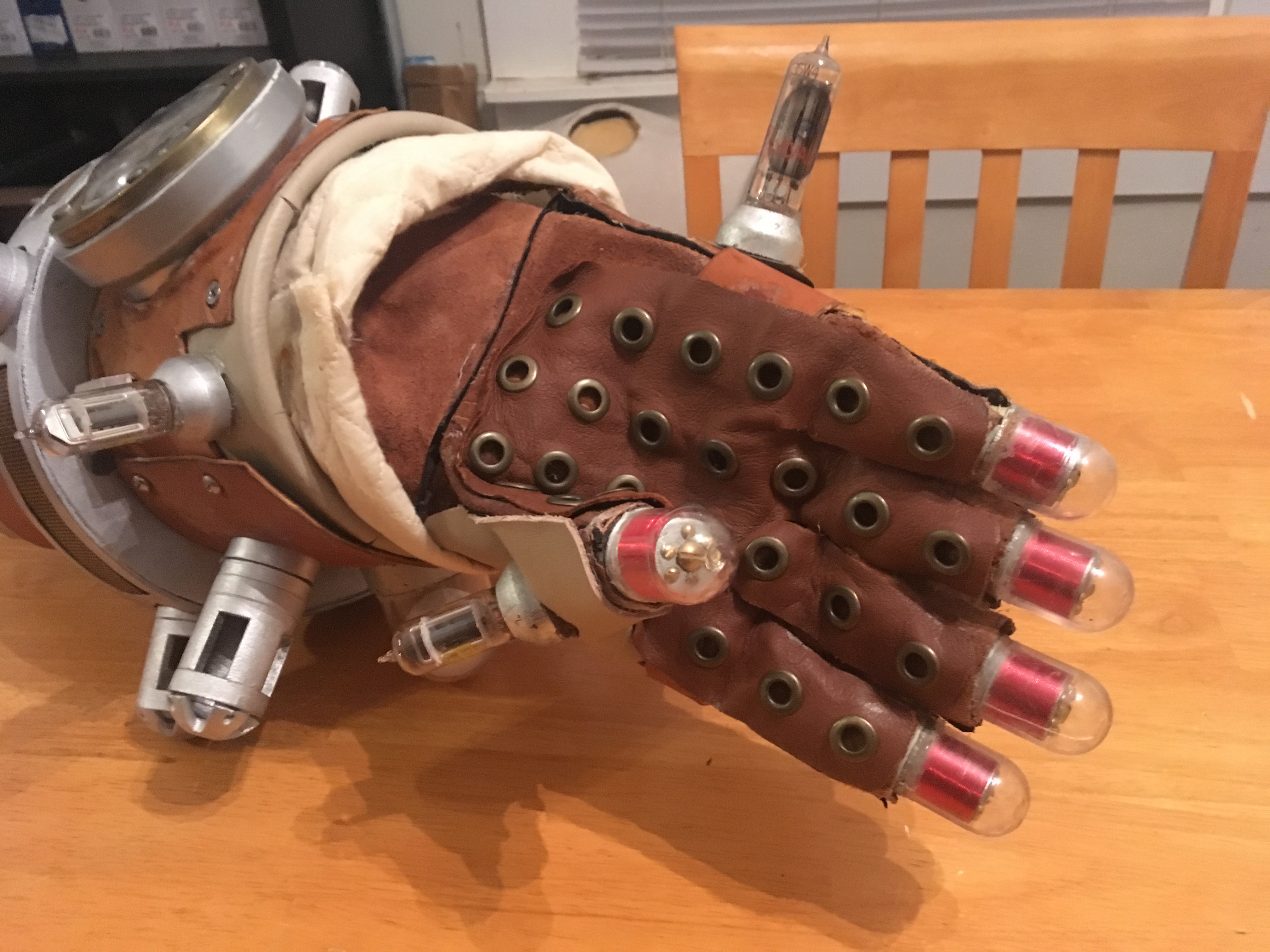

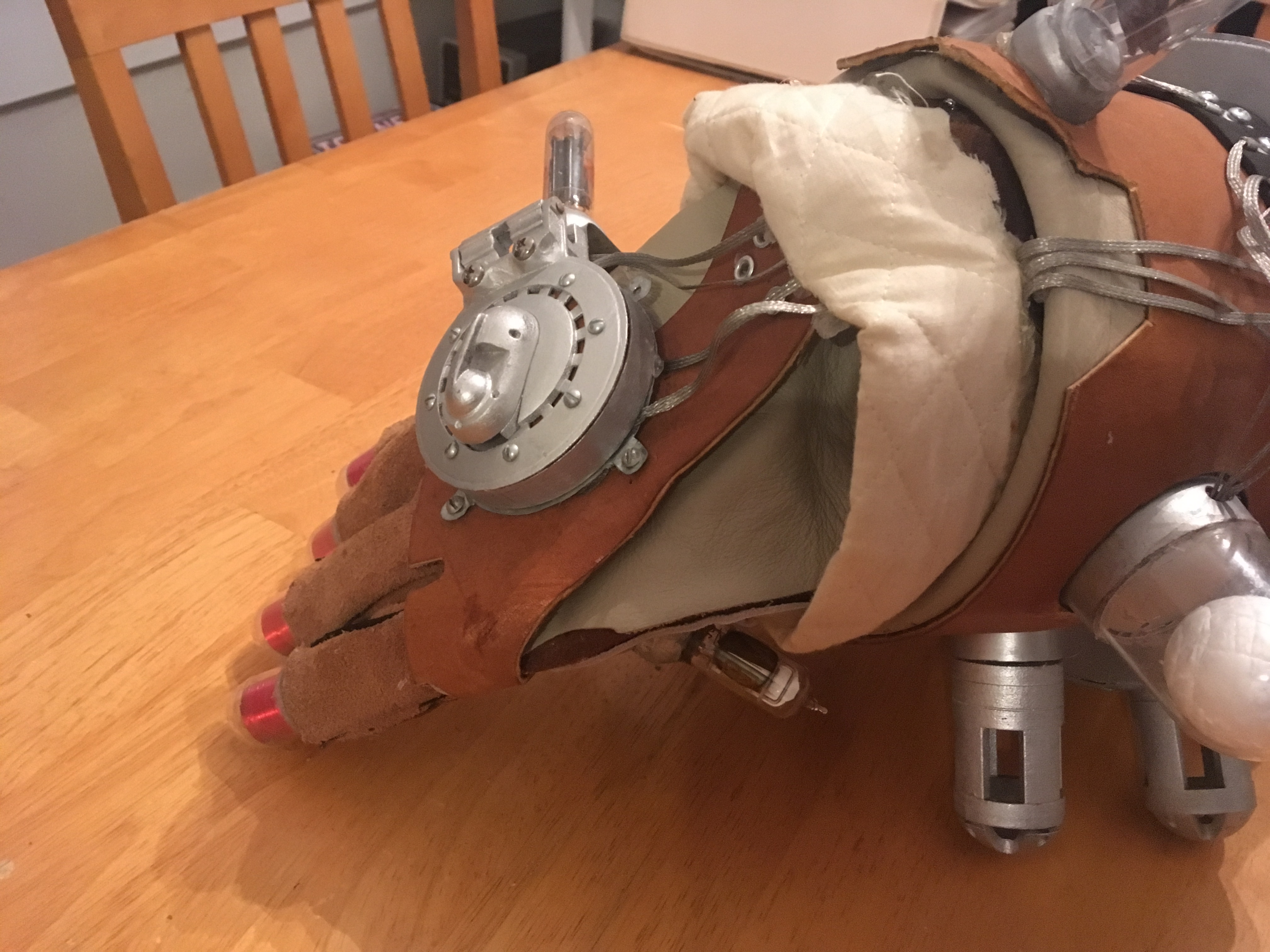

I'll post some pictures from this new build shortly. In the meantime here are a couple pics of my Rasputin cosplay and the most recent pictures of my glove before I broke it down into parts and

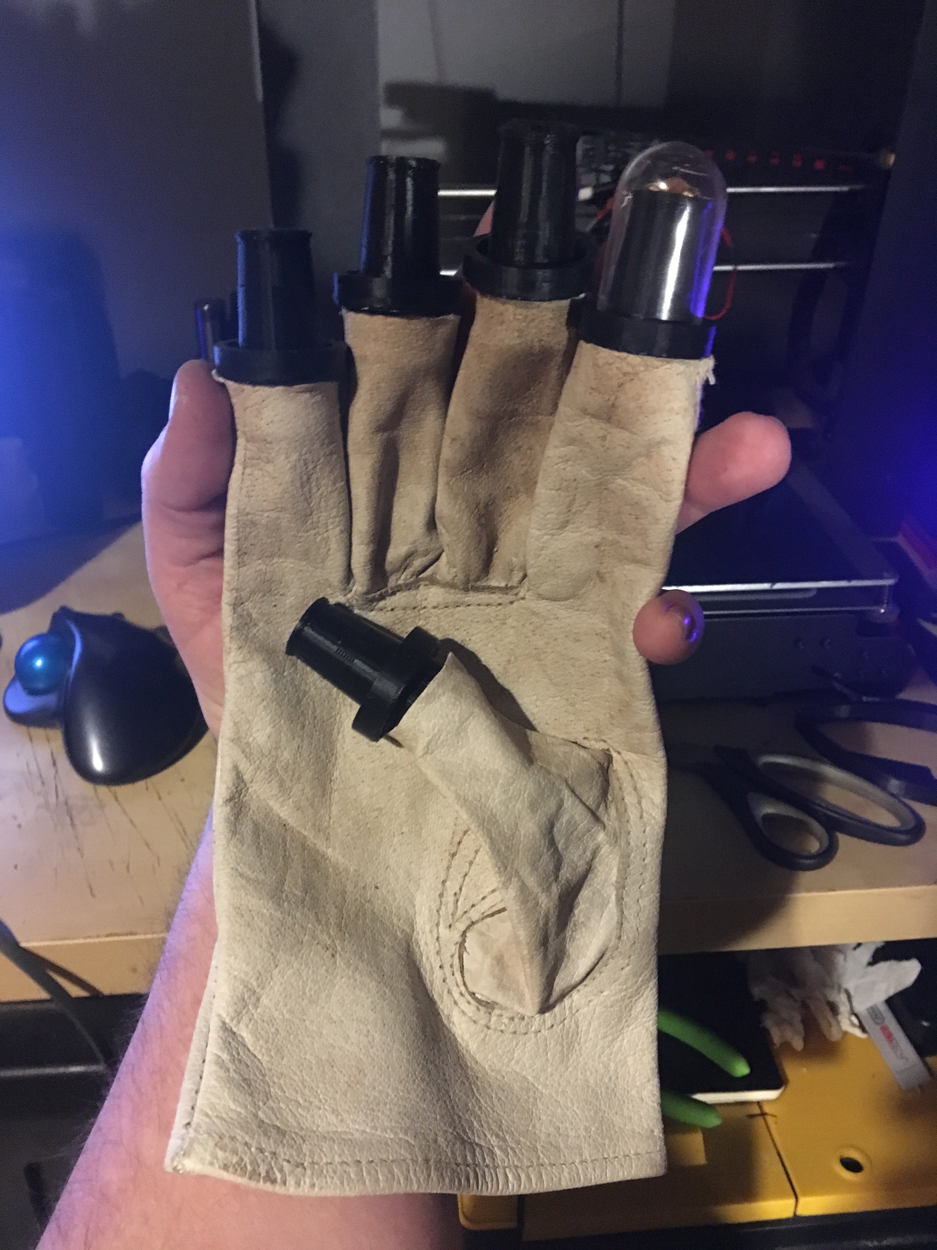

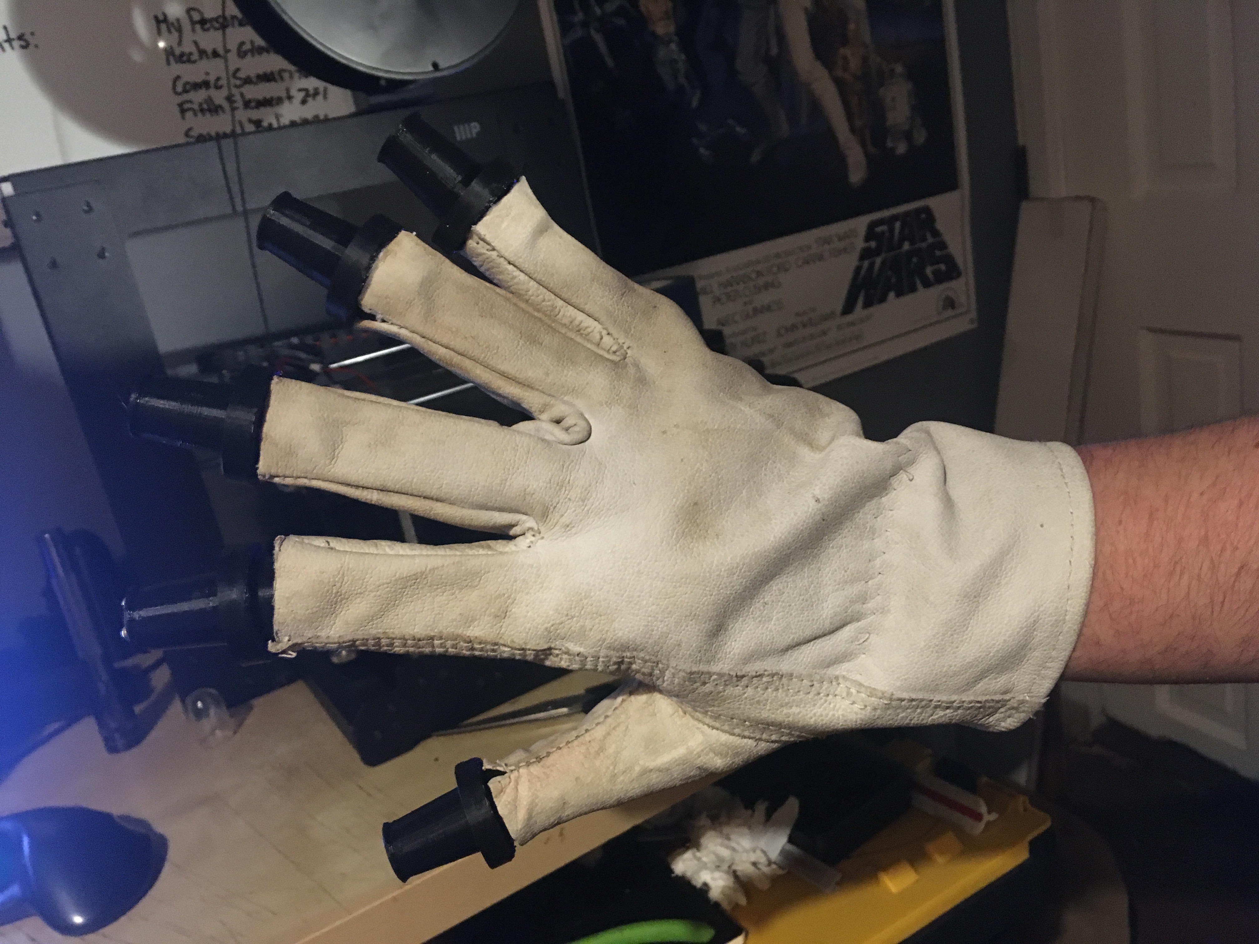

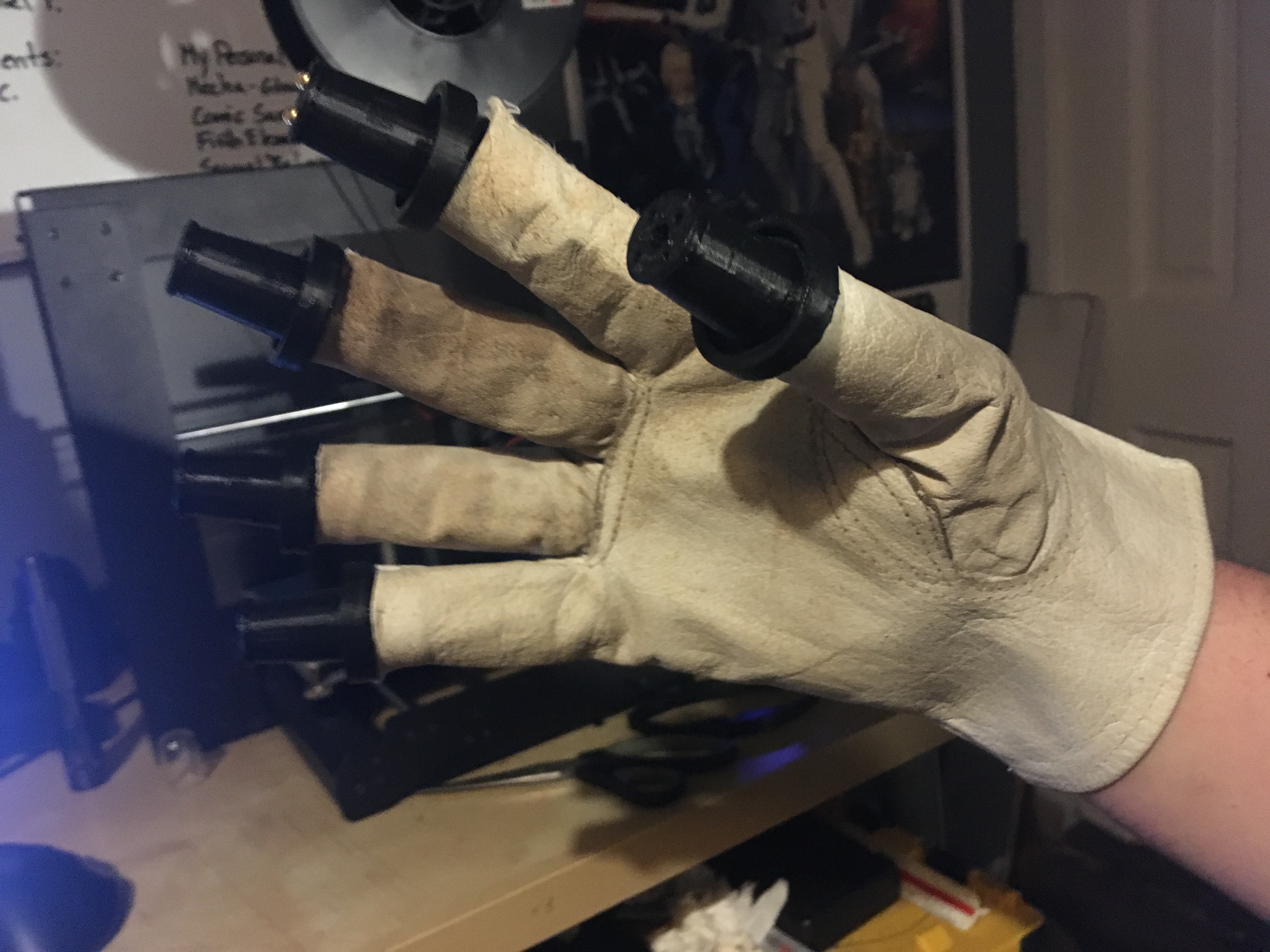

I 3D modeled the new fingertips that I'll be using. the lower ring portion is where these will slide into the new leather glove that I'm going to use. And the lower ring is where the tips of my fingers will go and that will allow me to have better control of the fingers and move movement this time around.
