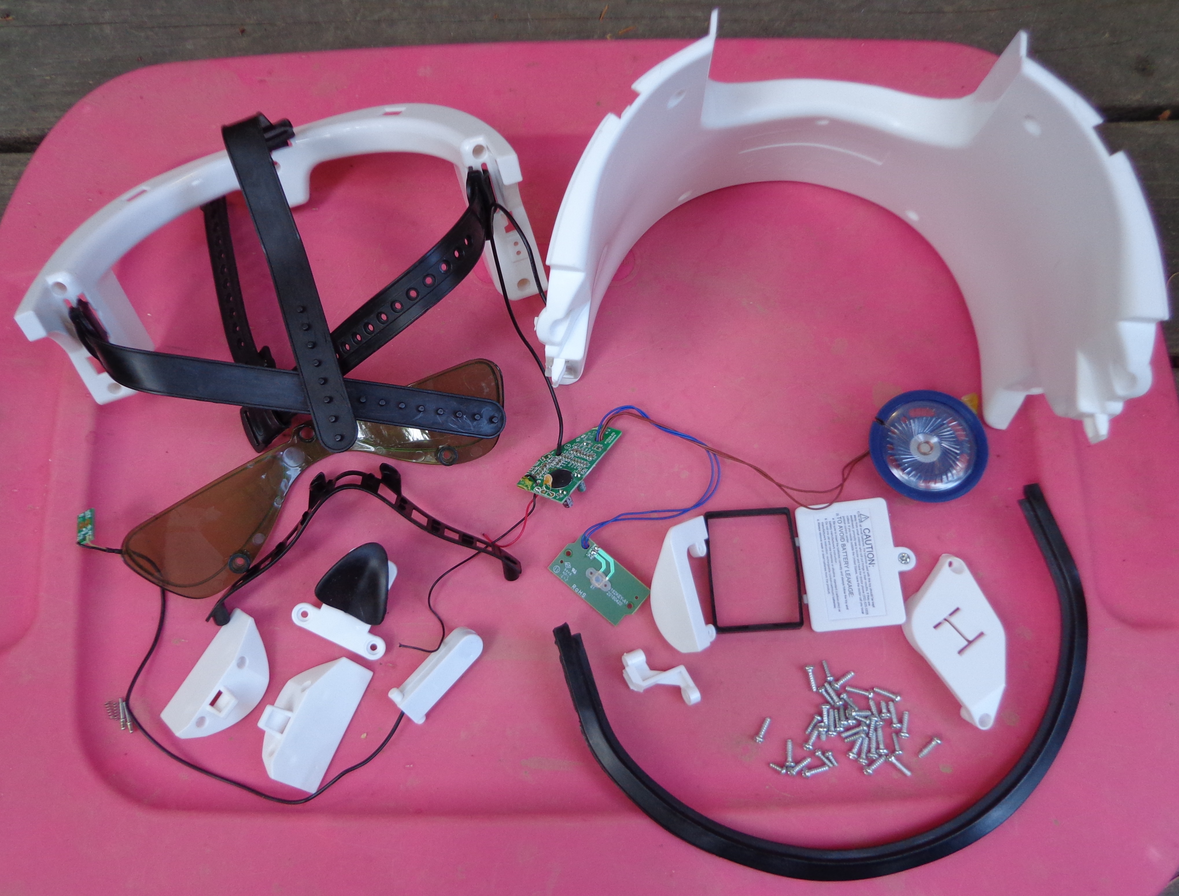

Welp. I was going to follow up updating the first post immediately with this one, but the power went out as I was typing it up. Yay. Anyway. Fresh start. Kinda. More of a soft reboot, I guess. I currently have three HBS Shadow Trooper helmets and one standard white Stormtrooper that I got for a commission that canceled due to life tossing them a curve ball. I'll start there. By this point, I can break these things down faster than someone disjointing a chicken for cooking. I keep these pieces:

Although I should note the Shadow Trooper variant has a semimirrored tinting film in front of the lens piece that I keep. Also, I keep the separate earcap greeblie out of habit more than need. I only need one pair of those, for one of the builds I'll get into later. The rest are getting replaced by more OT-style bits. I also pop the aerators off and keep them in my just-in-case drawer. As shown upthread, I have accurate 3D-printed Hovi replicas that, conveniently, don't require drilling out.

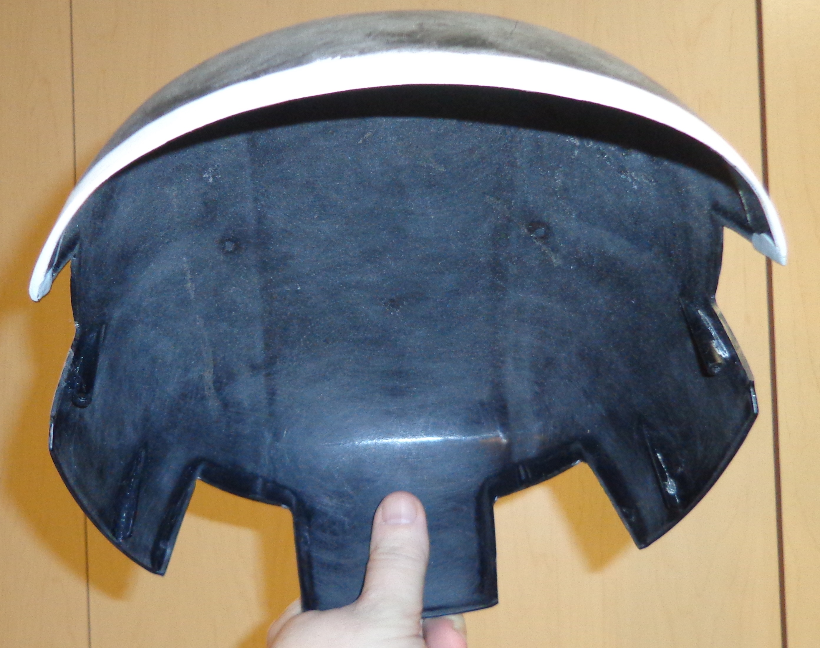

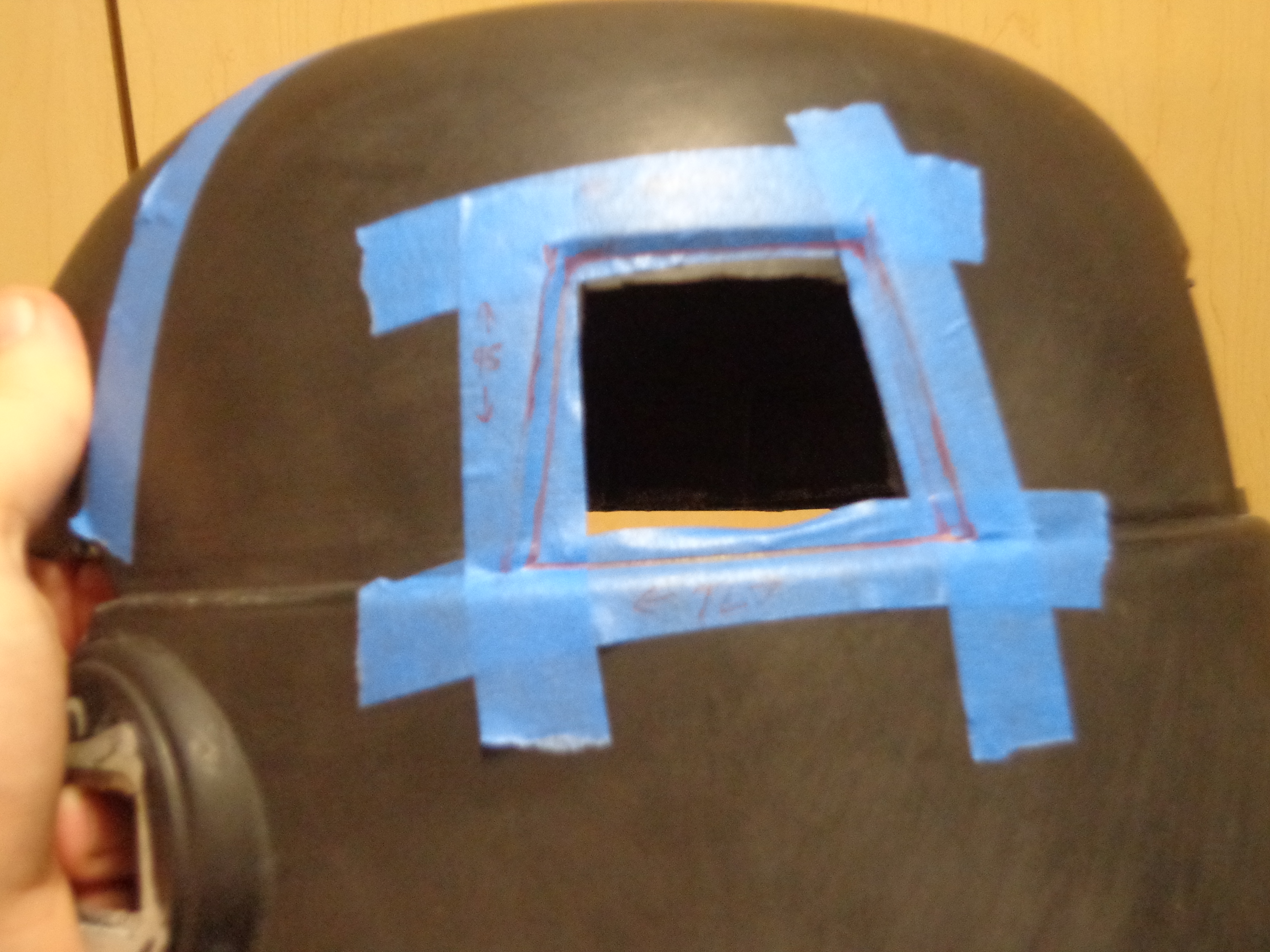

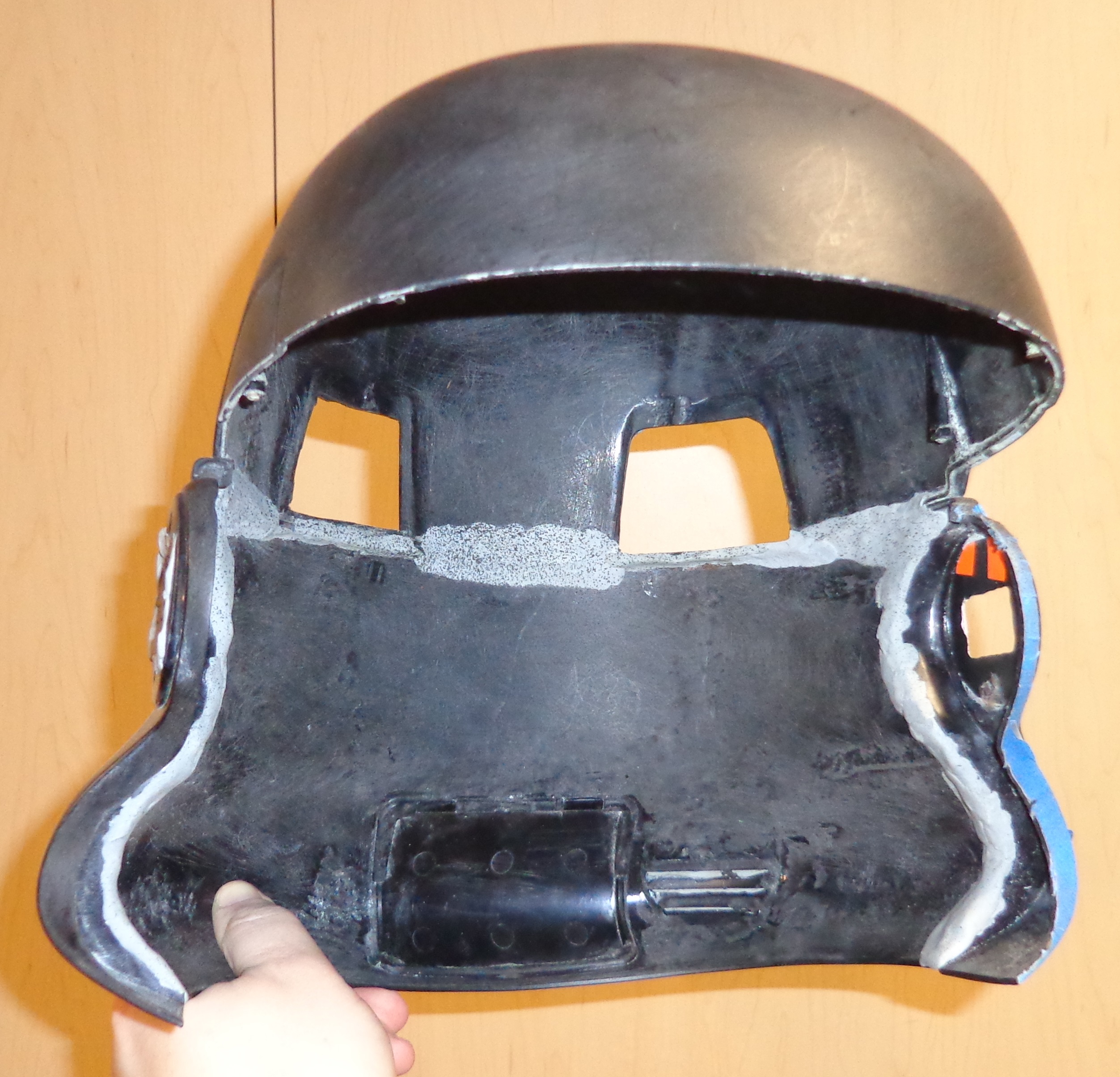

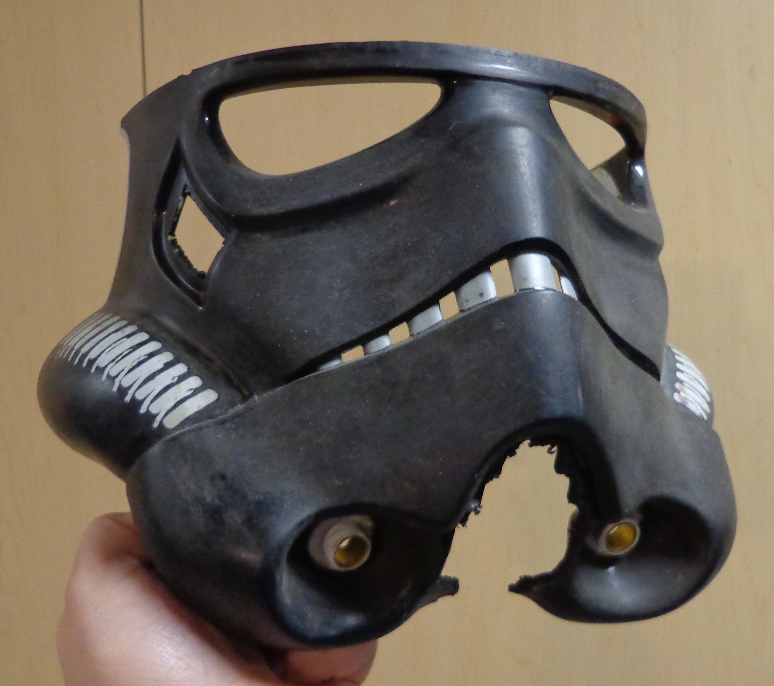

So I have two roughly standard Stormtrooper helmets I'm building out of these -- discounting paint jobs. Everything up to this point has been with my first attempt, where I was, ah, having all my learning experience. After going a little in the wrong direction, I am presently here with the cap-n-back, which I epoxied together ages ago. Cleaned up a bit of the inside and, as you can see, did some trepanning:
The traps around the helmet dome aren't quite accurate in shape, so I'm opening up all four to the right size, with new traps being made to put in from behind:

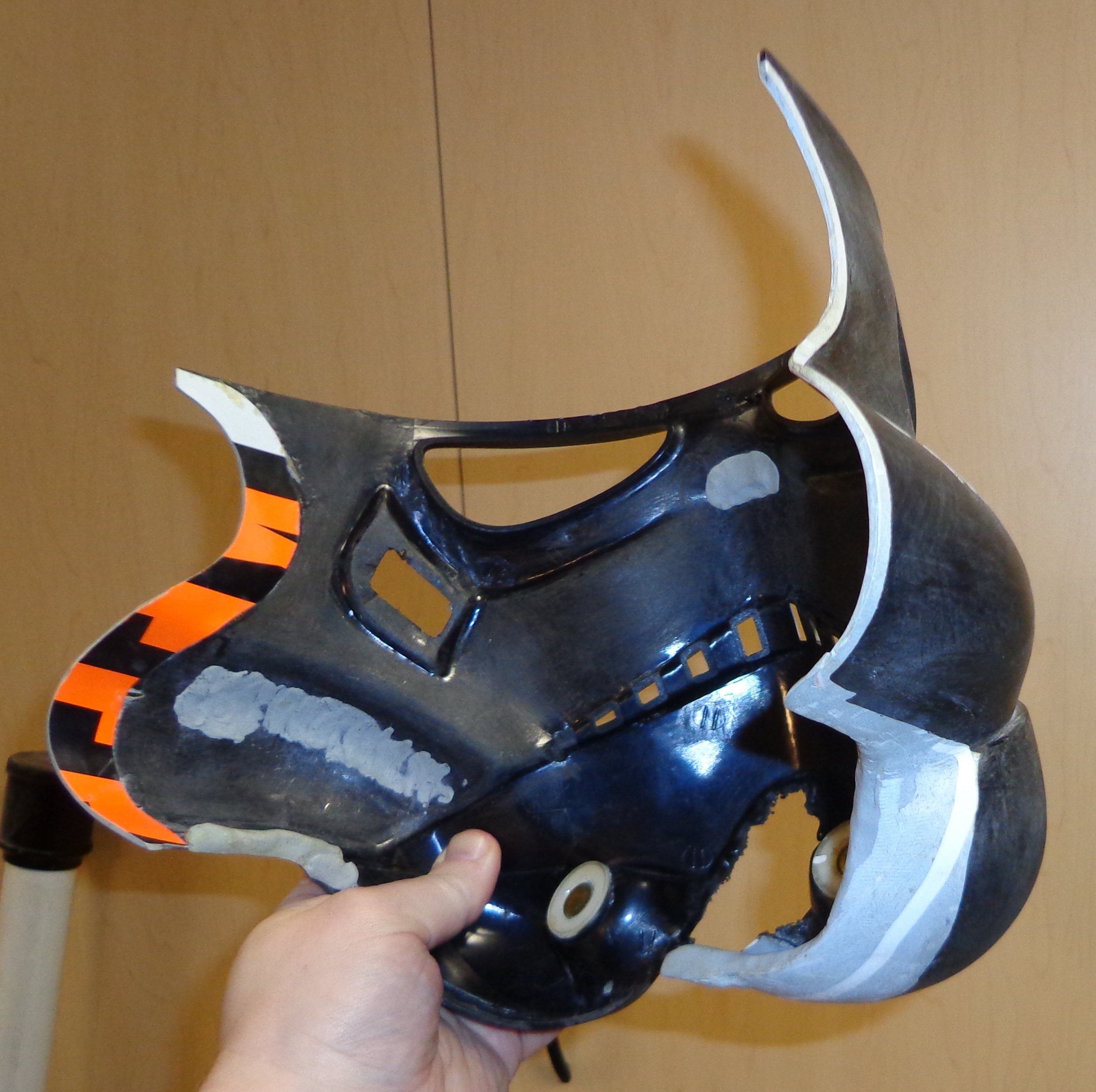

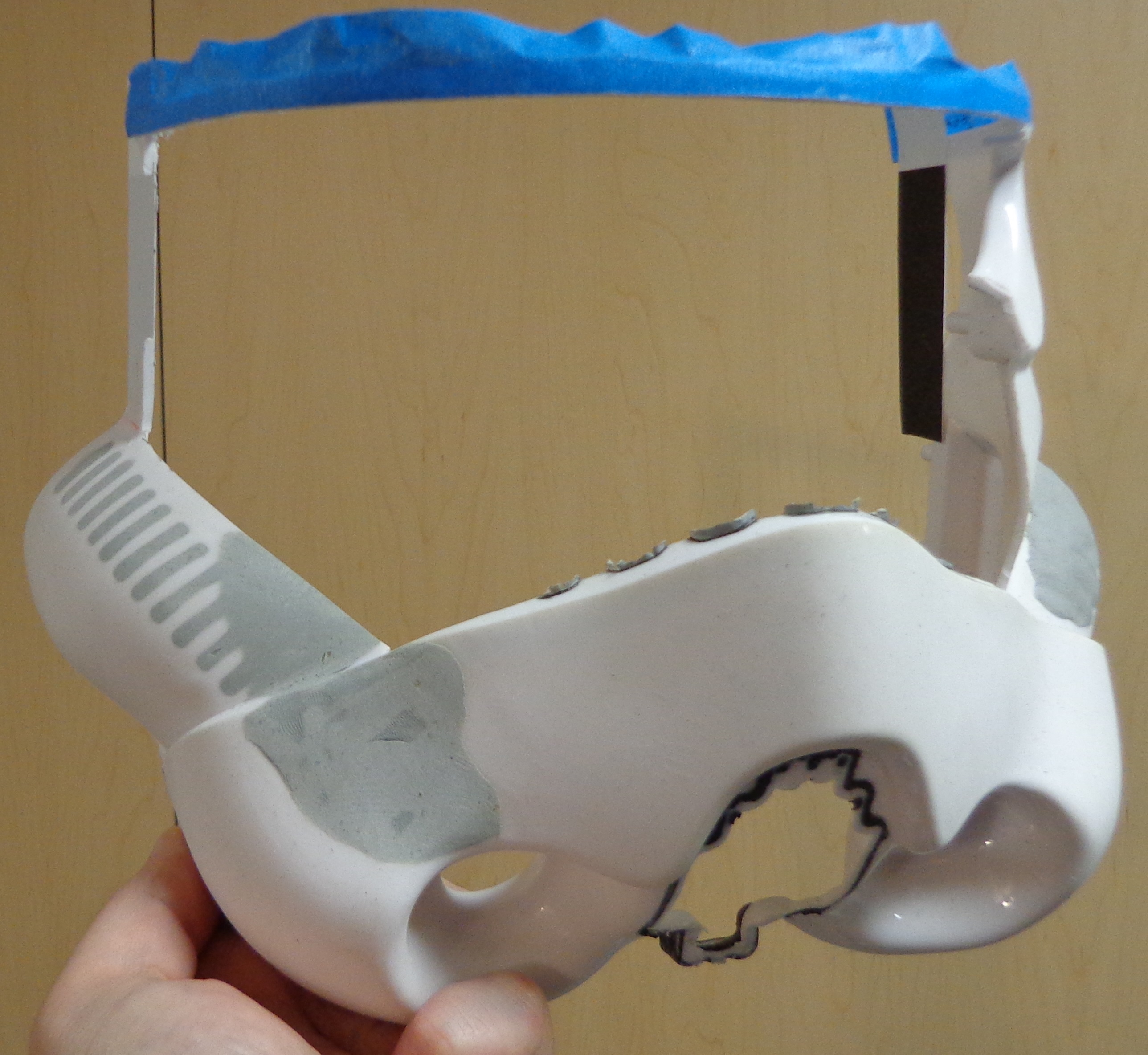

The faceplate got further butchery. The brow band got cut off entirely, and the tears and chin grille got cut out. I went back to my initial take on the tube stripes -- annoyance that they made them physical slits in Rogue One. So those are filled in and smoothed over, for good:
The lower return edges under the chin and around the sides are getting reshaped and extended to better match the originals (Stunt version, particularly):

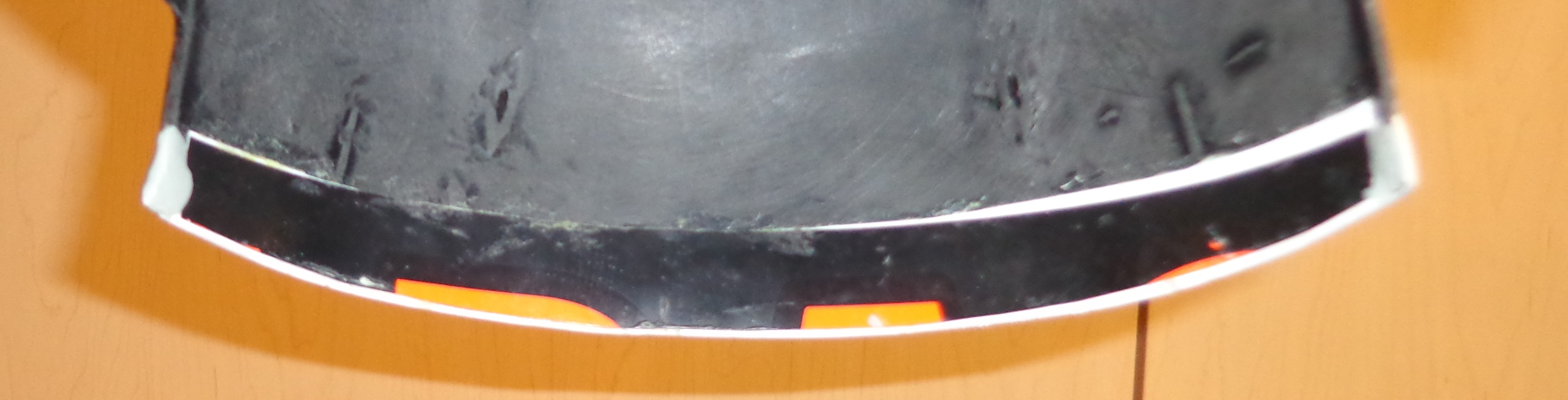

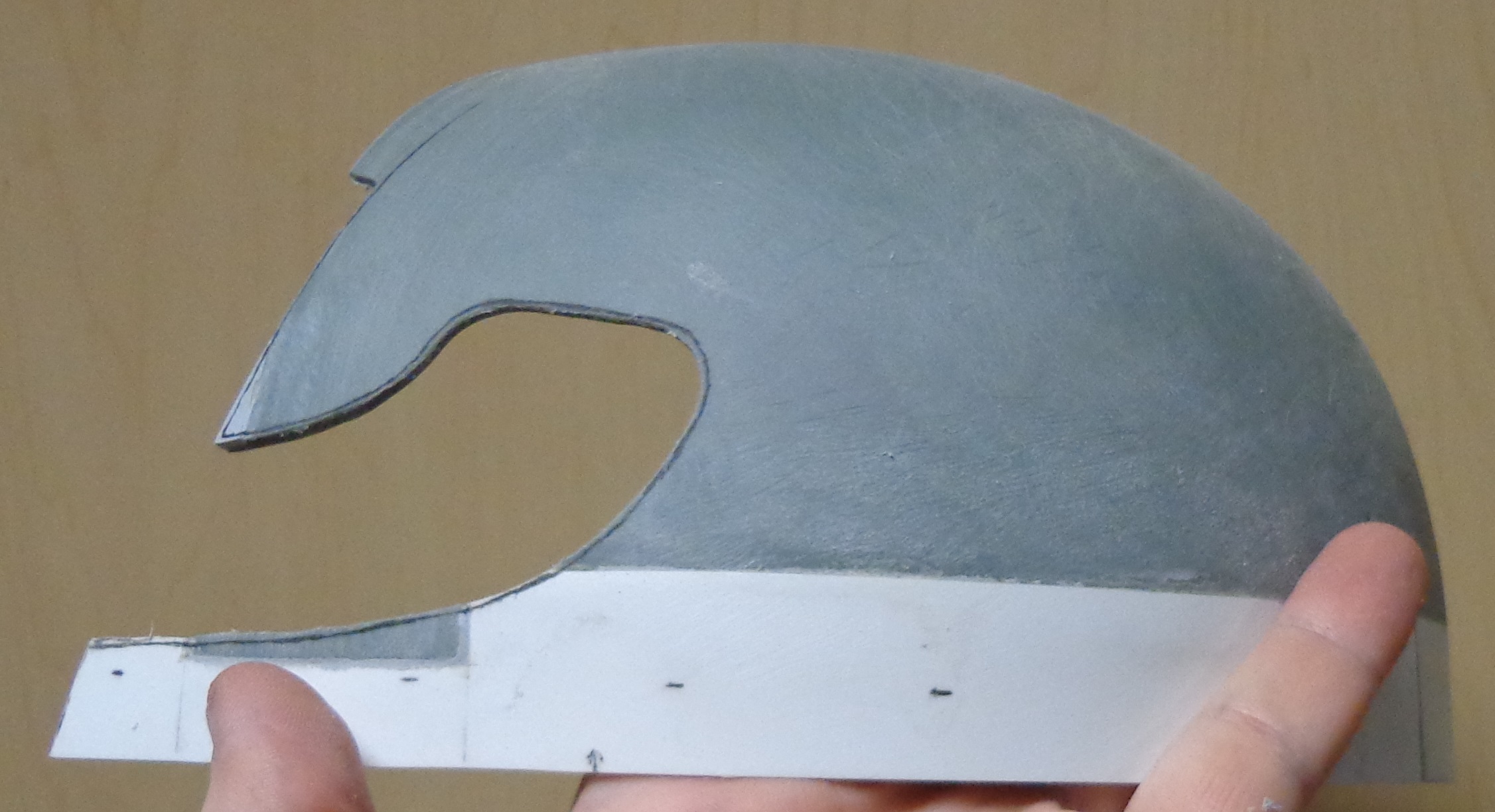

Jumping over to my second Shadow Trooper helmet, I can show how I better tackled the traps and extending the brow:
A decent amount of what time and energy I've been able to bend to working on anything has been getting all these up to the same relative points -- breakdown and discarding of unneeded bits, cutting out the traps and tears and chin grilles, extending the brow, tearing off the lower front rubber trim, closing everything up in the back, and grinding everything out where needed. Also accumulating the rest of the lenses and other bits and bobs for the interiors.

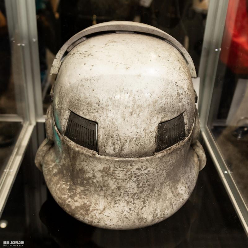

The fourth is more ambitious. To date, as near as I've been able to find, no one's done an accurate Legacy Stormtrooper. Not the one Jan Duursema designed when she created them, anyway. The only ones I've seen are derived from the interior art done in later issues by a different artist. What she designed is more like a mashup of an ANH Stormtrooper with a BARC Trooper, with other additional tweaks:
I'm merrily midway on my primary butchery...
With a good base to work from for the face:
...including a repositioned "nose"...
And, conveniently, the Solo style ear greeblies, flipped around, are quite a good match for the ones Jan put on these:

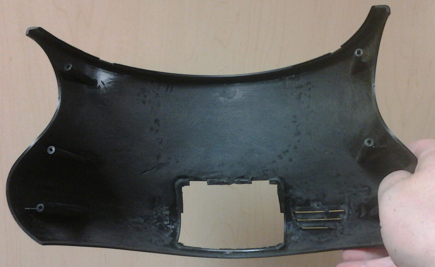

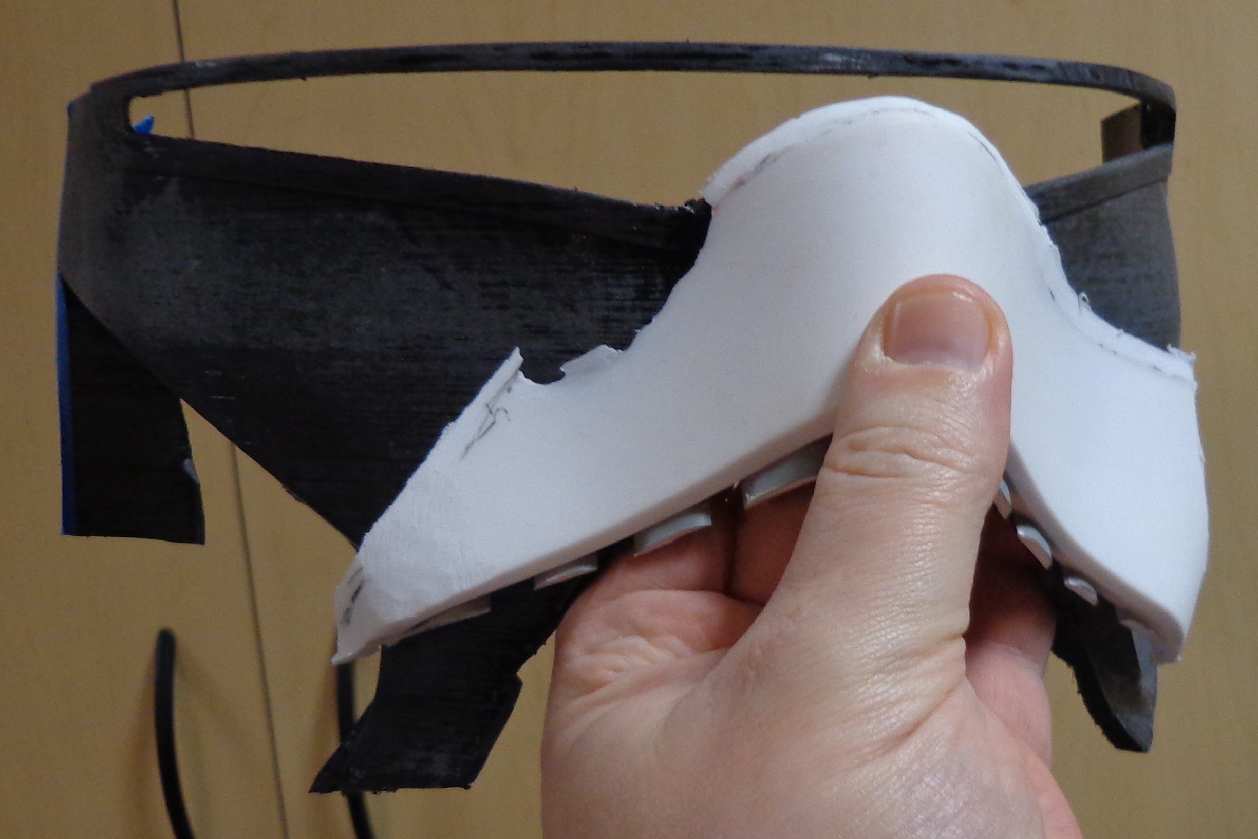

A teensy bit more, while I'm taking a break from kitchen stuff... Here's the best reference I have for the enhanced targeting housing:
Things I noted:

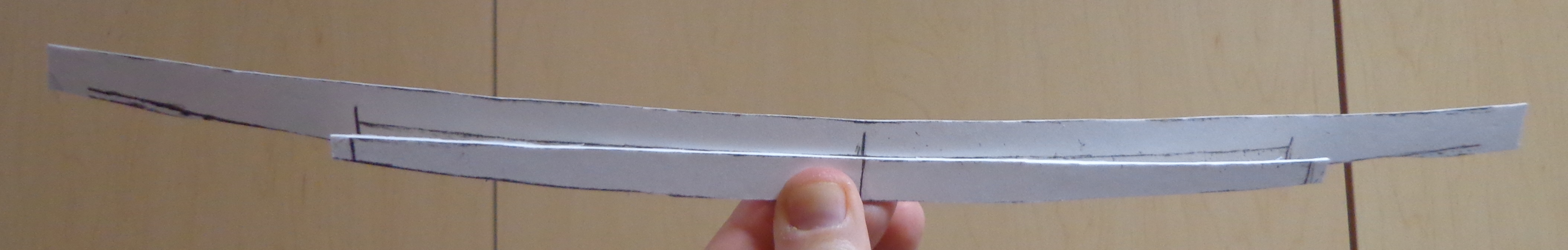

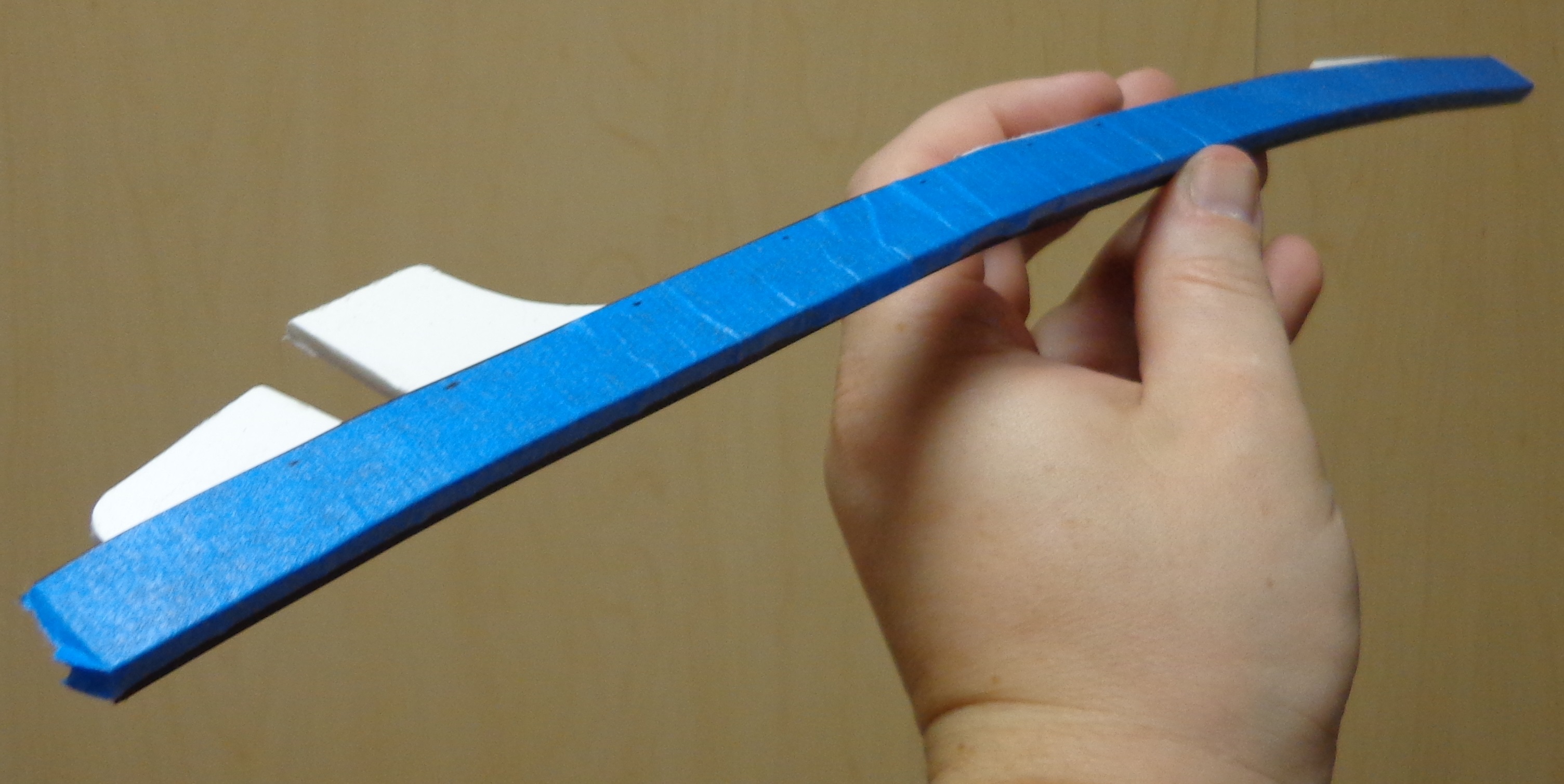

• Brow trim that is just a little shorter, vertically than the regular helmet brow trim. I have marked mine accordingly via photoscaling.
(The sintra chips are in there to hold the spacing for straight cuts.)
• Fun times parsing what's what in the undercut. The outer rubber brow trim is obvious enough. From the "bridge of the nose" between the lenses you can see the upper faceplate band and the rubber brow trim of the helmet itself, as here:

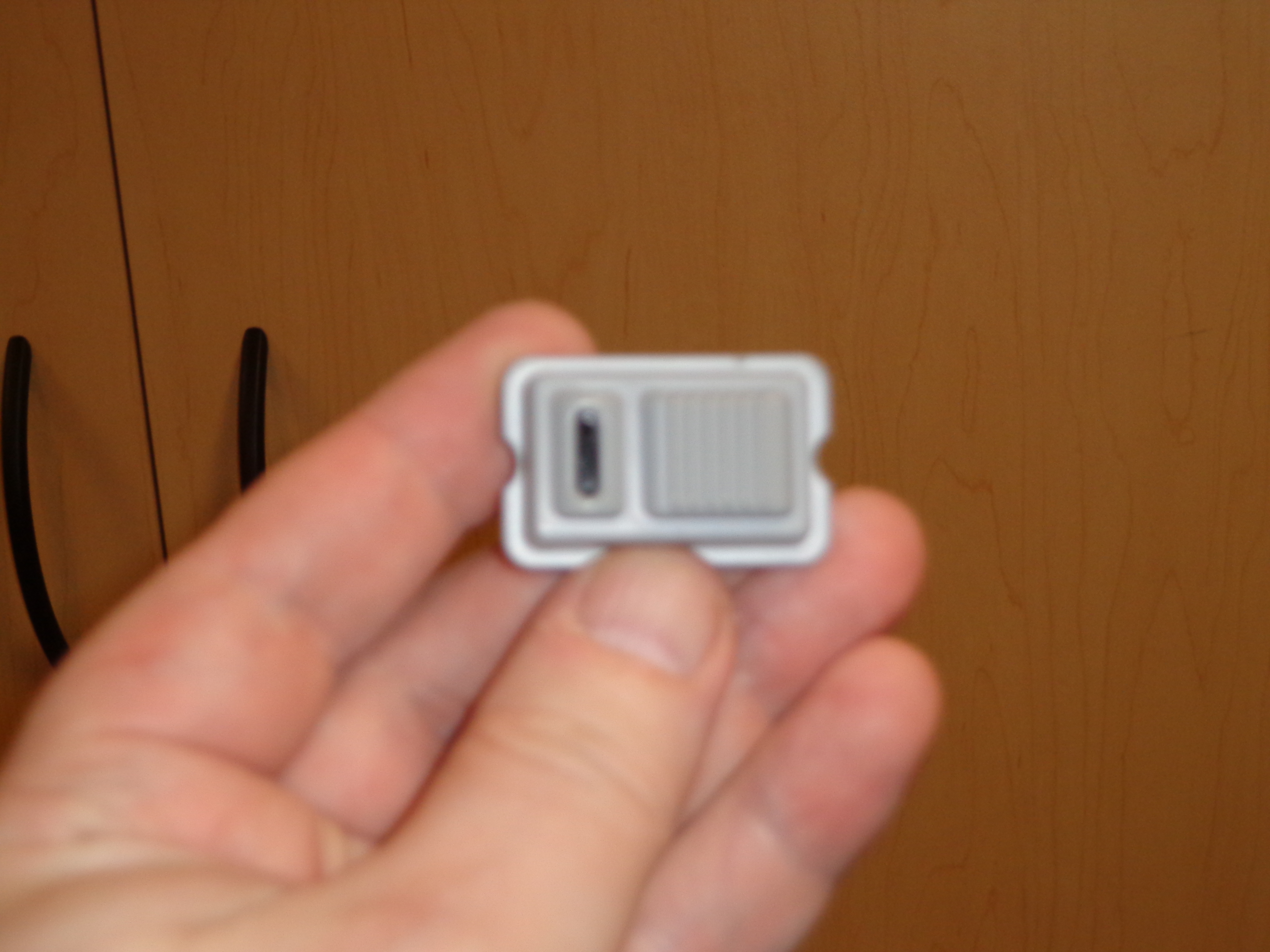

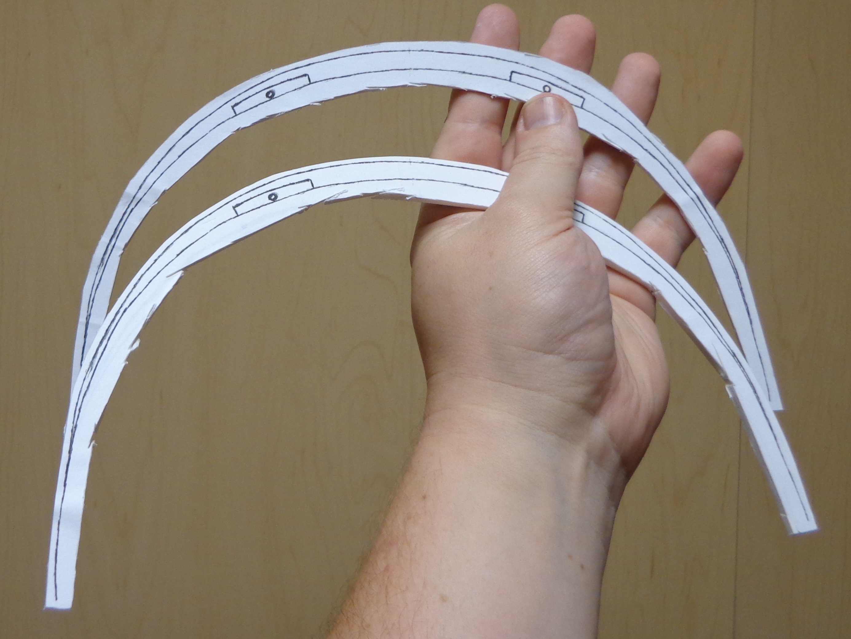

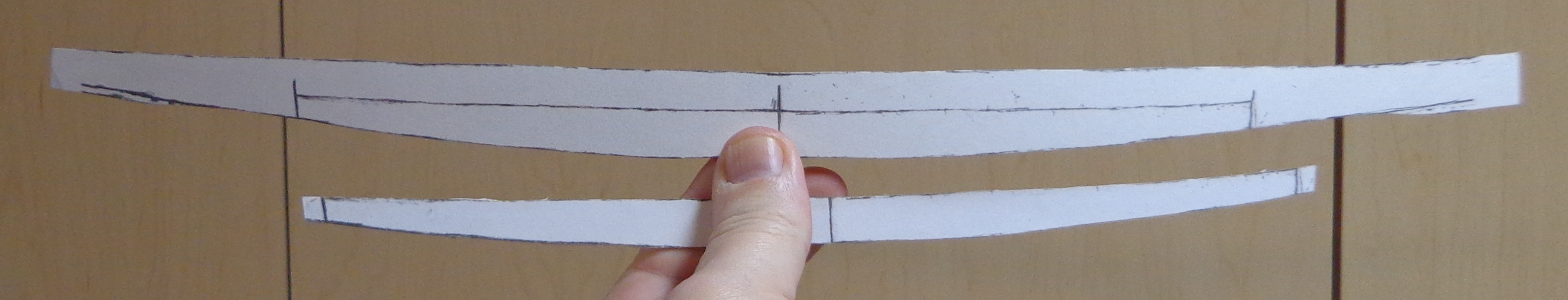

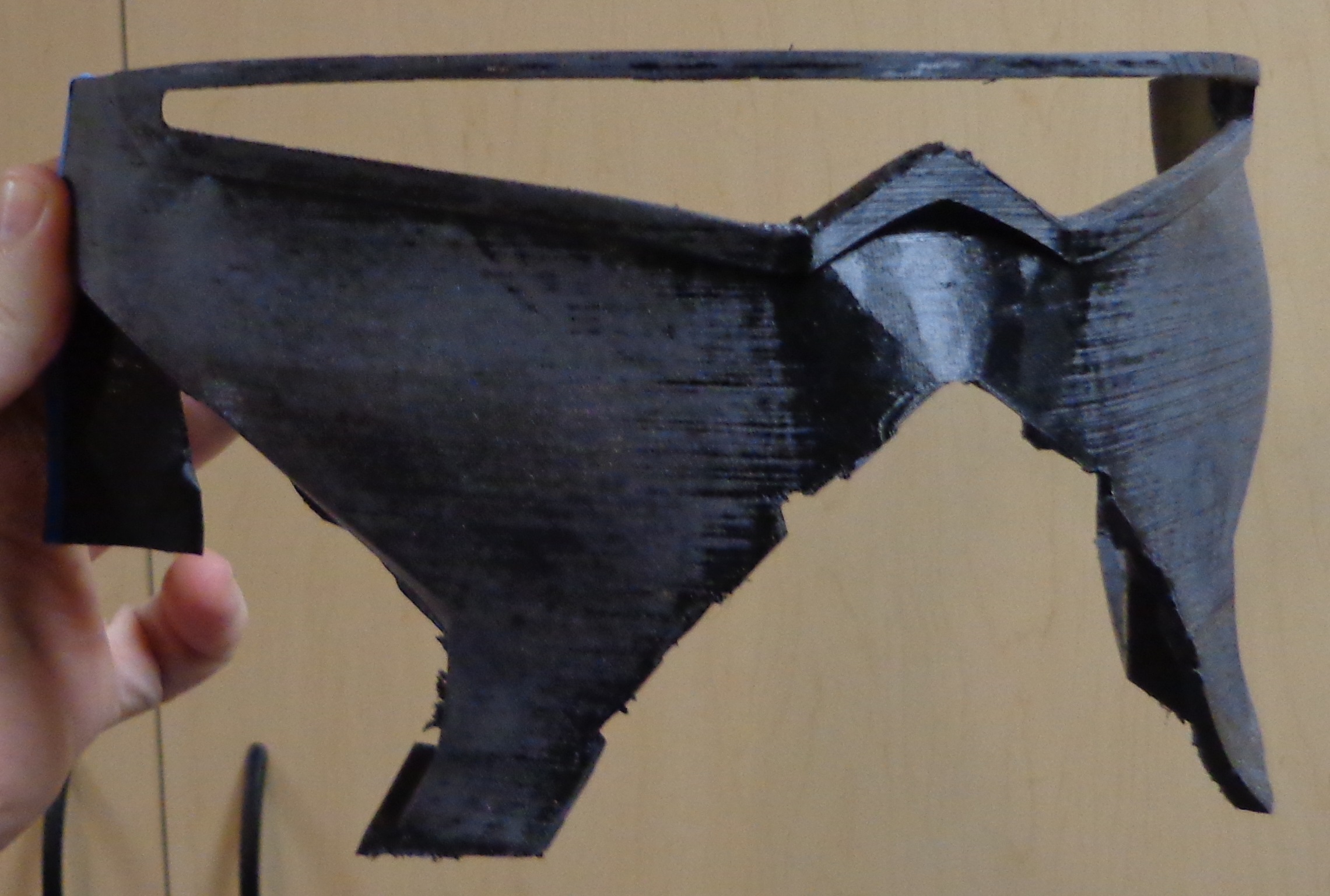

And between those is another thin crescent of material that comes down as far as the outer brow trim and has two rectangular cutouts with greeblies in them, positioned roughly in line with the lenses. I cut two crescents, one out of 1mm and one out of 3mm sintra, the latter to stack behind the former, after the notches are cut out of the thinner piece.
These will get fine tuned as they get attached to the inside of the forehead shield, and I have these to stick in for the greeblies:
I have built up the oval mounting lugs, as well, but don't seem to have pictures of them uploaded yet. I'll get on that. Which leaves the back edge of the forehead shield. Assuming Anovos' prototype is reasonably accurate to the film prop, which we never see clearly, this is what I'm aiming for:
...And is where I'm currently at with layout and fabrication -- marking the shield's approximate position on the helmet dome, creating a cutout template out of cardstock at that point, marking the outer face of the shield, measuring and marking where the inner face is, and figuring out the geometry and spacing. And what the heck to stuff under there. Those three spacers are obvious enough, and the gaps indicate they're part of the array, not attached to the helmet. I plan to employ magnets there. The stuff down around the side lugs is harder to make out, though, so that's going to be some experimentation and error.
