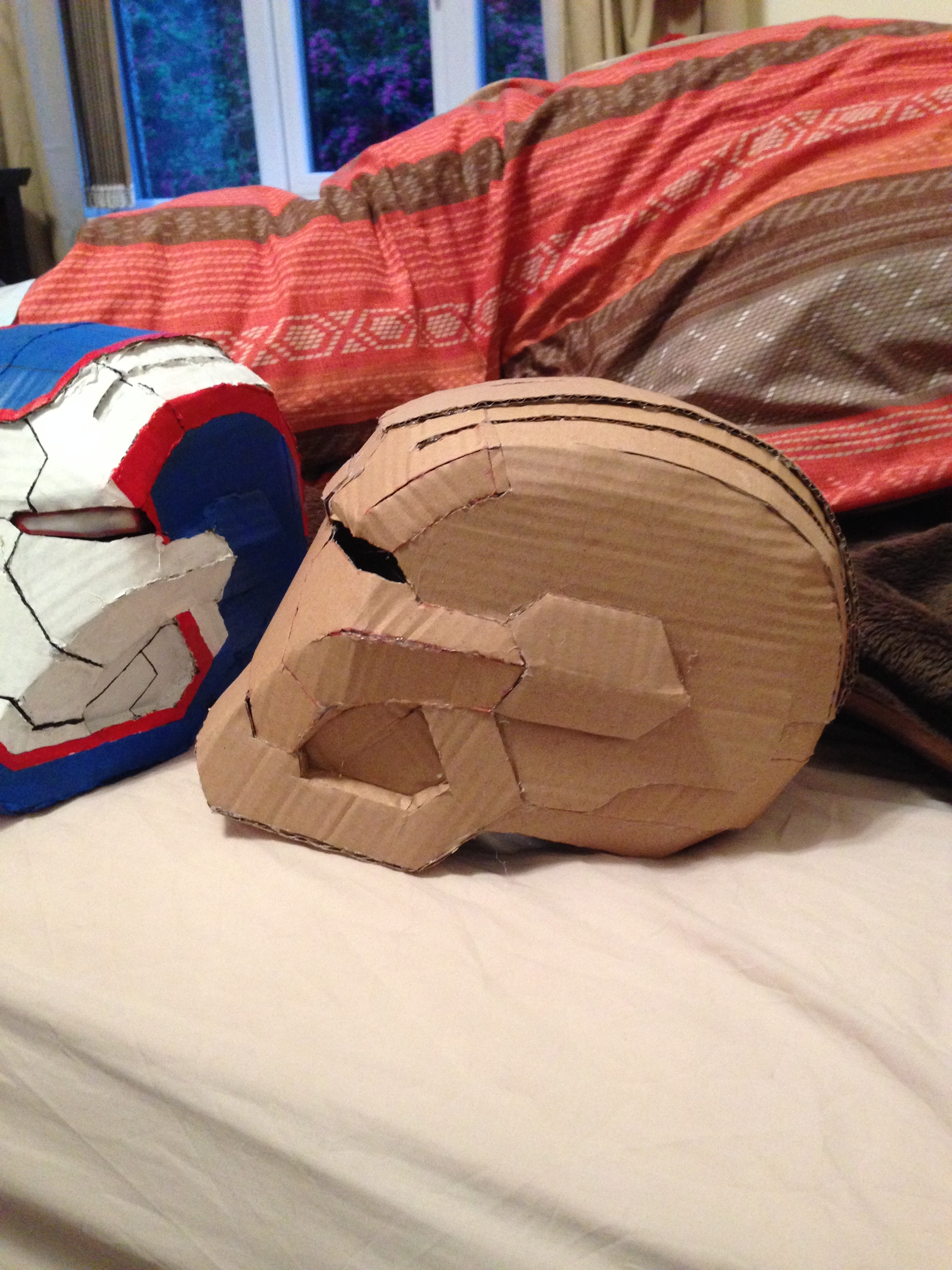

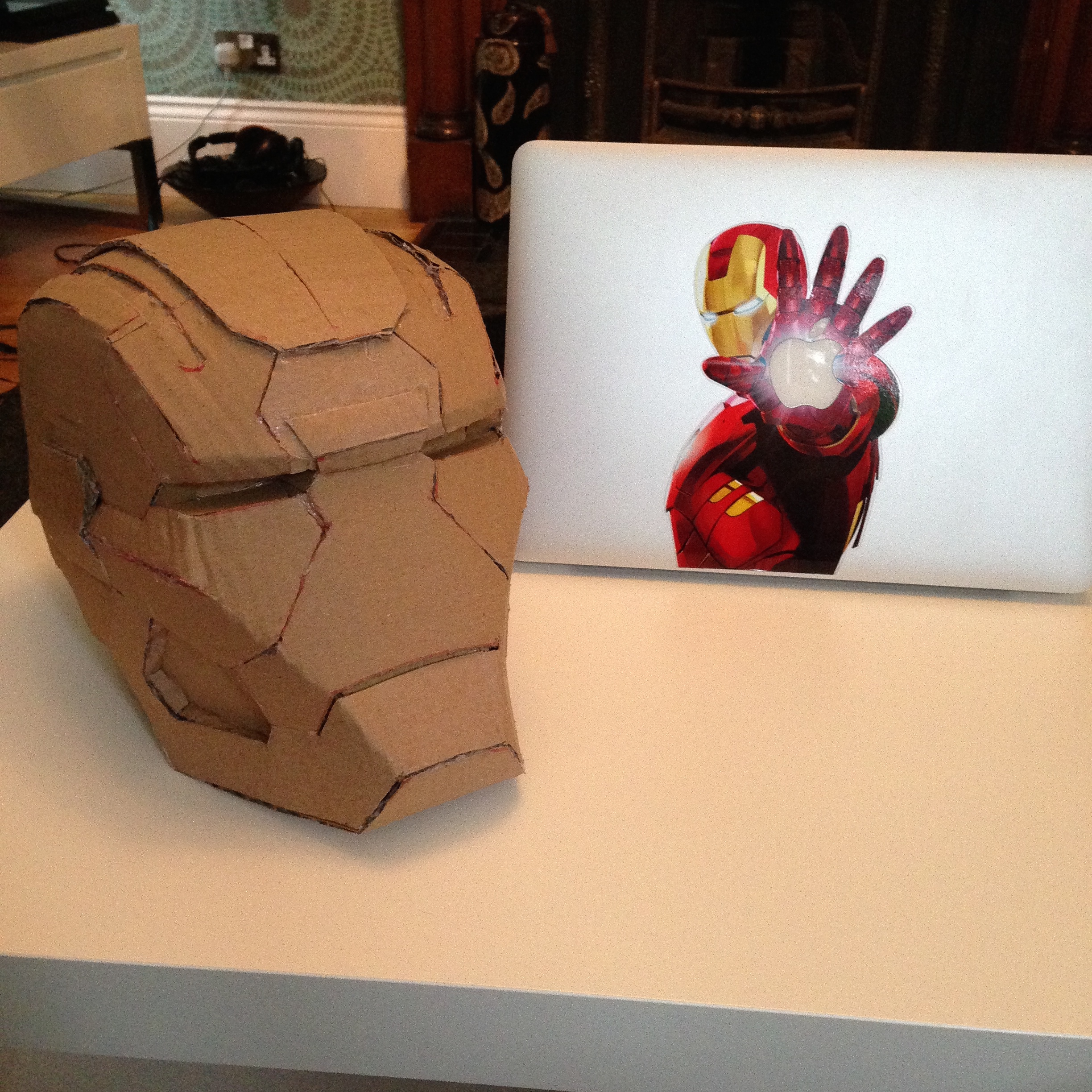

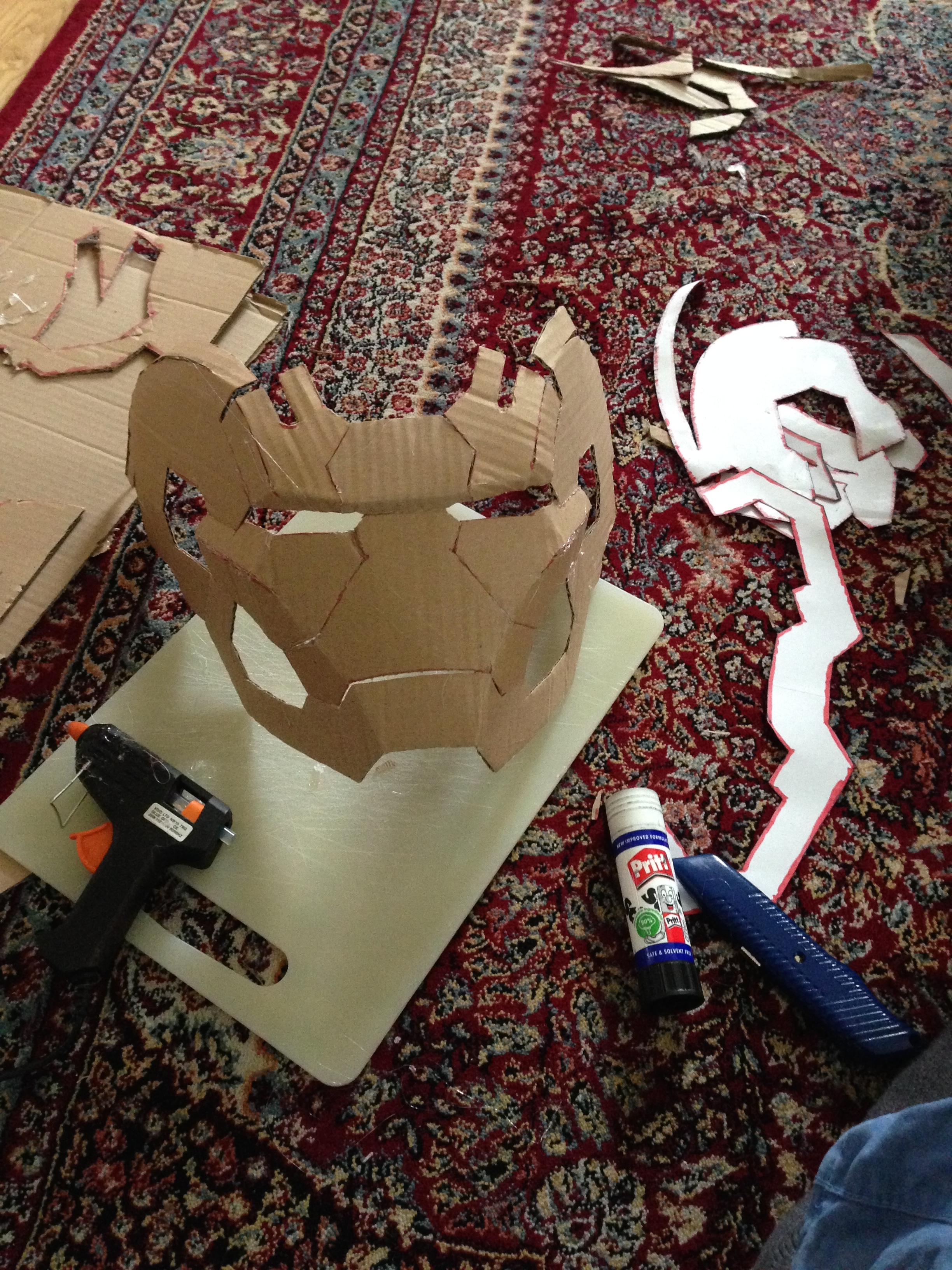

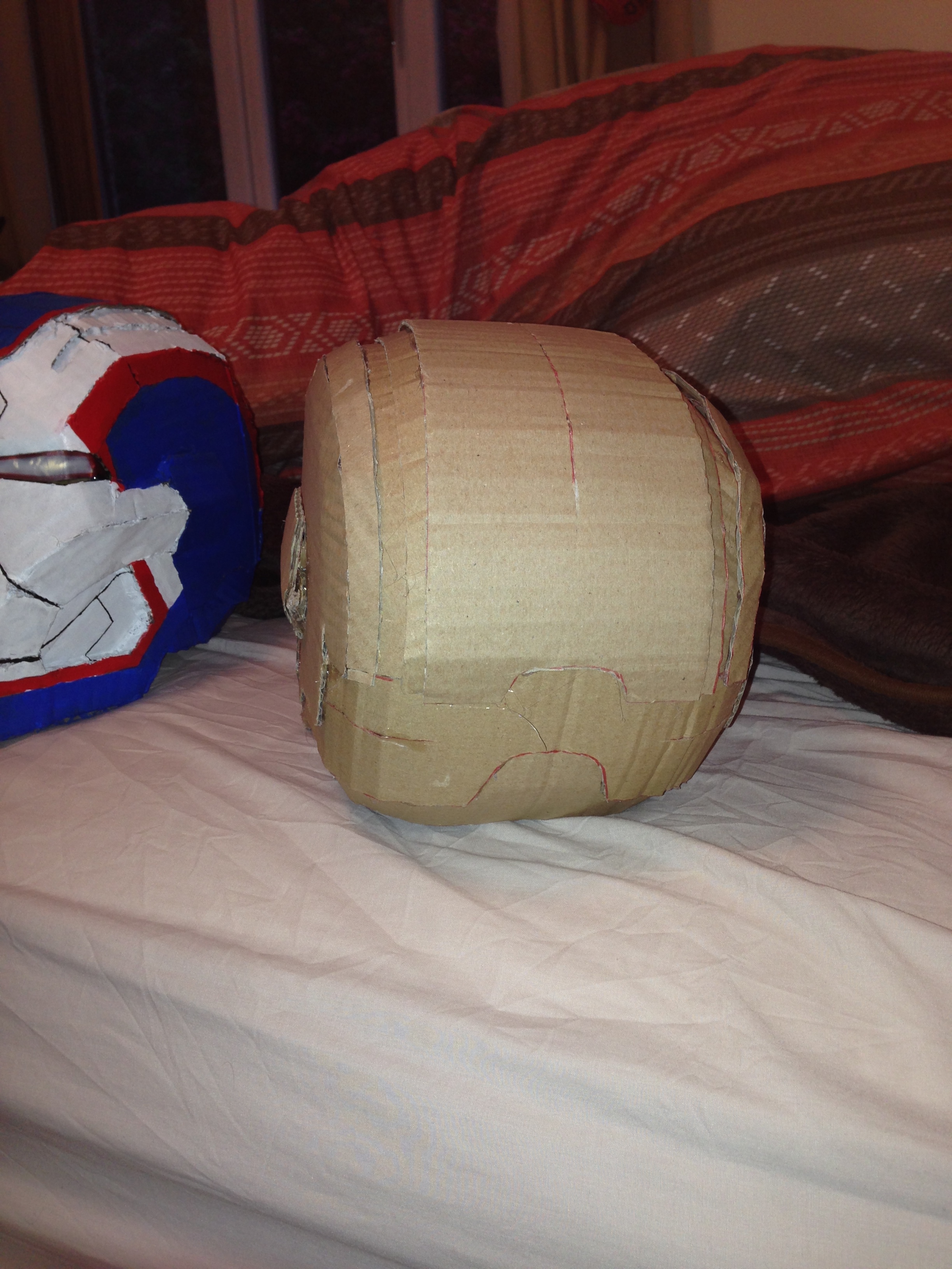

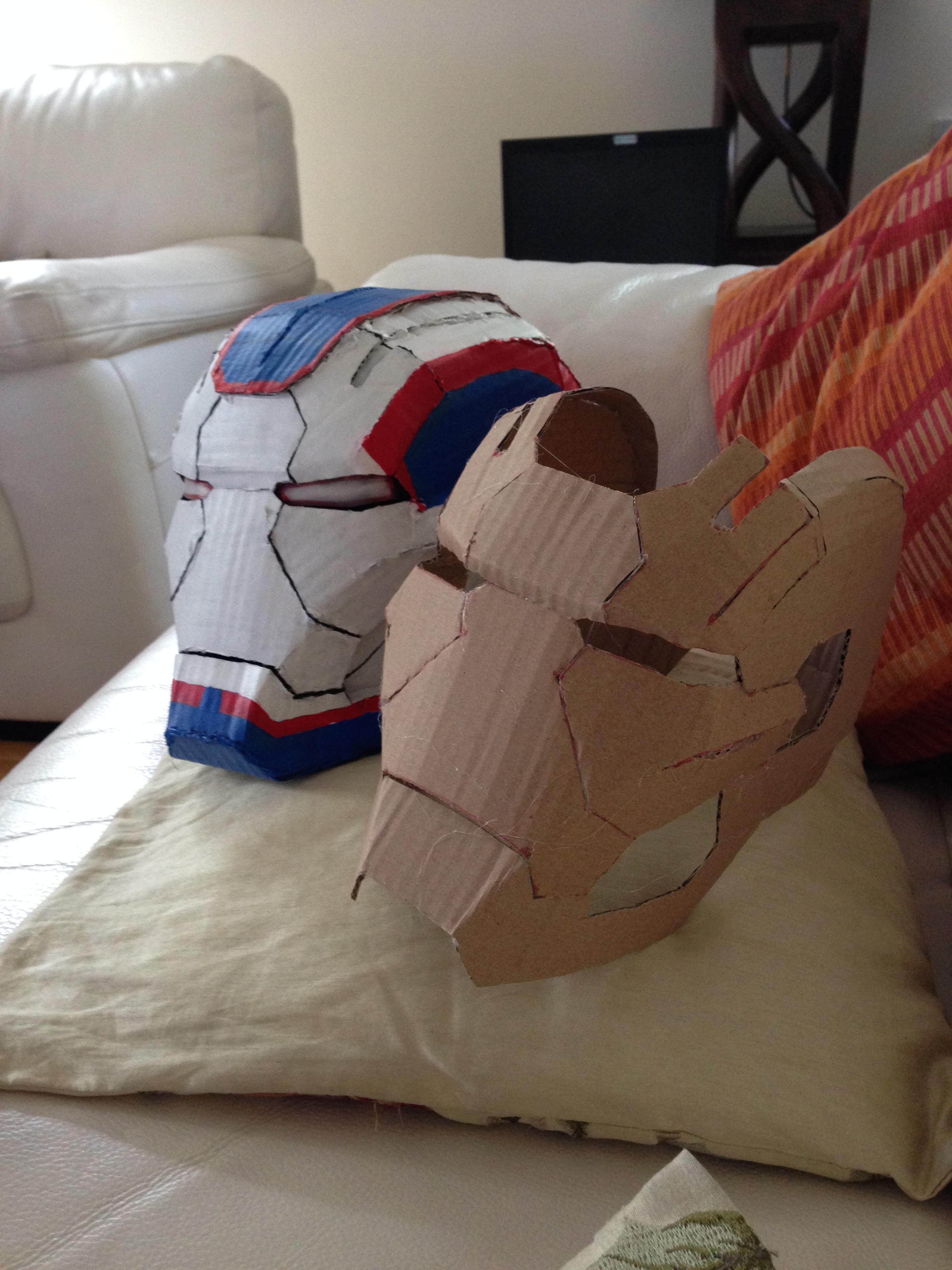

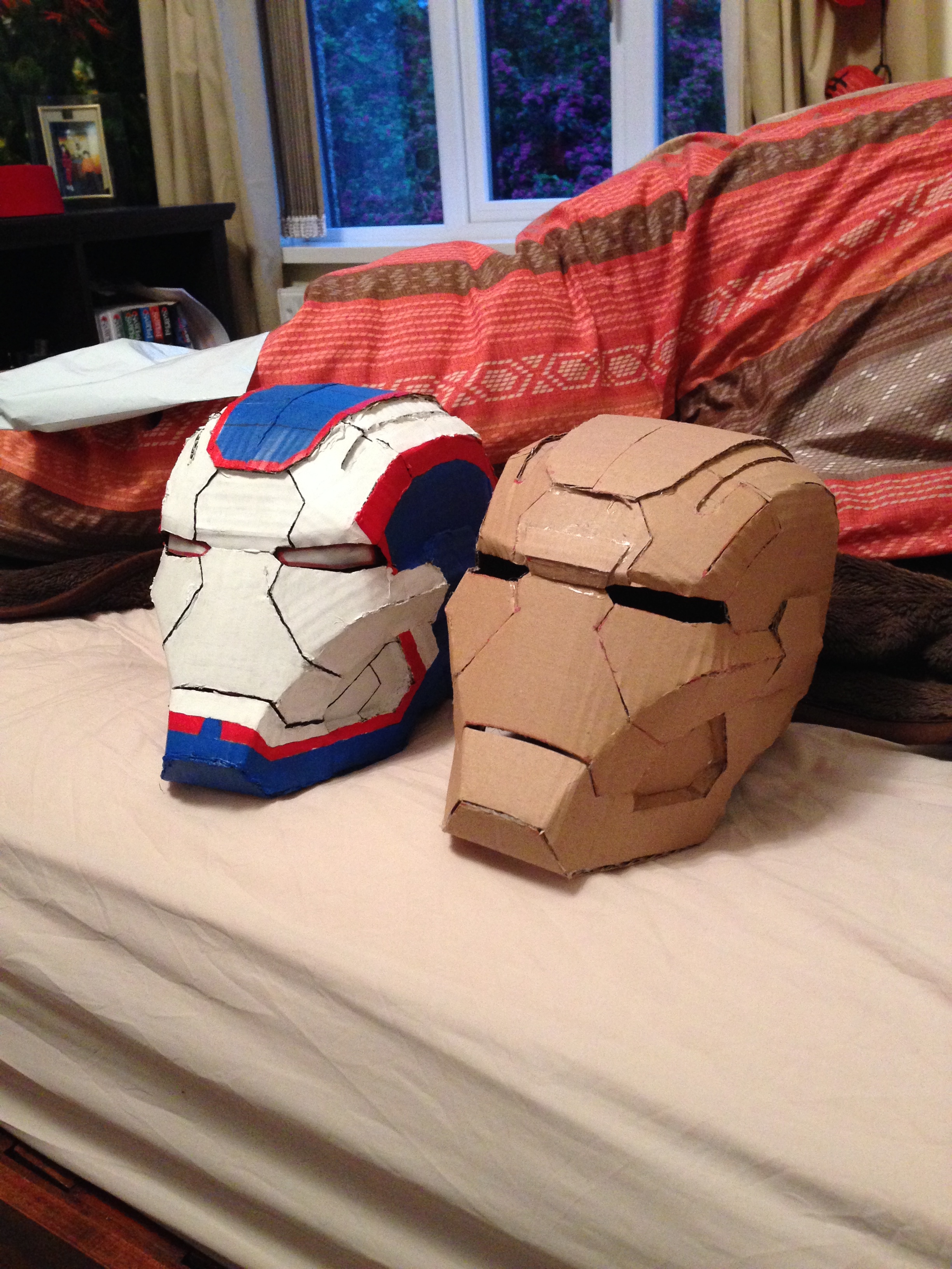

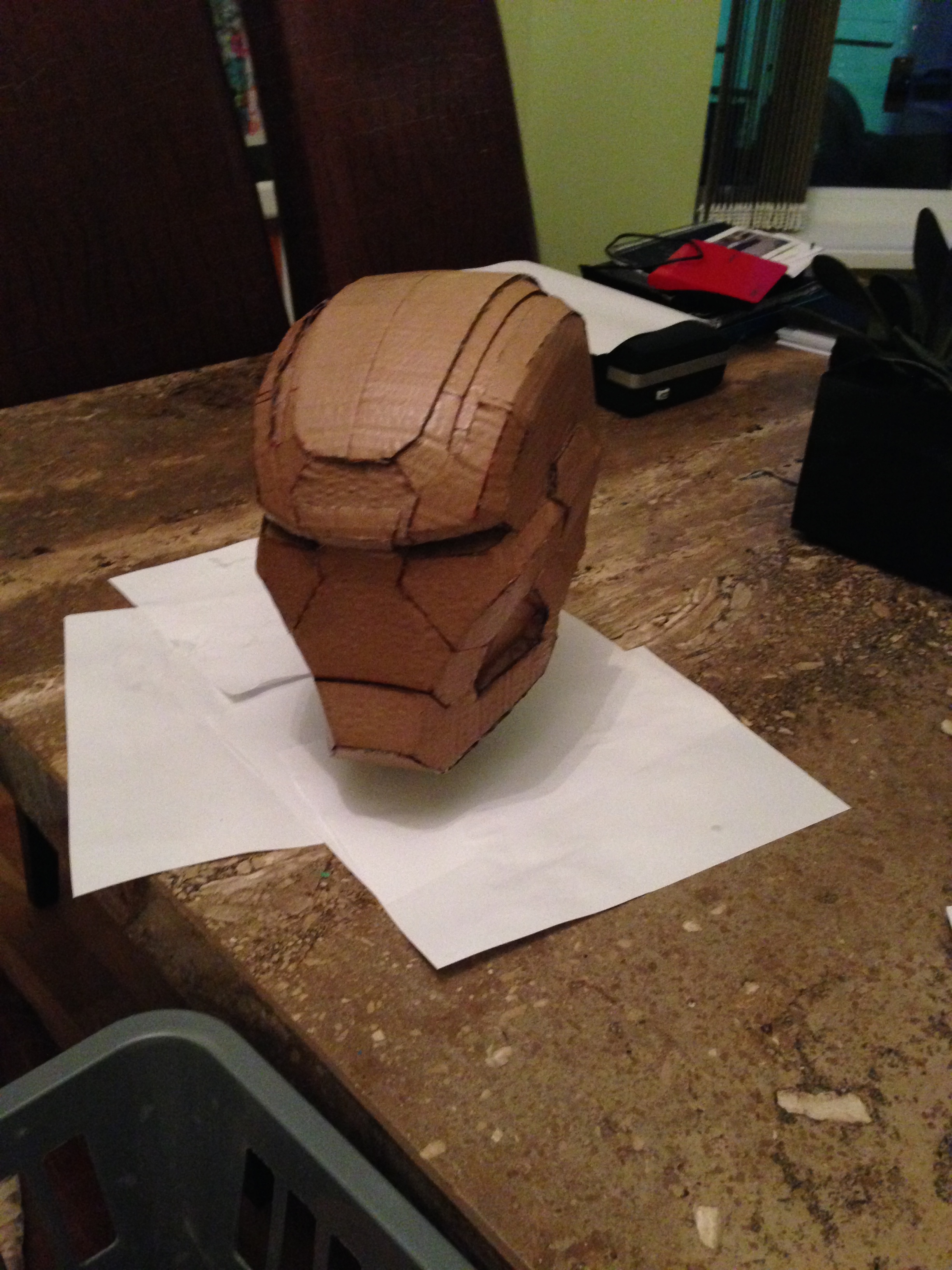

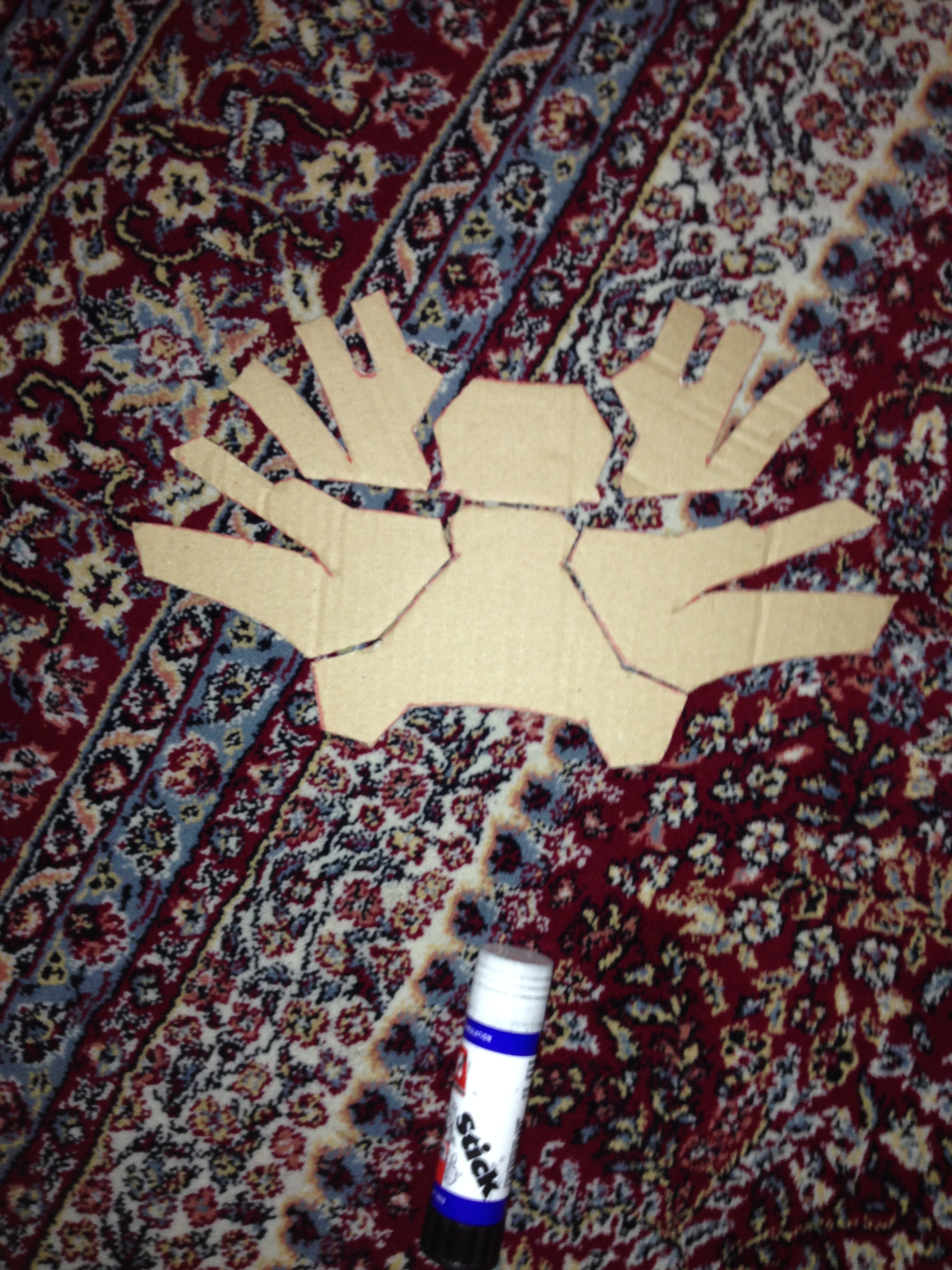

well I'm going to make an Iron Patriot helmet from cardboard, fibre glass and bondo. I have made a helmet before with these materials and frankly the finished product was very rough:eek So this time I am going to use what I have learnt from before and this time produce a beautiful Patriot helmet!

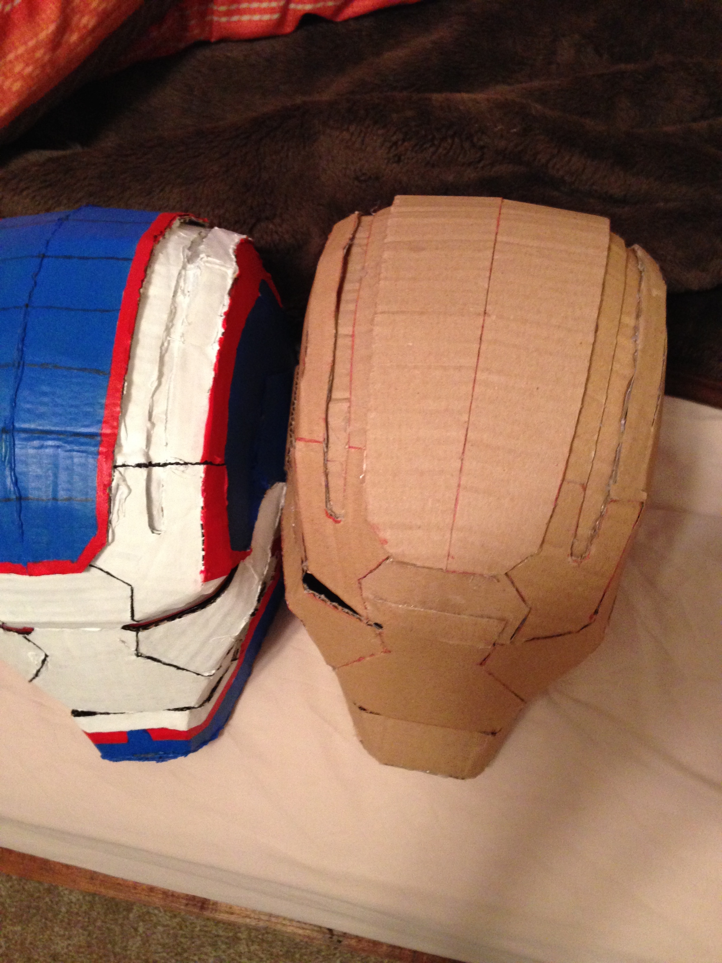

Last night I got to cutting and sticking the cardboard sections together (I had already cut out the paper templates from before) and I think it's looking pretty good so far; if you think anything needs adjusting or looks odd, please let me know, I want this helmet to be great! (The other Patriot helmet that I made is simply cardboard and acrylic paint)
pics so far:
IMG_4322.jpgIMG_4323.jpgIMG_4336.jpgIMG_4339.jpgIMG_4340.jpgIMG_4341.jpgIMG_4342.jpgIMG_4343.jpg

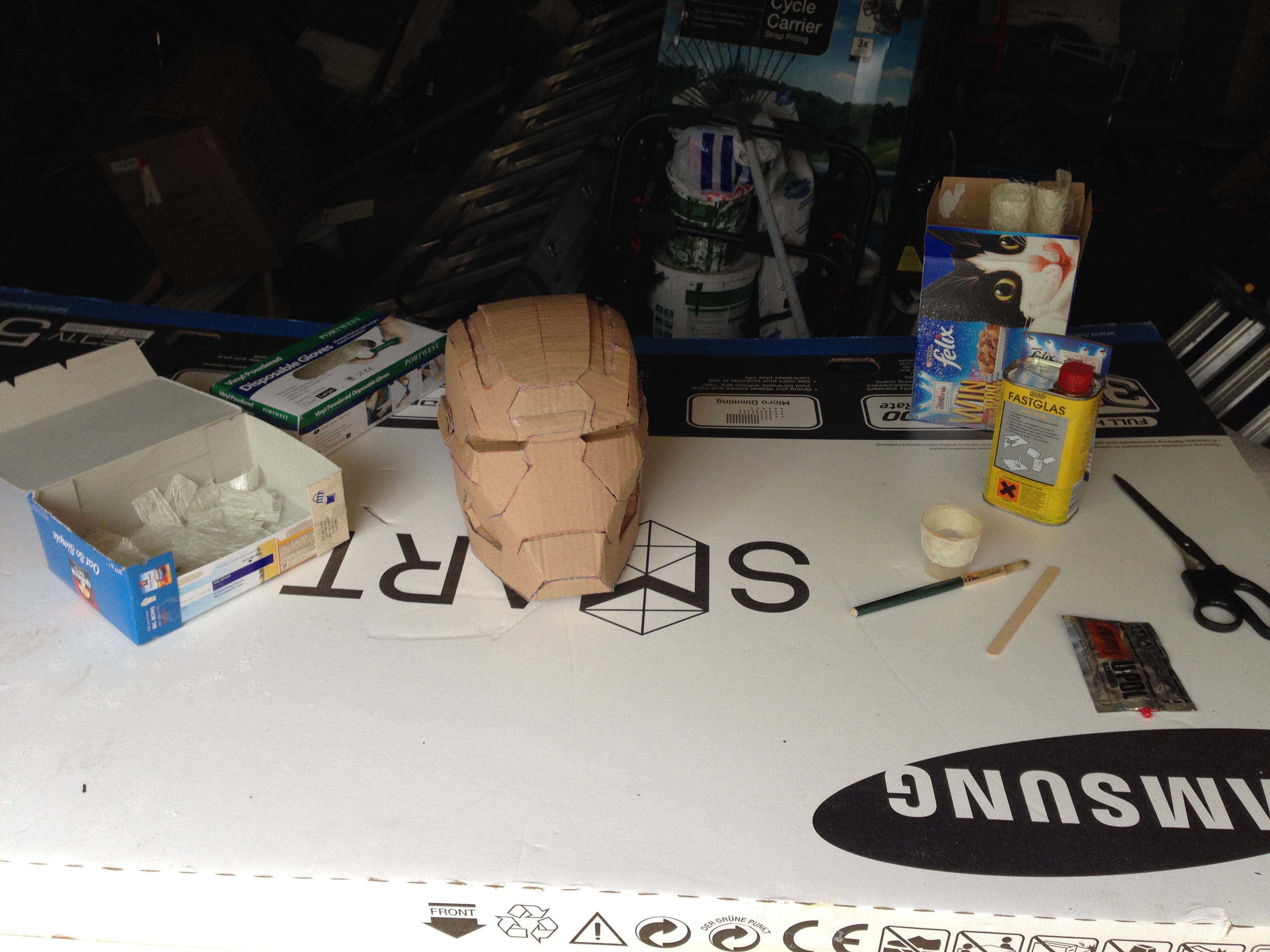

today I got a bit done, did the inside of the eyes and mouth with cardboard to help keep things nice and tidy for fibre glass which I will hopefully do tomorrow.
Got the fibre glassing done, I'm only doing one layer otherwise it will become too heavy and probably also too tight for my big head!

Oh and does anyone know if I am supposed to harden the outside of the helmet at this stage? I have ran out of resin, so could i use PVA glue or something?
Subscribed! This is really cool i resined my deathstroke helmet inside and out before I fiber glassed but I bet Pva glue will work just fine
- Gavin
Its recommended that you coat the outside too, so the outer layer doesn't cause any problems with the body filler stage by keeping the surface sturdy
Thanks for the input guys! I think I'm gonna go ahead and put a couple layers on the outside of the helmet because it is still soft cardboard after all:rolleyes

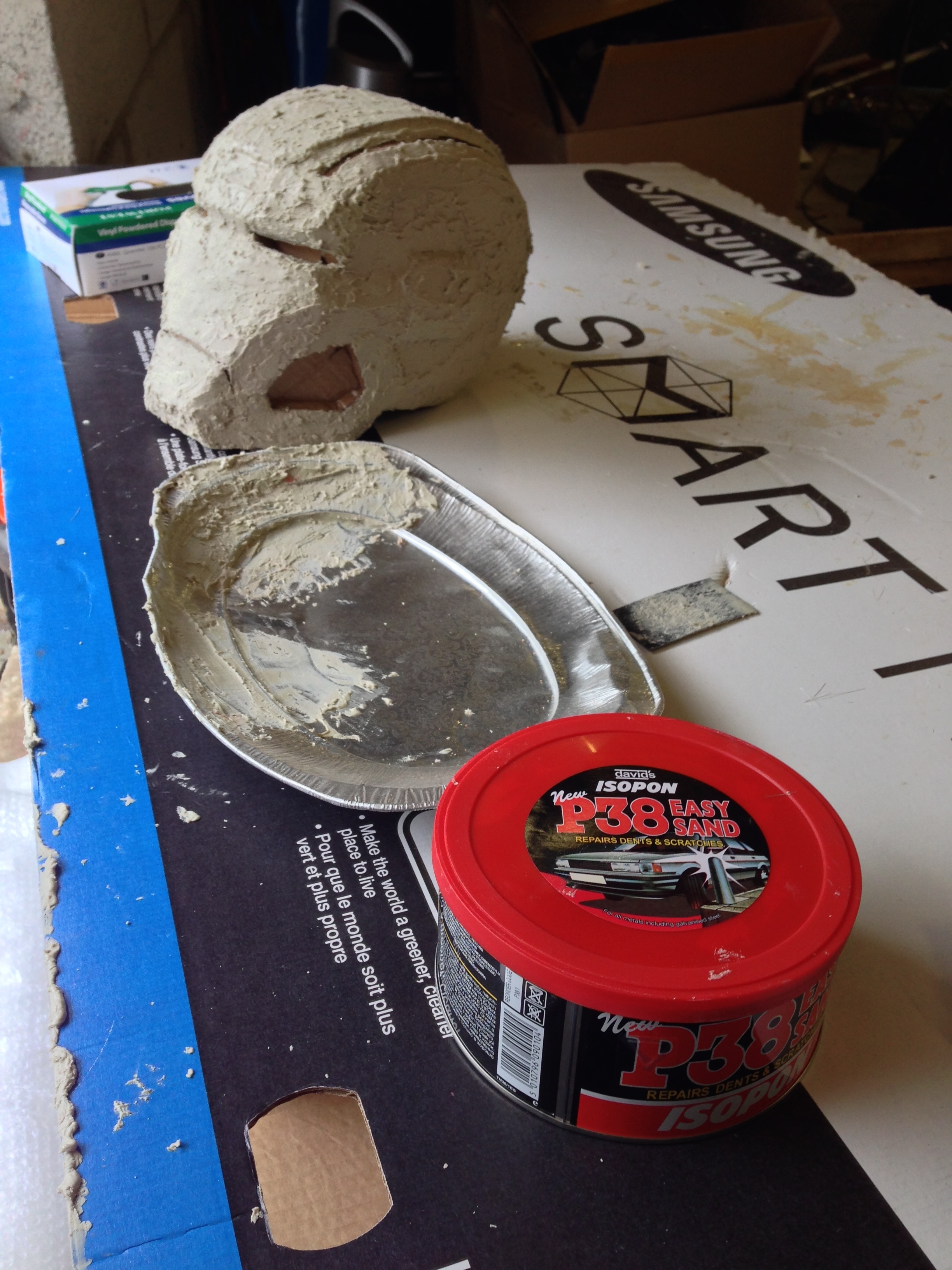

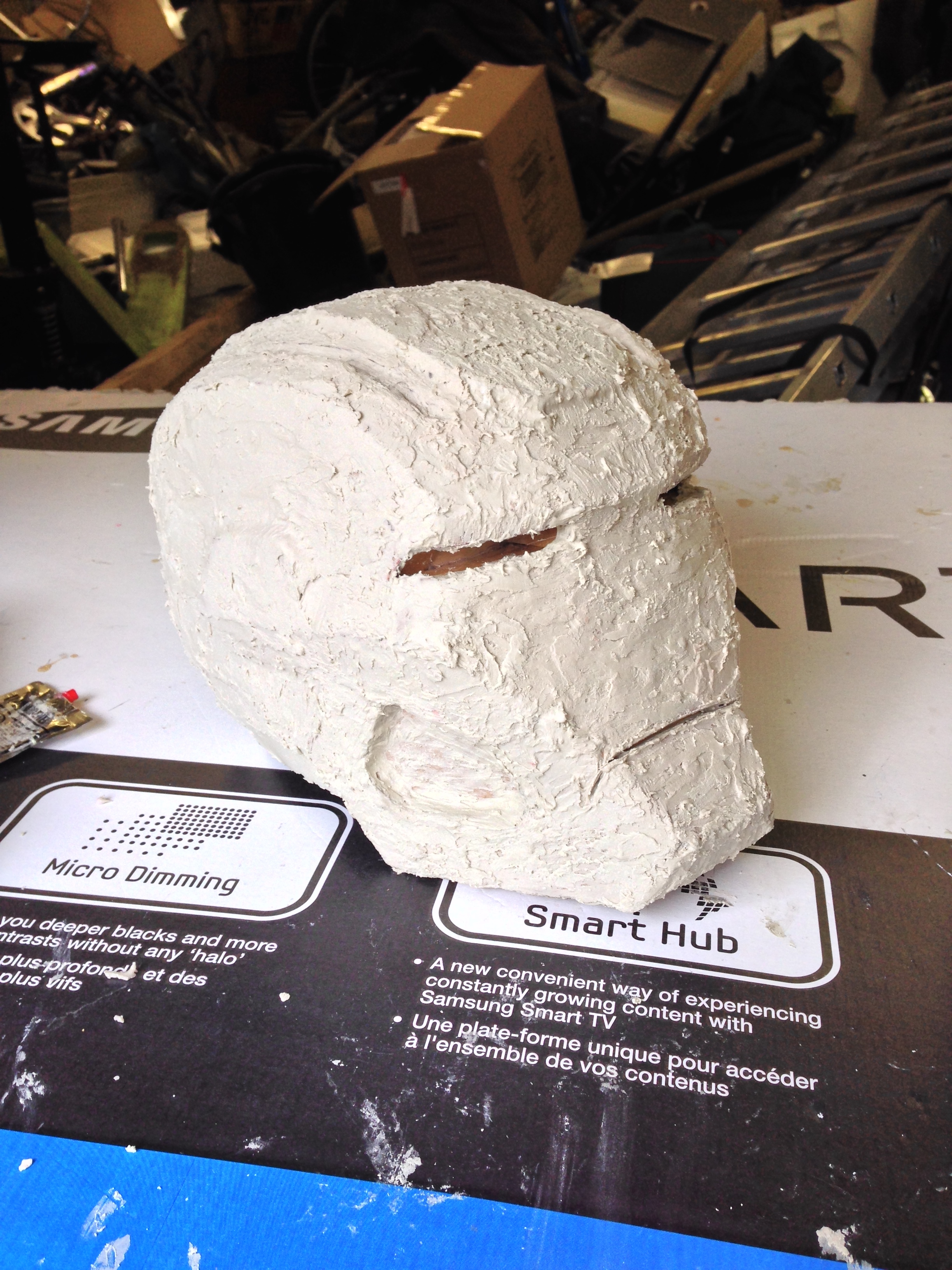

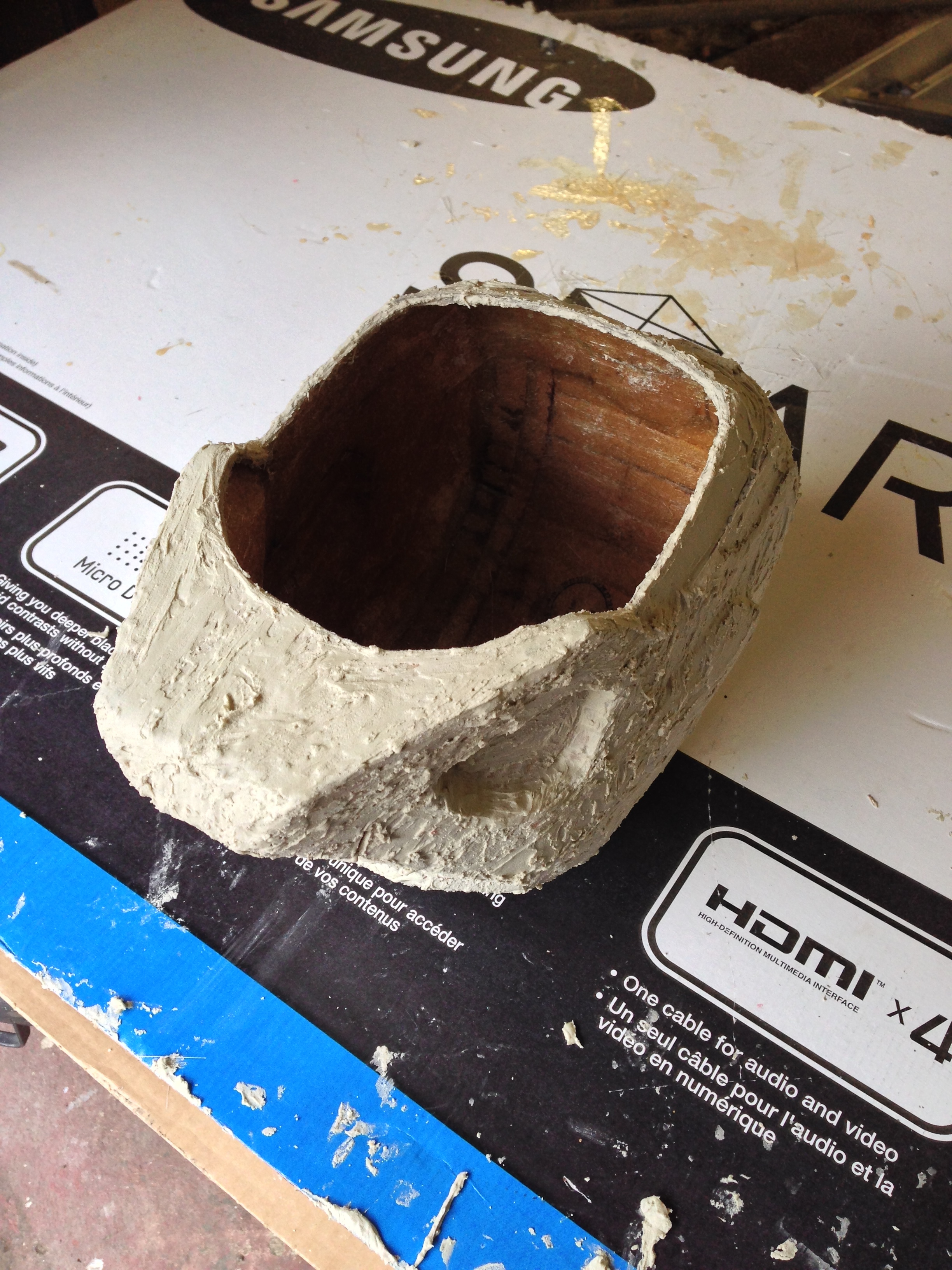

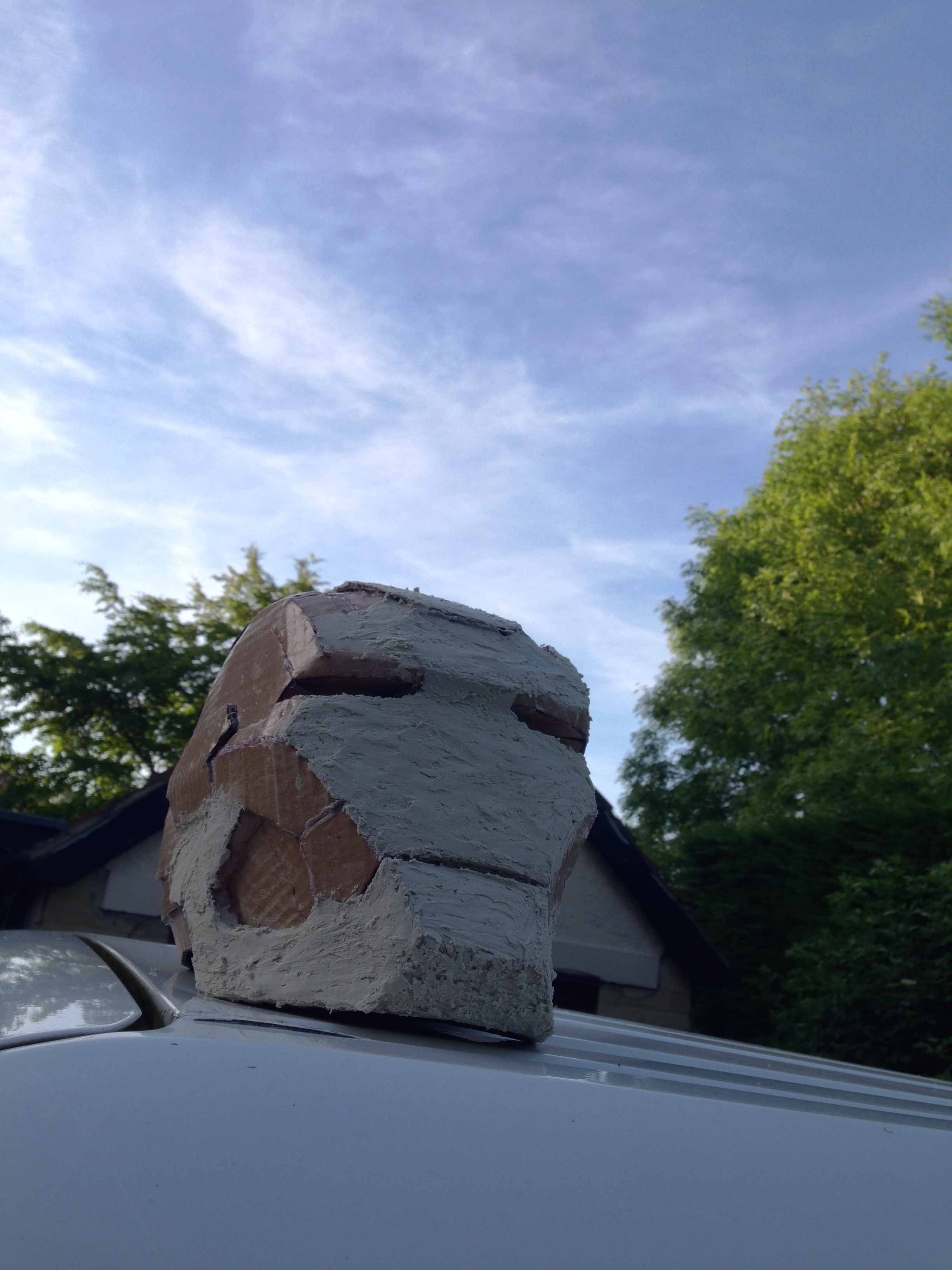

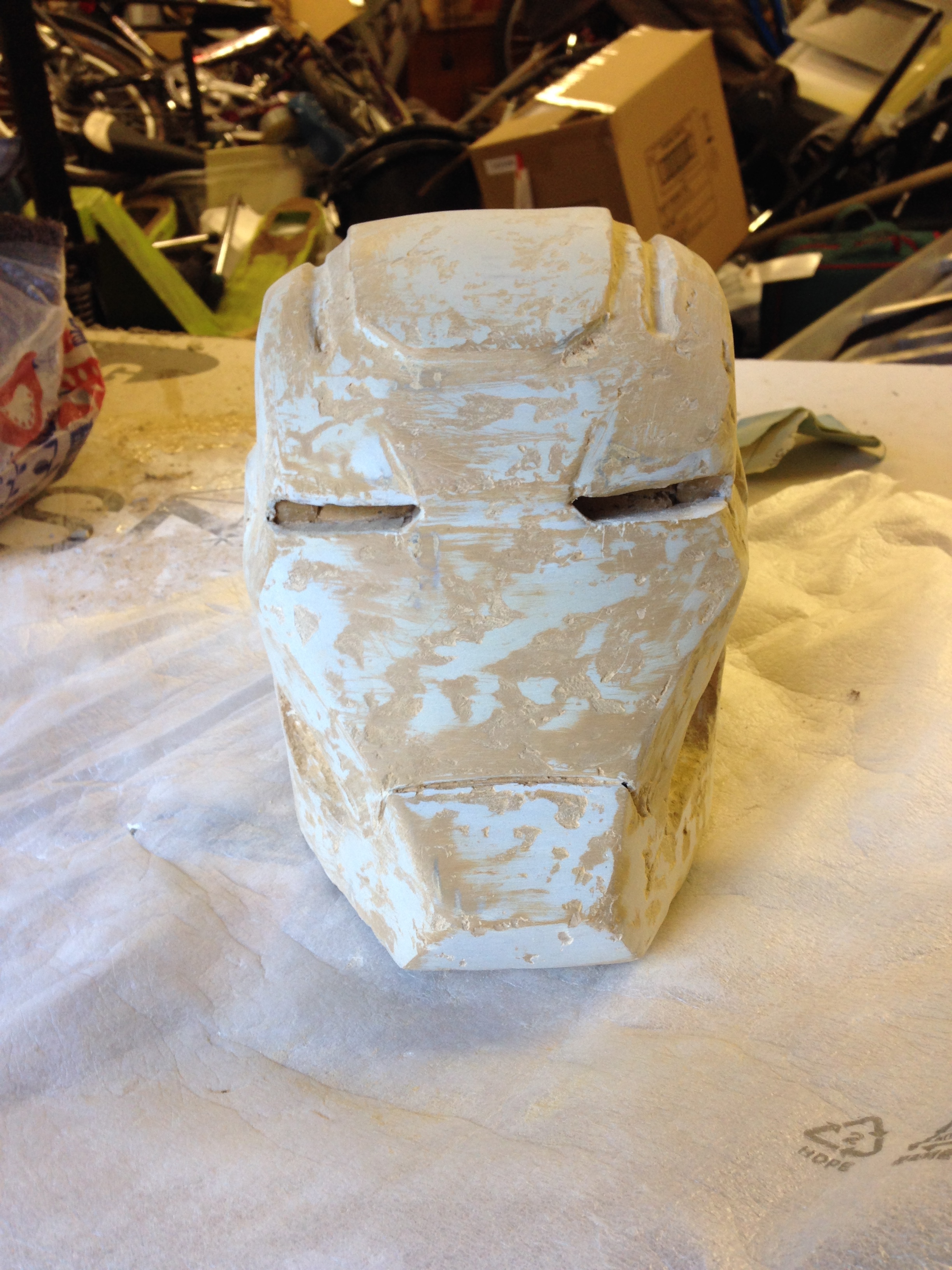

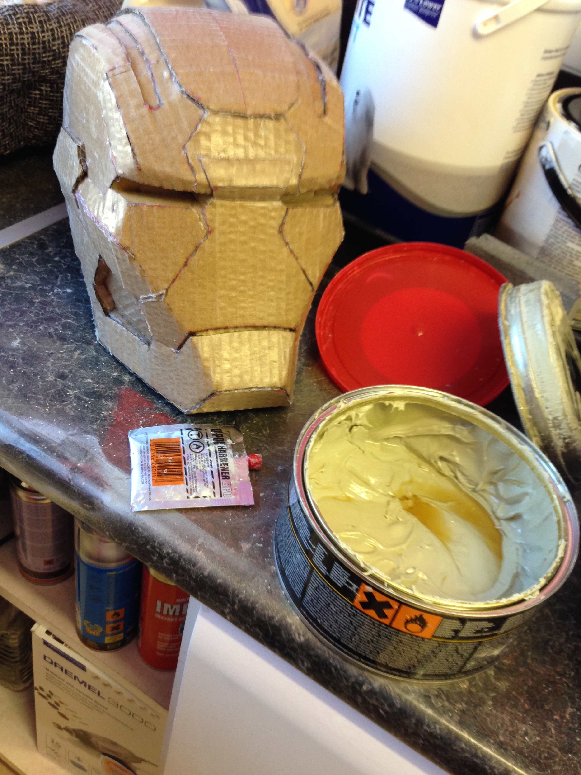

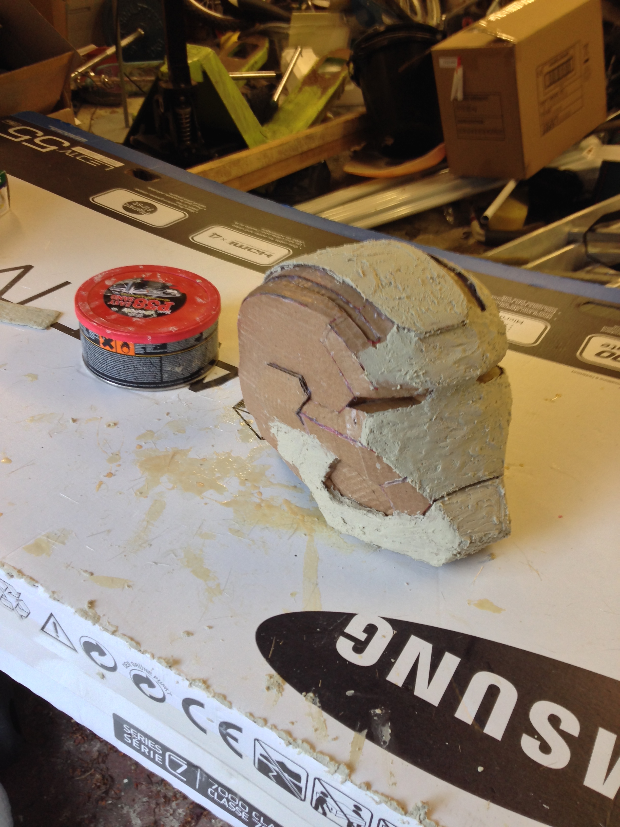

Ok well today i've got a bit of bondo onto the helmet, (this is the part i hate the most). I found some difficulty applying the body filler- it is quite stiff and doesn't spread very well, is this because I've had the half used tub for 9 months? probably, I'm gonna need more. Anyway, the pics show you what i've done so far :wacko
pics:
Hi, what ration hardener to body filler are your using? I've also found that when I work with the body filler in cooler temperatures, it tends to be have a thicker consistency, but not really that it "gunks" up on me.
Sent from my iPad using Tapatalk
Sorry, meant to ask "what ratio" not ration...
My ratio is about right, one pea size hardener for a golf ball size amount of bondo. its been quite warm lately here in England too :p
I can only put the thickness of it down to the body filler being several months old and perhaps not the best for such detail. I'll just buy more and hopefully it will be fine!
I'm going try and get the rest of the 1st bondo layer done in the next few days.

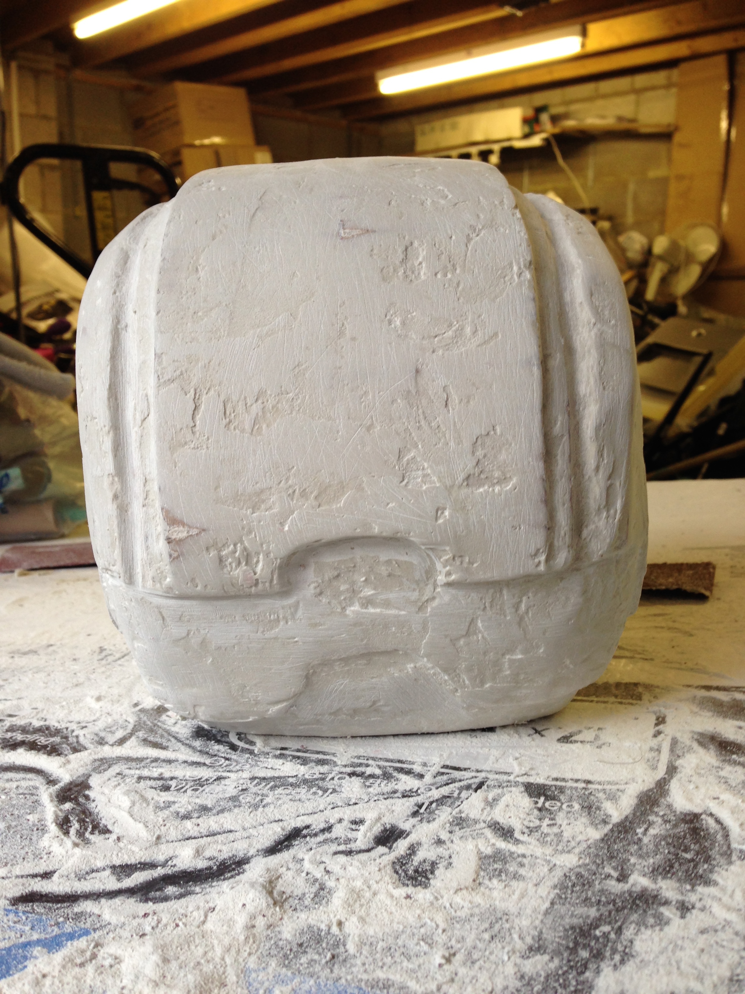

So I bought some new body filler and it was definitely easier to use! I got the whole helmet covered with one layer but I've done it very rough and the sanding is going to be a painful hell lmao, oh well :wacko Hopefully I'll start sanding soon and it will go well :p
pics:
The make do table is fairing well :D

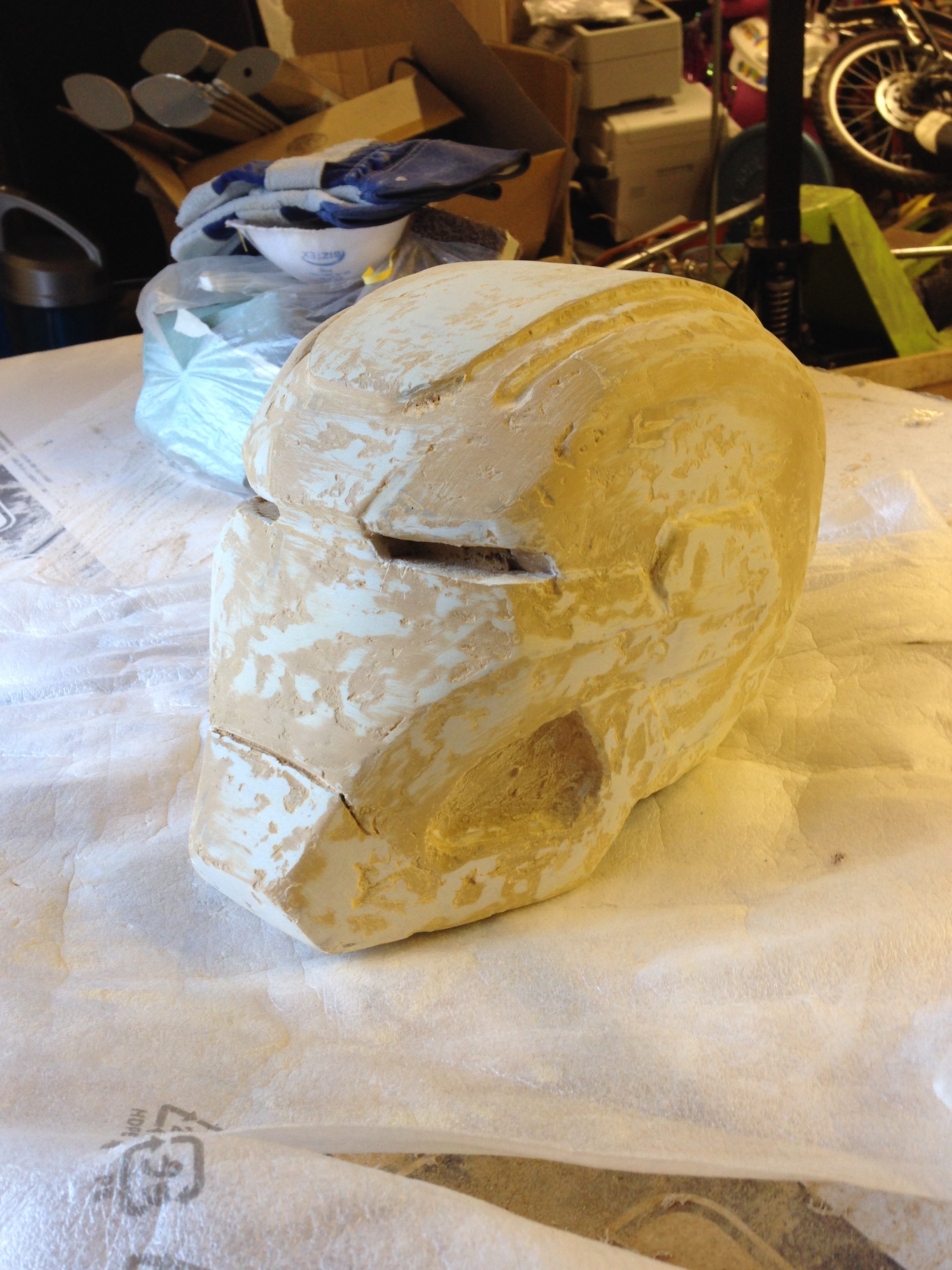

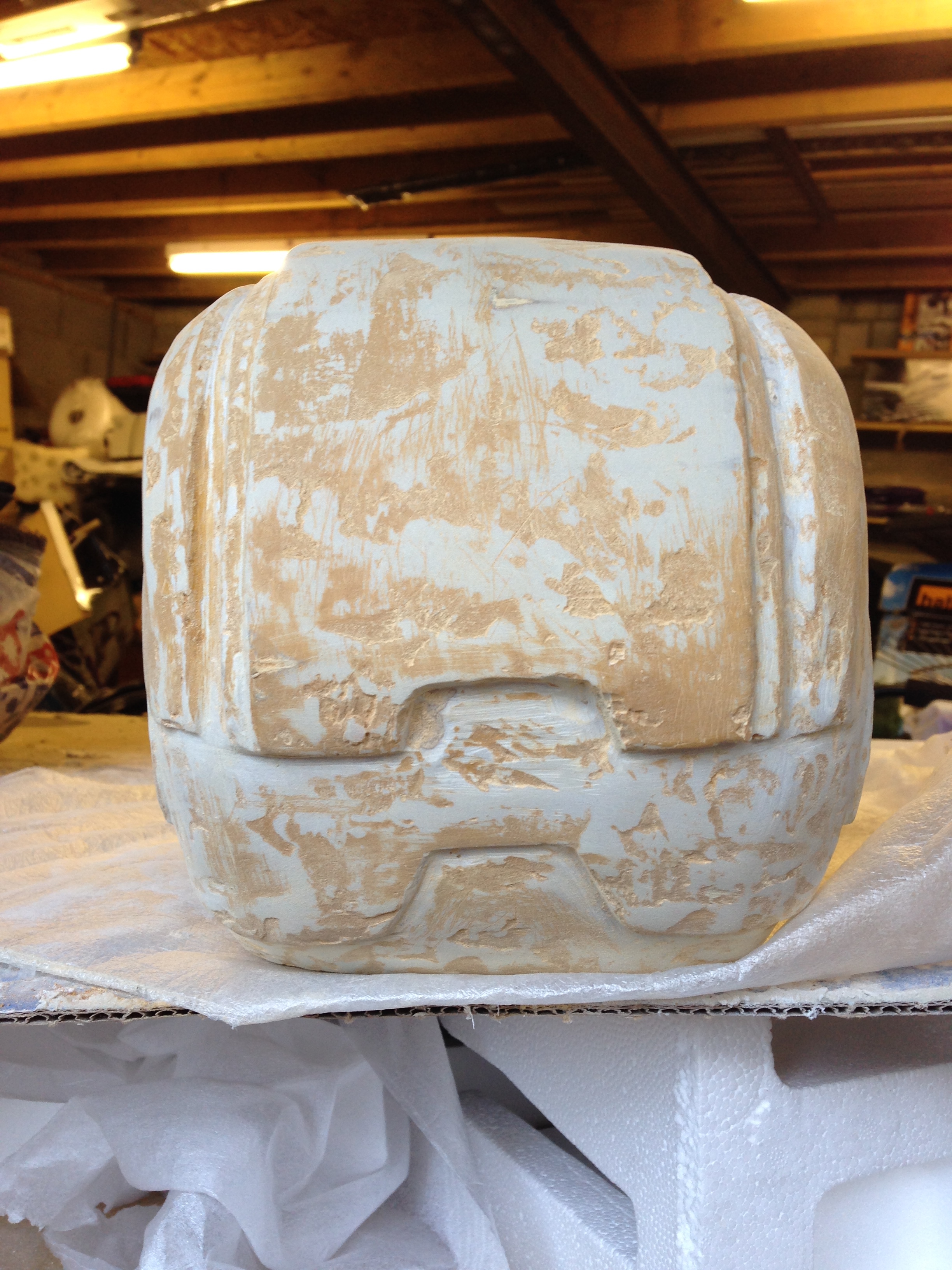

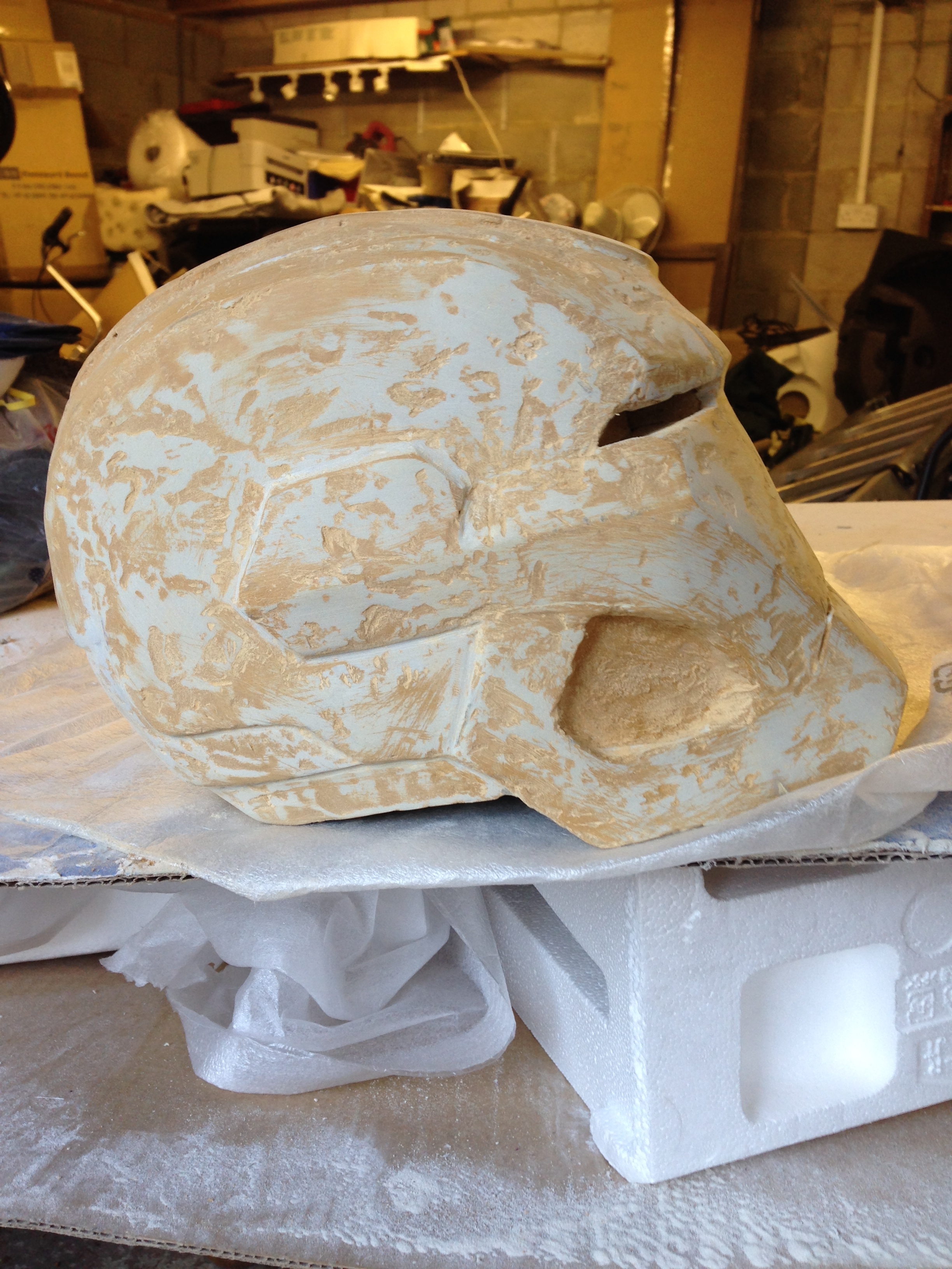

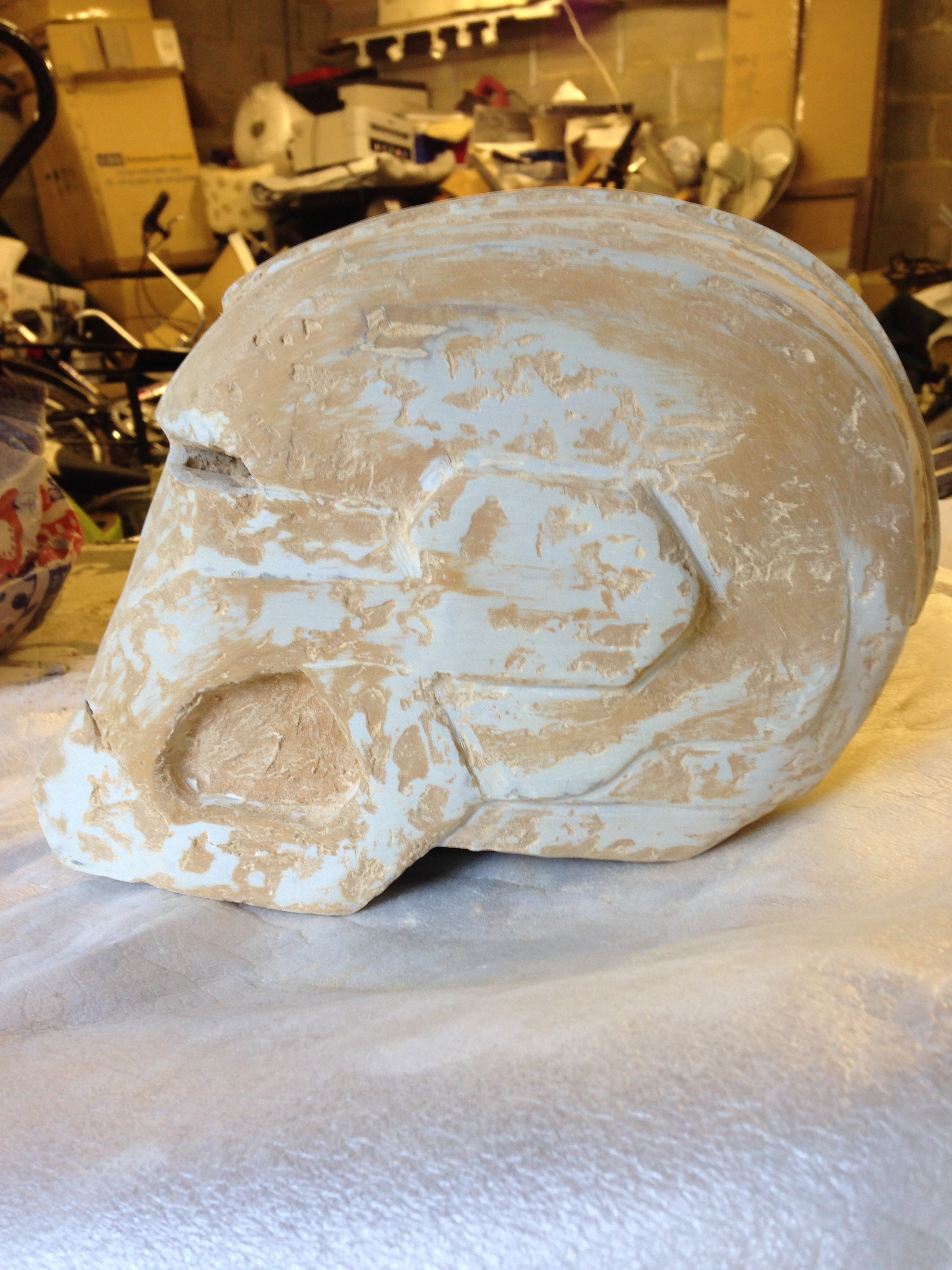

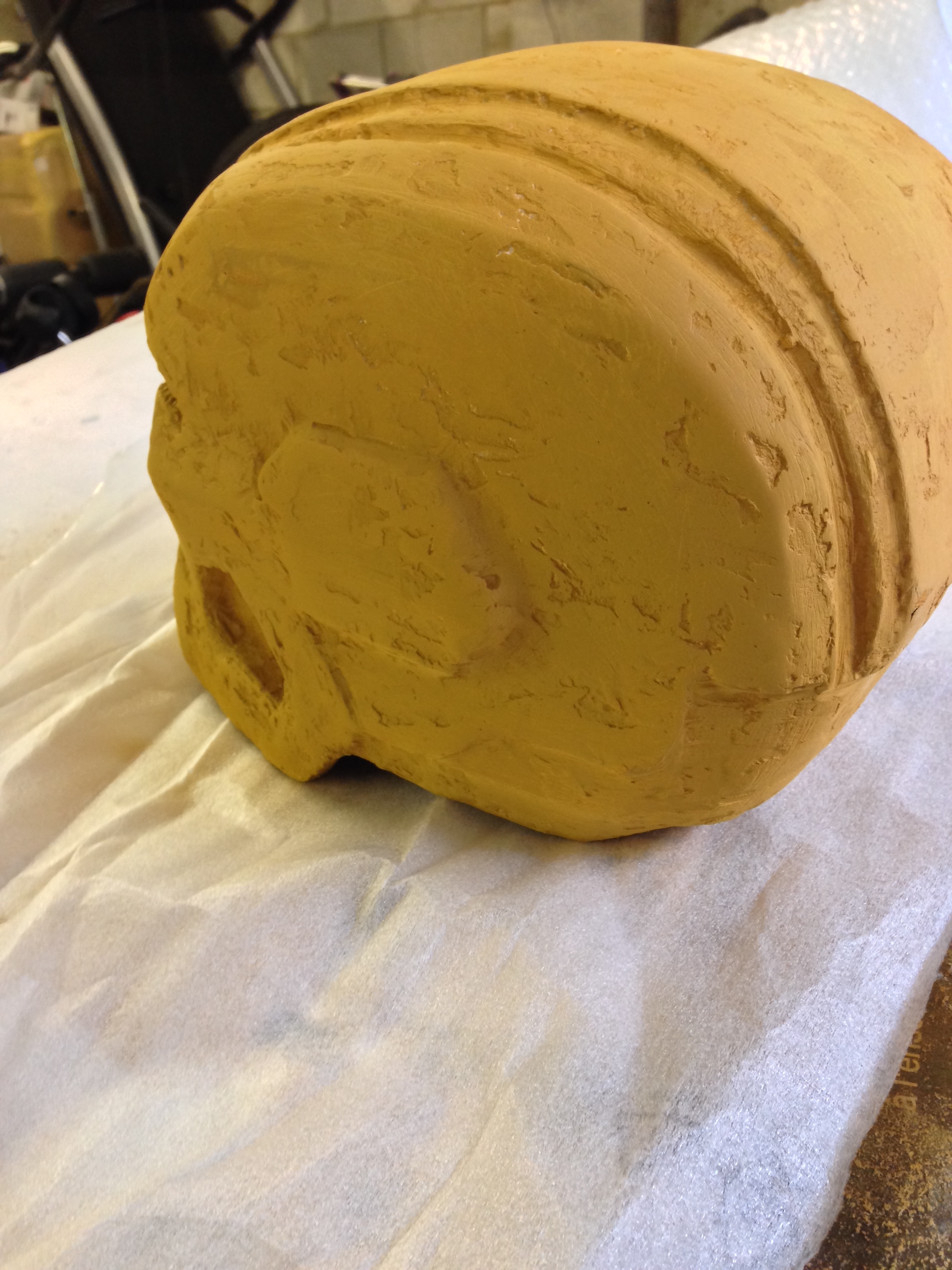

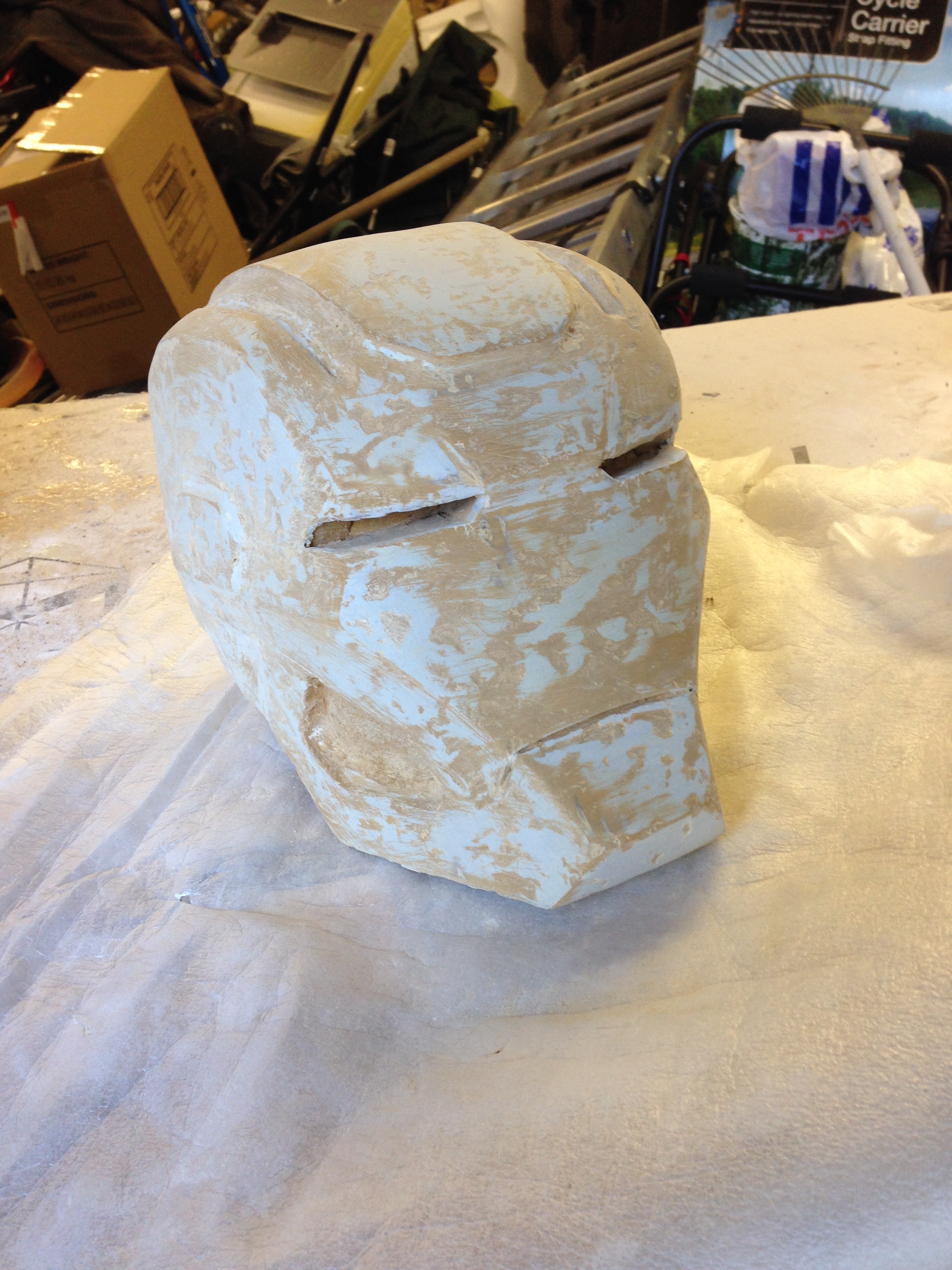

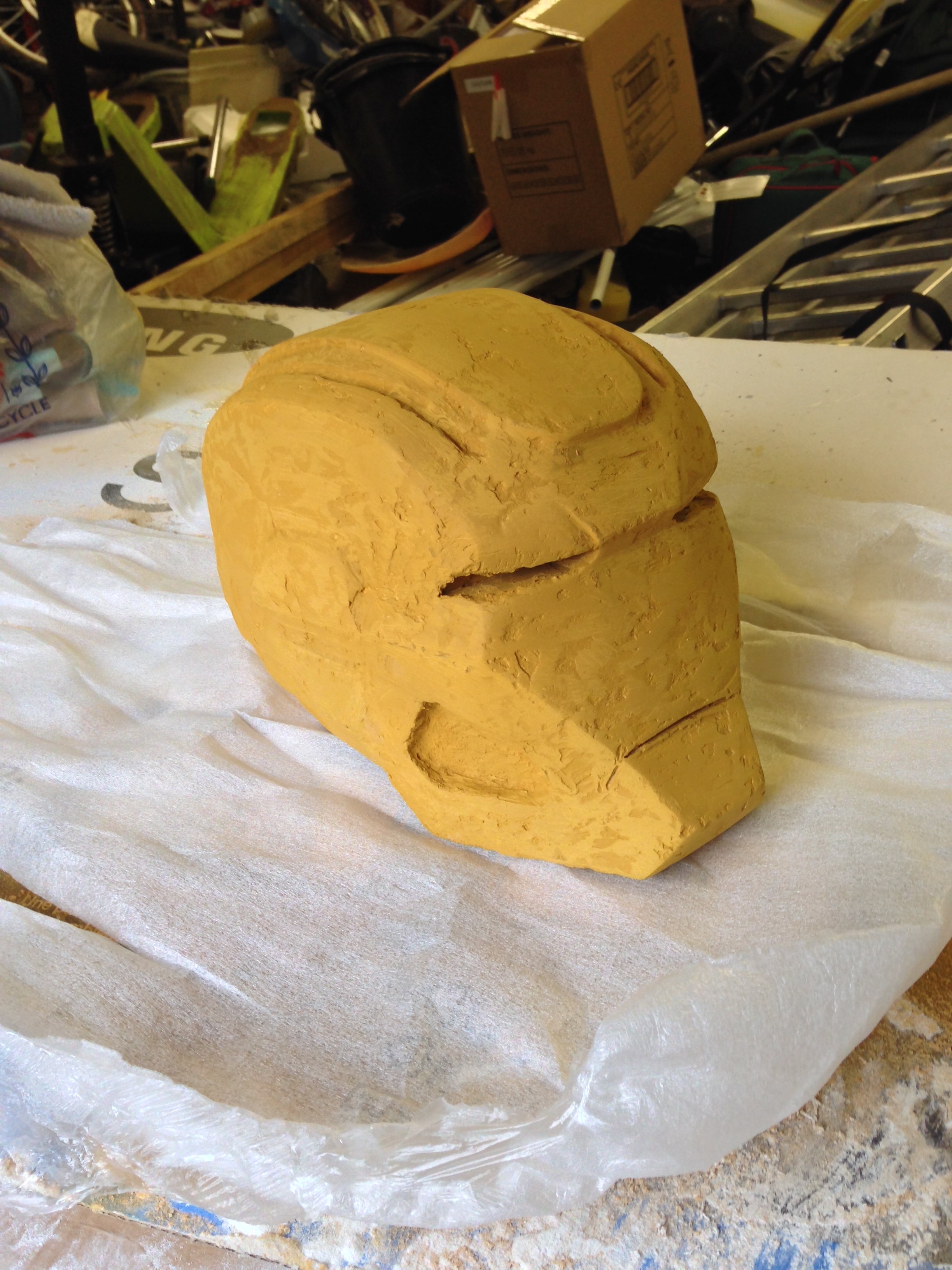

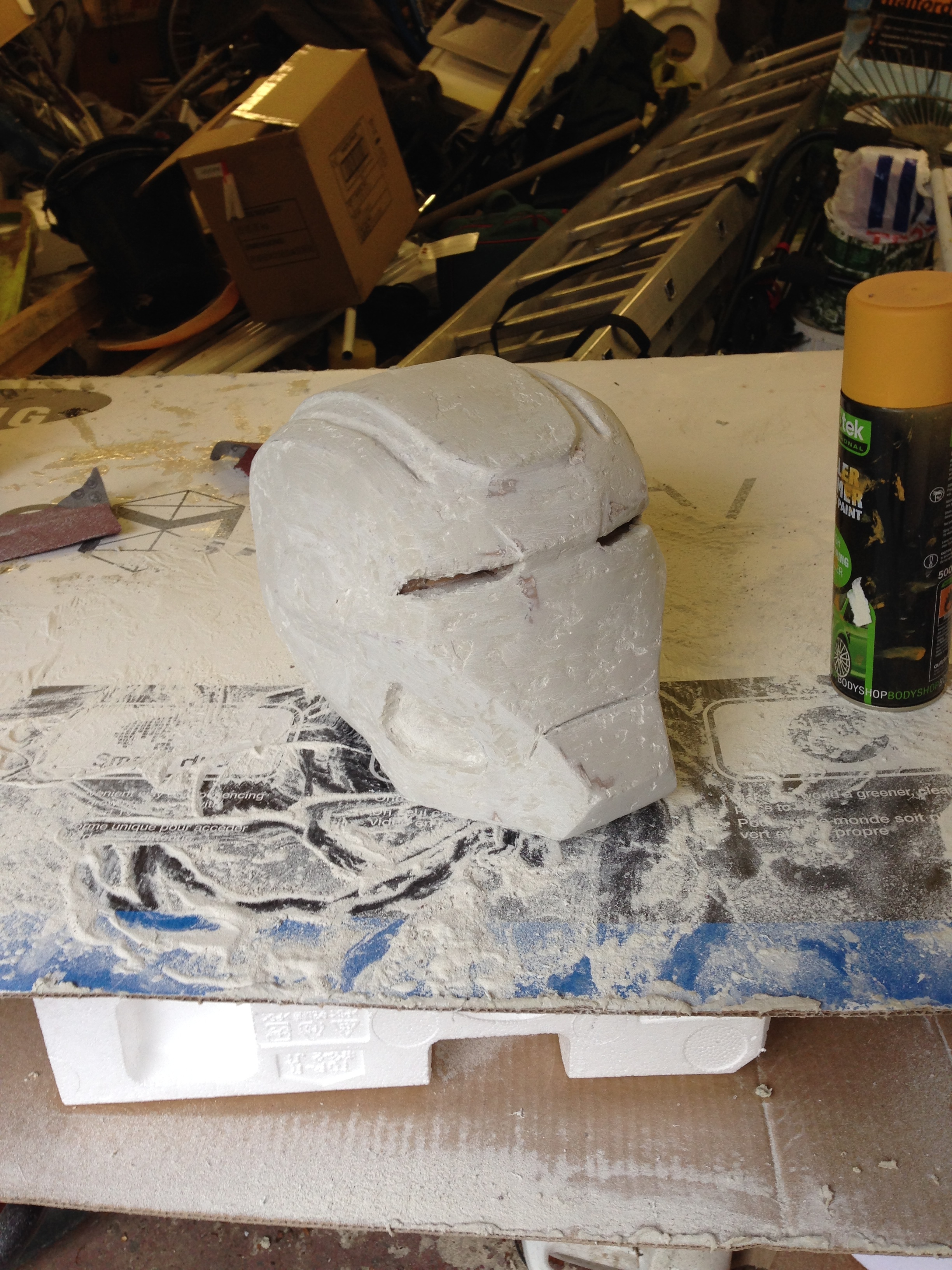

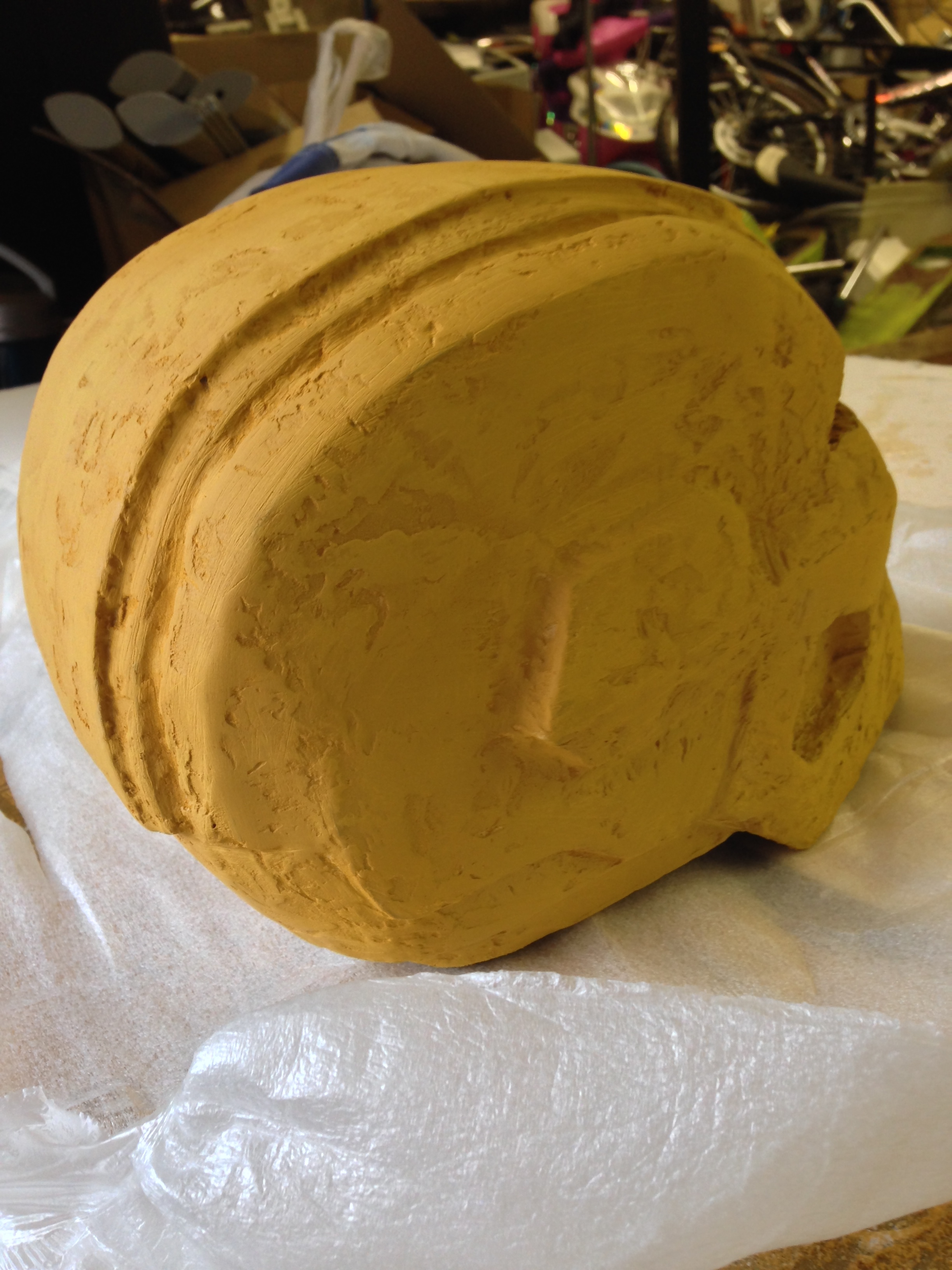

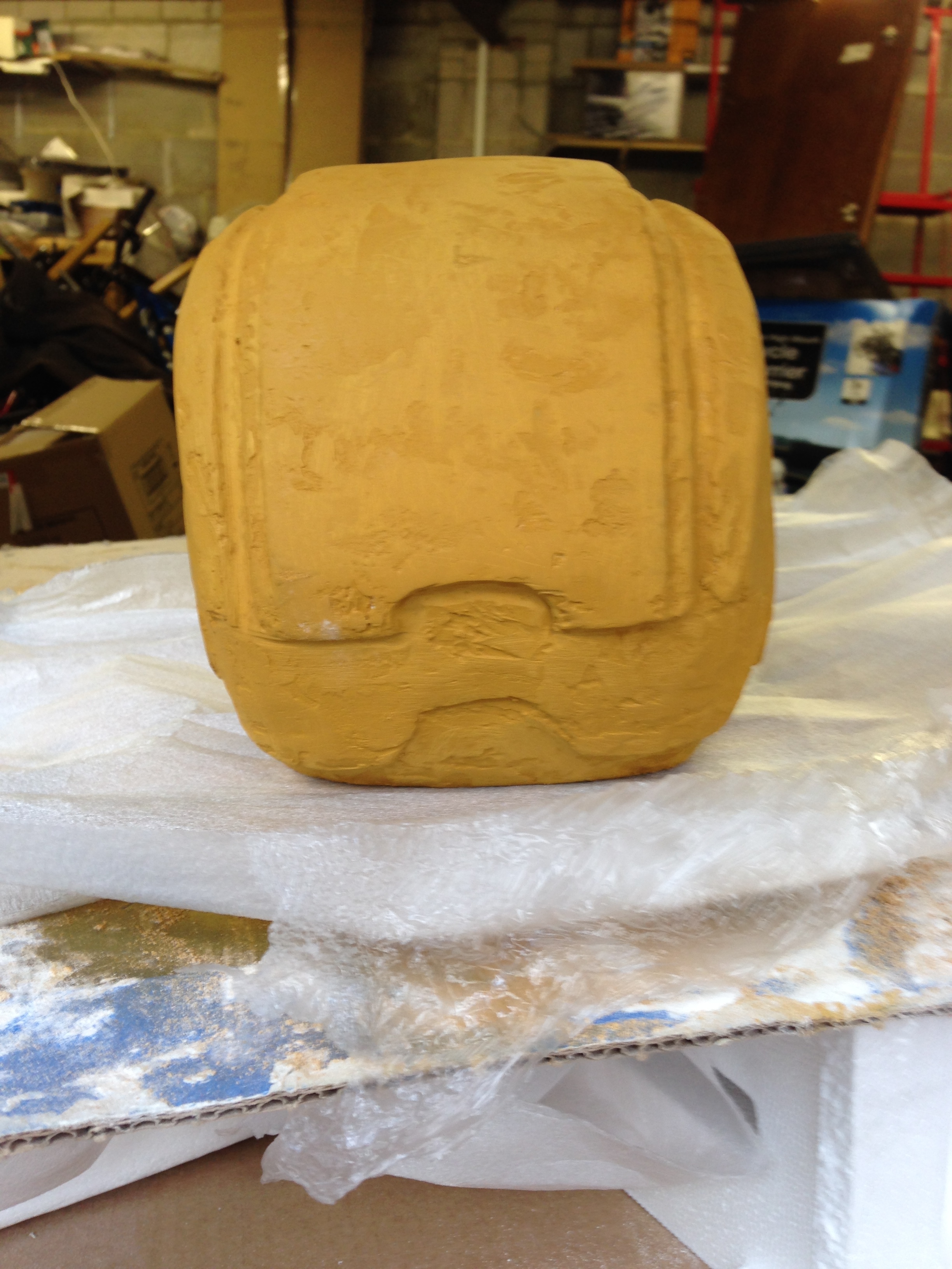

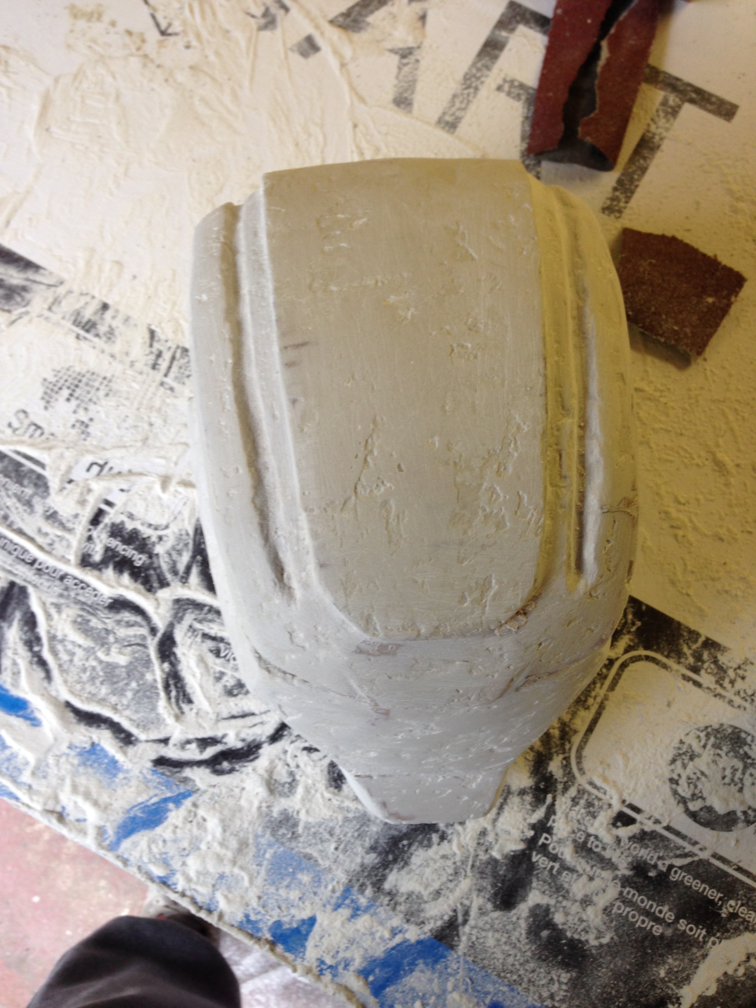

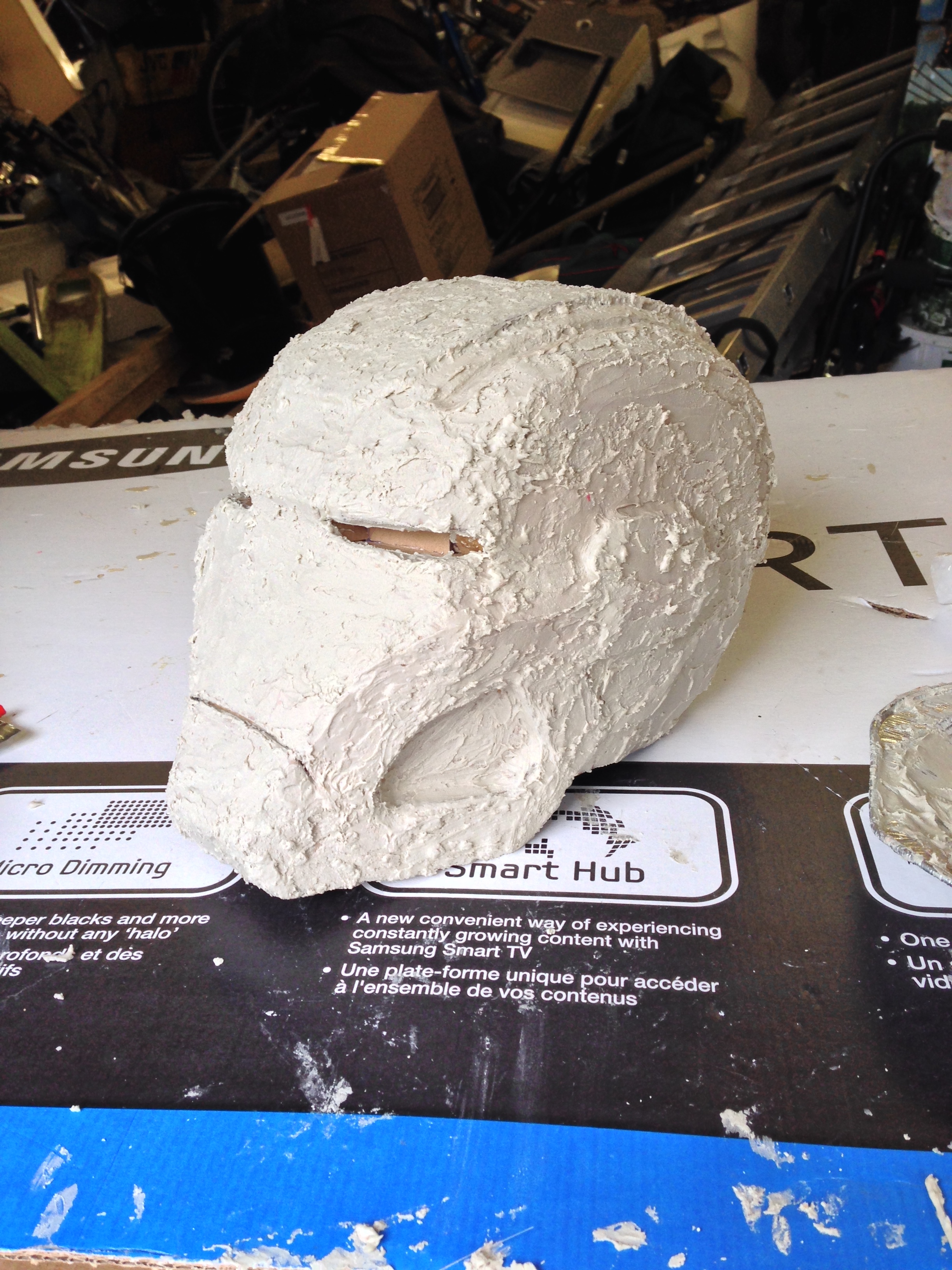

Got some sanding done today. Everything is rough, pics tell you everything :eek Deffo need another coat of bondo. I sprayed some primer on it because the primer is a weird yellow and it was almost finished anyway, other than that I don't know why i stayed primer on the helmet :wacko More updates whenever possible!
pics:
View attachment 338682IMG_4818.jpgIMG_4820.jpgIMG_4822.jpgIMG_4826.jpgIMG_4829.jpgIMG_4831.jpgIMG_4837.jpgIMG_4839.jpgIMG_4840.jpg
Tidied it up a bit more. sanded etc, some filing for the eyes and stuff. Will apply second coat of bondo when my new box of disposable gloves arrive (safety first)

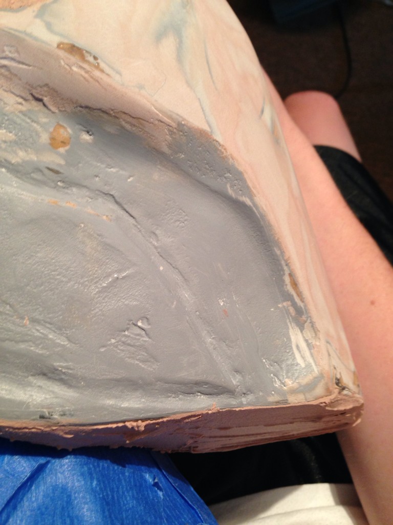

Anyone have any idea how I would sand the inside of the cheeks? I can only think of resorting to an awkward sanding with sand paper; maybe that will be the only option? Any feedback is appreciated :p
At the moment I'm making a deathstroke mask and I just fold a peice of sandpaper up and use my fingers to get to all the hard to reach places like this one
- Gavin
Another RPF member - Glennh, gave my an awesome tip for the " hard to reach " area's that need to be leveled and smoothed. As Gavin said, fold your sand paper and try sand as much as you can, then place the helmet on its side so that the surface you are sanding is level and pour a small amount of resin into the area. The resin will self level and give a smooth finish. This tip has helped me a lot.
Hope it helps...
