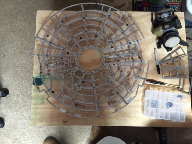

So - to begin with - I screwed together the bottom framework -
No real surprises (helps that others have forged ahead to this point - so great references!)
The only things that stick out - make sure you get the stiffener rods seated correctly in the slot of the center ring before tightening the screws , if you don't you can deform the parts.
Don't tighten the screws till they are all in place. The 4 hole connectors are prone to lift out and screw up the other holes/screws if you tighten to much.
Only had to use the tapping tool, which they provided, once. (screw hold on the center ring (issue 26)

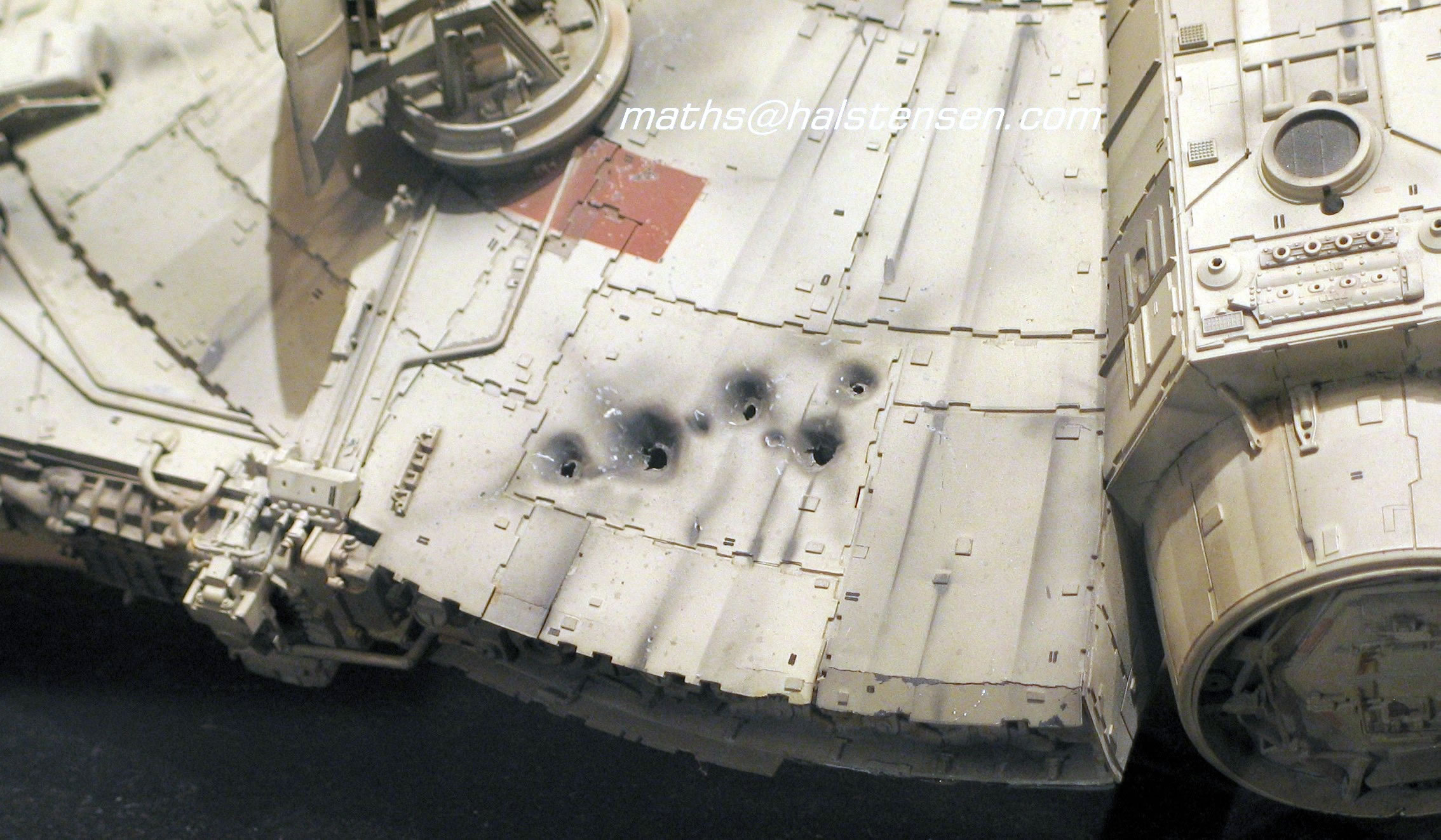

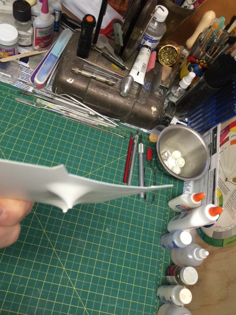

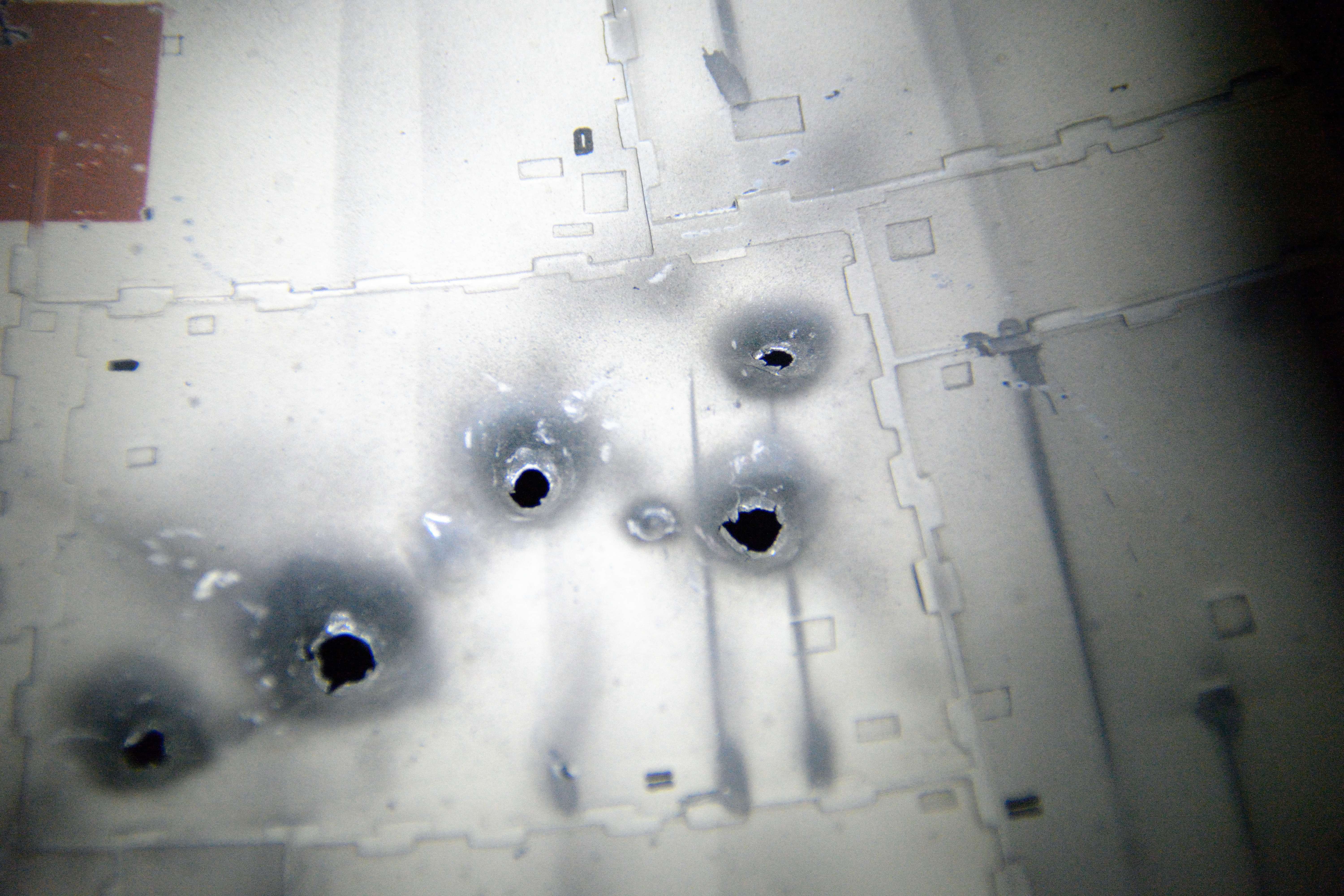

My first task was to figure out a way to replicate the holes on the topside, since the holes on the kit part are horrible!
So - onto what ILM has:
The holes have depth, they have a "pushed" in valley look and the plate appears to be "thinner" than the edge plates.
The holes are open - there is no bottom to them.
I thought perhaps they used a soldering iron to push in the skin, but in my experiments, it melts the plastic to much, and I didn't get the same pushed in valley effect.
So - hot air gun time.
When going through my reference pictures I found here and on the net, I came across the following two:
This shows the area where the holes will be, ILM made a hole in the structure of the falcon - triangle shaped, by the hole that will be used for the dish, and it is not using the black plastic they used for the rest of the Falcon skin:
this picture shows that hole is now covered by a piece of white plastic:
Then I realized they must of used different sizes of plastic to simulate the damage, since closeup pictures of the holes show thinner than the edge plates - and with the hole underneath, it would allow the depth, so with this thinking, I experimented.

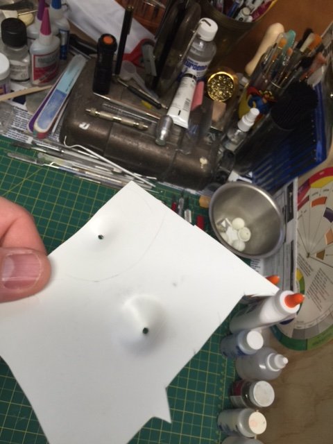

My first attempts pushing in a soldering iron ended poorly. The plastic melted, instead of oozing down to make the valleys.
So I moved on using a small hot air gun I have, and found that it heated to much plastic at once, so the valleys were way to big. I used a sharp pencil as the pusher, since I can control the depth better, but made gigantic valleys:
I could of pulled out my hot air device I have for removing solder, since it has a smaller tip, I thought there had to be an easier way.

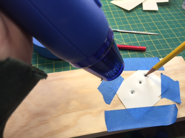

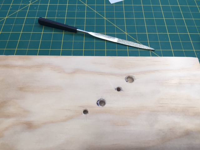

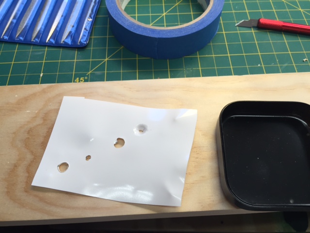

So, back to the drawing table, I used a scrap of wood, put in some drilled holes, made a slight rounded edge to them with a file, tape on some plastic, and went to town again, using the hot air gun:
Success!
By varying the distance and how much I push in, I can make the holes similar to what is on the ILM Falcon.
I put the plastic on my simulated hull hole:
Nice :)

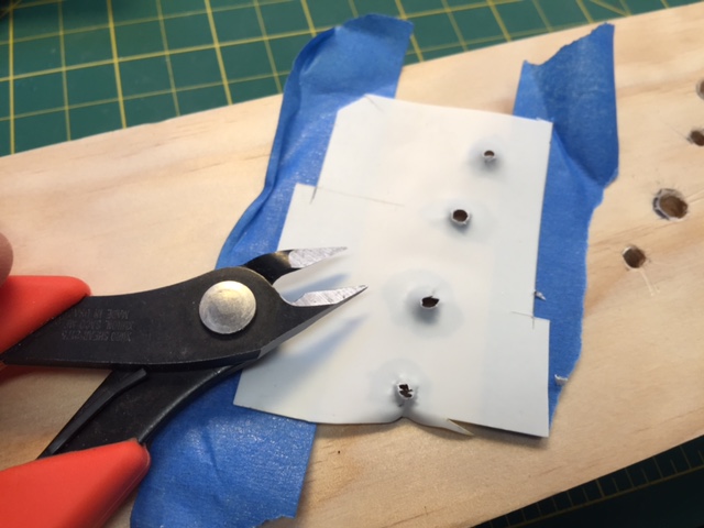

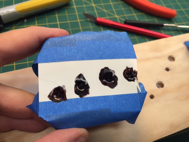

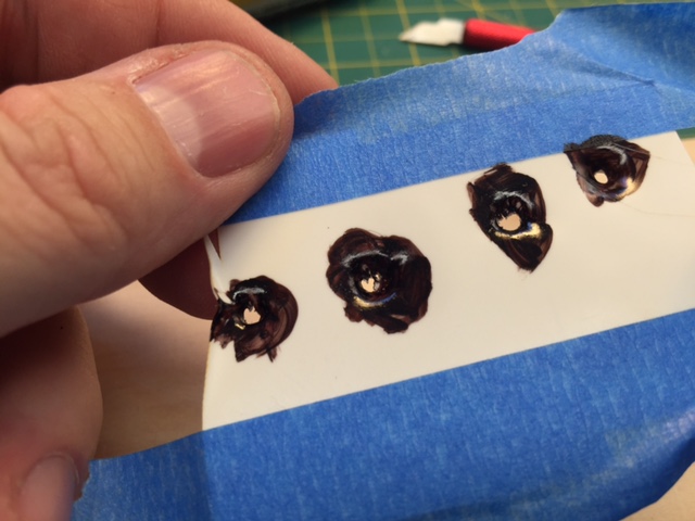

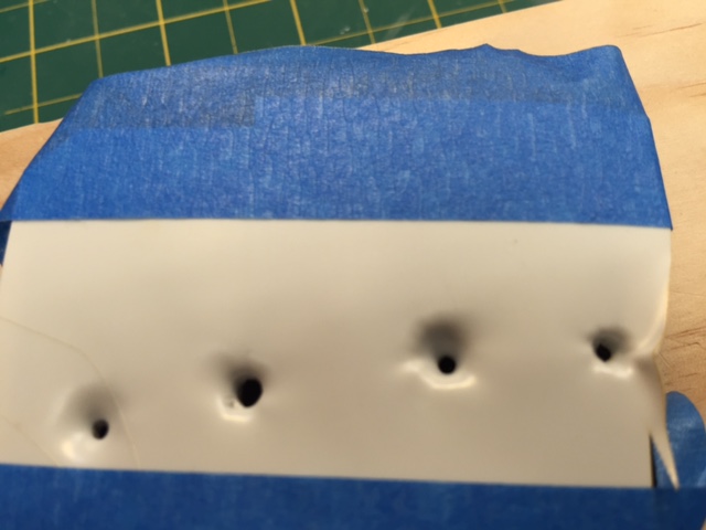

Quickie black marker to simulate paint, and using sharp cutters to make the bottom of the holes more ragged, even used a small file to rough it up:
So, now I can map the exact ILM hole pattern in wood, and by using this technique, can make my holes look like ILM's.
