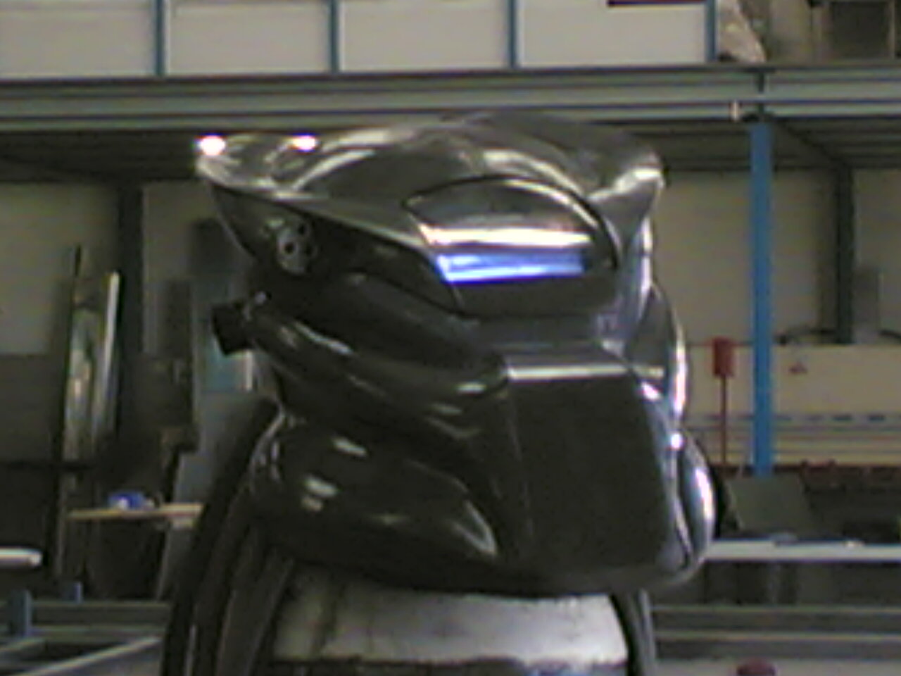

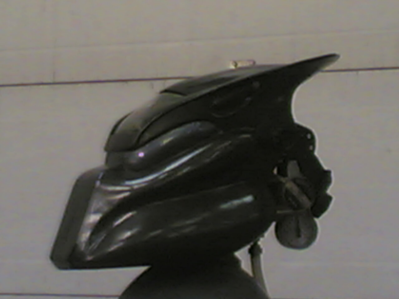

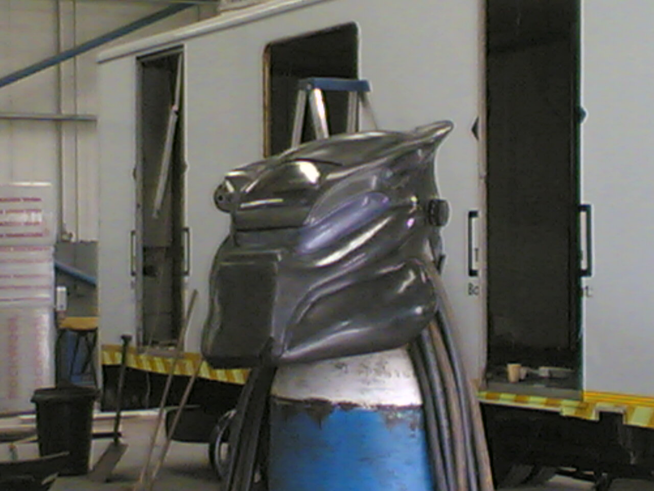

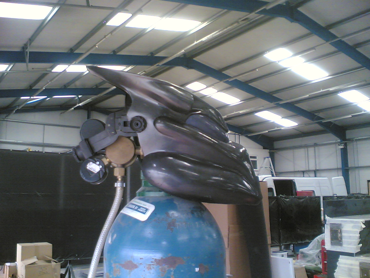

my first predator helmet which is used as a welding screen

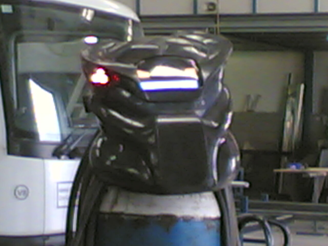

thanks . the guys in the work shop liked it .said i had to much spare time. looked good with the lasers on through the welding fumes. :p

thanks . i used a reacterlight welding filter so you dont have to lift it up to look around or look down at any one walking past and flick on the lasers :p then just carry on.

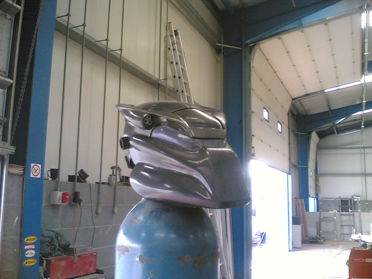

i used the head screen which had the lens in as a base .so from the start i knew it would fit my head ,and all the other bits were reused. oh and a few pounds of clay, body filler and fibre glass for the plug,took a mould and cast with a black gel coat and 2x2 twill fibre glass mat .
Since dropping it its come home to the shed for a bit of a remodel,and will be posting soon with pics. ;)
