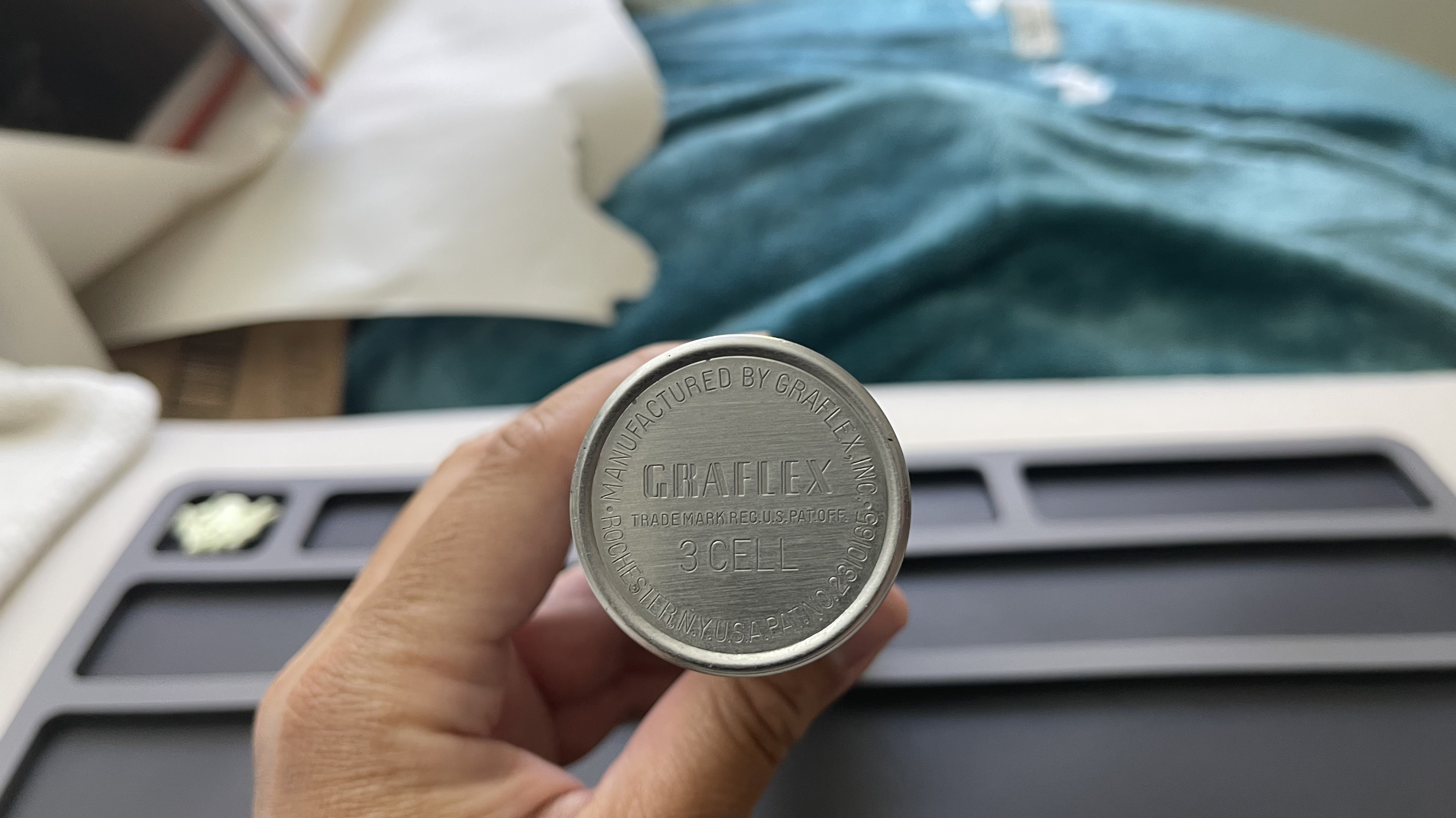

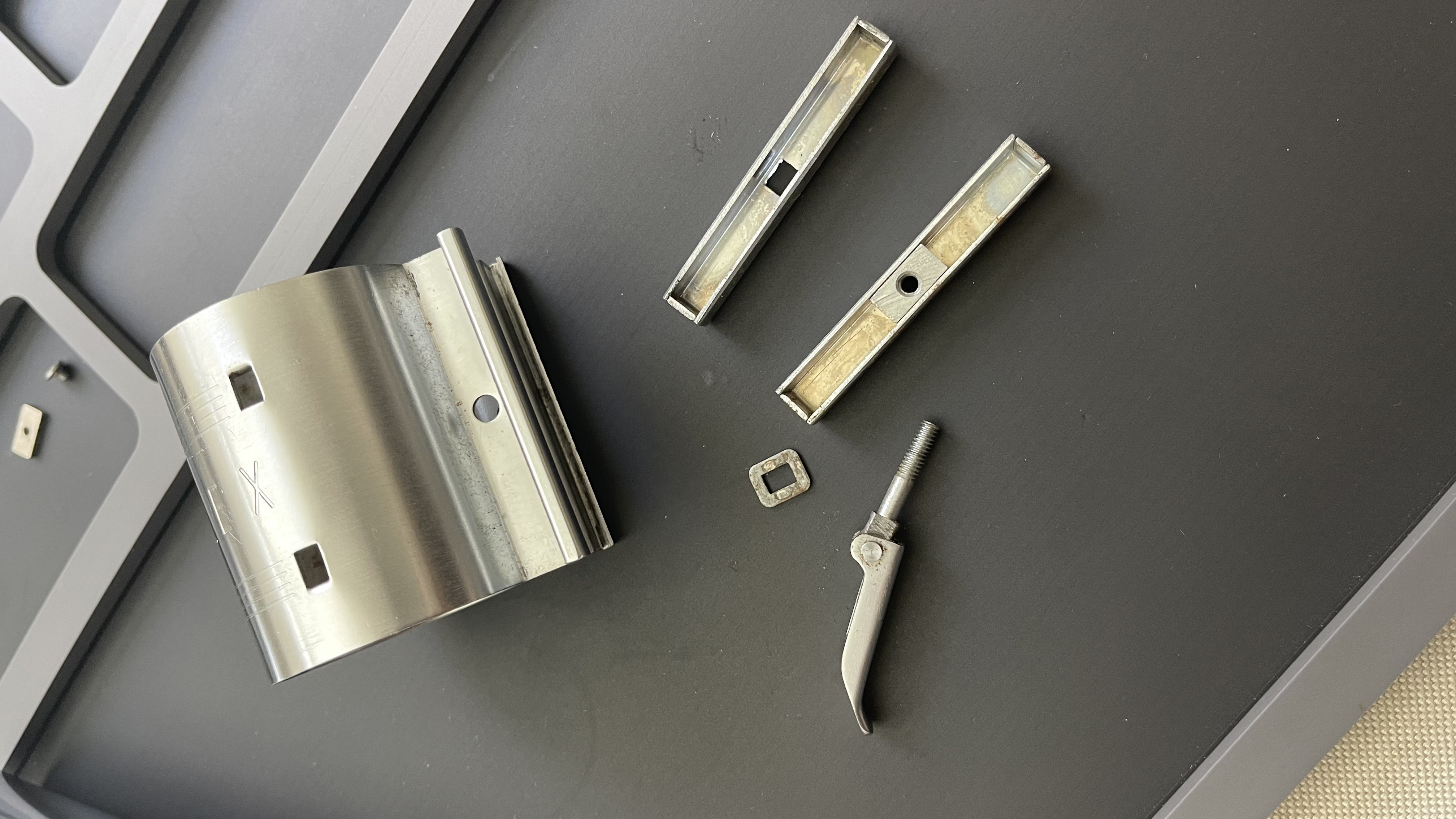

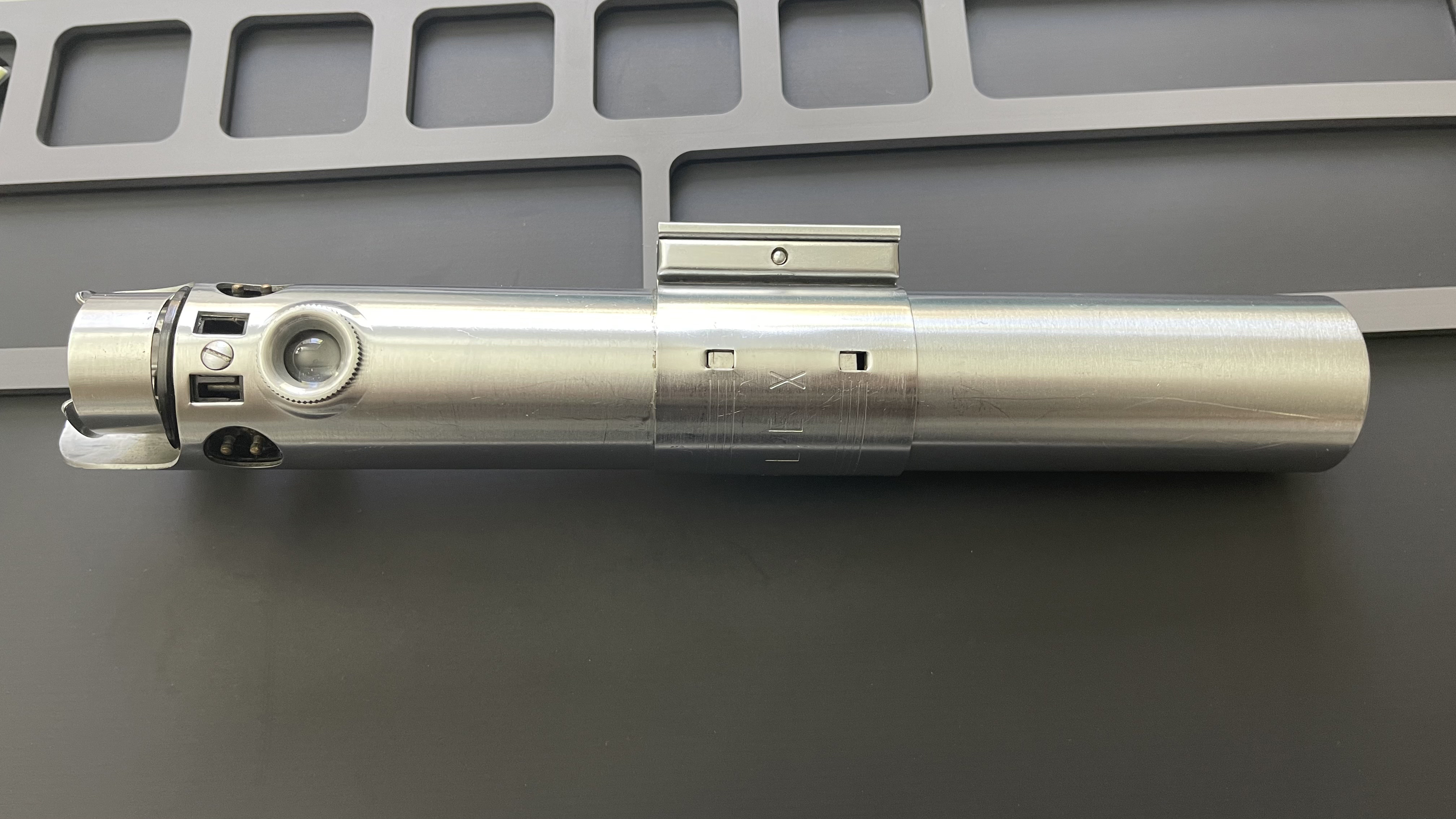

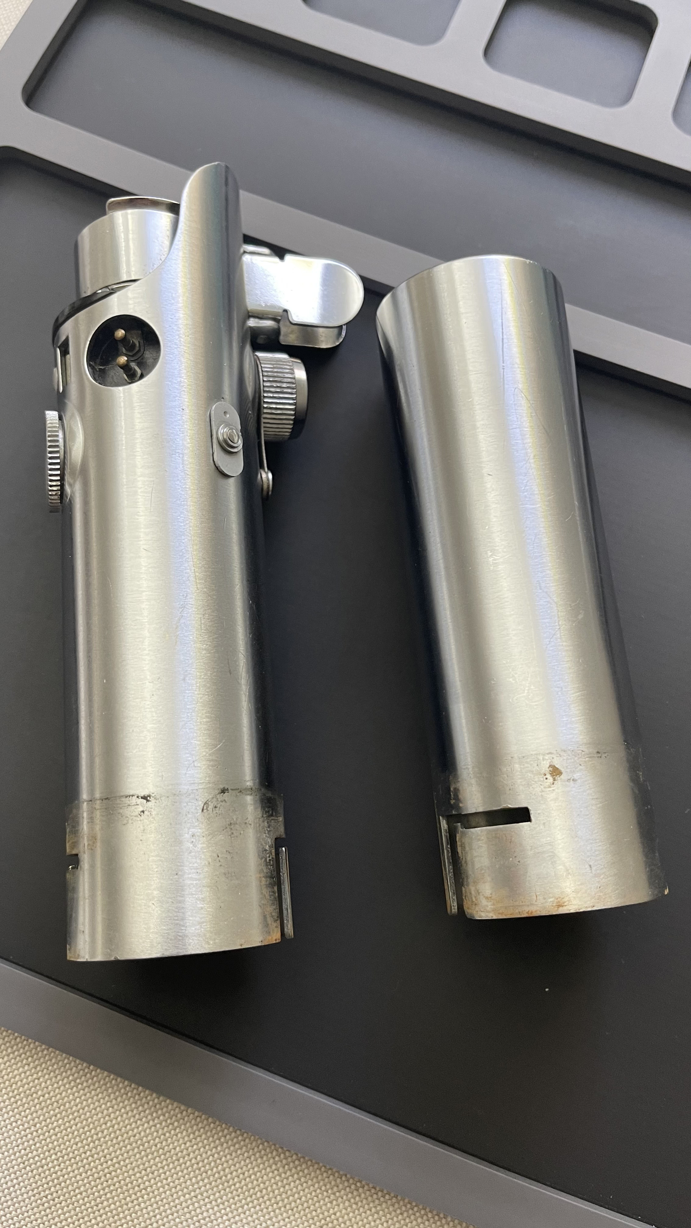

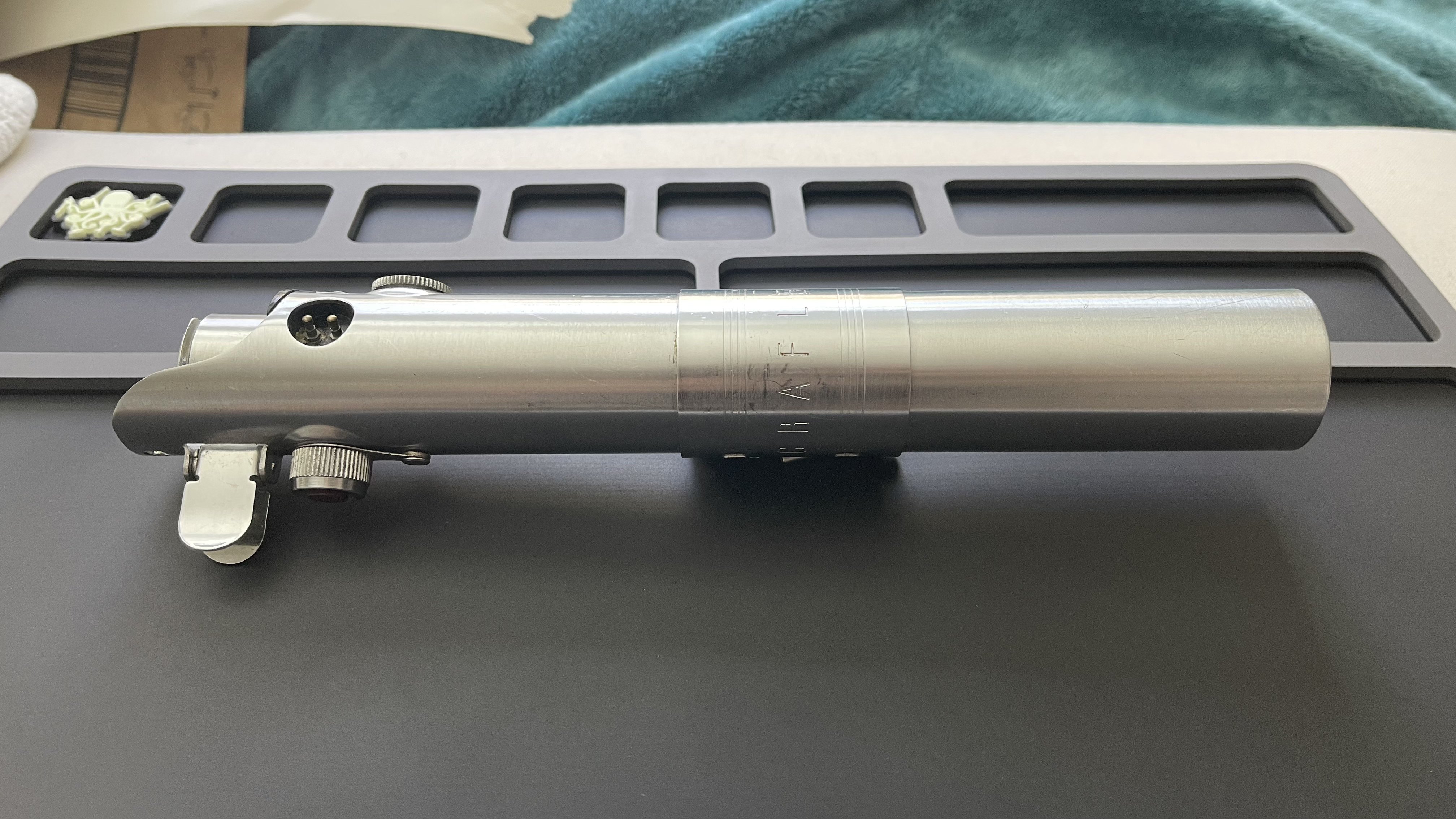

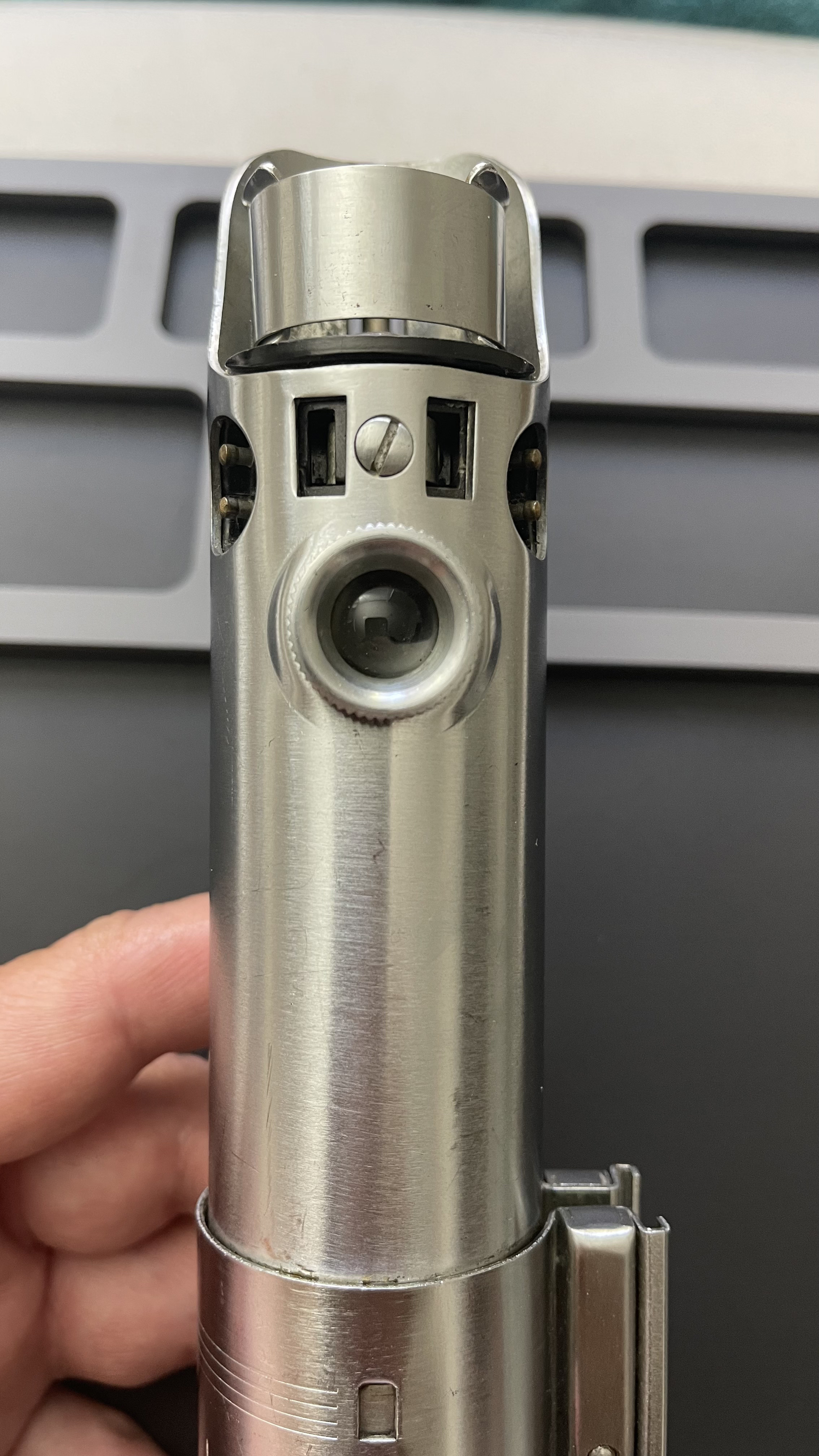

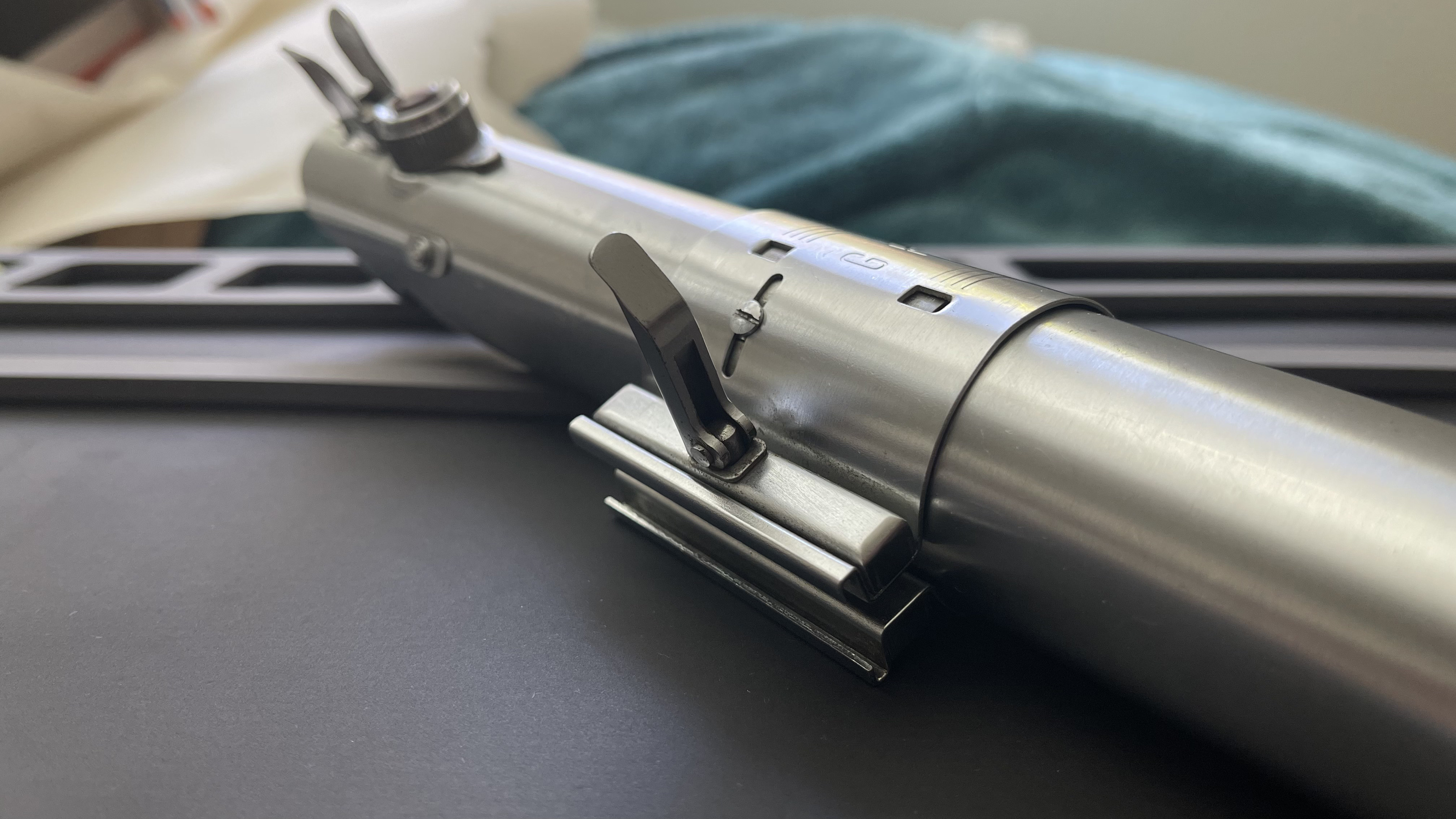

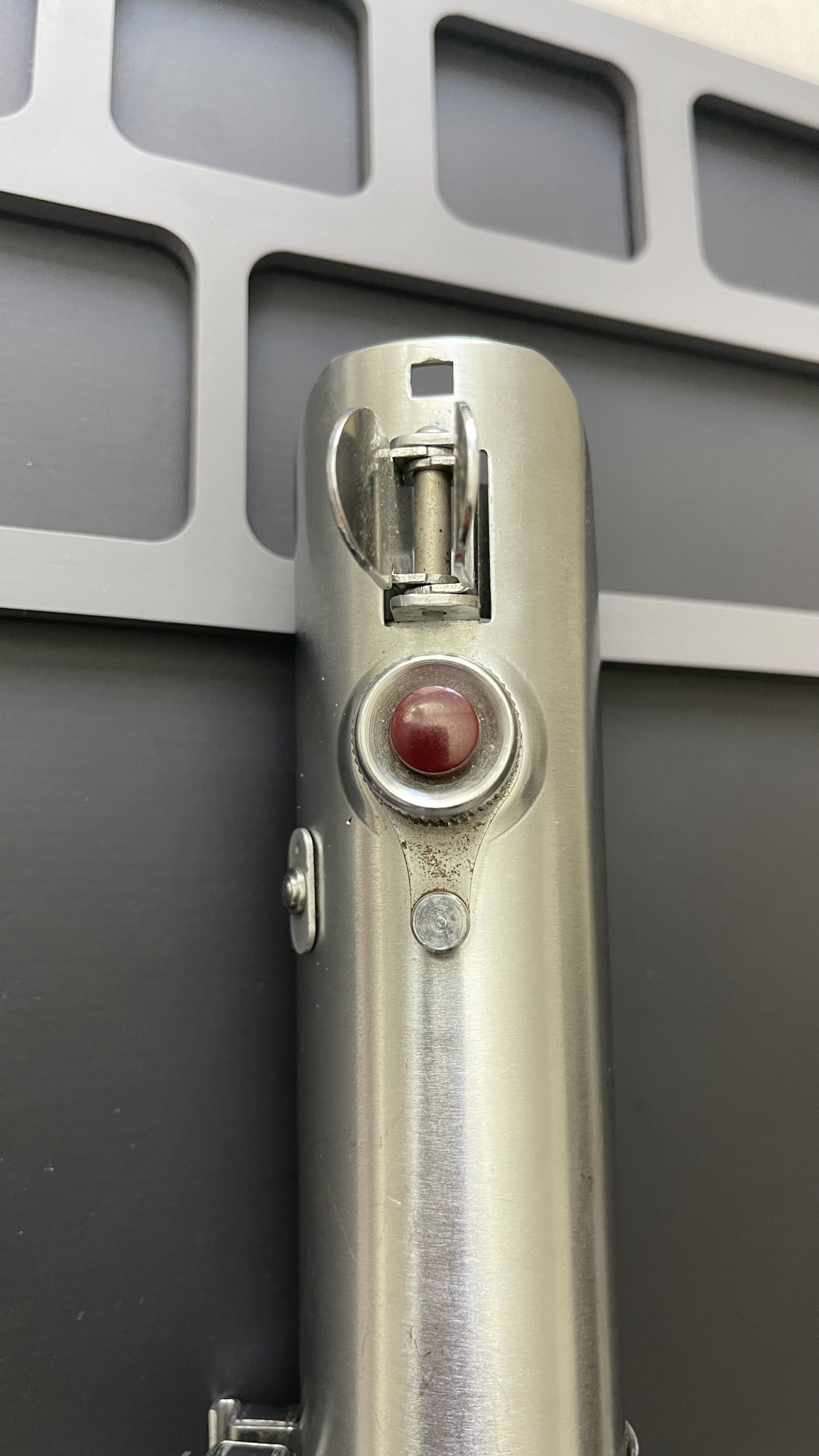

My first Graflex, do you guys think it's real?
fossil

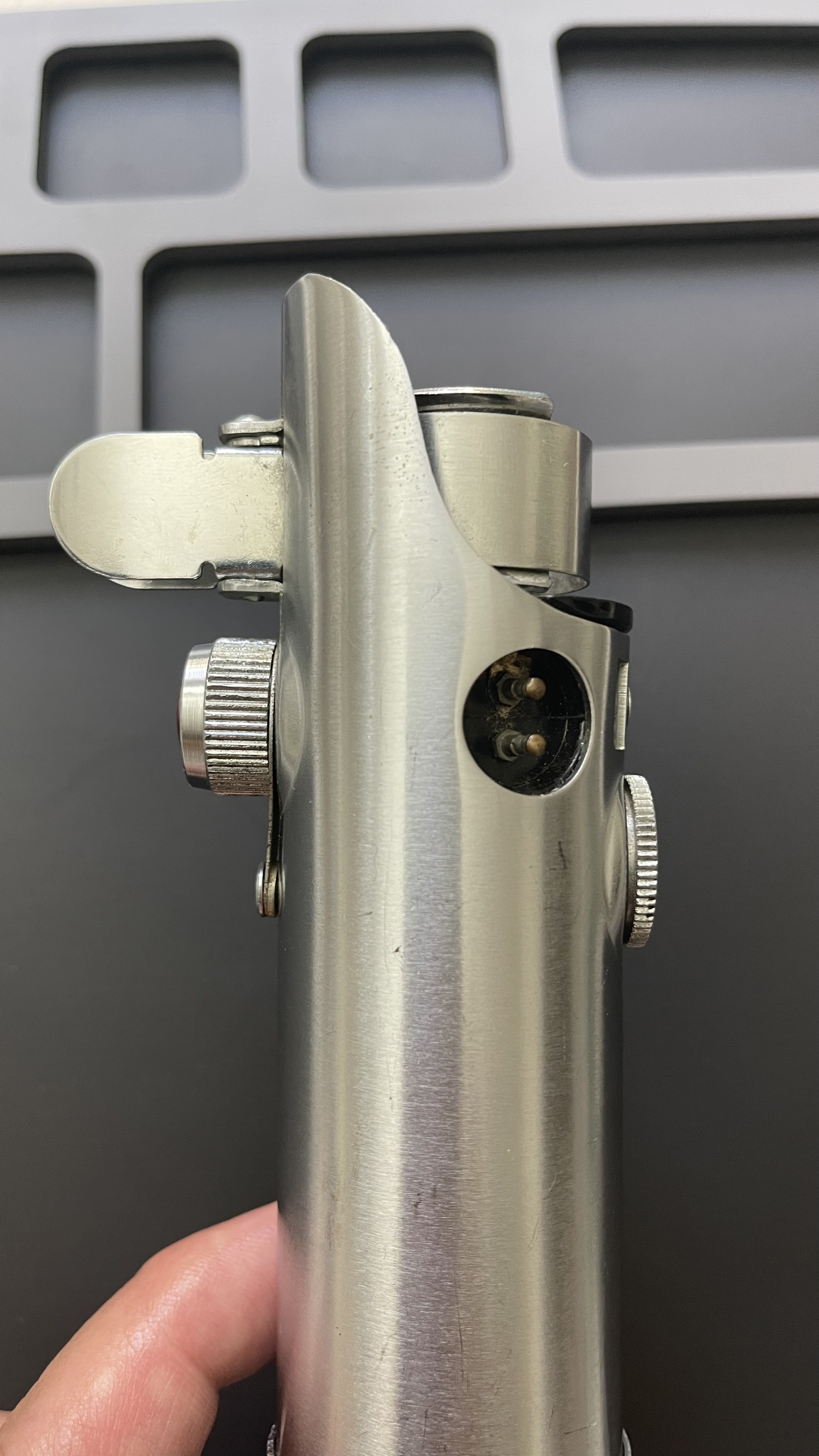

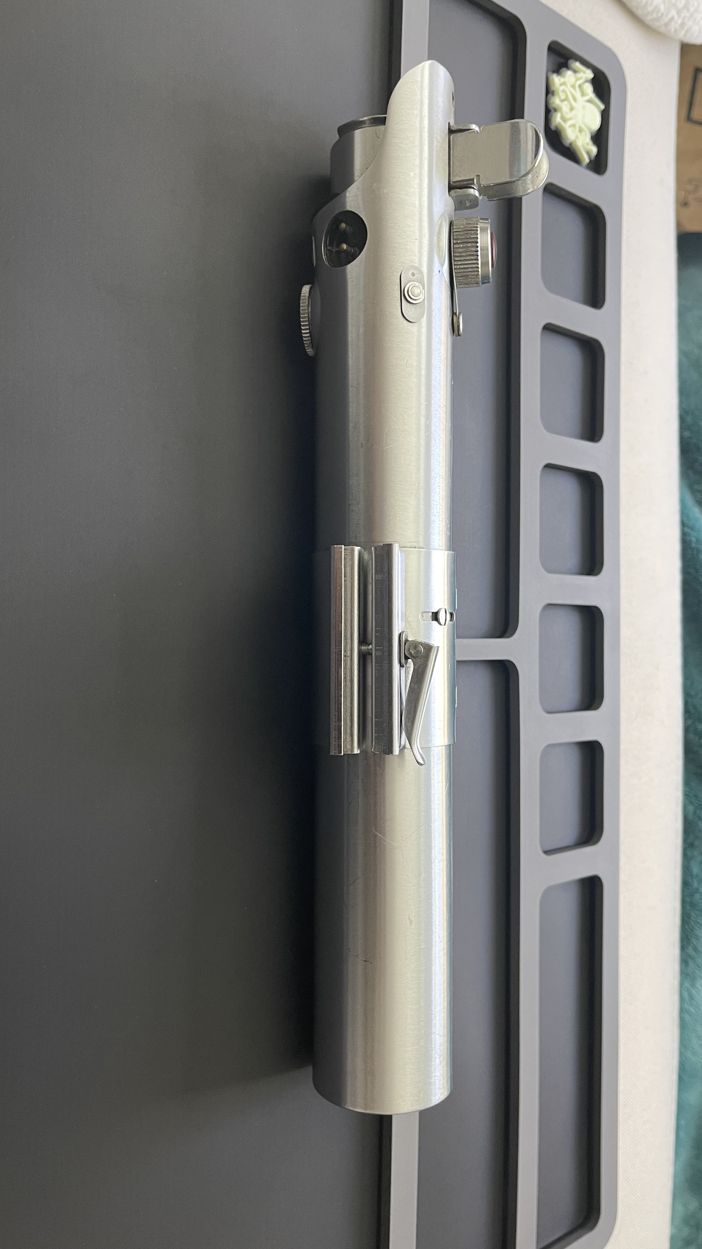

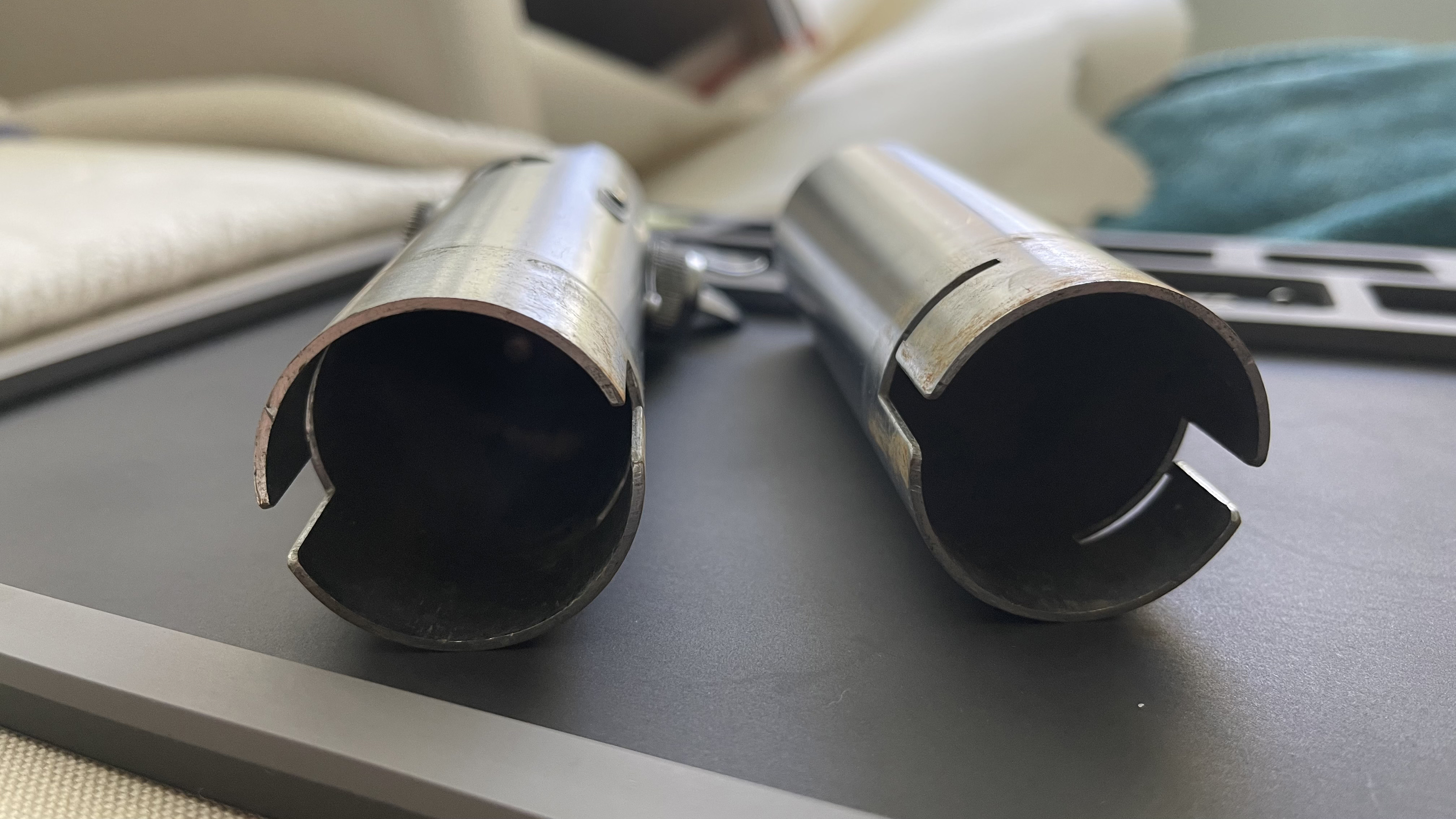

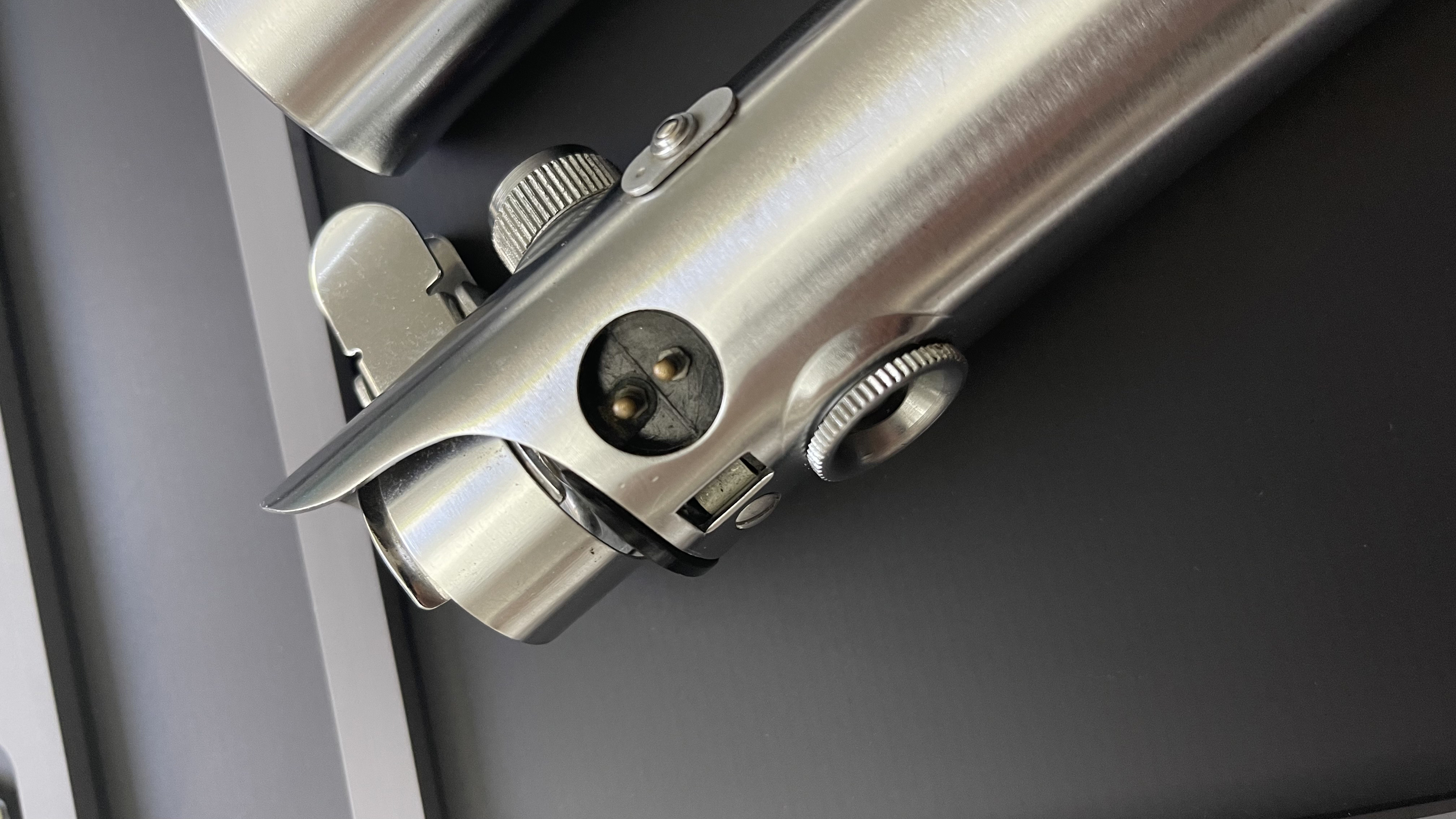

Hi everyone. I'm just getting into lightsabers, so I got my first Graflex. I feel like I have an ok grasp of what a real vintage Graflex Inc. ver looks like, But I wanted to get some second opinions. Hopefully this thing is real and not a weathered replica =O

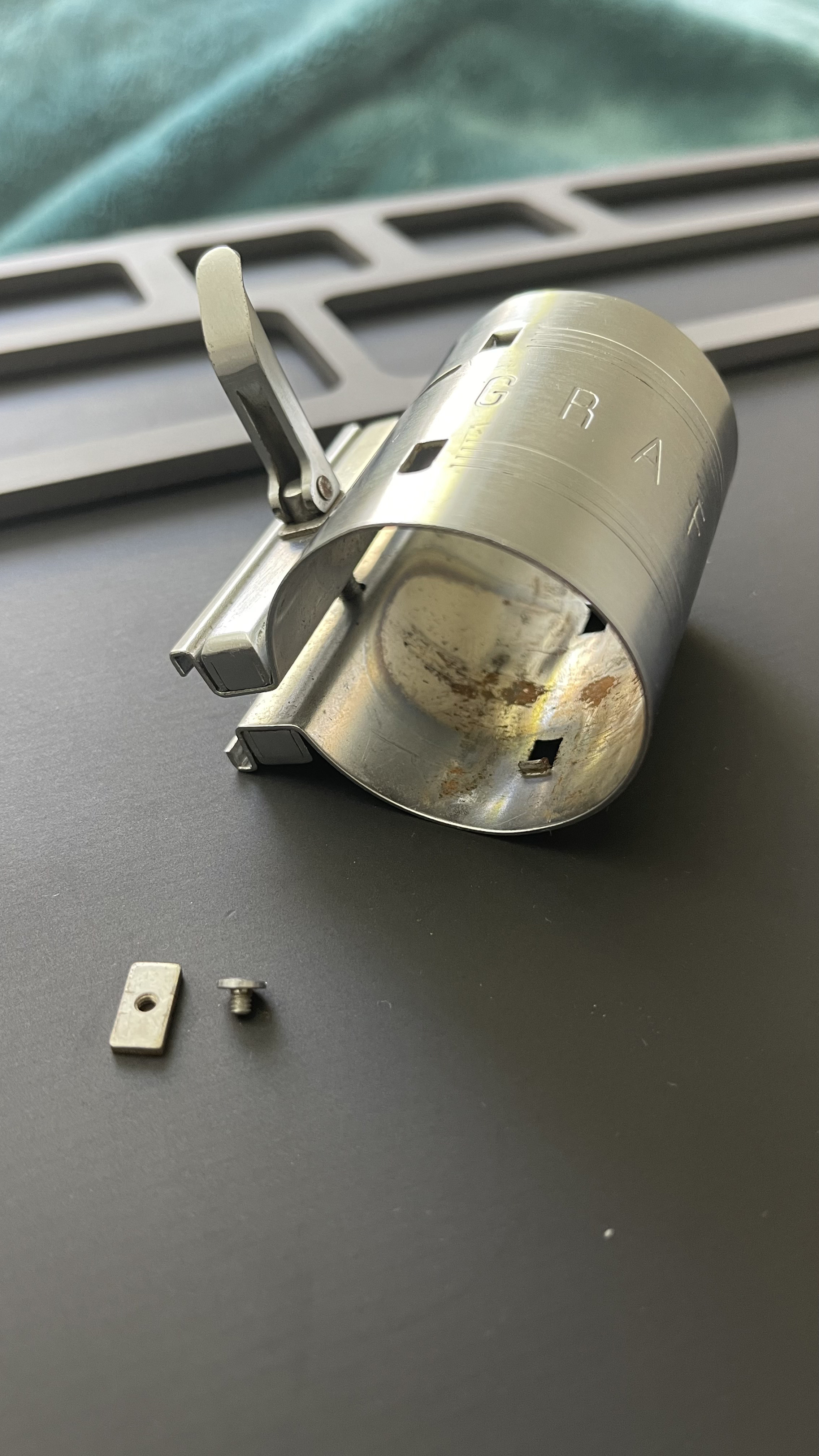

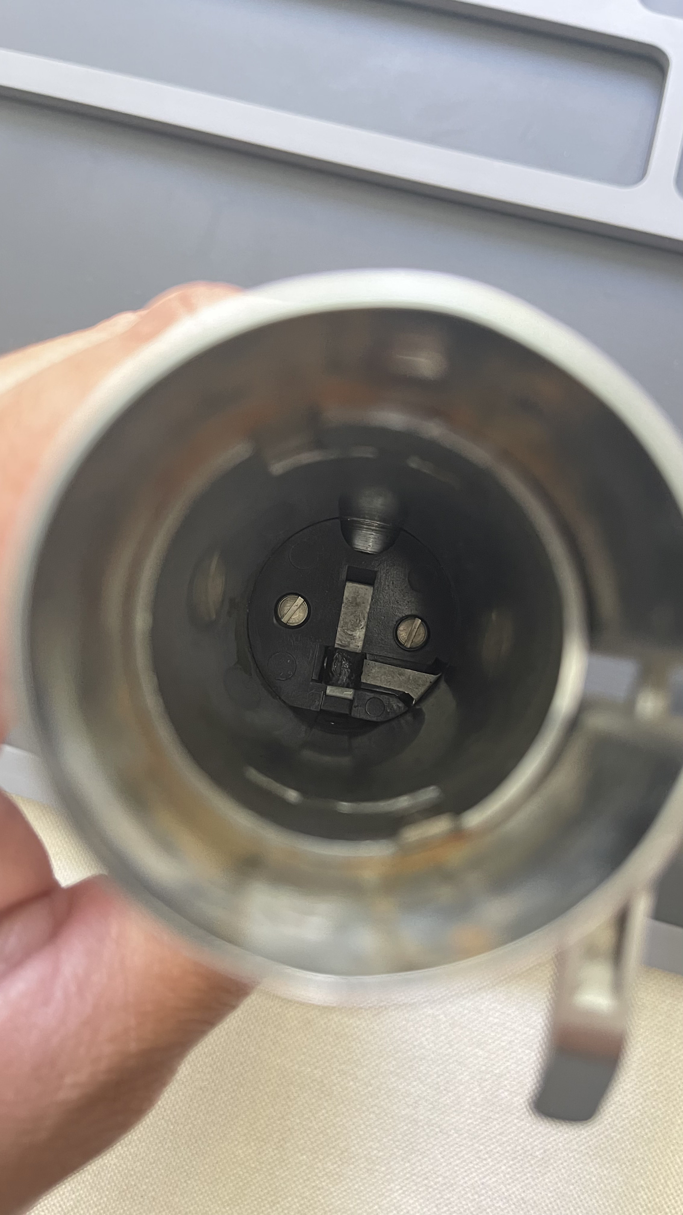

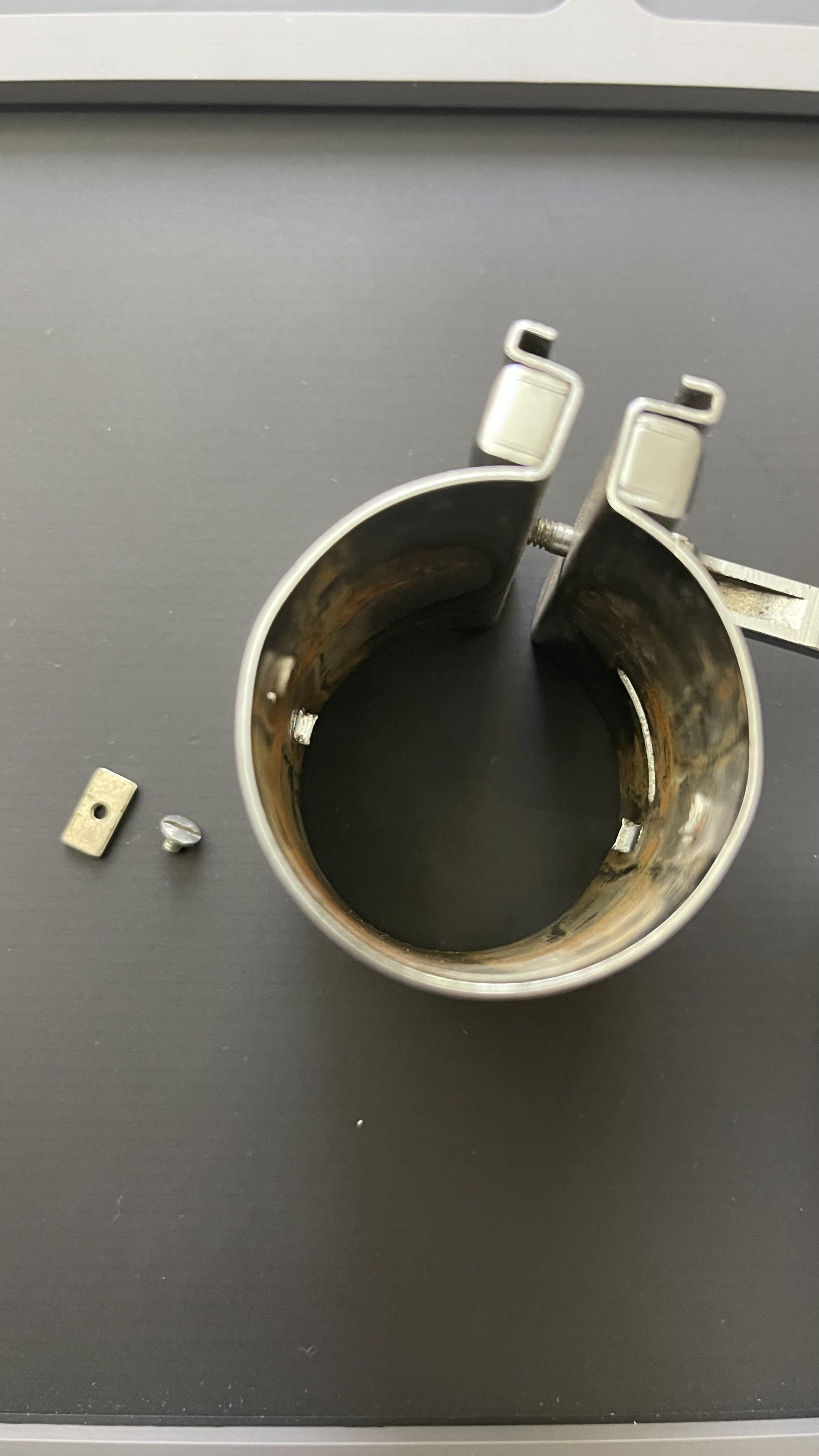

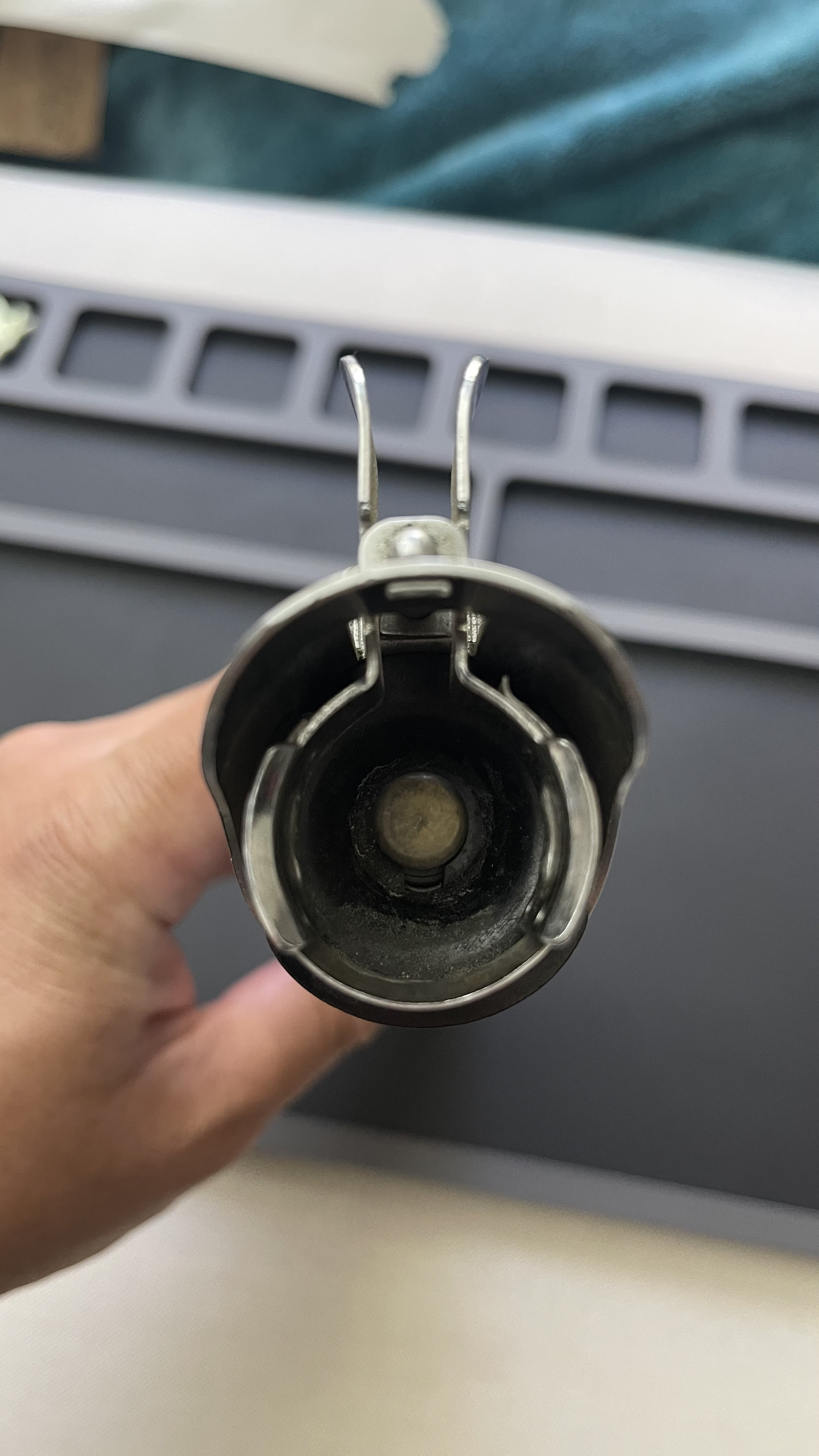

Yep, looks the part - accumulated dust/dirt, oxidized pins/bulb contact, and the rust inside the clamp. (y)
Another good tell is the rivet through the bunny ears - check that it's not actually a screw with a shroud to make it look like a rivet.

Any recommendations on how to clean this bad boy without damaging it ?
I don't think it's a good idea to go nuts, trying to make it look factory fresh - it's been around for a while (and has probably seen some things ;))
The grime on the upper and lower tubes? Try wiping them down with a rag saturated with isopropyl alcohol. Grime in the bulb socket? Try a small paintbrush and/or Q-tips (dry). If that doesn't do much, you can try dampening them with a bit of water.

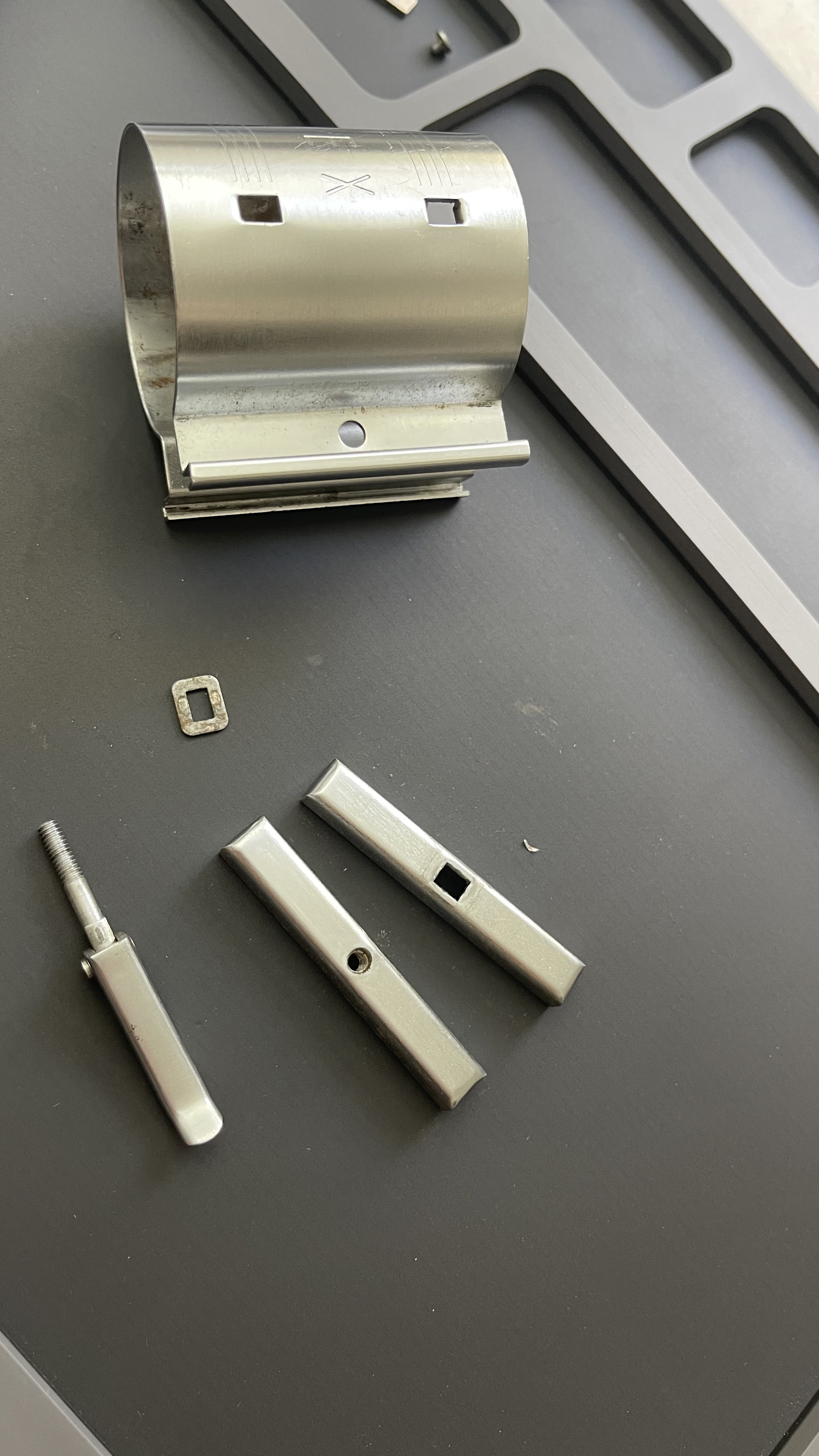

As for the rust inside the clamp... it doesn't appear to be too bad - you can try wiping it down with a dry rag and then maybe apply some WD-40 or other similar type oil. If you're really worried about it, you can pull the clamp apart (again) and soak just the main ring in Evapo-Rust (if you can get a hold of some).
Whatever you do, DO NOT use anything abrasive on the flash.

What would you recommend for cleaning the plastic parts?
As said above, I wouldn't clean anything on it. Yours is in a very good condition by the way.

Personally, I wouldn't clean a thing. Your Graflex is extremely clean as is! If there's excess grime build up, you can just wipe that away with a soft rag and some iso alcohol. Rust doesn't look too bad but a little WD-40 should clear it up, just be sure to oil or seal where it's rusted afterwards to keep it from rusting further.
SethS Clearly, it should be an ANH with how good of a condition it's in. It's also the easier, least intrusive to convert into for someone starting out. It's also the best iteration of all the Graflex hilts #bubblestrips4life #ESBGraflexhasuglyscrews #itwasneverrecoveredafterBespin
Yep, alcohol and WD-40 with a soft rag, cotton face pads and q-tips is all you need to use!!
DO NOT try to polish the plating!!! The Nickel plating is not very thick and if you try anything abrasive you will gradually remove it down to the brass base!!
