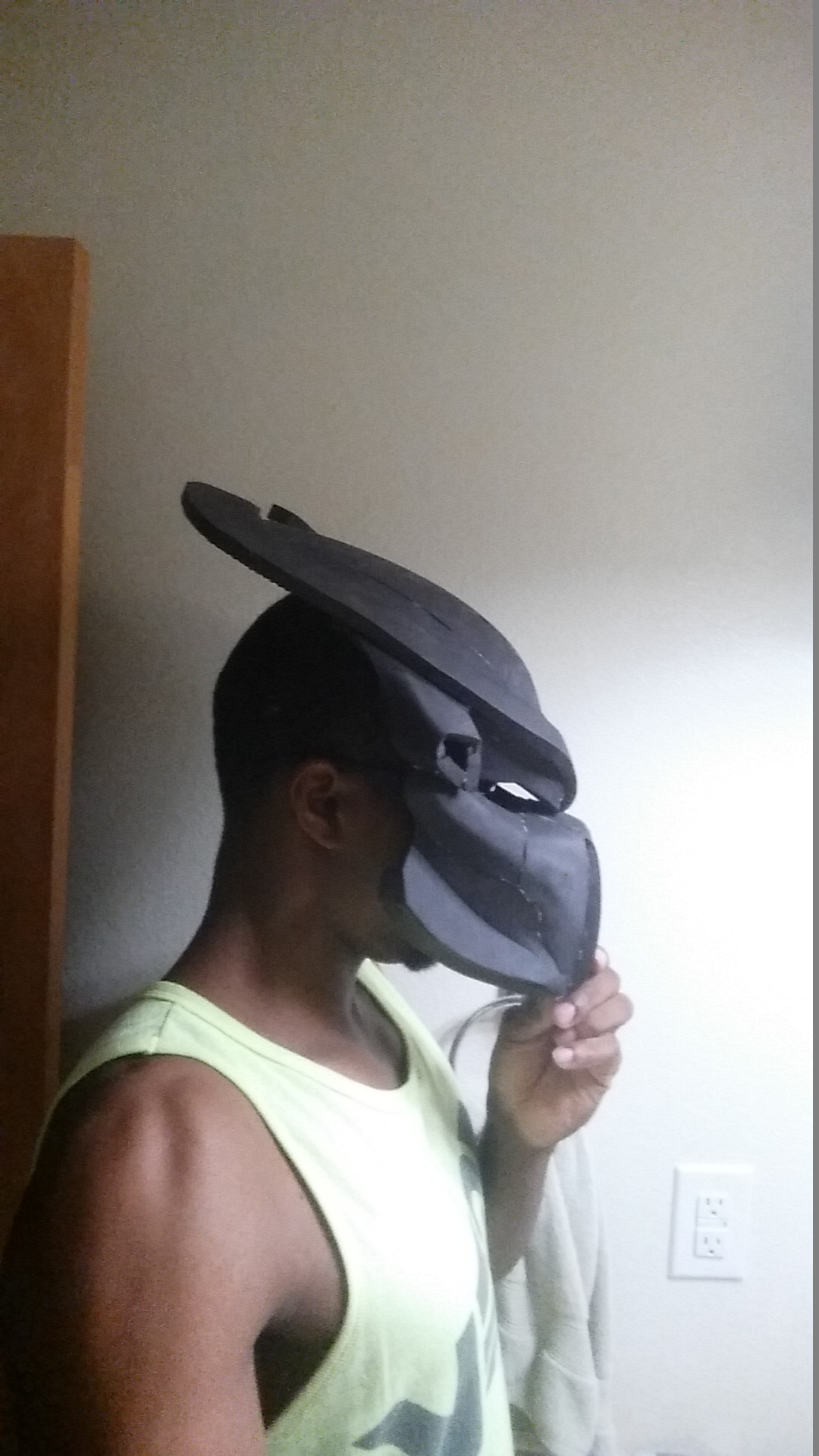

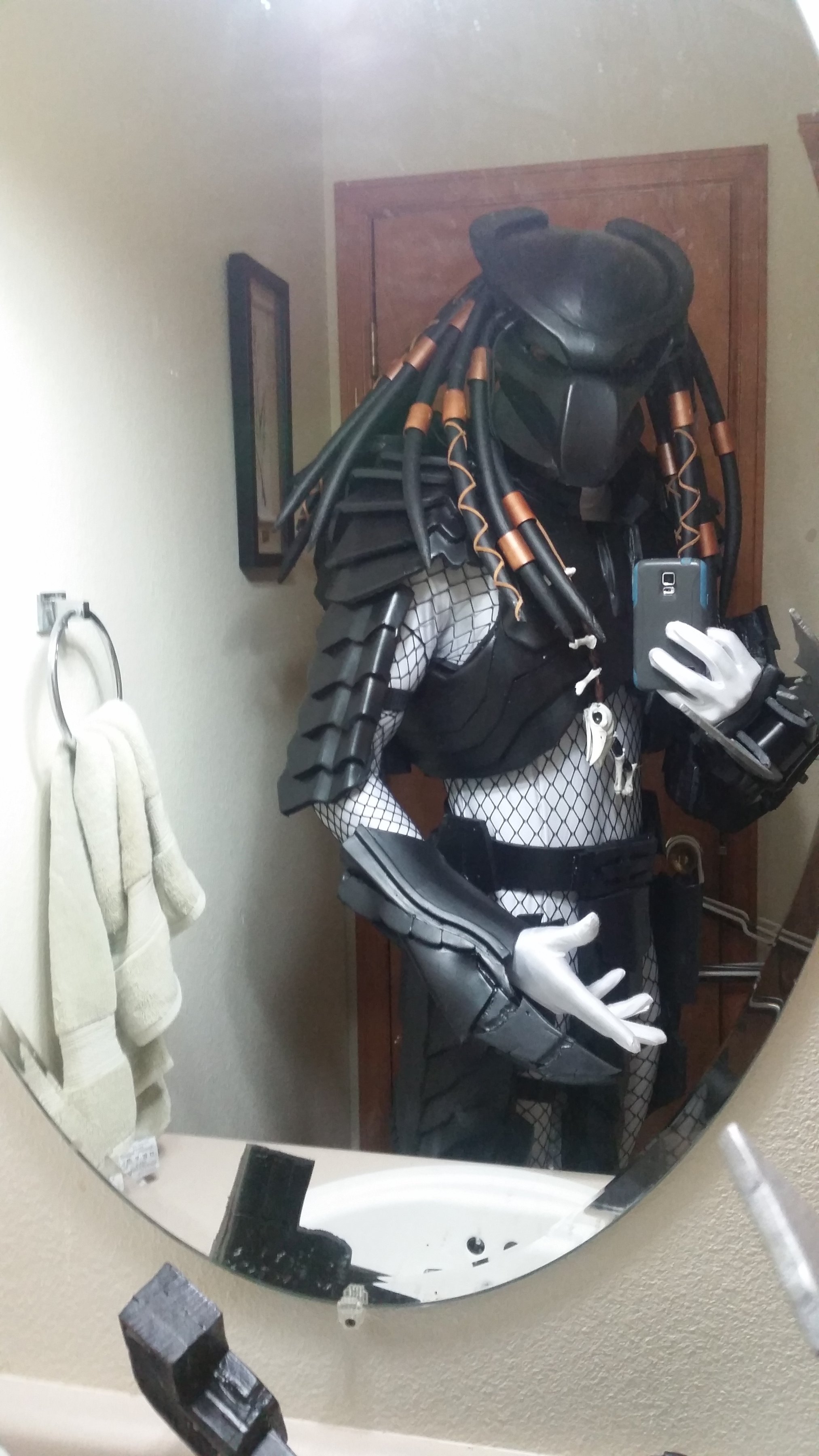

So a while back (like end of aug 2015) I began building my first predator costume from EVA foam using an AVP pepakura file I found on the RPF. (http://www.therpf.com/showthread.php?t=148889&highlight=Predator+Costume) Working the morning before work and all day on weekends I was able to build the armor portion by October. Kind of shy person so I never posted a build forum, but a fellow member encouraged me to share it...so here it is! I tried to take a lot of pictures.
I used an open face spandex suit for the skin. My plan is use an airbrush to paint the skin, and add some weathering detail to the armor. Also I want to change the dread/helmet so that I can wear them comfortably.

Thanks man! I'm 6' 1 so that helps complete the look haha. Id have to say I'm quite proud of the cannon, I rigged it up using pvc and an old pre-workout container haha

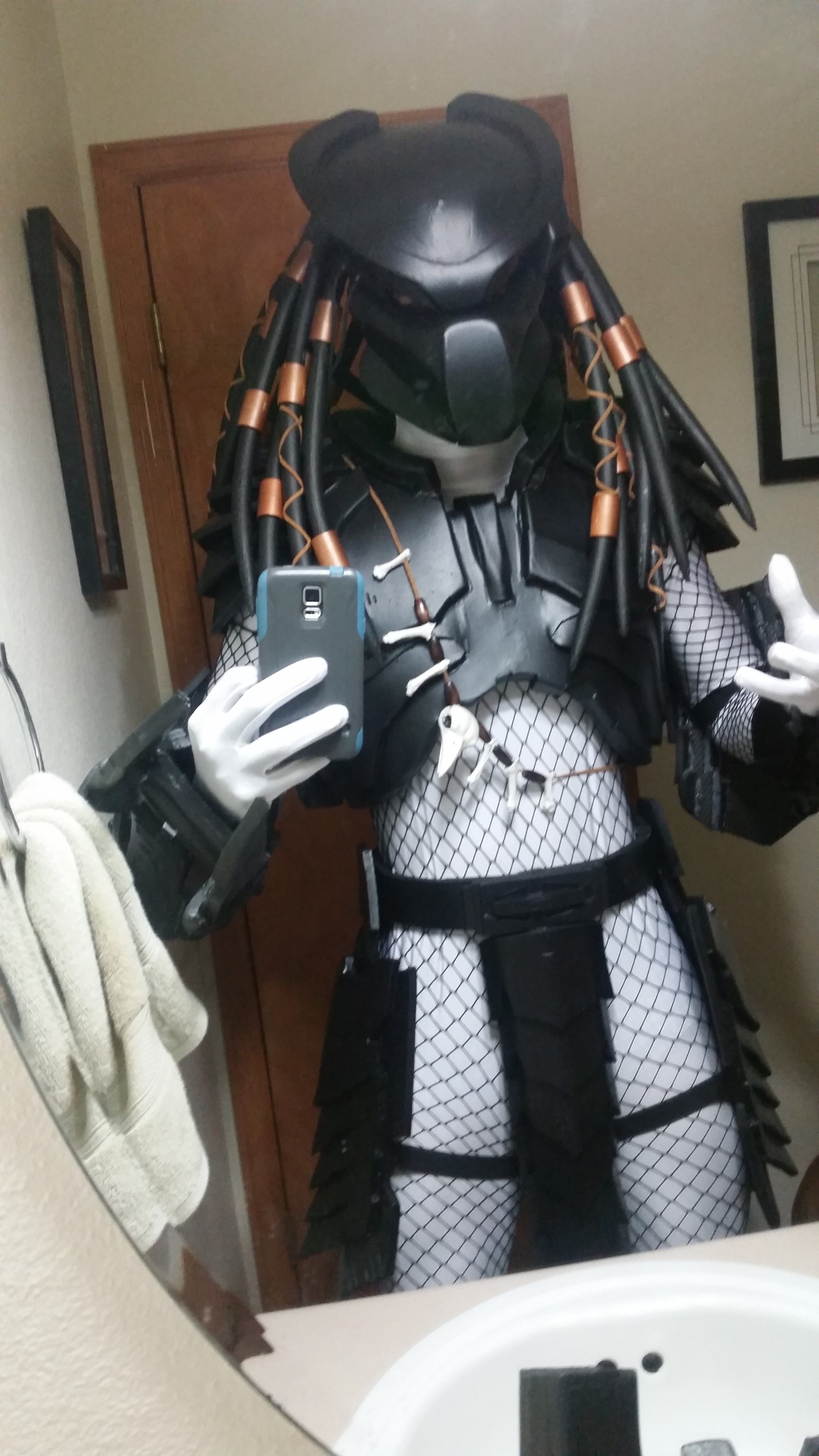

This is one really nice foam suit build. Excellent job, you should be proud of this one ! Is that a full fishnet body suit for the netting ?

Thanks! Yeah it's a full fishnet body suit...with a twist. I didnt know how to sew actual fishnet into the shirt and bottoms I needed, so I bought a fishnet bodysuit (it's basically lingerie haha)

I searched on Amazon for fishnet body stocking and browsed through the results trying to find one that best fit the predator look. It was $7 plus shipping, so not a bad deal.

Still really digging the bio by the way. What did you use to get the shape? Did you use a pattern, or were you just winging it?
Oh..... and love the base paint..... what did you use.....details! Details!!!!

Thanks haha, Well the helmet was put together using a pepakura file and lots of patience haha. THe first one didnt turn out to pretty so I remade it and was happy with it when I cleaned it up and smoothed the seams.. Well the base paint is a mix of a hammered steel and black. I misted with the hammerd steel, then went in a misted the black. Then went back over with the hammered steel as a mist, also kinda bursting the paint at angles to make it look kinda scratched/stained and blotched in certain areas. More or less repeated that about 4ish times until I got the base color before I went and added the silver dry brushing. I still want to do some more detailing and weathering but that will probably come this summer when I have more time to experiment.
