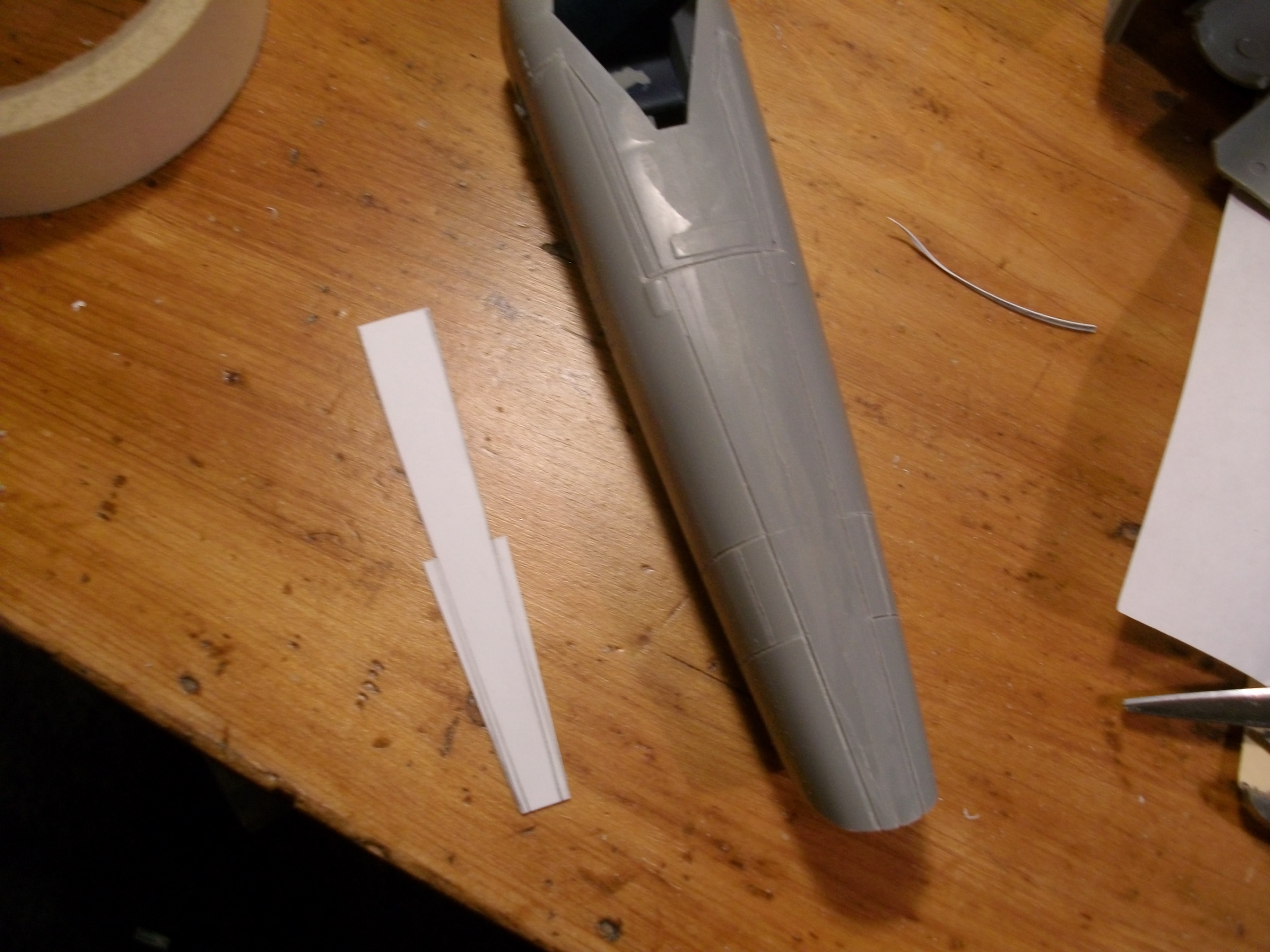

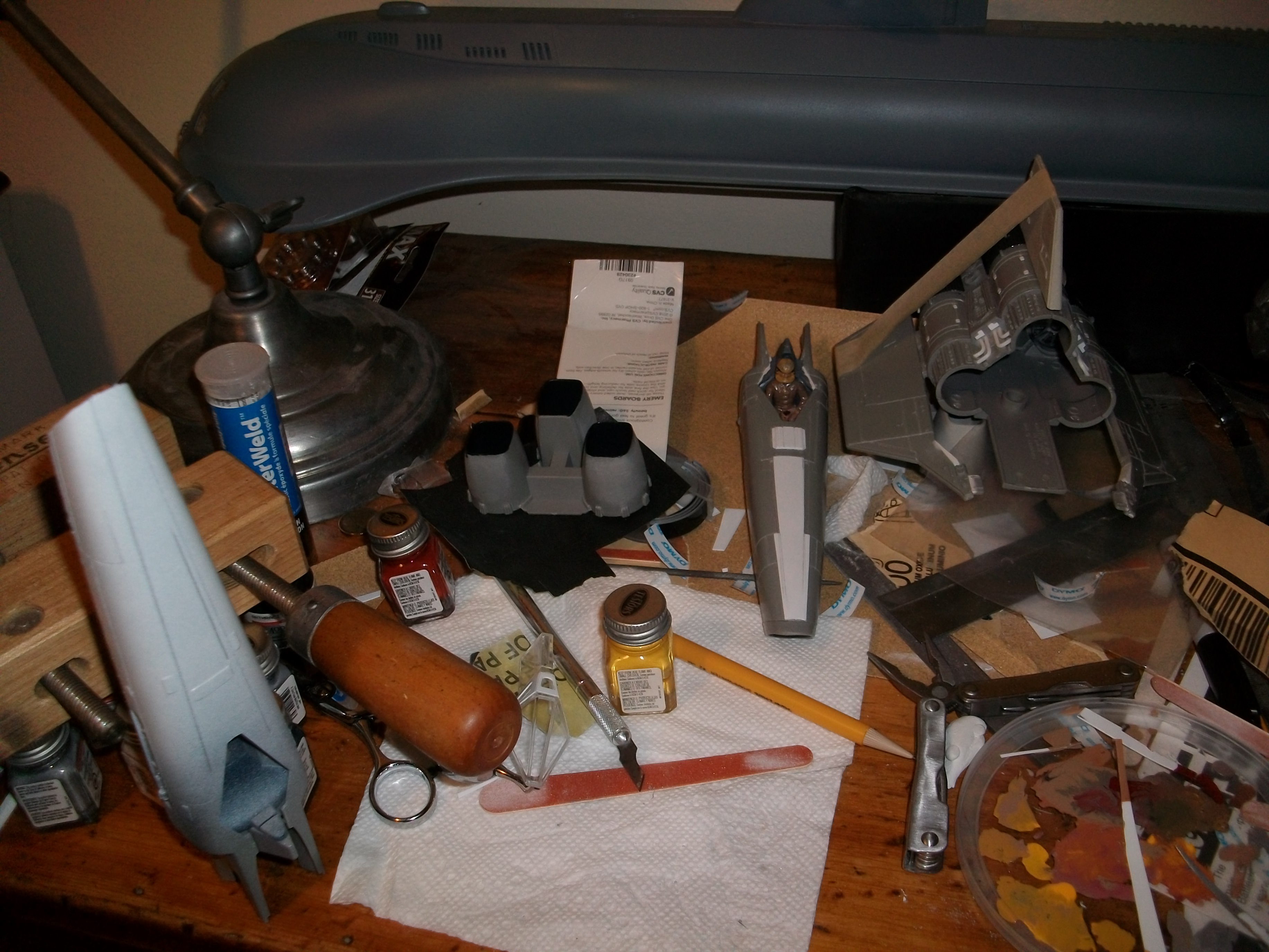

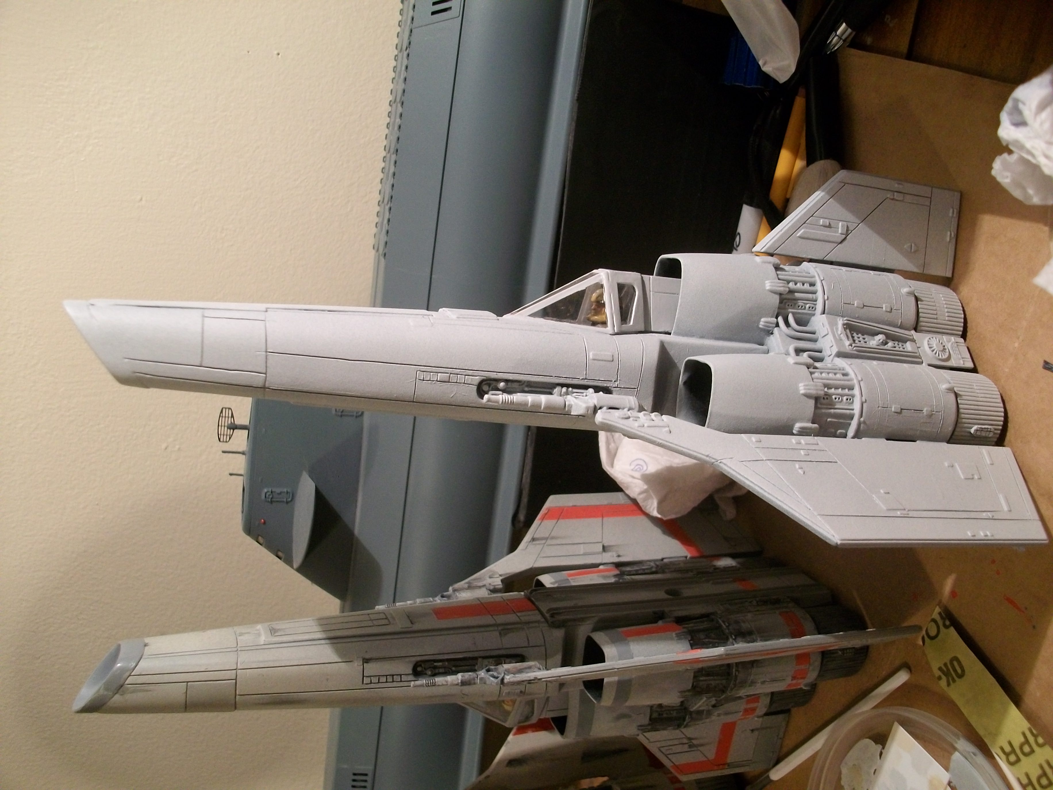

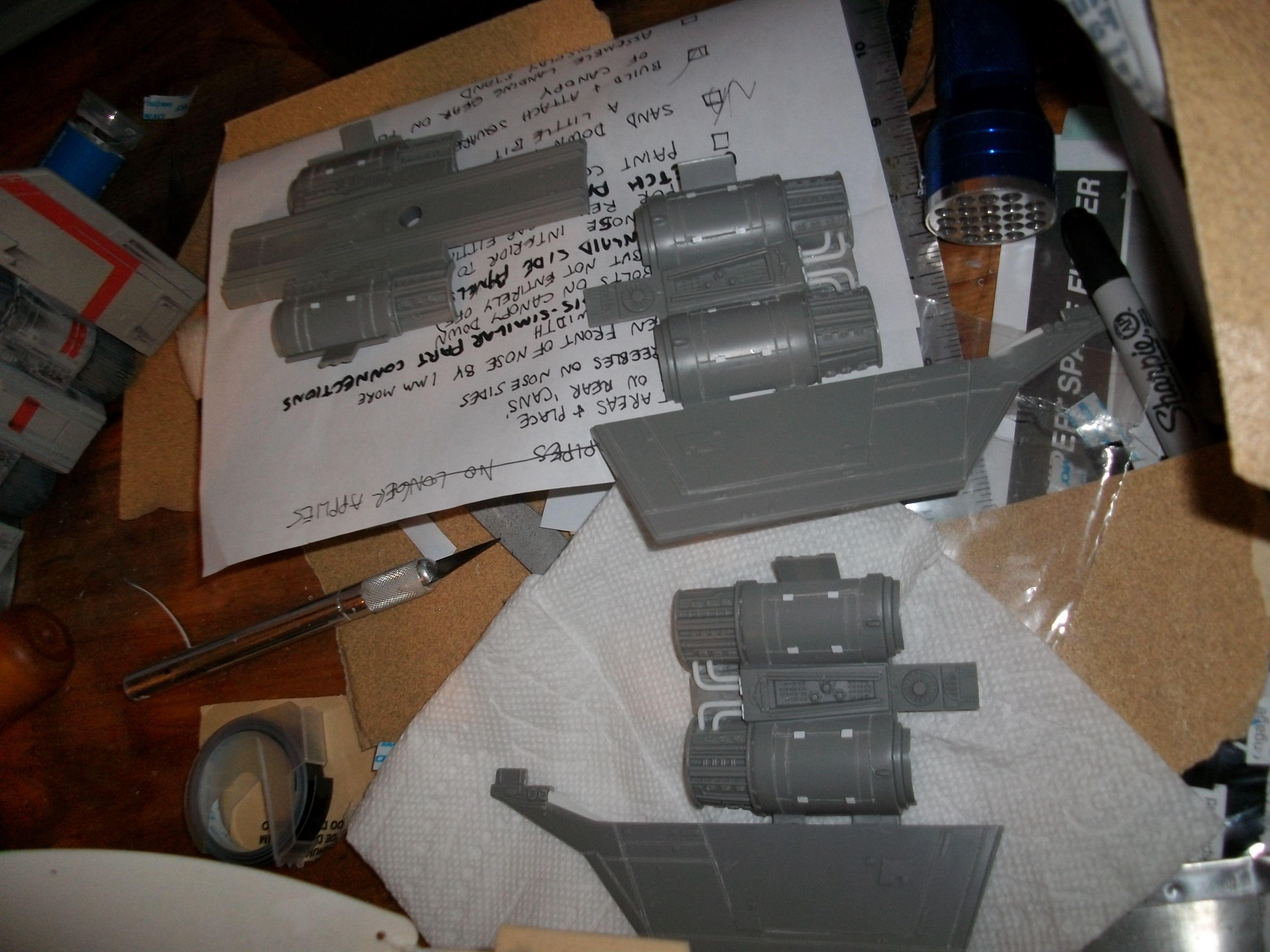

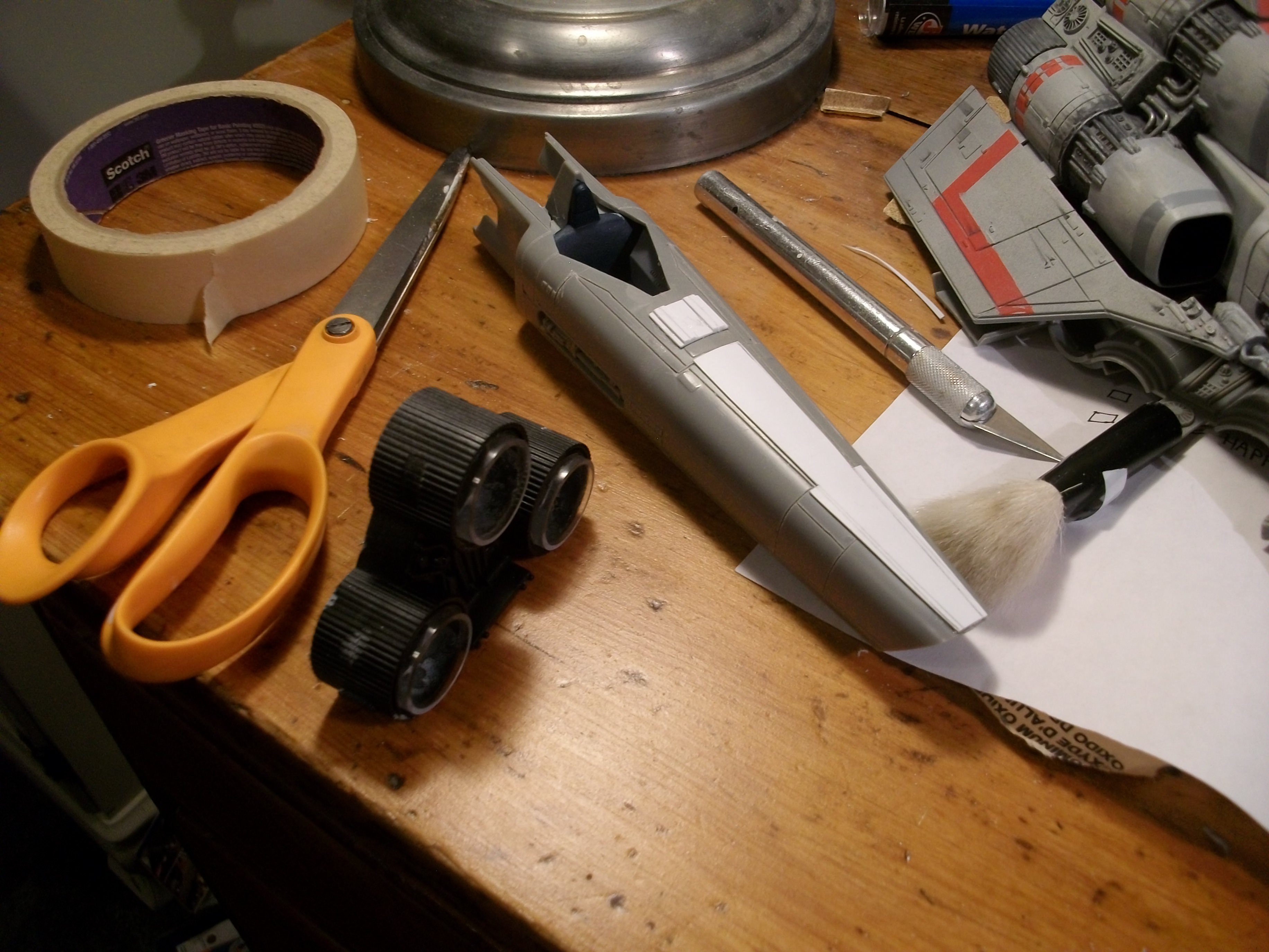

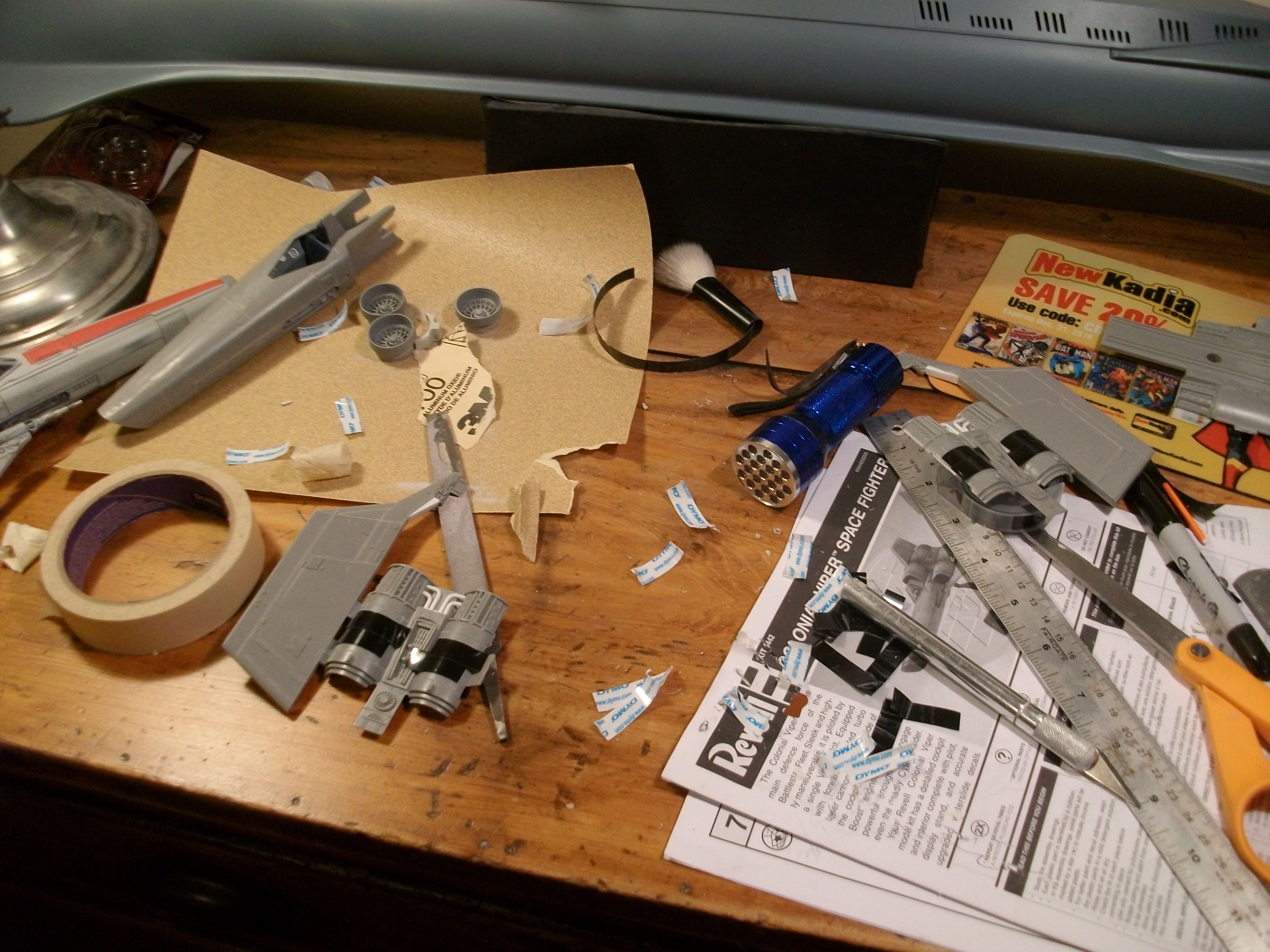

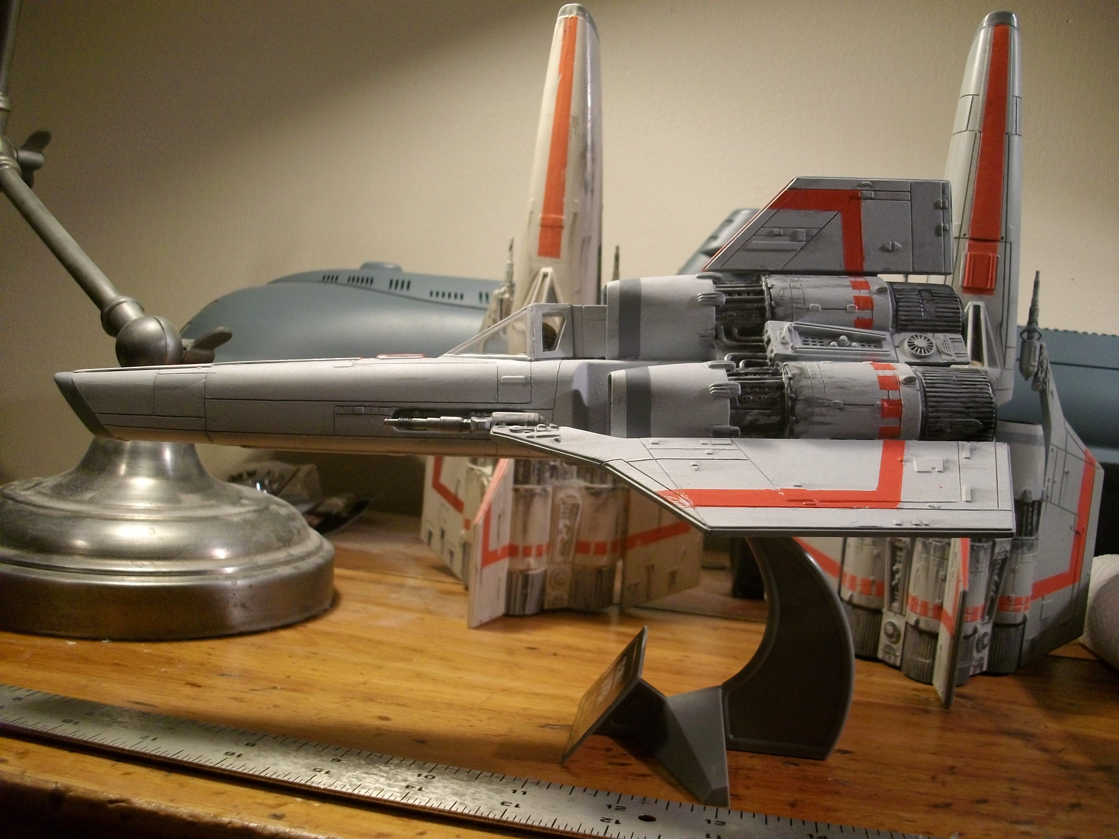

Originally, I bought the Moebius Viper kit, but last month, the more I examined it, the more dissatified I was with it. It was pointed out to me that it was based on the full size mock up, not the filming miniature, and then it made sense. I stopped trying to modify it into a filming miniature and went back to the Revellogram kit I had been working on yahrens ago, but took an indefinite pause on. So last week I reluctantly went to town on it again. I had already modified the guns, put a fabricated grill in the nose, and switched out the side piping with thin tube styrene, so that was done. So I gritted my teeth and spent a solid 3 & 1/2 hours scribing the panel lines, then modified the rear of the cockpit, and canabilized the Moebius clear engine part to thicken up the cans at the rear openings. I also snatched the Moebius high tail fin as it's closer to the correct length than the Revellogram's (IMO). I also sanded down the 'buldge' on the three intakes to make them straighter, and thus more accurate (that took an hour). So yesterday I finished building, and there was much rejoicing (by me) that it turned out pretty nice. Now for the painting... currently doing tests... any suggestions? 40 years ago I basically nailed the colour on my first Viper with Testor's small bottle paint so I'm going that route this time as well. Problem is I don't remember what I actually used back then. Obviously flat black & flat white... but I'm seeing if yellow or tan additions will yeild that particular on-screen FX shots look again....

I think it IS accurate- to the full size mock up. I tried to modify it to be the filming miniature, but it was turning ito a ridiculously involved project... for all of it's problems (no panel lines; inaccurate canopy; the ridge on the intakes you need to remove...), the Revellogram's lines are pretty flawless (exept for the high fin being a few mm's too short).

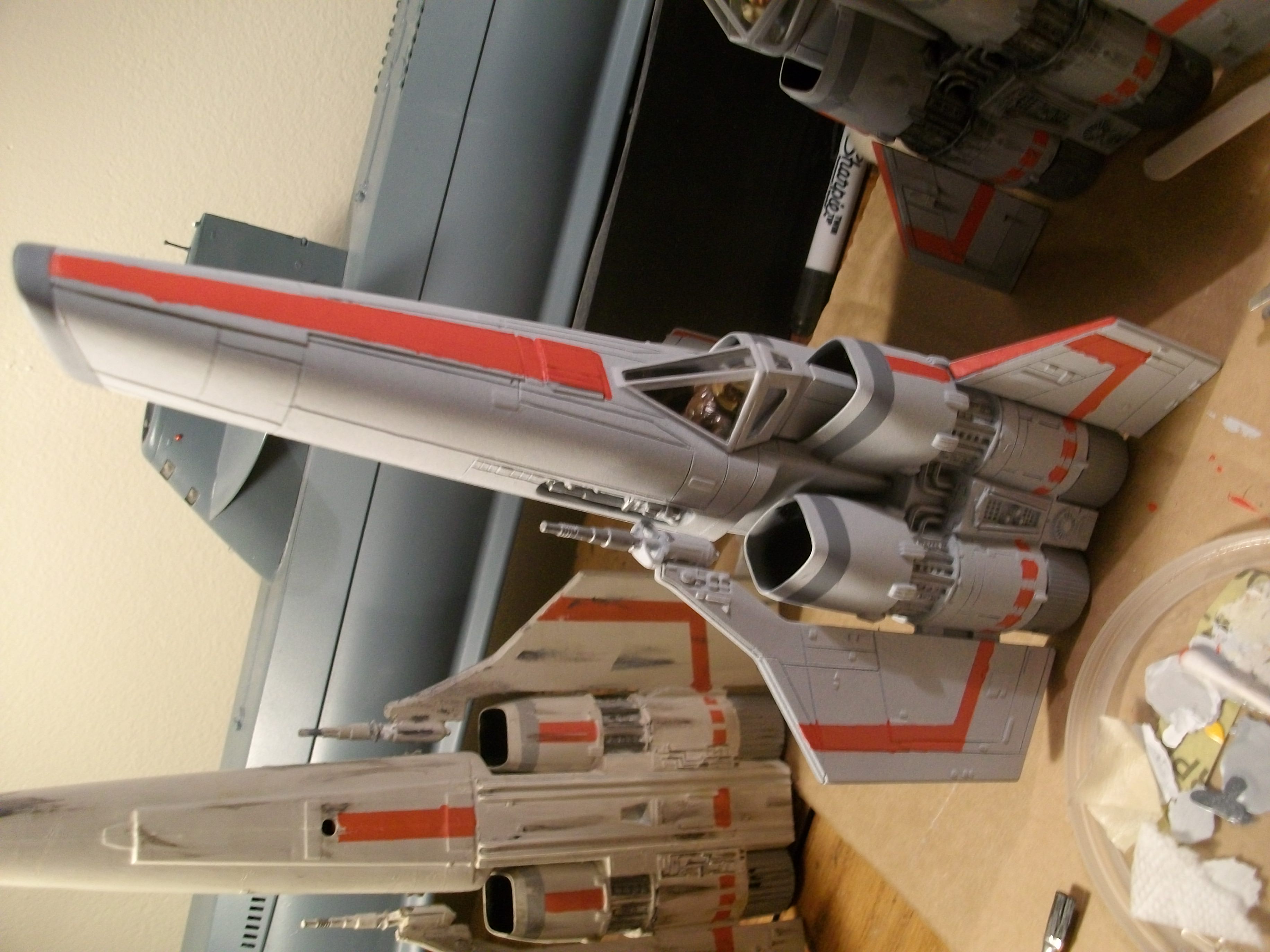

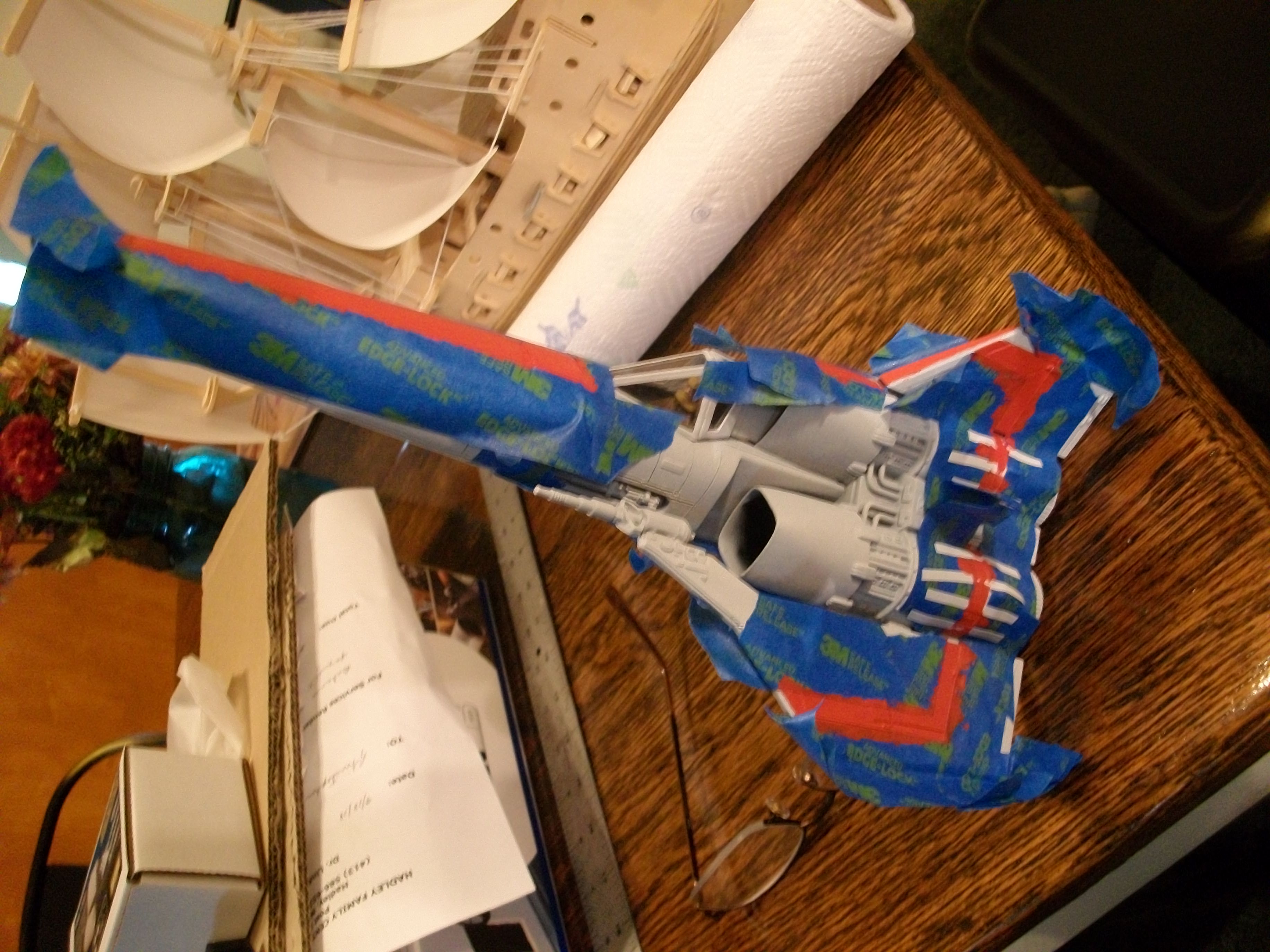

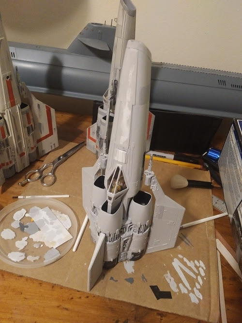

Late night touch up before clean-up and red/orange stripe painting tomorrow (I hate decals). Nice having two days off in a row just now!

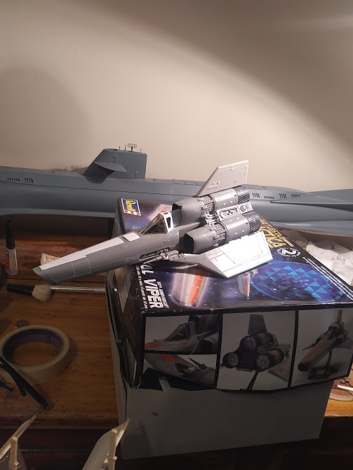

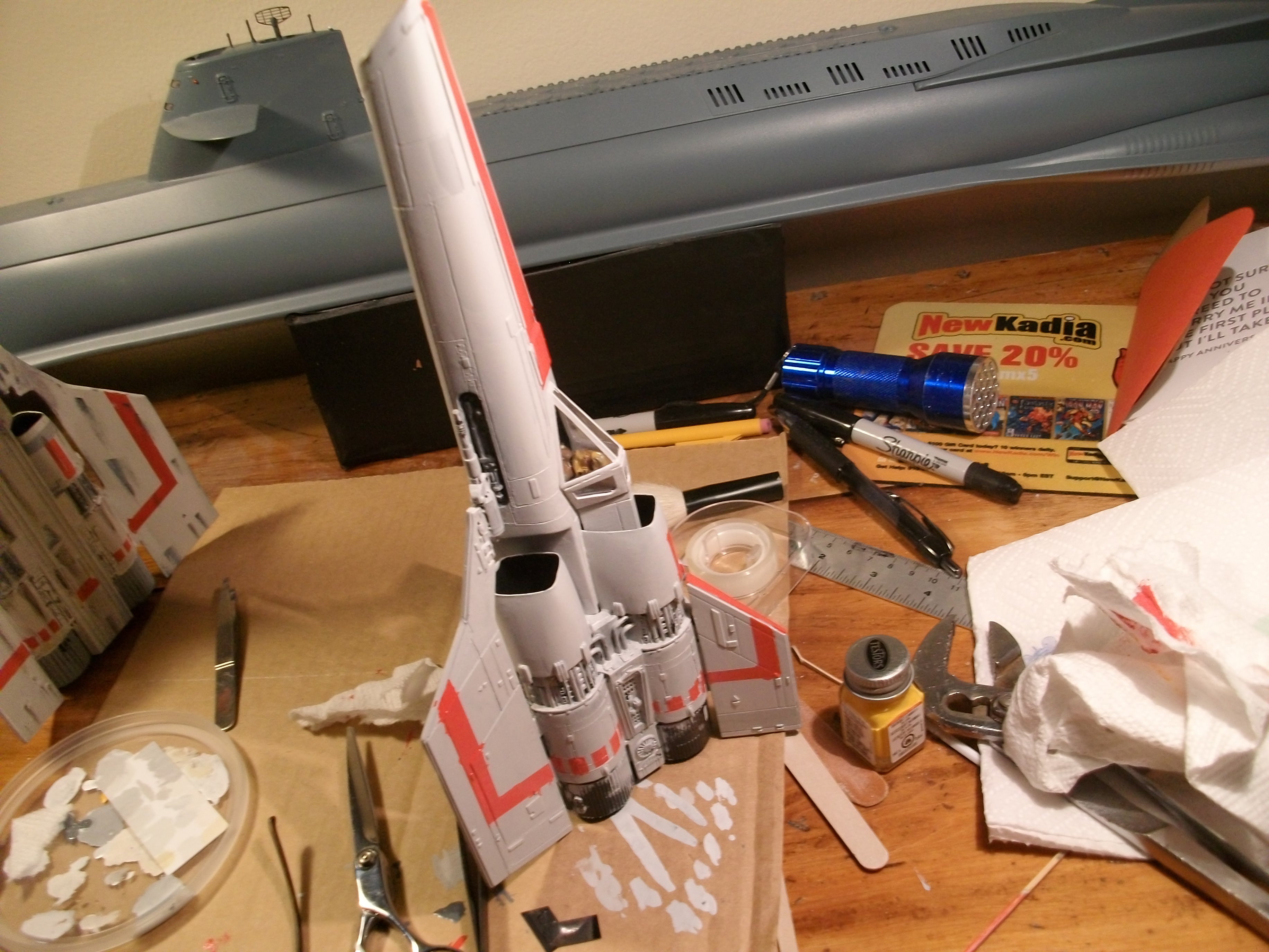

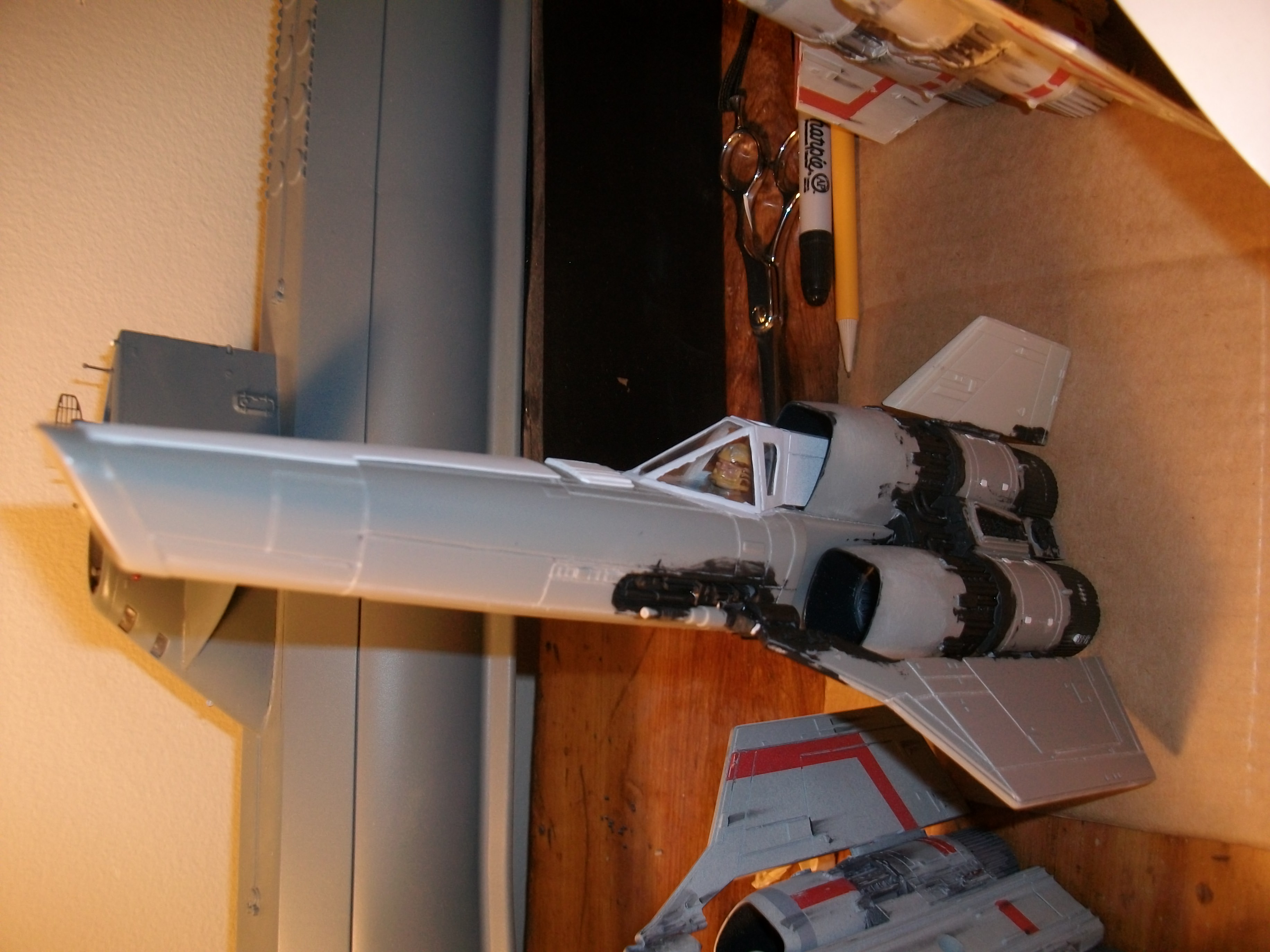

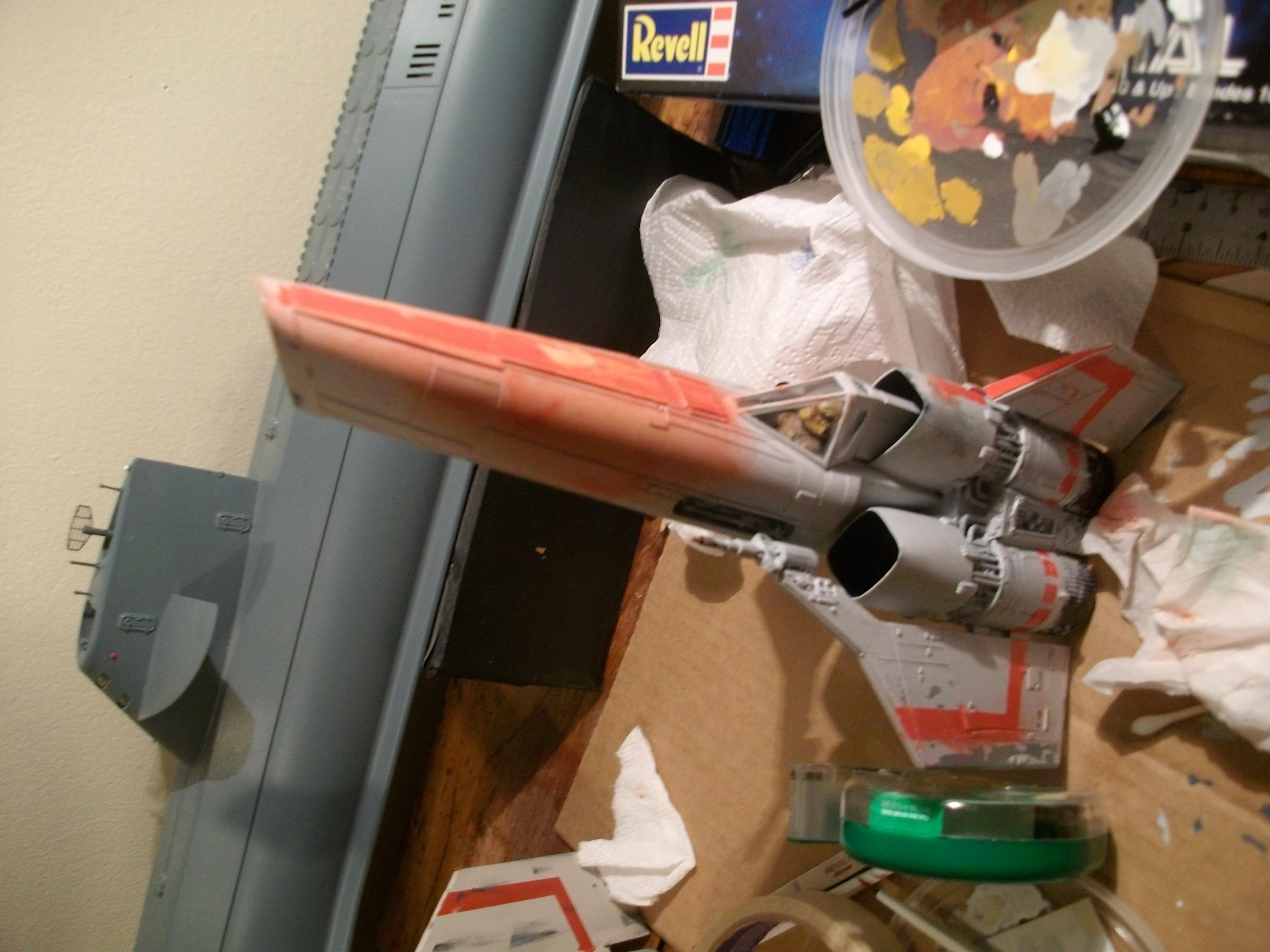

FRAK! The tape I used was cheap tape, and left a felgercarb residue that would not come up and reacted with the enamel. I had to strip it with WD40. Washed with soap & water, back to painting square one. Primer tomorrow. I'll make it better, stronger, faster! In the mean time, it's a Blood Viper on a blood hunt...
I painted the hull with Krylon this time, a mix of flat gray & flat white, sprayed in super-thin coats until I got the right lightness & darkness. The whole thing will appear a bit darker after I add the 'dirt washes' to it.

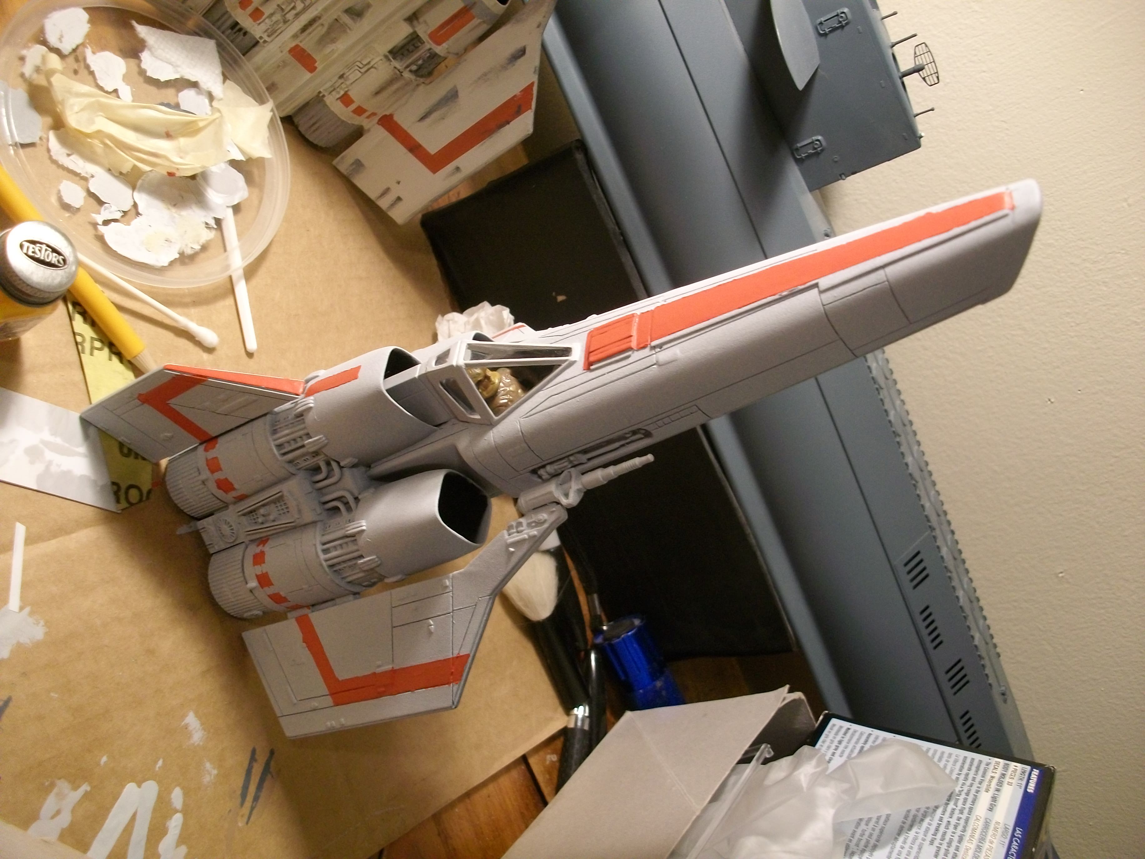

Just painted the canopy. I'll have to clean up a line or two there. No biggie.
Even with the little flaws, I'm lovin' how it's turning out.

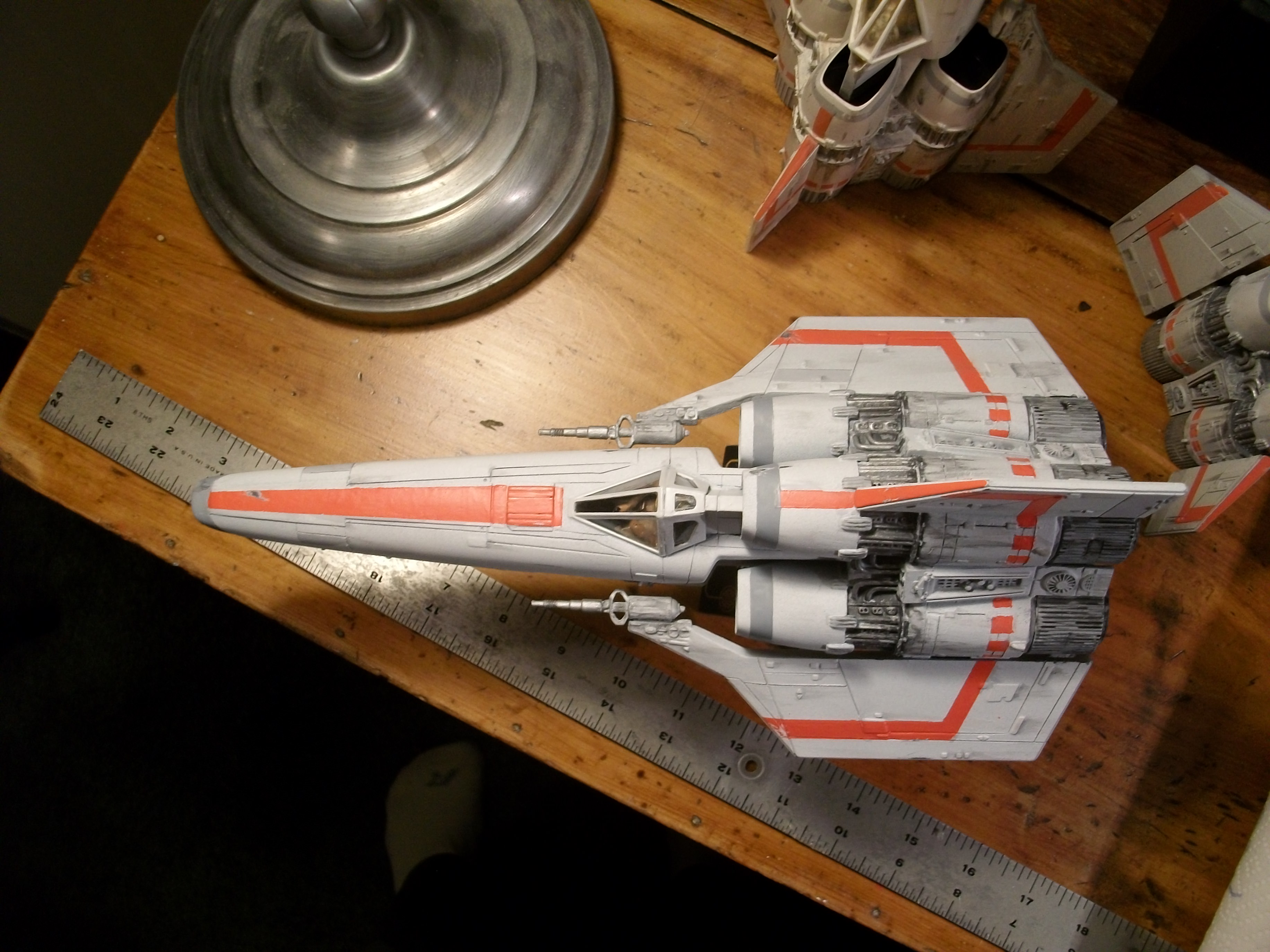

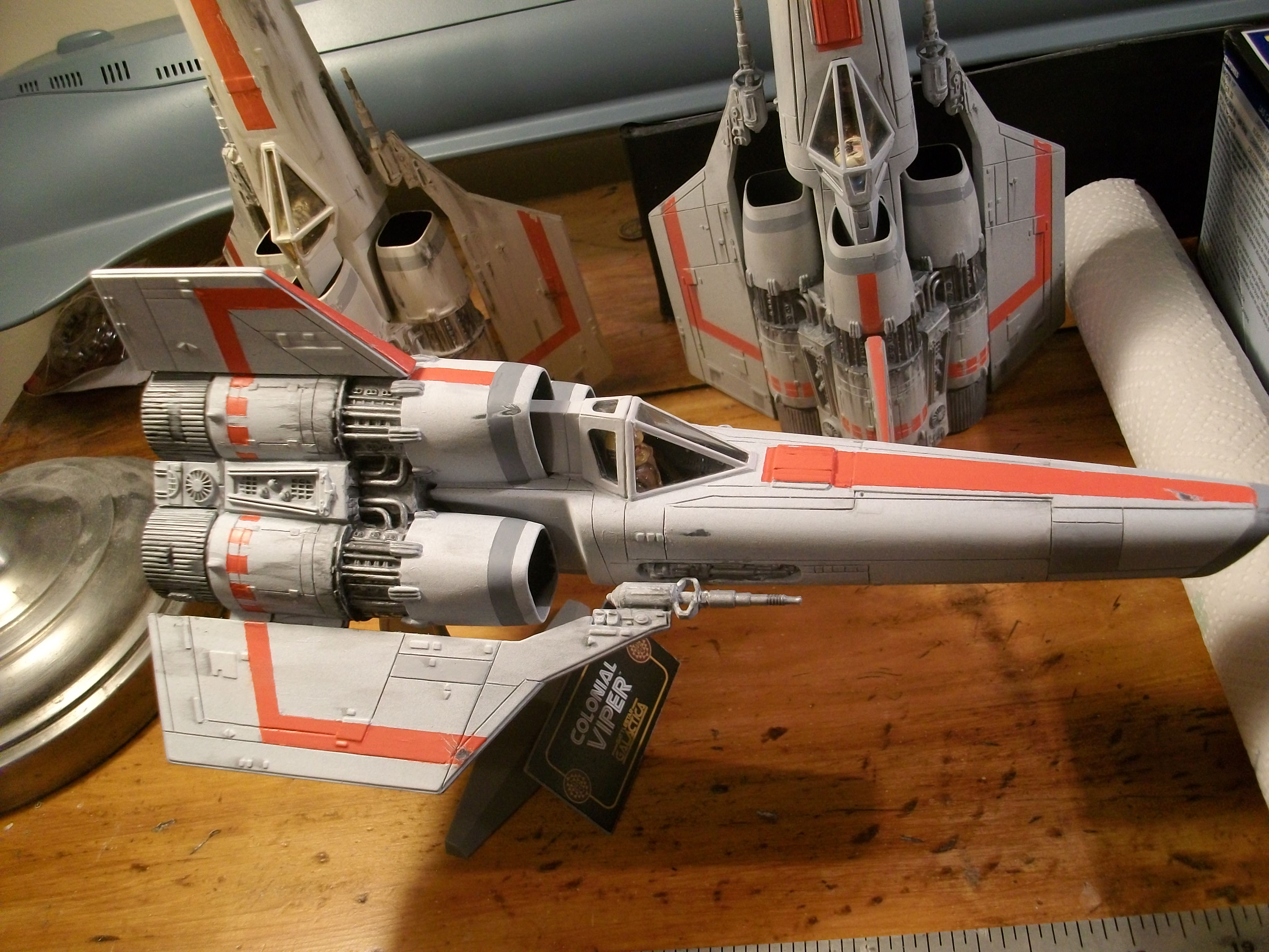

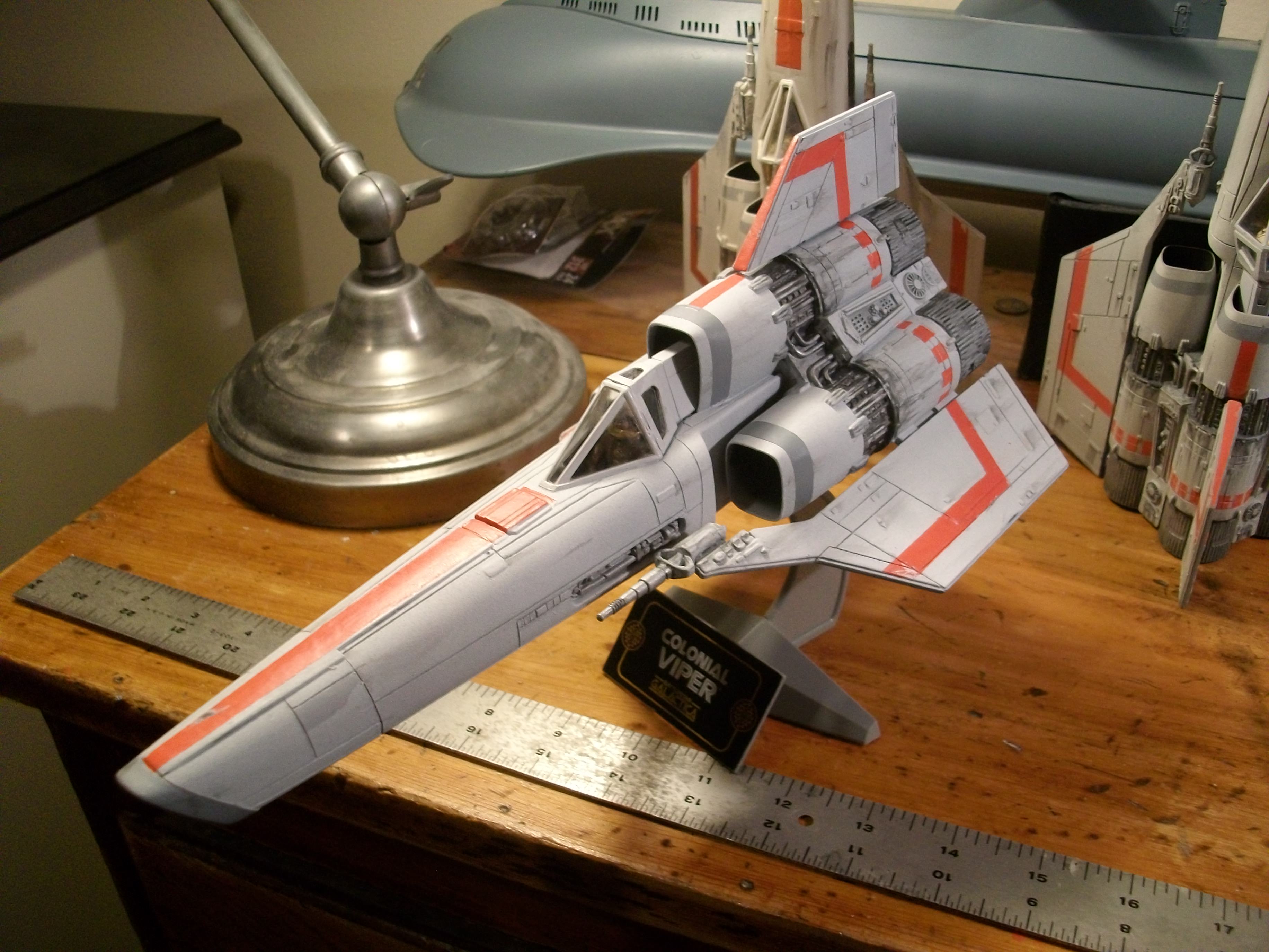

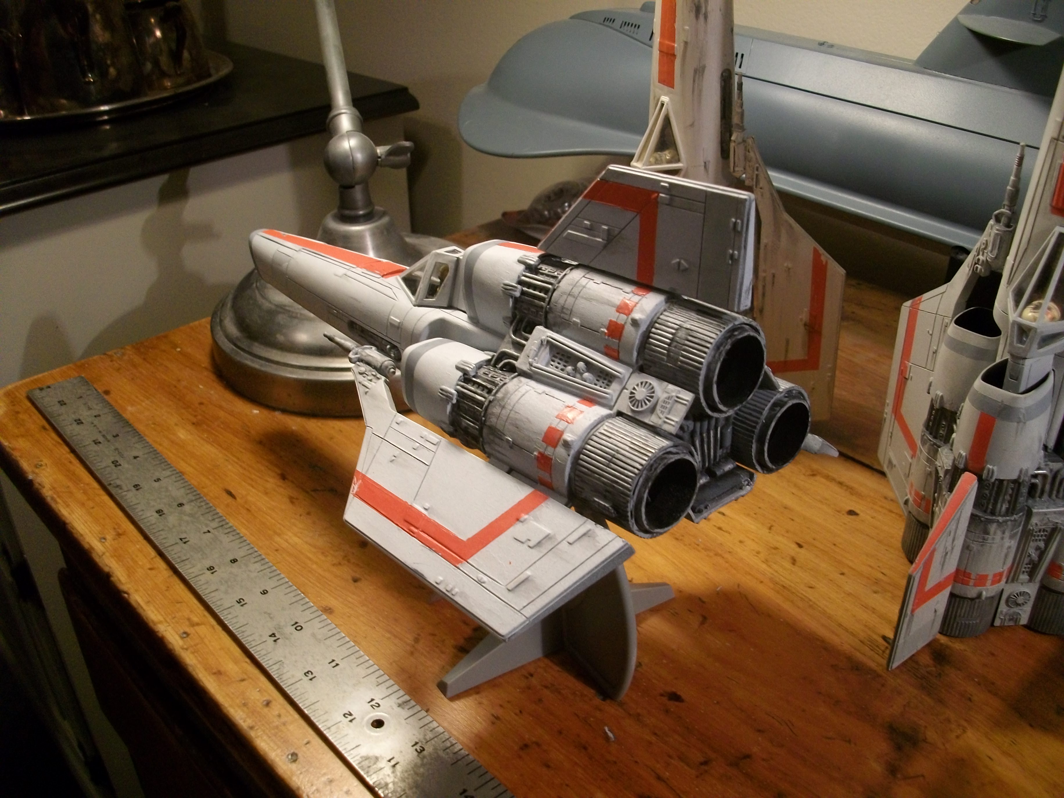

I just finished the main painting, next (after it dries) I'll clean up the edges of the orange lines and she'll be ready for the dirt job! Nearly finished! Yahoo!
Really nice! I'm glad to see you didn't over-weather it. I think a lot of these kits get overdone a bit in that area.
