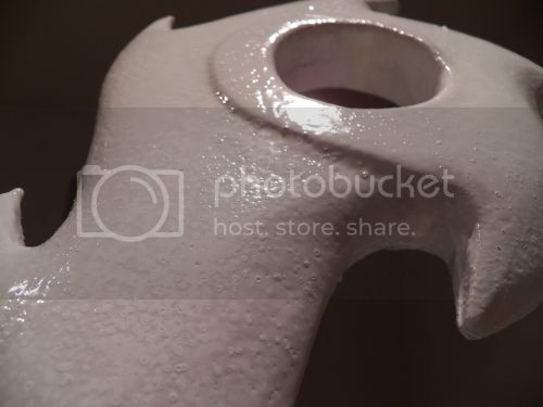

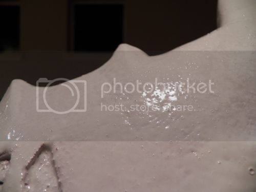

So after the 3 layers of styrospray, this is what it ended up looking like. I made the mistake of having my heat lamp too close, and it cause bubbles. Now we know, if you leave a heat lamp to close, it bubbles! Probably just too much heat in general will do that. Luckily, I was able to sand out the bubbles very easily, so that wasn't too much of a problem.

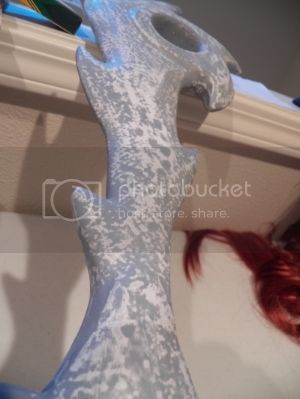

These pics are after my first layer of primer filler. You can see how it dried. Sort of uneven. To the touch, and even the naked eye, it's not nearly as bad as it looked here. Nonetheless, it needed some filler to get a better surface. This would have been much btter had it been sprayed.

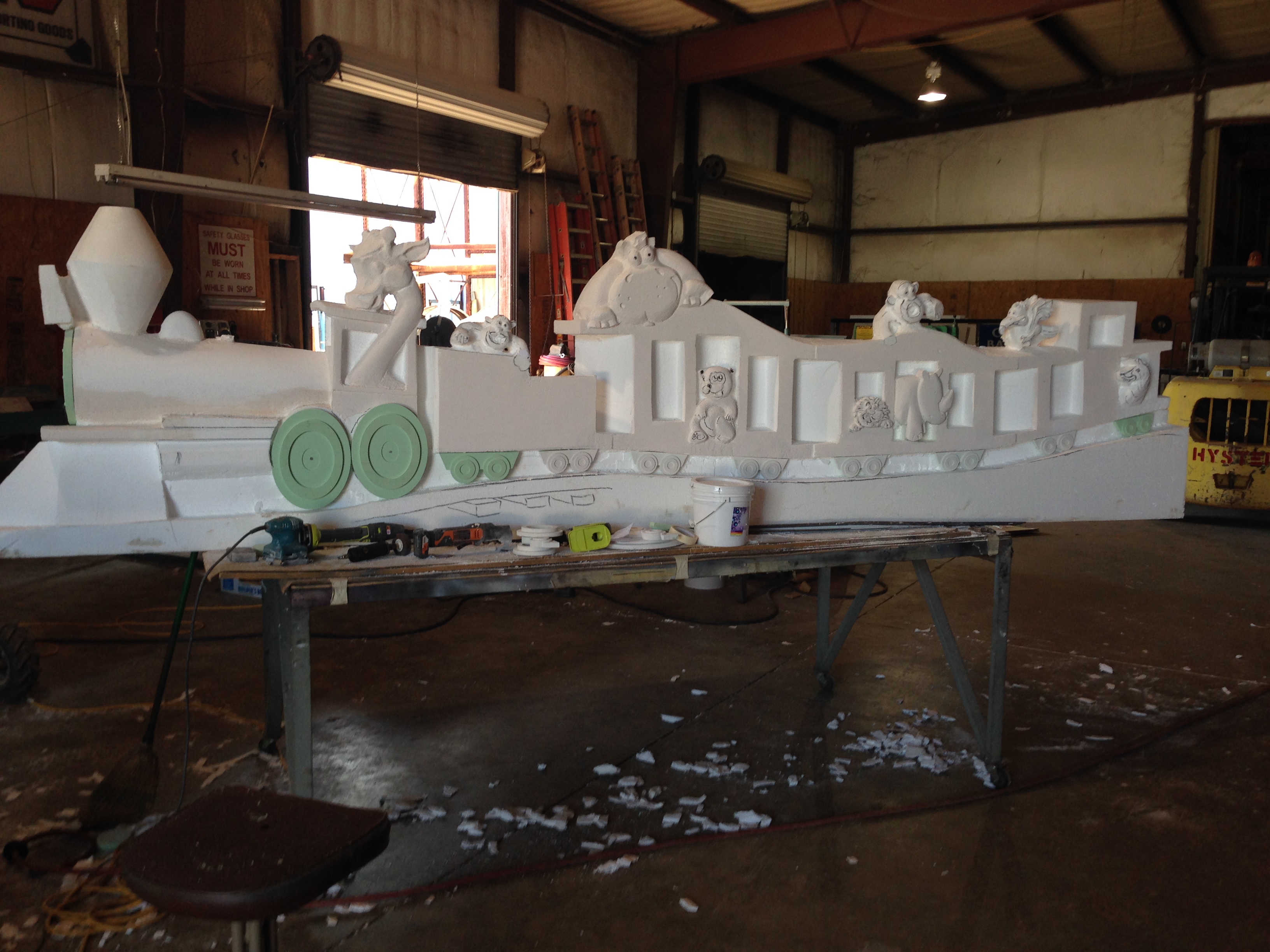

This is a choo choo train 14ft long i am making for daycare sign exterior, windows lit by led to give train night time look. My question as i am new to styro 1000 is putting details be for coating useless. Should i put 4 coats and then detail before airbrush. Just want enough relief details to give a good look. Wheels , monkeys ,engine need more finishing. Please feel free to give advise. Need a slick finish so colors will be bright enough. My understanding is sand before each coat. After airbrush does clear coat adhere good.
