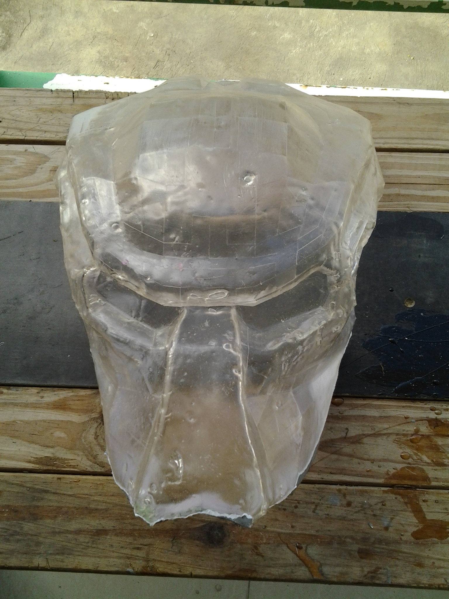

I have finally finished the shoulders and biceps ( I now have to figure out how to fasten it all together).
Whilst waiting for the wood to dry, I made 3 biohelms from Pepakura files and made myself a mannikin ( with an appropriate head),
and made some dreads from black cotton cloth,stuffed with fibrefill and painted with 2 coats of latex.
Here's the results
