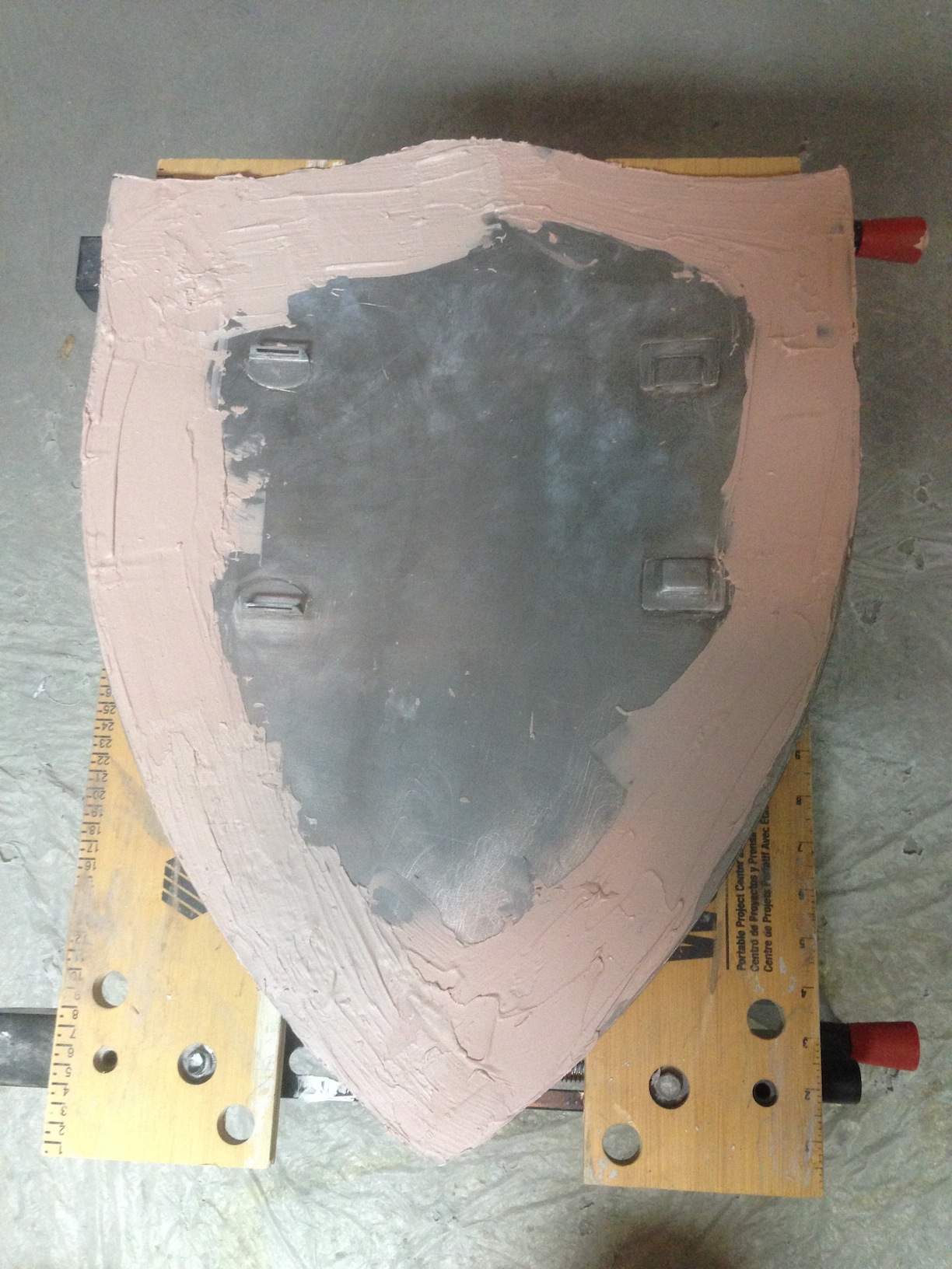

But the back has a strip of metal that welded around the edge (used to reinforce the shield) that makes it look less than authentic (used to reinforce the shield). So, I decided to do something about that. I filled in the back back of the shield from the reinforced edge to about three to four inches in with Bondo.

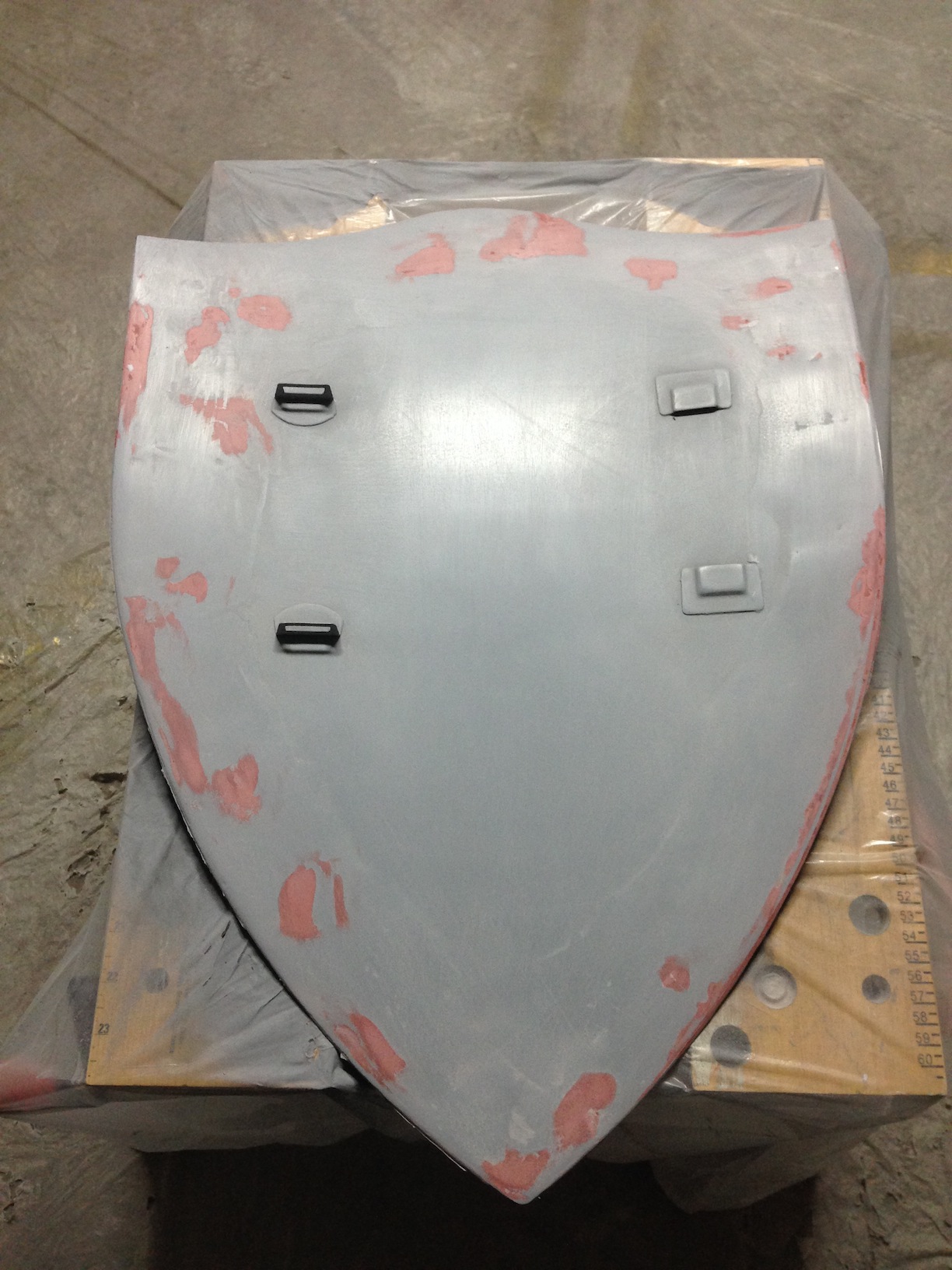

Next, I sanded the Bondo smooth and feathered it into the metal as best as I could. Then, I primed the back with Rust-oleum Filler Primer, wet sanded it smooth, and filled in little pinholes with Bondo Glazing and Spot Putty.
I next re-primed and re-wetsanded the back.

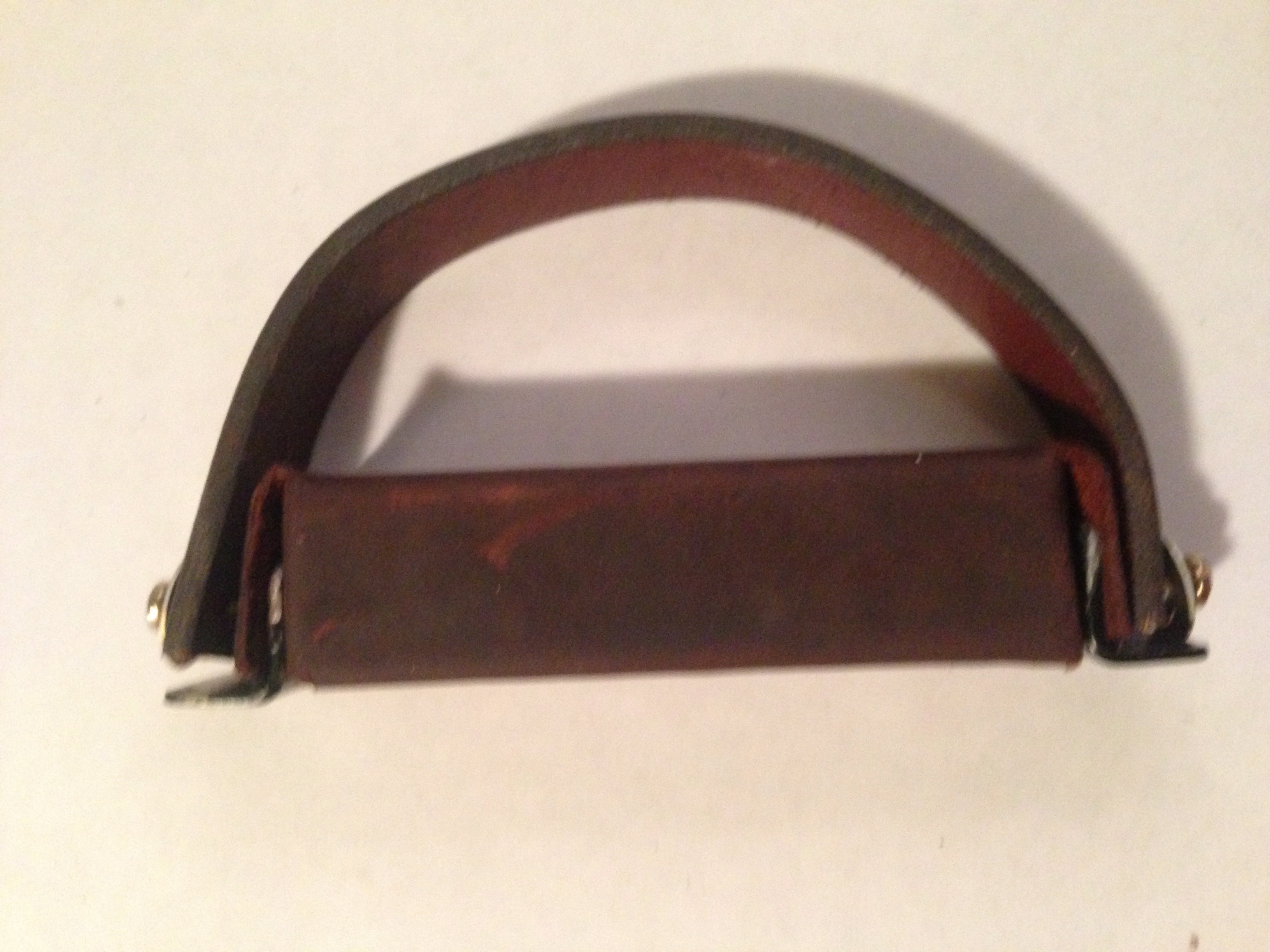

For the arm strap and handle, used dog collars. They are darker than the leather used on the original, but I like the color better. The arm strap is adjustable so it can be fitted it wearing a jacket (which I need to look for Cap's leather "Bucky Rescue" jacket) or just a shirt. The arm actually under the lower strap and against the shield itself. The handle is attached using a leather wrapped piece of 1"x1" wood. I reused the hardware that came with the shield (slightly modified) and some brass wood screws. Eventually, I will change out the buckle and keeper on the arm strap to brass ones.

First, I used the same heater shield that most have used:
