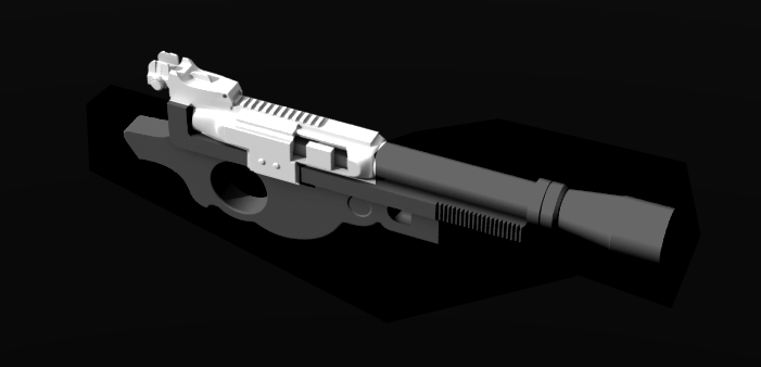

I've made a start on his sidearm, and am noticing some things that aren't directly apparent, but at the time of writing this the 3d model isn't worth showing. (I basically spent the entire weekend assembling reference to work from, including doing a lot of color de-grading and things to analyze available images.)

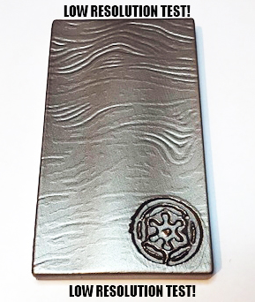

However, I have made a bit of progress on the Beskar ingot- so much that I have a rough low-res prototype printed, with a higher detailed one in the works. I was able to use the method I developed for a couple other projects, similar to photoscanning, to transfer details directly from the screen prop onto my 3d model, which preserves and replicates a lot of details almost exactly- far more that what would be possible just hand-sculpting.
In the show, it looks like we saw a couple versions of the prop- one just for show and one for melting. The latter one seems to have been made of pewter and has a bit of a texture to it, while the former is smooth. I have some ideas of how they did the wavy pattern... some have mentioned hydro-dipping and maybe that's what was done, but for the fact that it'd be impossible to get more than one copy exactly the same, and the waves seem a little too thin and perfect. (Dipping tends to be more chaotic.) I have some other ideas that I might explore.
I'm also talking with a metal foundry about casting some in aluminum!
In this first version, I transferred all the details- wavy pattern, Imperial stamp (and indents on the back) but I'll probably move onto a version without the wavy pattern.

This is just the raw print, painted with Citadel (Games Workshop) "Lead Belcher", which is a great metallic base for a lot of things.
I kept the billowing surface

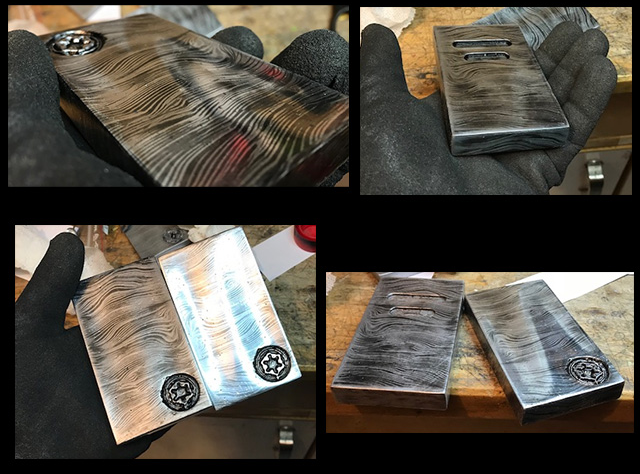

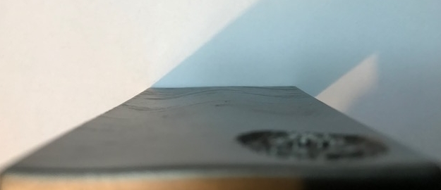

Kinda funny how things develop sometimes. When I got home last night I had a "screw it, lemme try something" moment while tinkering with the ingot. A short while later, after several simultaneous attempts at dealing with the antics of a crazy kitten, I had this:
Keep in mind that this is VERY roughly done. The color needs work and I only had a brick with the lines engraved handy (the smooth one was still processing) so you can still see the grooves (which kinda look like wrinkles) but overall I'm pleasantly surprised with this. I've confirmed that they used different ingot props in the episode (at least 3, I think) and they all have a different wavy pattern on it. This supports the idea that they were hydrodipped, after all, though I'm still not completely convinced. (The pattern still looks a little too sharp to me for dipping, but I'm going to give that a try too, just out of curiosity.)
Still a lot of tweaking and testing to do, but I think I'm going to abandon the "engraved pattern" route and just keep the screen-transferred Imperial stamp. At first I was thinking that transferring the pattern would make it "feel" more authentic since it was directly from the prop, but it's not gonna look right. Adding the pattern later will, and keeping the stamp, which was also transferred from the real prop, will be enough for me.

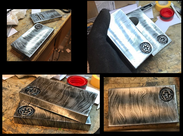

Ok, so here's the lastest ingot test:
After fiddling around a lot with a from-scratch drawn pattern, I decided to go back to the original again and see if I could replicate it with more fidelity intact. After a helluva lot of tweaking, here's the result. I'm still refining the intensity, but I'm happy with the progress.
I might do some changes to the stamp... not sure yet. (It looks a little big BUT after applying perspective correction and compensating for lens distortion, it matches up fairly well in size. The photo actually shows two different prints I did, each with the screen pattern applied and a slightly different transfer of the stamp.
Final version (I think) of the textured ingot. I've got a smooth one printing right now.

The first couple of tries (pictured above) I started to put the pattern in the sculpt, but after repeated close scrutiny of the different copies on screen (which have different patterns), it's clear that the real prop has the pattern as a transferred image, so that's what I ended up doing too.
(The idea of having it as a relief in the sculpt is kinda neat, because it makes it more "real world" like Damascus steel (which has a similar pattern, but with lots of "jagged egdes") but my goal is almost always to get as close to the actual prop as possible.
The differences in patter of the screen props kinda suggests they were hydrodipped, but for my reservations about the sharpness of the lines.

A tiny bit of progress on the blaster but I've mainly been doing the ingot. I've kinda restarted the frame three times already, and this is still in the "blocking out" phase.
Looks like the grip frame will be separate from the receiver so that I can print them without having visible seams (except where there are supposed to be seams). Receiver will be split into asymmetrical halves like the real prop seems to intend. Grips will of course be separate. Slide frame, rails and sights will be as well. Barrel will be a steel or aluminum tube. I'm also tinkering with an idea of how to screw the receiver halves together in case batteries need to be replaced.

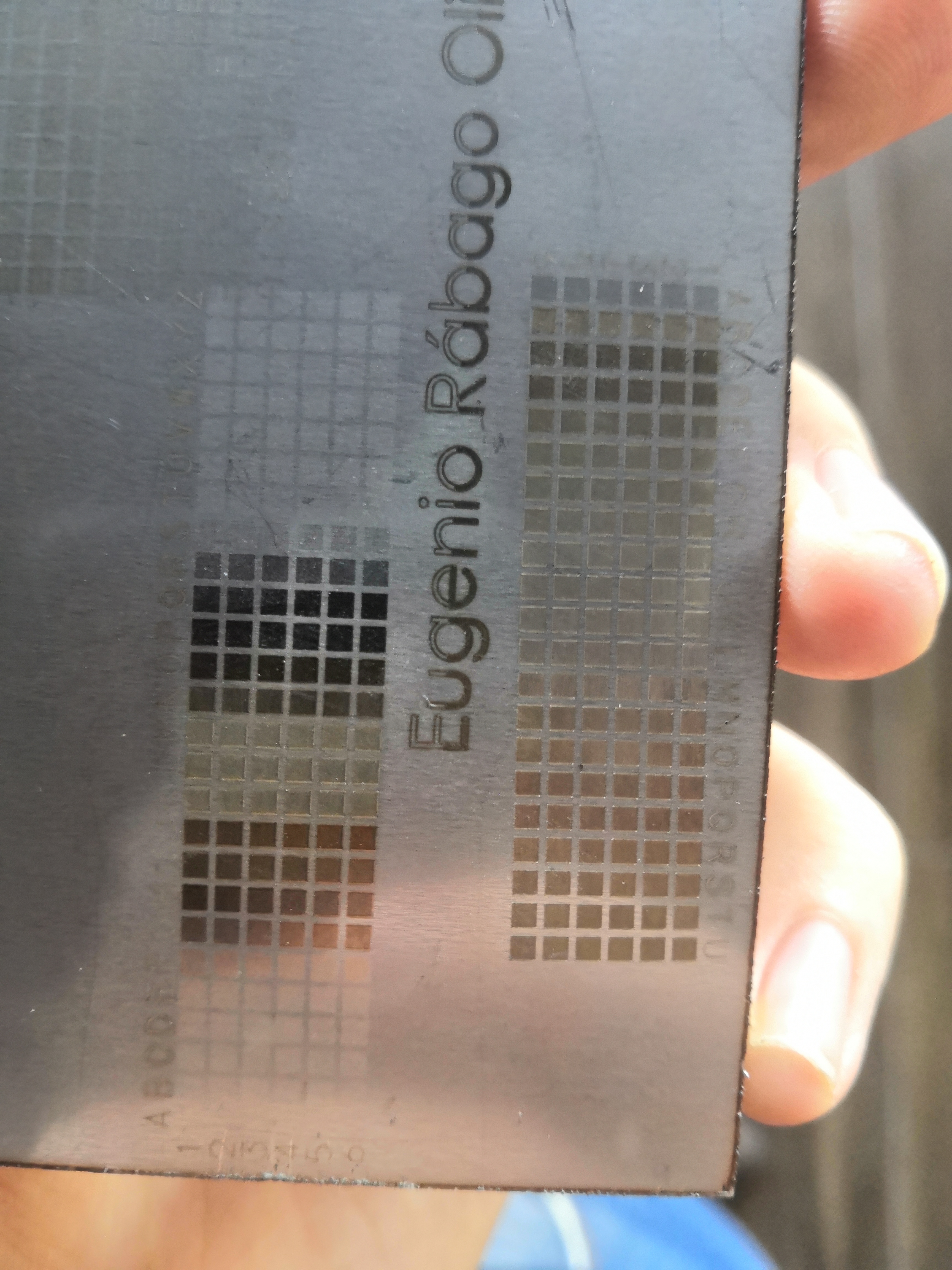

I don´t know if you´ve considered this, but it could be achieved by laser engraving, we have a pretty good engraver here at work that might be able to do the job perfectly, if the color needs to change it could be painted since the engraver leaves a decently deep pit that can be painted easily.
This is a sample of a stainless steel piece and the colors that the engraving leaves, no paint.
I don´t know if you´ve considered this, but it could be achieved by laser engraving...

I thought about engraving, but it wouldn't end up being screen accurate- for one it's hard to get the "organic" look of the stamp (which I transferred with all the asymmetrical details intact) and also, the Beskar pattern isn't just black/white but has subtle variation in opacity. It's the reason why I opted to skip transferring the pattern as a relief onto the face.
After having the ingot cast, I ended up with this look:
I'm also quite a bit further along on the blaster:
The entire slide/top area is still far from done, as are most other details but I've got the rough stuff blocked out. Not too long until I'll be able to start hollowing out and breaking it down into many parts. (I might ask the foundry that cast the ingot to also cast the receiver halves of the blaster.)

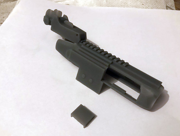

OK, so the first printed detail piece is here! Turned out pretty OK, maybe some things to tweak here and there and I might still have the sight block separate. I really want it to look like it was put together from many parts and not printed in one or two pieces.
Still surprised at how small the part is, but everything suggests it's accurate in size- it's just a very slim-looking blaster overall. Like I mentioned before, I left the brass block separate- makes it easier for painting, or in case I want to have that piece in real brass later. I'll have an aluminum barrel running through the whole thing to make it more durable.

(This is straight off the printer... support points haven't been sanded down yet.)

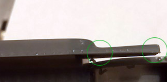

If you look closely, you can see parts broken off the blaster in some scenes!
