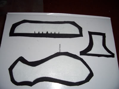

Step 3 Measure out the shoe and draw up some templates
You should have:
x1 side
x1 back
x1 tongue
x1 toe with hole pattern
x1 back with hole pattern

Step 5 Time to cut out all your other pieces. This time you will need the interfacing that when you iron it to the material is will adhere on both sides.
Sides and the back use the same thickness as the interfacing you used for the tongue
The front toe pieces used the same iron on stuff, but the really thin kind.
Cut 2 more sides out of the really thin interface. (Not pictured)

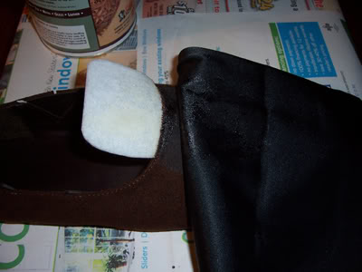

Step 15 HERE'S THE TRICKY/HARD PART, Covering the shoe. The reason for this is so the tongue that you stitched onto the shoe looks like its all one piece. I layed a piece of muslim cloth on top of the shoe and traced around it to get the size material to cover the shoe. Make sure to leave a lot extra around the sides to make sure you have enough material to cover the entire shoe. Once that is done you can now lay the muslim cloth on your fabric, trace around it and cut it out.
Step 16 Now using a strong contact cement start gluing the material down to the shoe a little at a time. Make sure to stretch it and keep it tight so you have no wrinkles.
