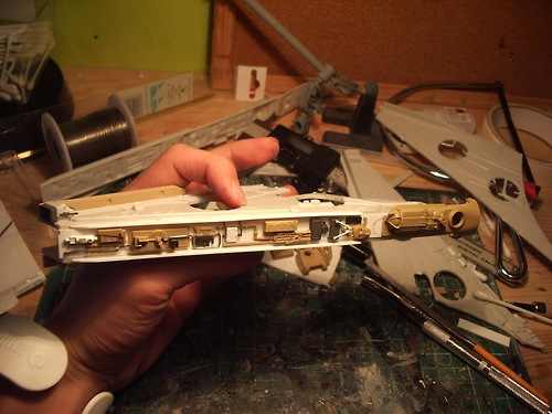

I added the styrene struts and tank skirt replacement parts to the right hand mandible
Glued in the sidewall to the left side mandible
Built the mandible inner wall
Just seeing how it's shaping up; not too bad so far, not sure how I'm going to reduce the hole size though :unsure

Started fiddling with the jawbox, in the end I gave up and chopped it off. I'll build it up from scratch instead, gives me some more control over it at least
The new styrene sheet IS angled, it goes from 53mm down to 43mm but it's not very apparent in these photos. It's 160mm long, and will be slightly longer once the angled plates are all added in.
This coming week I'm going to try and start a metal frame structure for this all to sit on, it's all very flimsy at the moment.

Starting detailing the jawbox; cut out a hole for the vent casting and mounted it underneath. It's too far forward, and I'm not bothered about it right now but knowing me I'll go back and redo it all later
Starting detailing with 0.5mm metal wire
In comparison to the MPC part; probably the darn finest piece of scratch building I ever did dooo
Primed up the jawbox
Needs a little more detail on, but I'm pleased as punch with it.
