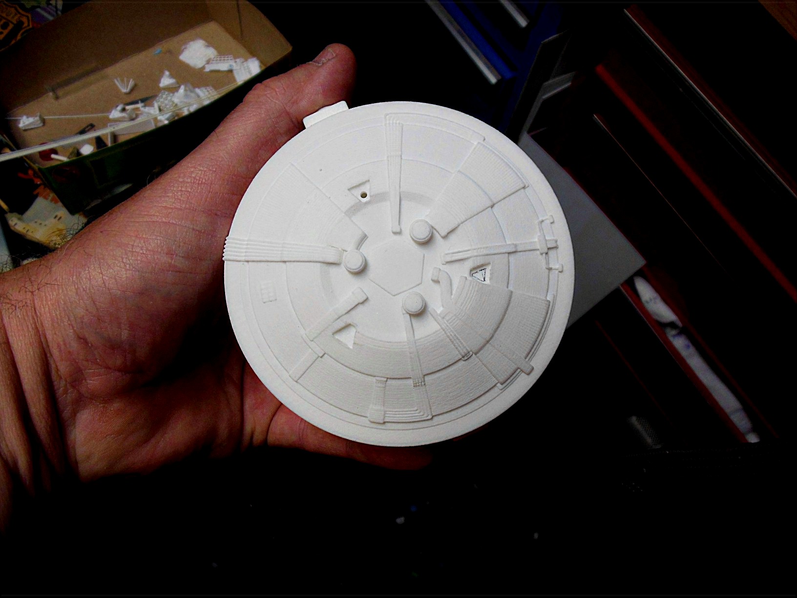

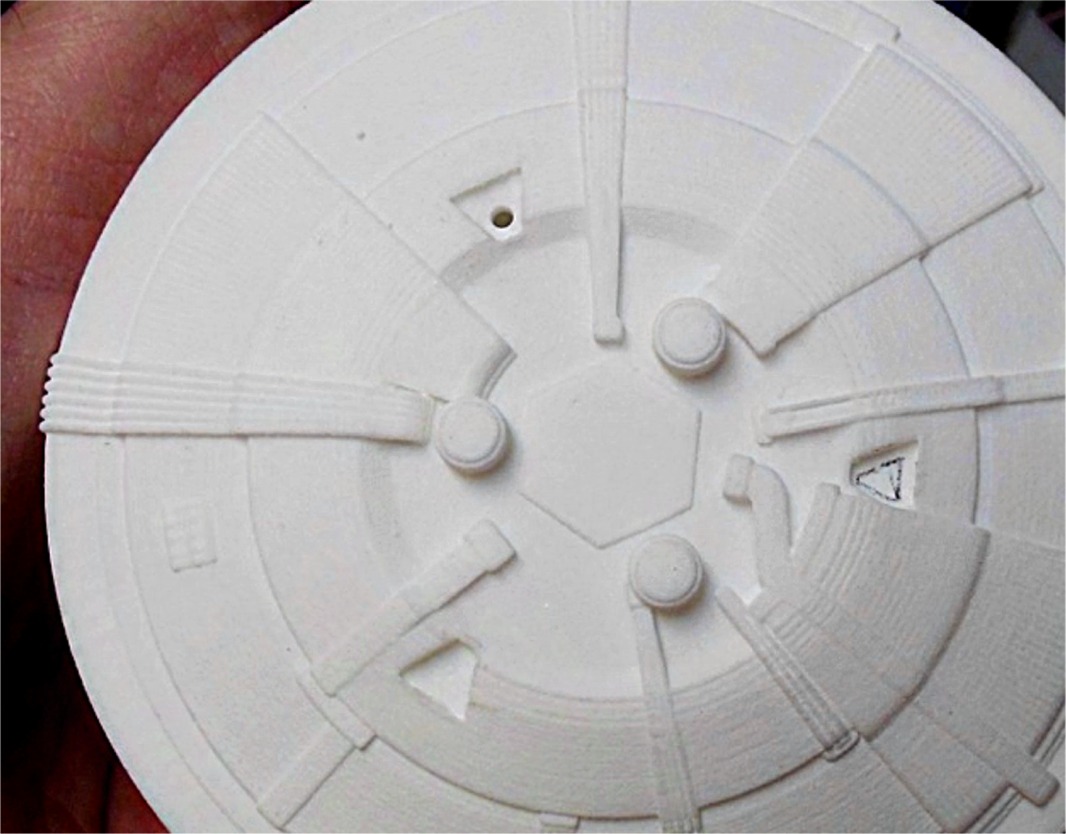

One more side bar... There hasn't been a decent model of Cygnus' counterpart, Palomino... until now. Kremmen By Kremmen on Shapeways has two sizes of Palomino of which I've purchased the larger of the two (1.192 designation) which consisted of five sections (Upper and Lower Hull, two different antenna sets, and the Power Deck) The Power Deck was held up and was subjected to rework (and a price increase). The complete model is 8.5" long and the hull is 4" in diameter (the thrusters have a 5" span). The model goes together rather nicely. except for two minor issues. First, one of the three recesses for the Power Deck struts needs some trimming (see the fourth picture, the triangle to the right with the ink outline). Second, I found that filing down the top of the three struts made for a better fit (the Power Deck is a bit more brittle than the rest of the model).
The finished product is well executed and I might take some time off to give it a proper paint job. Thanks Nwerke!

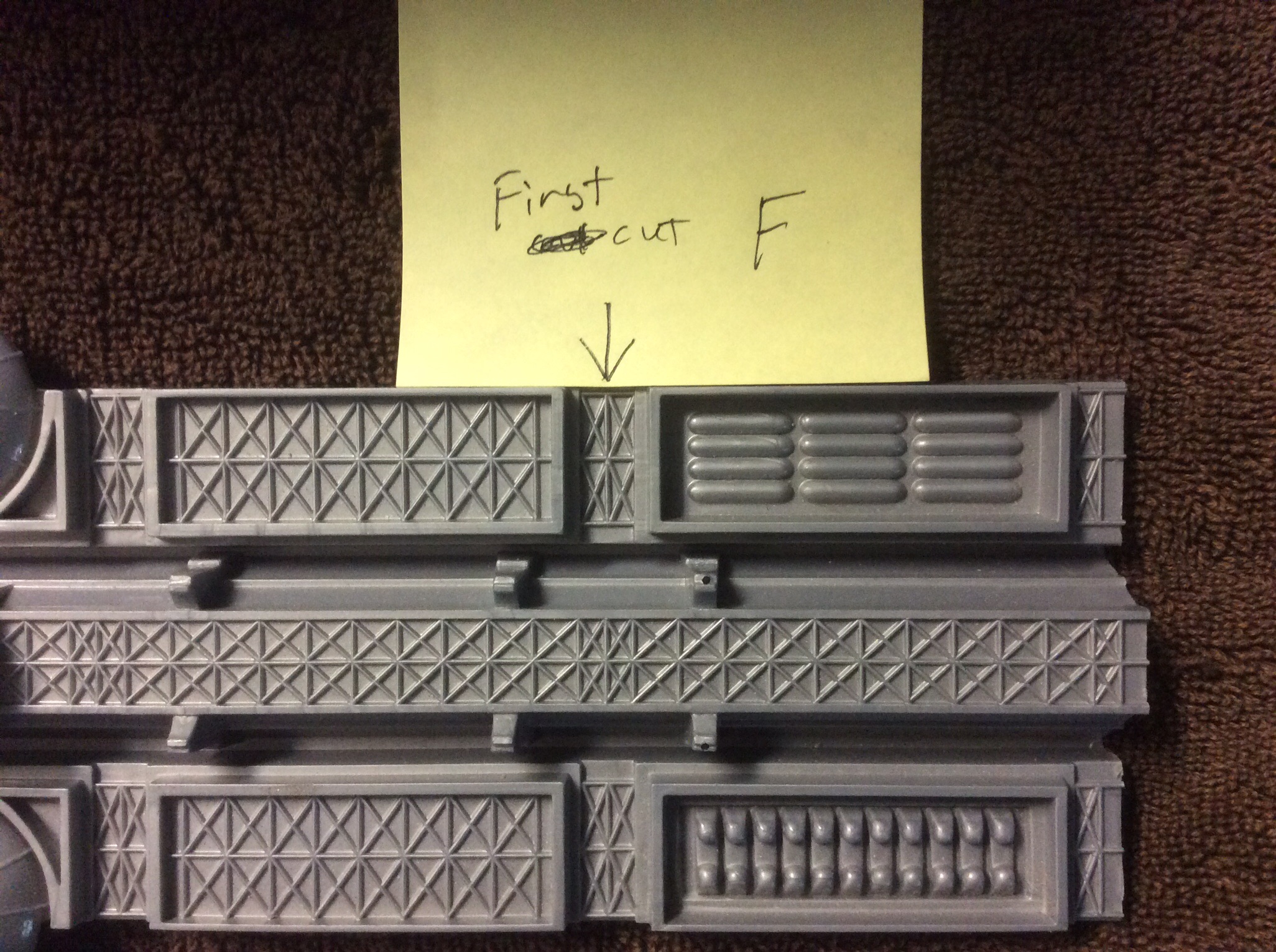

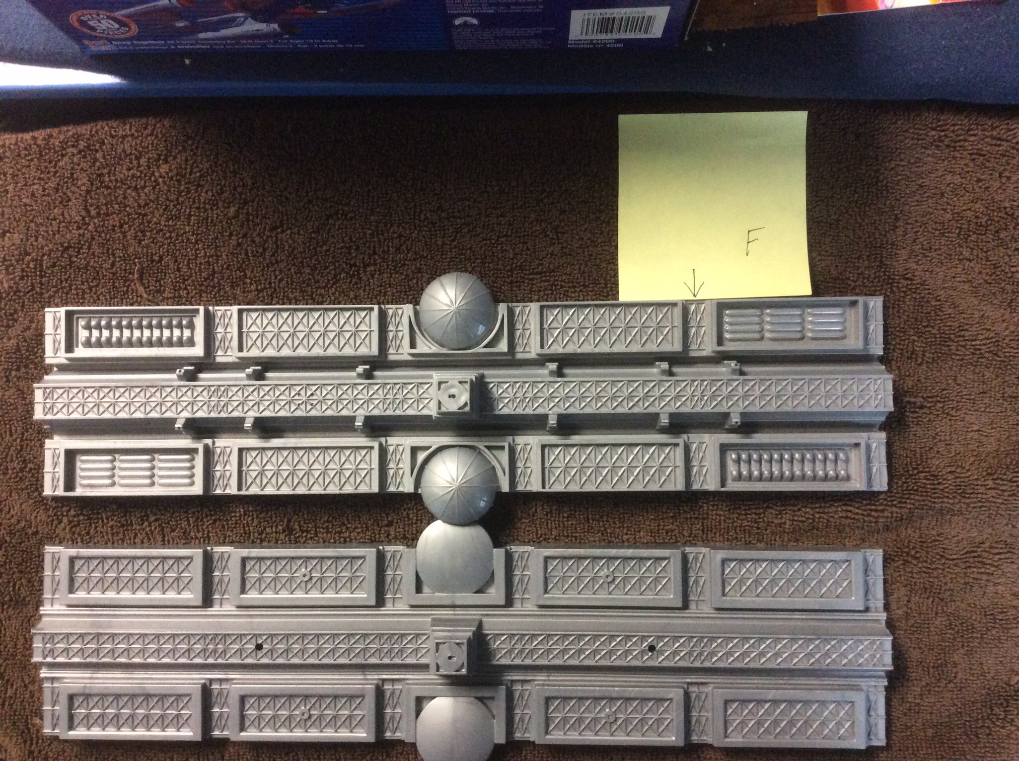

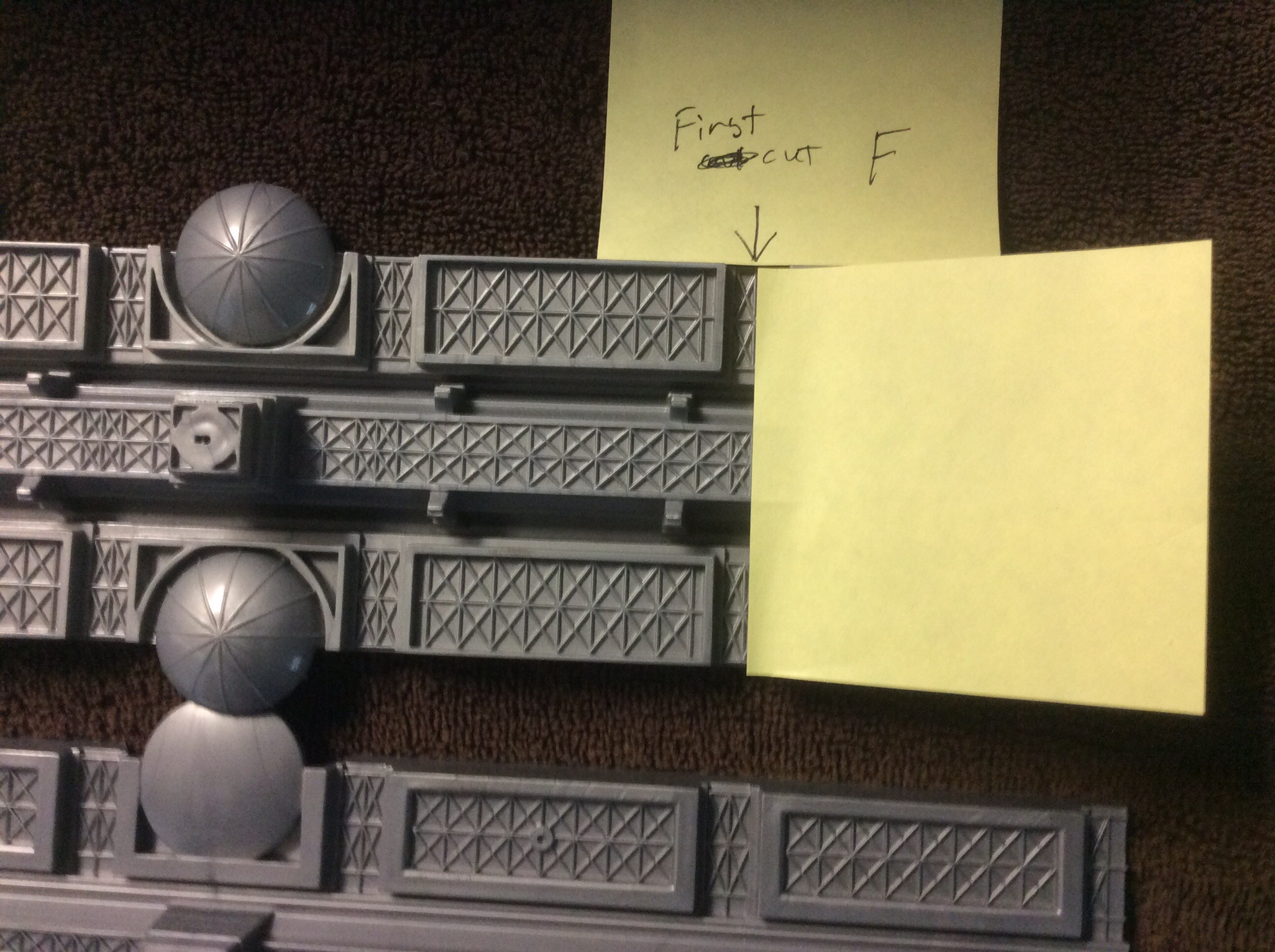

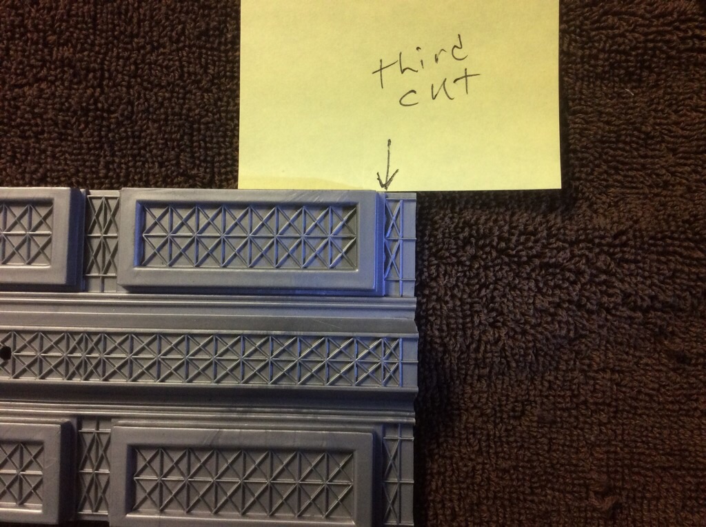

Thanks Tazman2000, hope your in for the long haul (because that's what it's become). Now for you Empiflake...we'll do this in two parts. First, the top section. Since you have to work with the tank details on the top, you are limited to where you can cut. I have some pictures with arrows to help. I'll keep the tutorial short since this site and my I-pad don't get along for long sessions.

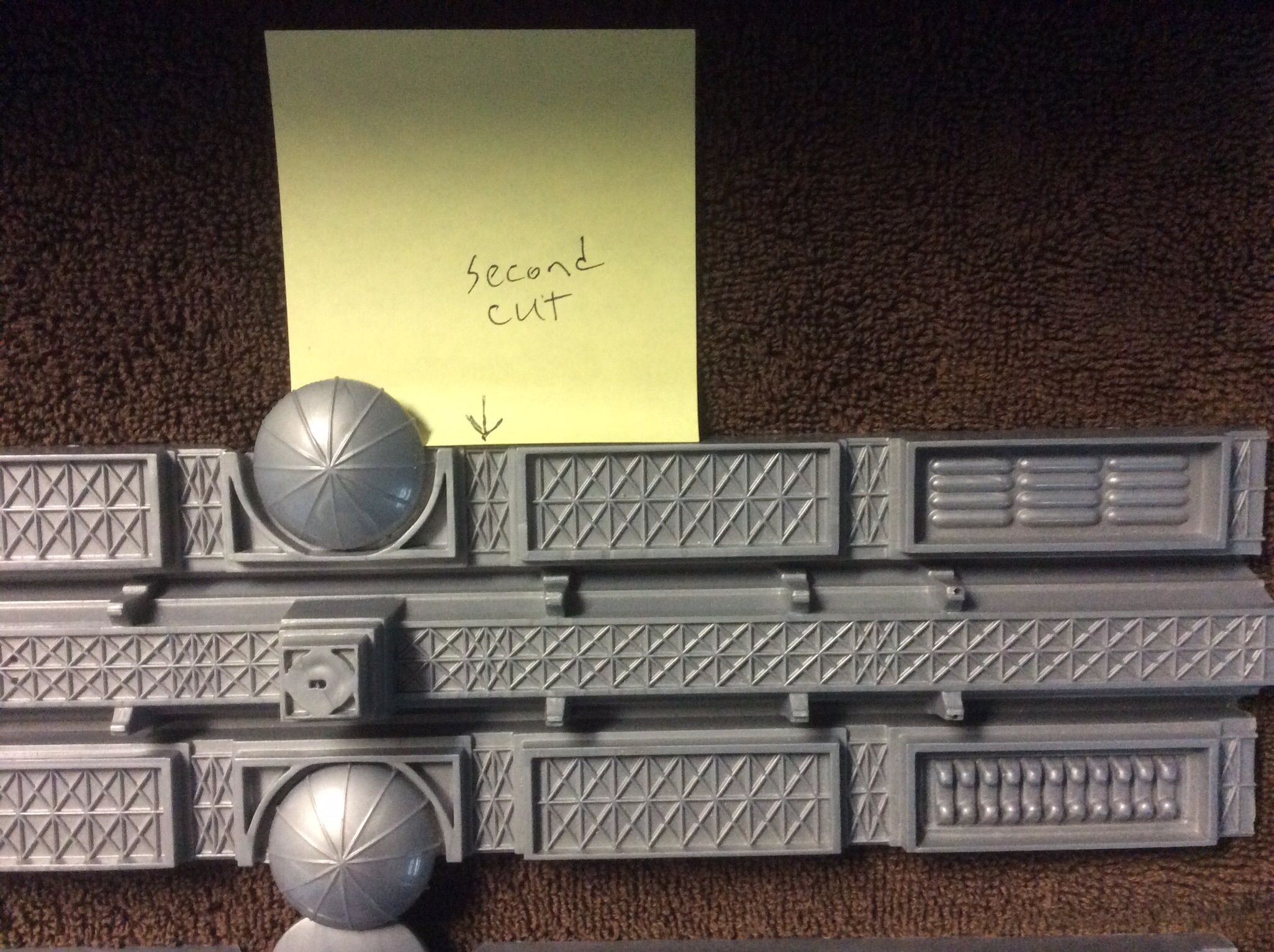

I'm doing this again because of this stupid I-pad...Alright, for the top section you are working the end marked 'F'. The target is the straight line between the four smaller 'X's shown in the picture. That is in line with the simular section in the central corridor. Second cut is to be made on the spare part that you have. That front piece of 'second cut' goes onto the big piece of 'first cut'. The idea is for the seam to be in the straight lines of the lattice work.
Now, pay attention...NO HIGH SPEED TOOLS! This silver plastic is almost like a hard rubber so invest in a razor saw. Also, the bottom section has a different cut line. This is for added strength so don't go 'woochering' on those parts yet. More soon.

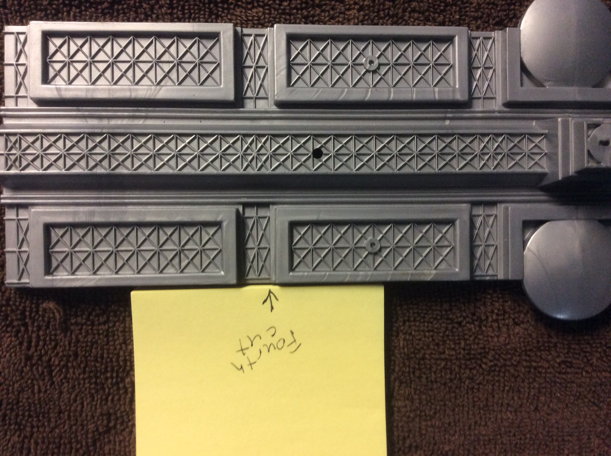

Thanks for the kind words blakeh1...now to finish Empiflakes tutorial. For the bottom section, I would make the cut just to remove the end piece (with the two 'Xs' and two blanks on each side removed). That is marked Third cut. Then on the spare section make your cut on the line I've labeled Fourth Cut. This approach makes the join seams to be offset and giving the final assembly a stronger build. Now for the side panels...I never really pondered them ( The ones for my project are so heavily modified that it doesn't really jive with the original). All I can say is that if you get past the stuff I have shown you, then modifying the side panels shouldn't be too hard.

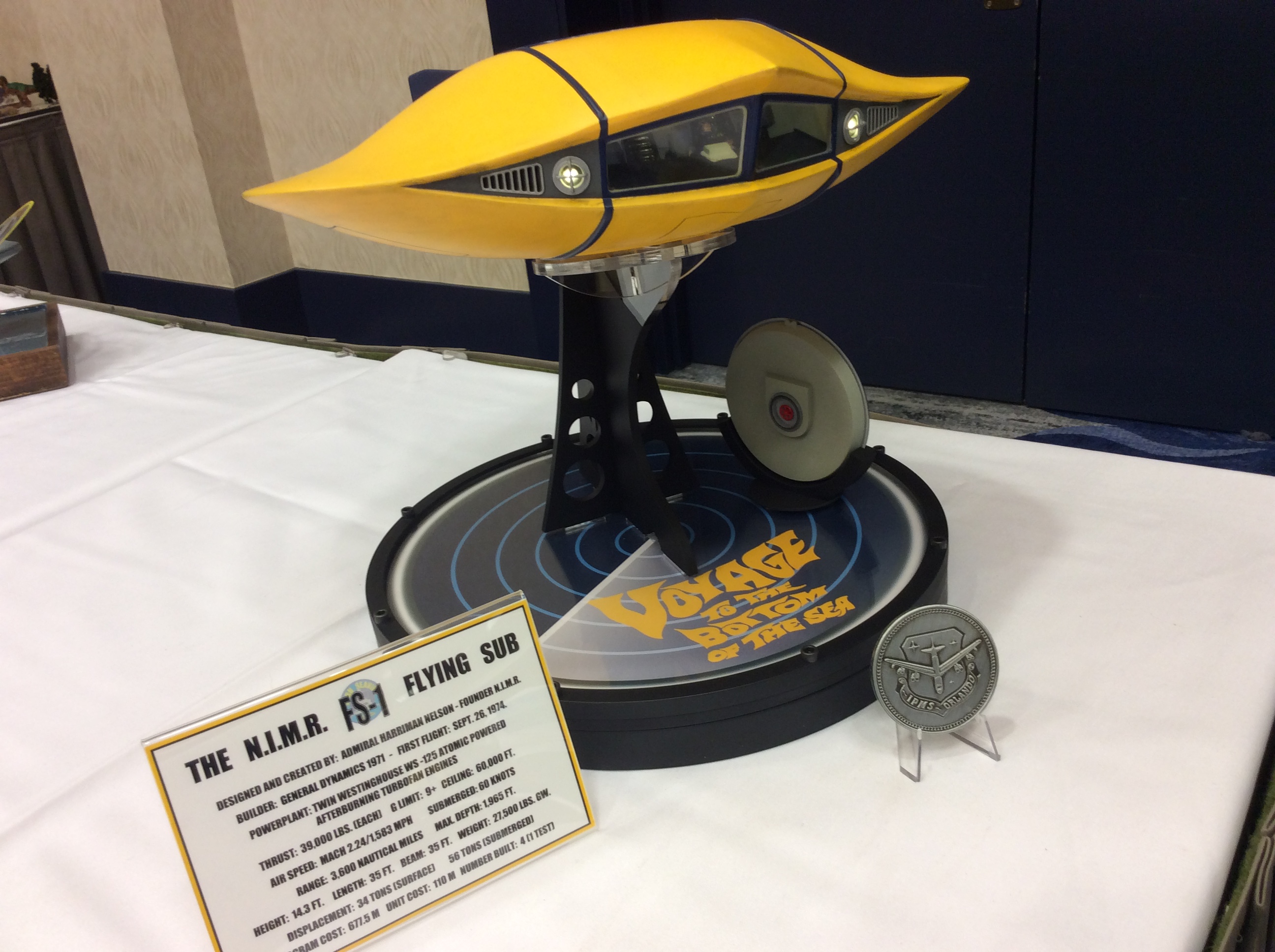

  • Greetings fans, I'm back for now but not on this project. I'll be posting a new thread about the last big project I actually finished. Moebius' Flying Sub kit... with all of the bells and whistles (and a couple of special modifications. Below is a teaser pic and hope to get back to the Cygnus stuff soon. Thanks
