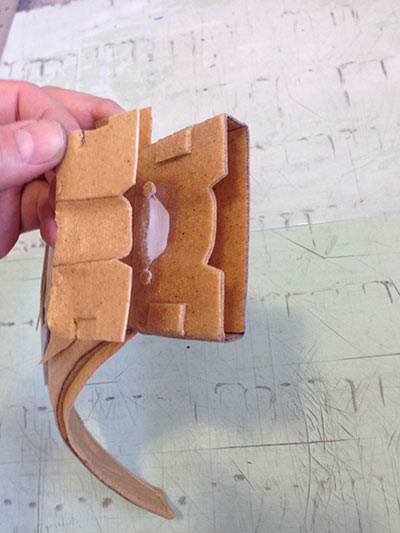

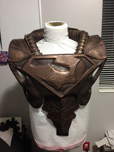

Worked on the ab plates over the weekend. Used a piece of lycra and hot melt glued it to the back of the four plates. I could have used elastic but it is too stretchy and my experience with using multiple pieces is that it's difficult to get the tension the same on more than one strap. If they're not the same the attached pieces will not hang/stretch straight. Yes that's hook/loop on the top.
And here they are mounted

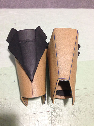

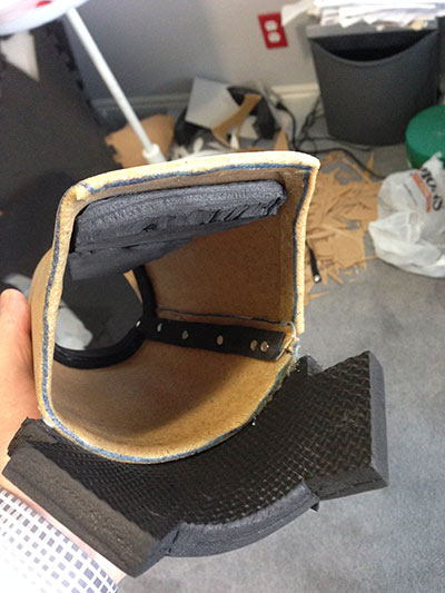

Started on the gauntlets. I've psyched myself out about these for too long. Finally bit the bullet and just did it this weekend. They are held closed by six pairs of neodymium 5mm x 2mm magnets on the inside seam of the gauntlets. There's still quite a bit of detail to go, these are just the base shapes more or less and the black foam triangles are the bottom of the bracers.

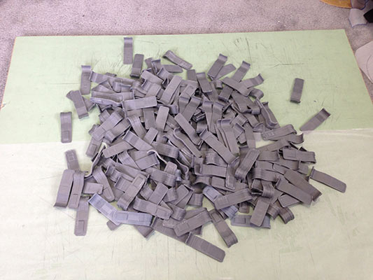

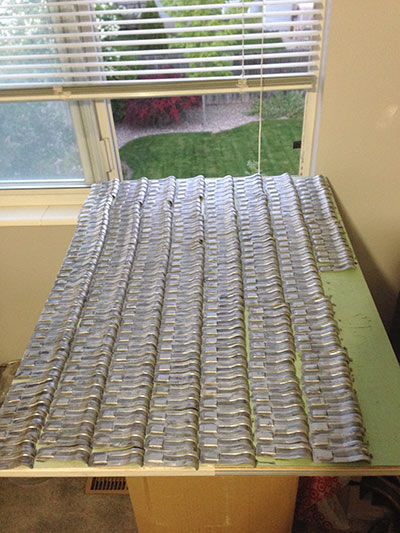

HOLY SHIITAKE BATMAN! That was a pile (all 285 pieces of 335) of work to remove all of the 3D printed supports, file each piece and lastly use 100% acetone to remove the grooves (by hand rubbing) on each piece. I wonder if I dare start painting each of them tomorrow?
Well... after a few days of letting the base coat of silver leaf rub n' buff dry I've dirtied up the 285-ish belt segments. Now I can start building belts and trying to join these crazy puzzle pieces of armor together. At least above the waist for now. I still have to finish the boots before I can build the lower belts since they attach to the boots. :-/ Yes that is a freshly mown lawn.

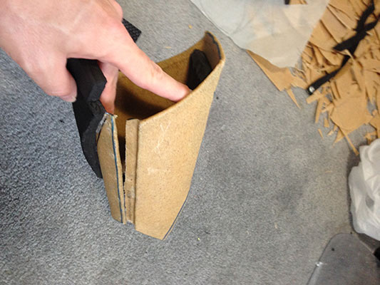

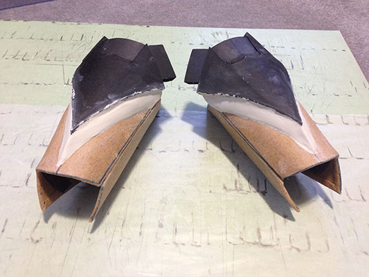

Gauntlets are currently just a basic body form for the right and left arms. I have lots of details and still have to work out the saber extension mechanism on the right arm (think lightsaber extension). Again, black parts are EVA foam and a Worbla sandwich for the body of the gauntlet. They are split along the inside lengthwise so I can get in/out of them with neodymium magnets holding them closed.
The black wedges are one thick piece of EVA tile and then two layers of 2mm foam. As you can see the middle piece is just a narrow strip and the top layer flows over it. I use a heat gun to form the top layer over to get that definition of the middle layer. The middle and top layers are super glued, hot melt glue would have been too bumpy but I used it to glue the tile to the bottom of each bracer. The black EVA tile in the inside at the top is used to push my arm down to the bottom of the inside of the bracer.
I also attempted to make the bevel from EVA that runs around the bottom edge but it was impossible with a hot knife, I think I need a hot wire instead. Oh well, I used a fair amount of Apoxie Sculpt to make the lower beveled shapes(white stuff). The big tip with Apoxie is to use water. Water will keep it from sticking to you as you mix it together. After you place it use water to shape it to a buttery smooth surface. Zero sanding (unless I goof it up).

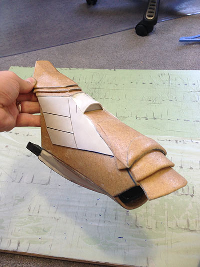

I've been working on the gauntlets today. I have a few nerdy details to fix but it's going well. There are a ton of detail on these things.
This is the left gauntlet. I'm using foam when possible. And you can see I have to do some build up under the paper patterns at the back. FYI I don't use Papakura, all of these patterns are done by eye and by making measurements which are then transferred to Adobe Illustrator.
The second pic is where I blended worbla into the plate below it with my bone folder. This is one of my favorite things about Worbla.

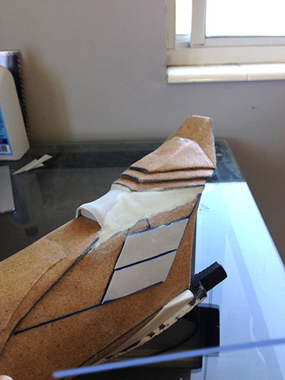

Got to the three top plates on the left gauntlet today. Started off with building in some foam supports and then use Apoxie Scuplt to smooth out the transition between all of the surfaces. I'll post a video demo of Apoxie later today on youtube, Monday morning worst case. My wife is consuming all of our bandwidth for Netflix :-/
