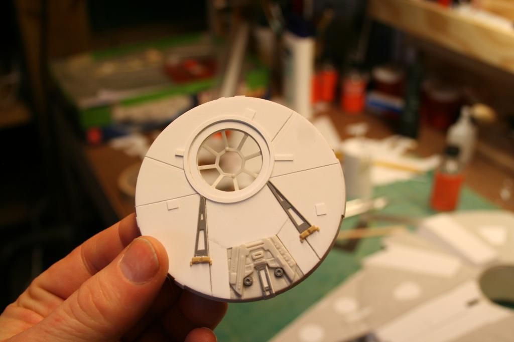

Man, is there a lot of preliminary work to do, a lot more than I thought. So far its just a lot of cutting, sanding and gluing styrene in for support. I have done a bit of design with the sensor dish and some gun work. The grills on the back are from some sort of electrical substation model for train hobbyists. I thought the “grills” would look great on the back so, they’re just loosely set on for now. I am also going with the cockpit style of the McQuarrie falcon and following Jaitea build on it. I just made a simple facsimile of an inner cockpit with some seats form the MPC kit.

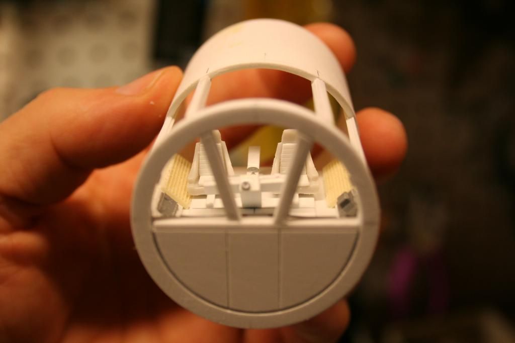

I decided to make another cockpit tube. I wasn’t happy with the size and some of the creases in the first one. I use a part from a Saturn or Apollo rocket I had for some time. There is no tapper to the tube this time like in the Ralph McQuarrie design, but frankly I don’t care this is turning into quite the project and I am happy with it as is. I will either add some thin plating and some scribing. I did some in the front but its hard to see in the light.
I also made some seats and console of sorts and a backing with a door, nothing fancy just something to give an impression of a little more going on instead of an empty tube. I have never really built an interior before on a model so its good practice.

Some work to the top of the turret.
http://i202.photobucket.com/albums/aa25/Ludwig45/Vrnt Flcn Bld II 023.jpg
