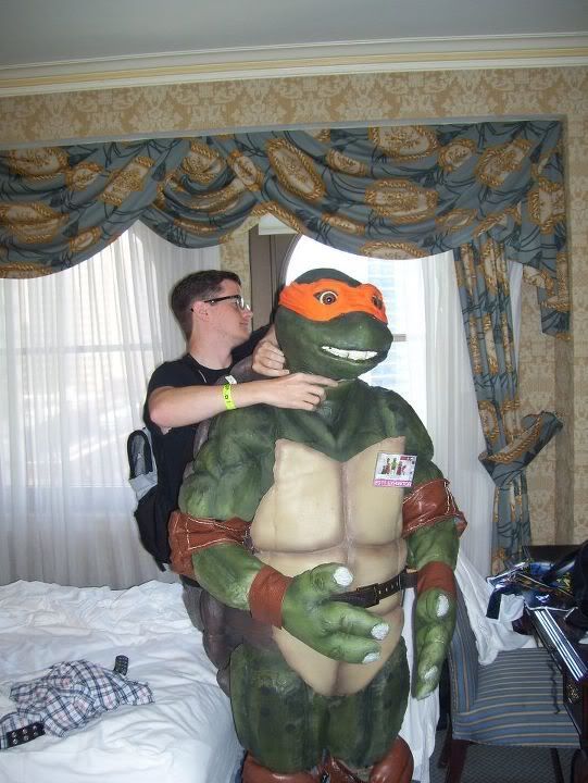

How does your shell attach? Do you have "suspenders" of a sort that run under the shoulders of the bodysuit?

the shell is 2 parts the front and the back. the back and sides are one part and the front is its own.. the back part goes around me and the i have to straps with clips holding it on like a belt and the front velcrows on to the sides of the back.
