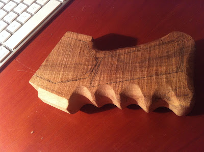

The grip and butt stock on the gun are both wood. I had a scrap of walnut form a tree I'd cut down once that was the right thickness (full 1") so used it.
On to the construction. First, making the grip...
Rough form
Some shaping with sandpaper and knife
Other side
Sanded smooth
The butt stock with metal bracket attached to the pipe which will attach to the main body of the gun...
Unfortunately the wood I had was too nice - doesn't quite match the gritty nature of the game style. I very well may remake it with something not as "pretty", though the walnut does look good I must say.
Still need to apply some checkering (that hash pattern) to the grip sides. Also perhaps a metal plate on the side of the butt like in the original. It appears that this is supposed to be a patch to fix a crack in the wood. I don't want to put a real crack in it but could at least fake it a bit.

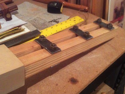

I went ahead and knocked out the main front rails (the "barrel" I guess you'd call it) today. Here's the build steps...
First, the wood I'm using - an old 2x4 that's got a bit of age/color/character...
Cut into two pieces the right dimensions
Like the main body, they are cut smaller to fit into the box joint between body and barrel...
Test fit...
Some correction with a hand plane...
Then I cut and added the 1/8" metal pieces that hold it together with the bolts...
The overall gun so far...
With it all together I was able to heft it up, and I gotta say this thing is heavy. At 4 inches shy of 4 feet long, it's no compact weapon!
