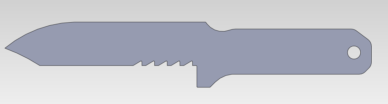

What I have currently modeled is below:

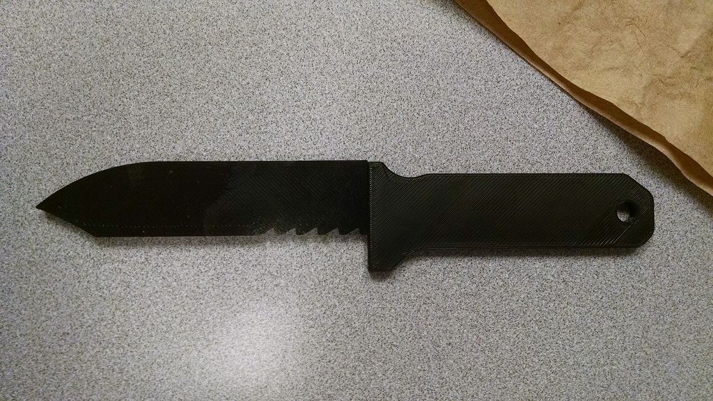

The knife is currently a flat piece. The idea was that however it was created for a prop, it would be finished as needed blade-wise. For some cases doing nothing might be the safest bet. While it won't look the best, it will be clear to people that it has no blade.
Some issues I have run into reference wise are blade shape:
-Some references show a drop point while others show a clip point. I am currently leaning towards a slight clip point.
-The shape of the serrations. This one has them based off the toy. The real-life "kinda close" knives all have square notches rather than proper serrations and it looks strange. I honestly thing it is because they are low-end knives that are stamped rather than having the serrations cut out a bit more finely.
I also kept some things off as this is intended to be made on a thremoplastic extrusion type AMM/3D Printer. Some edges were not rounded off or given certain textures to keep things easier. I intend to take some sandpaper, a file, or a rotary tool to it after it is done.
Also due to the side of the machine I have to make this on, I will be splitting the knife into two parts at the flat protrusion of a hilt. The build area is only 6" x 6" and that seemed like the easiest place for reassembly. After that it will be a matter of wrapping the handle area with paracord.

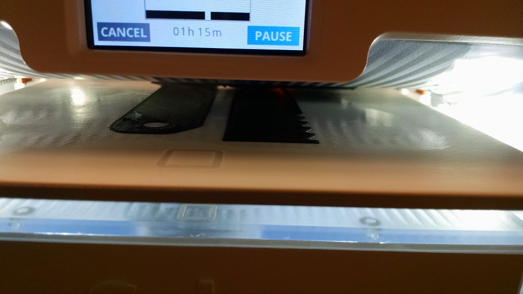

I hope to do a test print tomorrow.

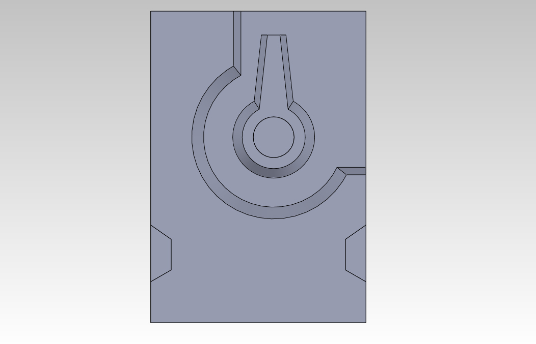

I changed the name of the thread as I have started a model of the elusive VOX/PTT switch box.
