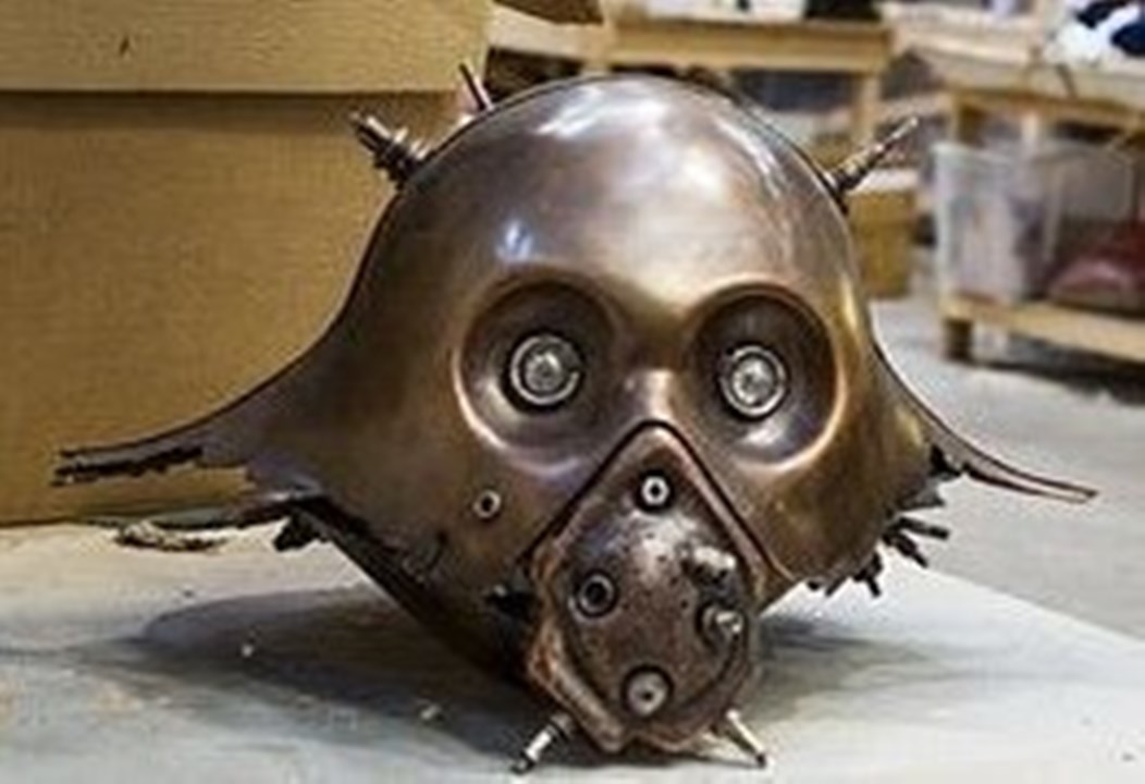

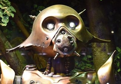

Hey guys...I want to build this droid; EMMIE/ME-8D9 from TFA but there are almost no good reference pix. I know that if they exist then this is the place to find them
These are the best ones I have so far
15624086_466087673779980_4048060453765513216_n.jpg 12224349_1217833964898961_371906584_n.jpg large-1461338849-f3544c56ef26633f66ec8b85f6a9b785 (1).jpg
I'm particularly looking for side shots or close ups on helmet details but any others would help

FYI, if anyone has a high-def version of the movie there are some good screen cap opportunities. When they first walk in to Maz's place it shows her from the side and you can see the back of her head pretty well. I just have it on my DVR or I'd do it. Tried to get a good photo but it's not going to be good enough that way. You can also see her wandering around at the edge of the frame several times throughout.
-Rog
I love that concept image but there's no way Disney would have used her for TFA
OK I had the same idea and did the screen cap thing, so have a better idea of the back of the head but still no luck on finer details

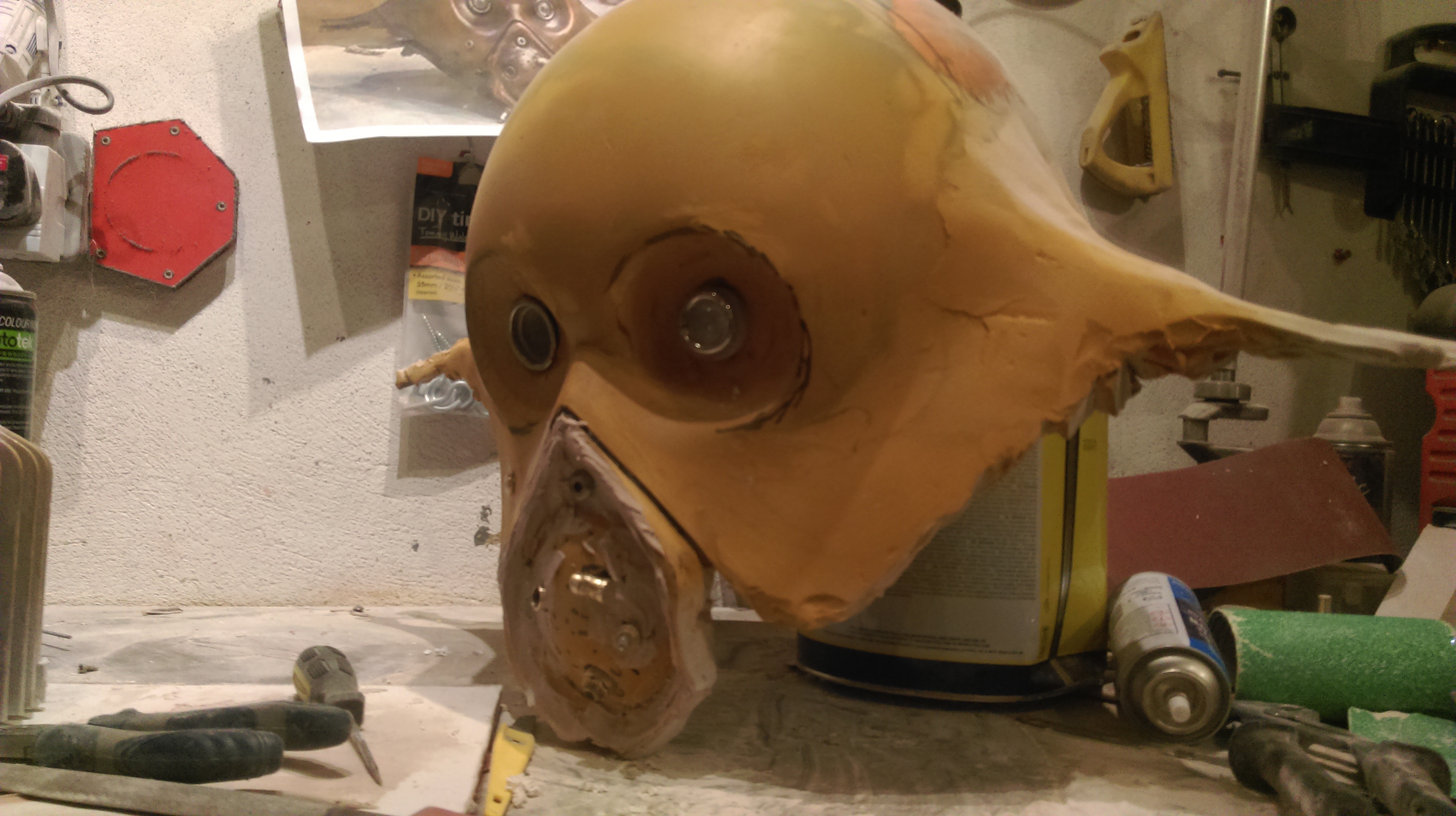

Update on the build...she is a minx! Getting the position of the features exactly right is just so difficult...because she has a 'face' instead of the usual helmet/droid head, every little tweak changes the attitude and expression' I think I'm finally on the right track but it has taken vast amounts of Bondo
What d'ya think?
Still messing around with the eyes and the breather but I think it's getting there

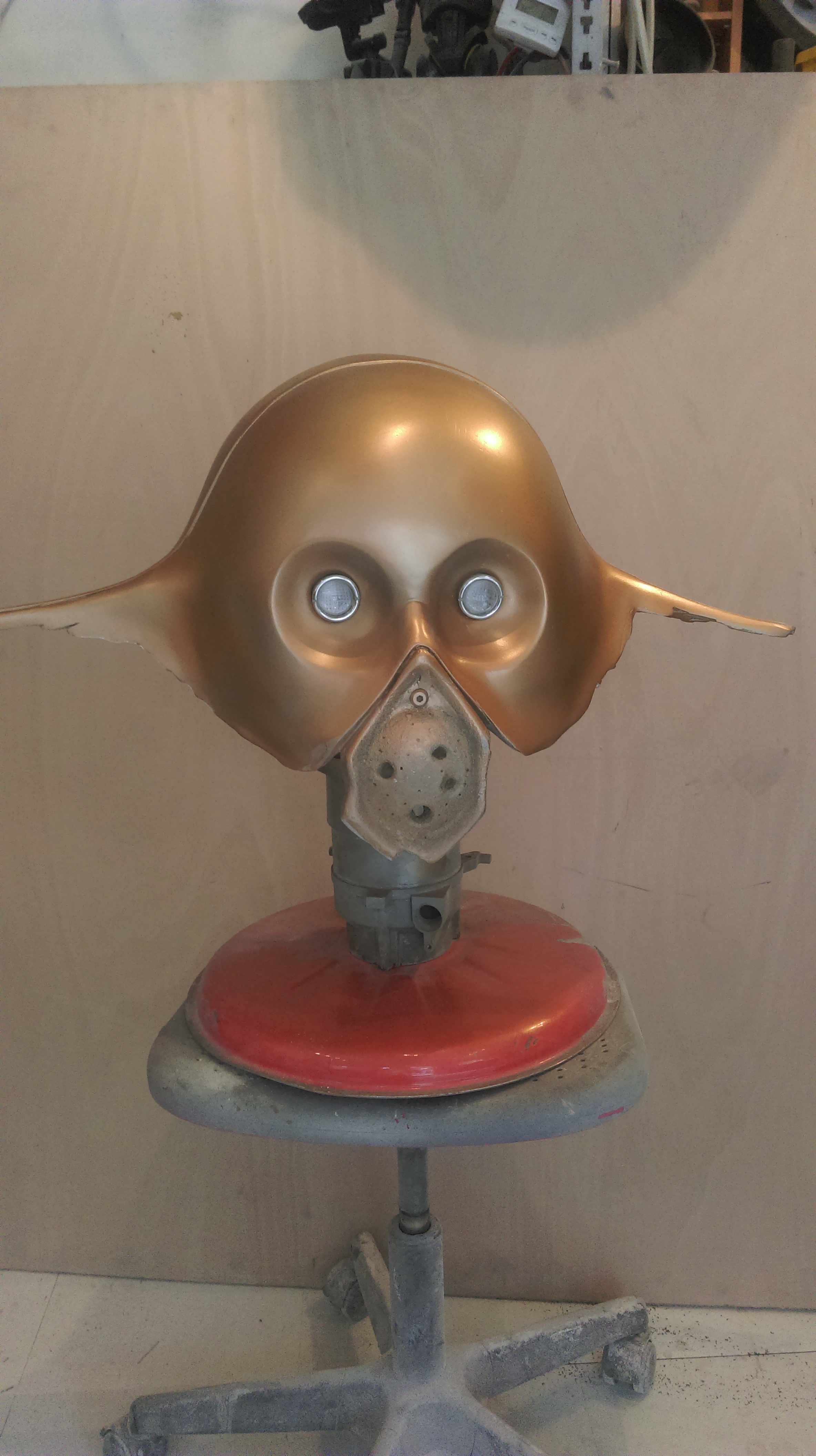

OK so the basic modelling is finished.
I've got the eyes as close as I can get and am busy making/finding all the brass greeblies, of which there are actually a surprising number
I've just given her a shot of copper paint for now but I'm gonna try a different approach for the final bronze paint finish
Also, can anyone tell me how to load pictures in bigger sizes than just thumbnails please?
What d'ya think?
View attachment 711970 View attachment 711971

i think it looks ****ing spectacular!
