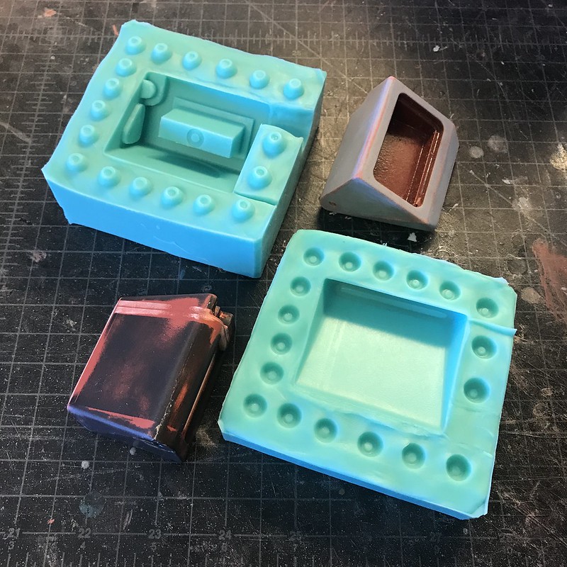

Well, that was a chore! As I mentioned previously, all three molds for the RF, stalk, and antenna failed. So the long delay since my last substantial post was due to me ordering more rubber. Twice.
I was able to mostly-successfully remold the stalk. There is a little funkiness around the RF mounting point, which is easily sanded away, so for expediency I opted to just go with it and deal with the minor sanding work. Even if you don't sand it, it's hidden by the RF once installed anyways. I don't really have any photos of that part so you'll just have to trust me on that.
But both second molds for the RF and antenna failed. The problem ended up being the Krylon primer I was using, even after clear coating it. I've used Krylon primer for years without issue, but they recently changed the formula and the new stuff made its way into my supply. So gotta toss all that crap and find a new primer. To fix it, I opted to scrap the RF and antenna masters and rebuild them from scratch so I could control every facet of it from the beginning. And since I didn't have any new primer to replace the Krylon, I opted to just gun it straight from the build to clearcoat on both pieces. I lucked out and got two good molds out of it.
By the way, I decided to alter the design of the RF. Before, I had a recessed section on the bottom. However, I decided to change that to the back of it to switch it up from Production Boba a bit more. I like this way more.

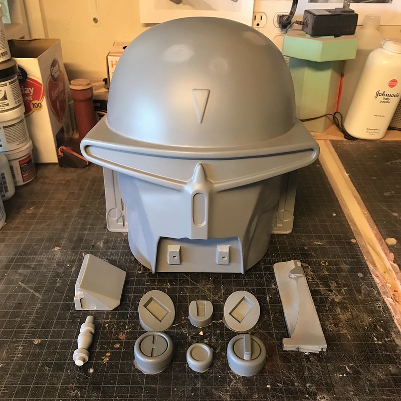

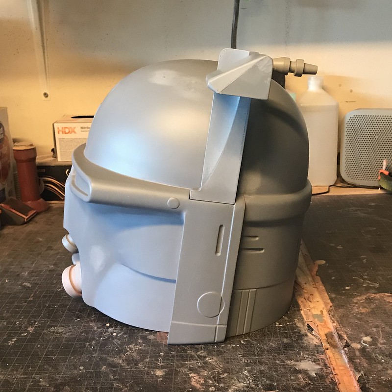

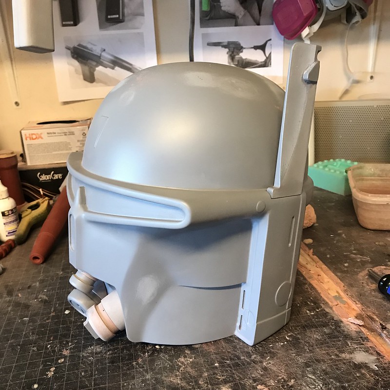

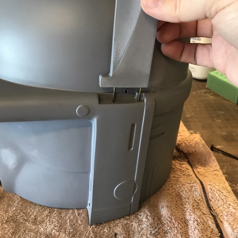

With the RF molds done, I was able to get the whole RF assembly put together and fitted to the helmet. The main task was to get the stalk fitted to the helmet securely. To do so, I embedded two metal rods (coat hanger wire) into the stalk, and drilled corresponding holes in the helmet. The stalk is then screwed in laterally from the interior of the helmet. This keeps it secure in all directions, but also keeps it removable. I'm rather paranoid about breaking stuff like this, so I like to build in replaceability into these kinds of things.
I made the RF itself removable as well, by simply bolting it in from the side. The bolt is slightly hidden by way of a recessed hole in the RF stalk - a little unsightly, but when painted white and weathered in, I'm sure it'll be quite reasonable. This is my own personal way of assembling it, though. Whatever works for you when kits go out will work fine as well. Unfortunately I don't have any photos of the screw hole, but you'll see it all attached with the final photos below.
And here it is - the full kit! At this point, I'm ready to build this one out to be my helmet for DragonCon, so I'll move forward with all the remaining trimming work and paint prep. But this means that I can start casting kits as well! I'll have a sale thread up in the morning or thereabouts, and I'll link it here when it goes live.
