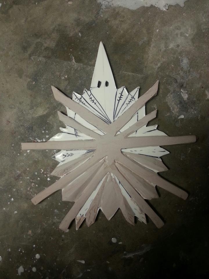

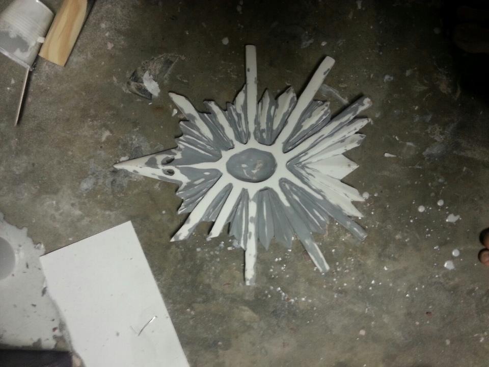

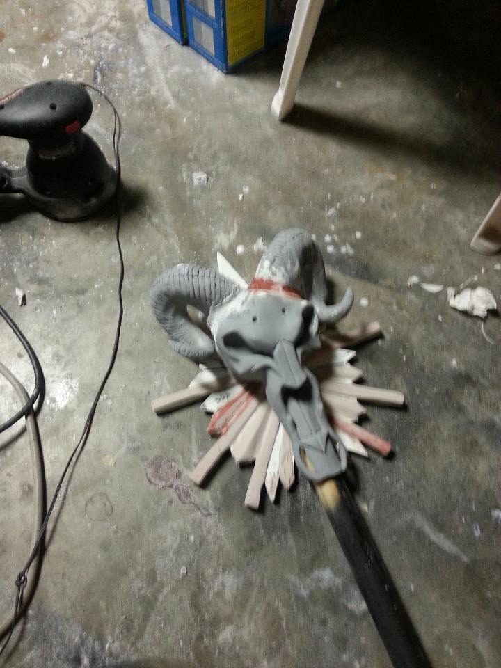

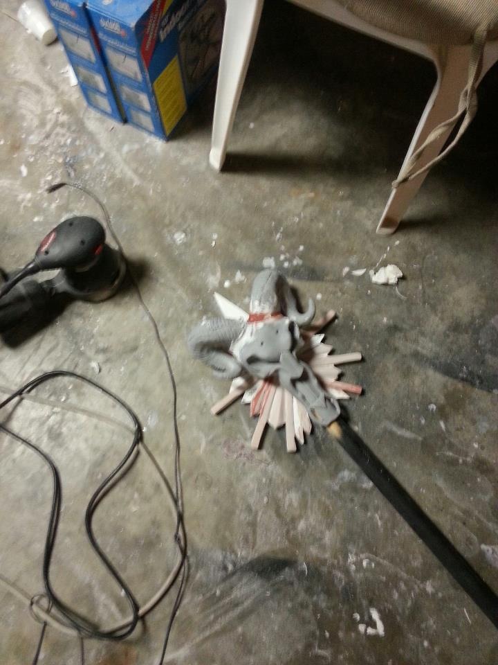

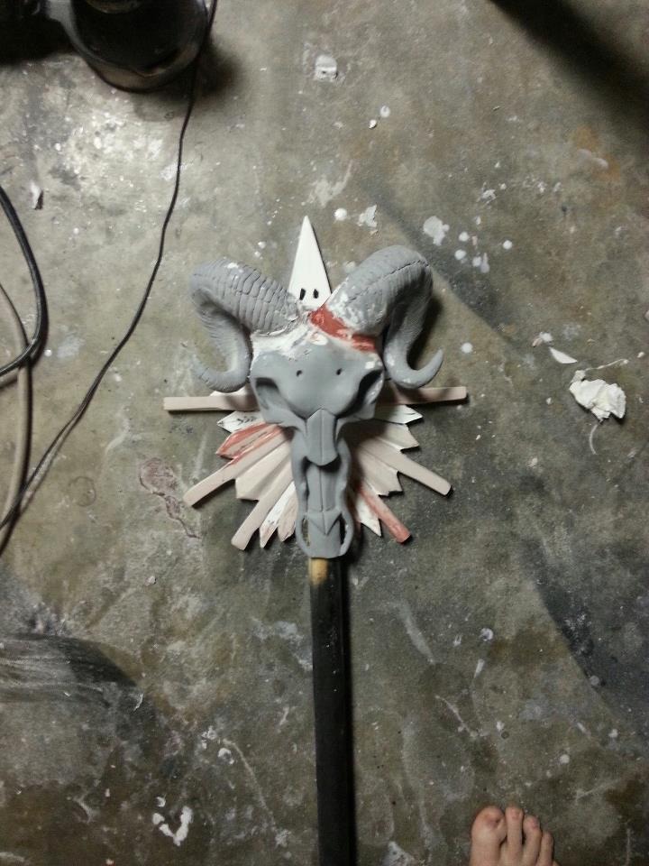

More progress

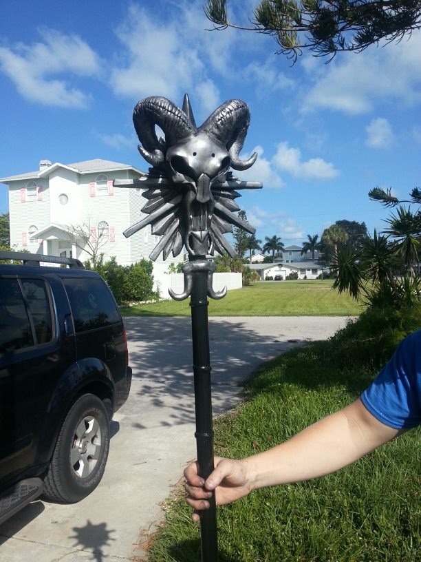

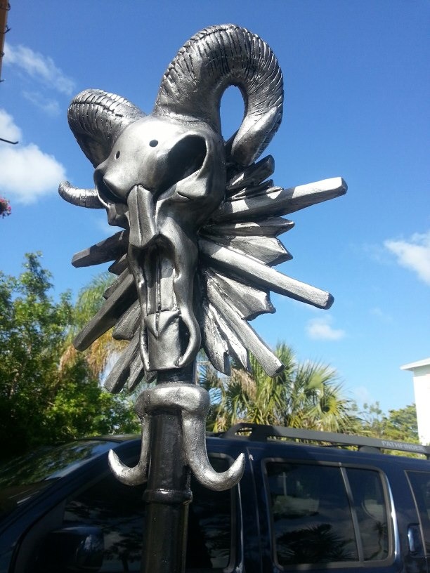

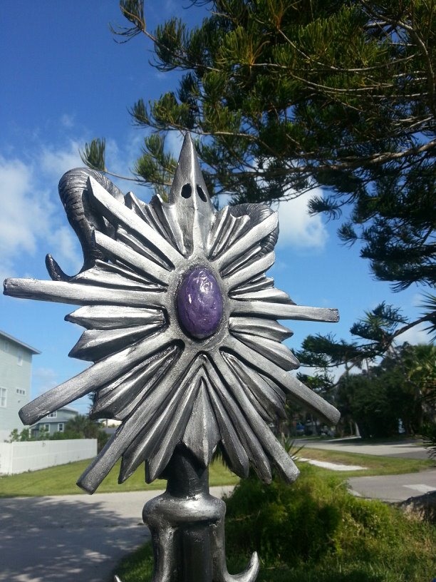

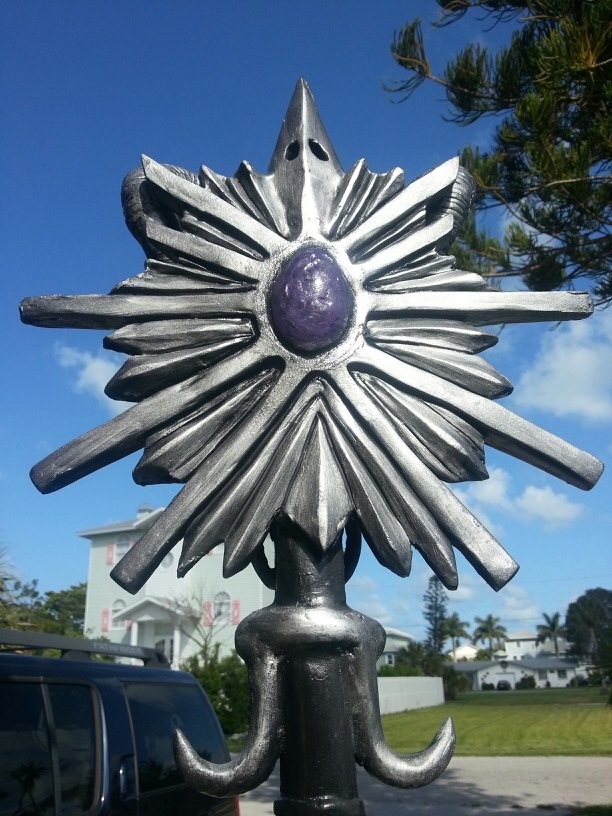

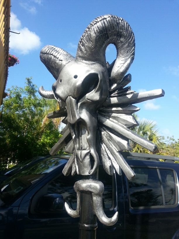

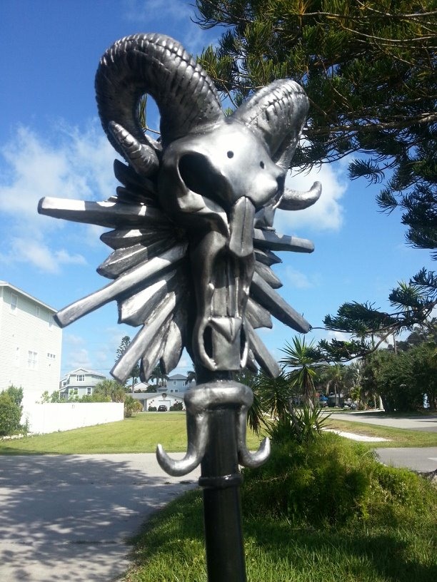

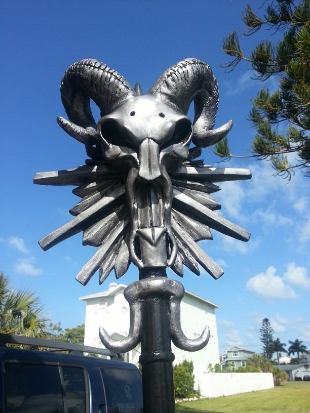

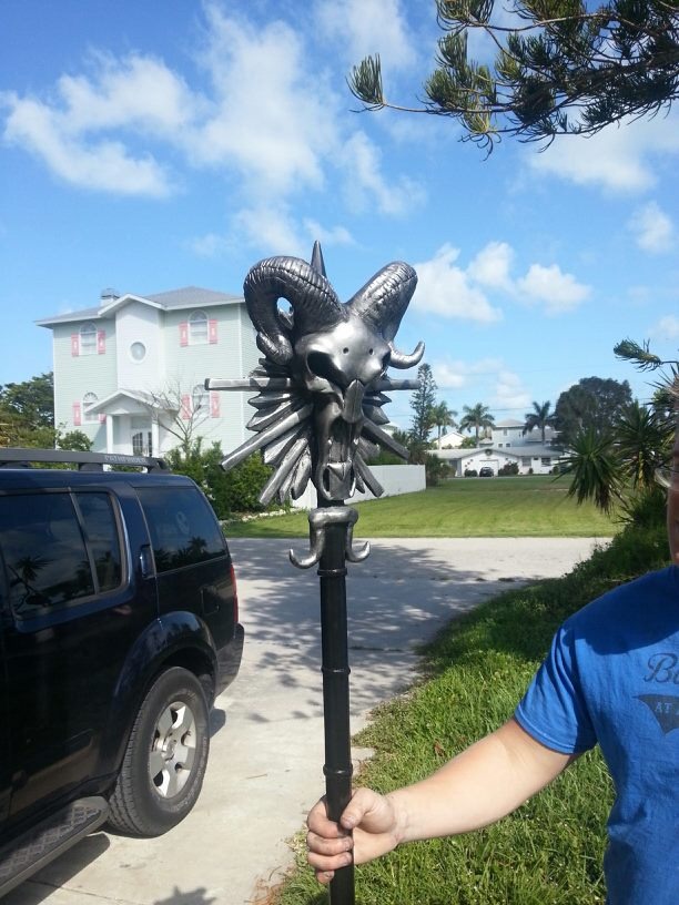

Primed,painted and finished!

awesome work on that.and i'm using that word too much. so I will throw in a fantastic too...
We are using Mold Max Stroke from Smooth Cast. We order from Reynold's Advanced Materials off of Pinecastle in Orlando. The Mold Max Stroke is better for Bondo filler work which is my main medium. Dries in about 45 minutes for another coat and works with Urefil 11 to thicken up allowing for the 3rd and 4th coats to be thicker and stronger greatly cutting the amount of time we waste molding our bigger pieces. I would suggest it to anyone, I've used rebound 40 and Mold Max 30- which are very good- but I'm very comfortable with this product. Thickens tough and keeps shape well as opposed to other silicones and is moisture curing. If you are going for extreme detail I would suggest going for the 30, drying times are just atrocious.
Sent from my iPad using Tapatalk HD

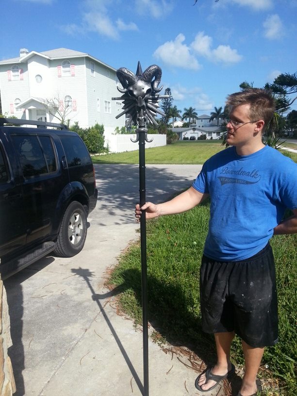

Thank you very much! It was almost impossible to get reference pics for it because I don't think anyone has replicated it yet. The gentleman who commissioned us is a huge fan of the film and has wanted the staff since he was a kid. He will be sending us photos in a few days of him using it with his costume and we will post more pics of it then.
