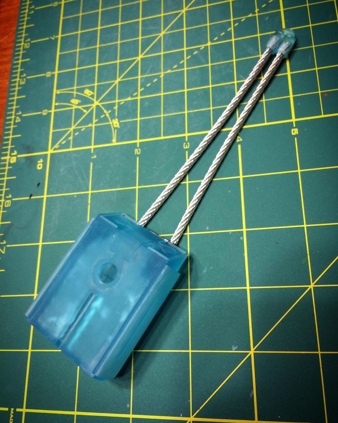

im goinging the 3d print route, using the model i liked above. Got 1/8" threaded cable last night and it fits perfectly.

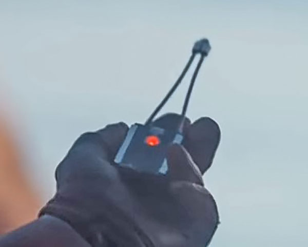

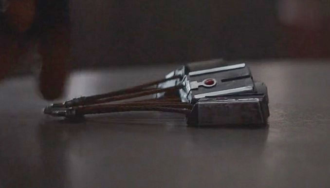

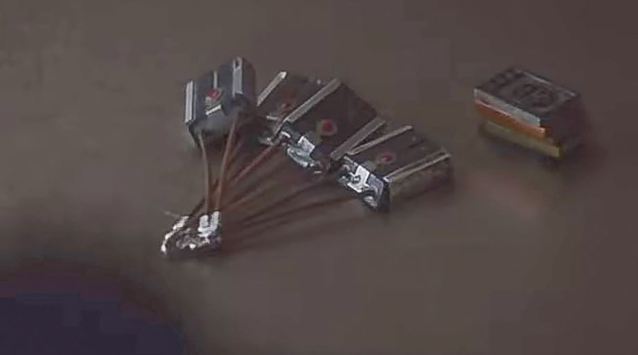

I've made some screen caps of the tracker. You can see the detail may be a little different on each of the trackers, but I'll draw something up tonight.

Looks great! Where'd you get your scale from though? My (admittedly crude) measurements came out a bit smaller. I mainly used the shot with the credits for reference, with the credit bar as 52mm.

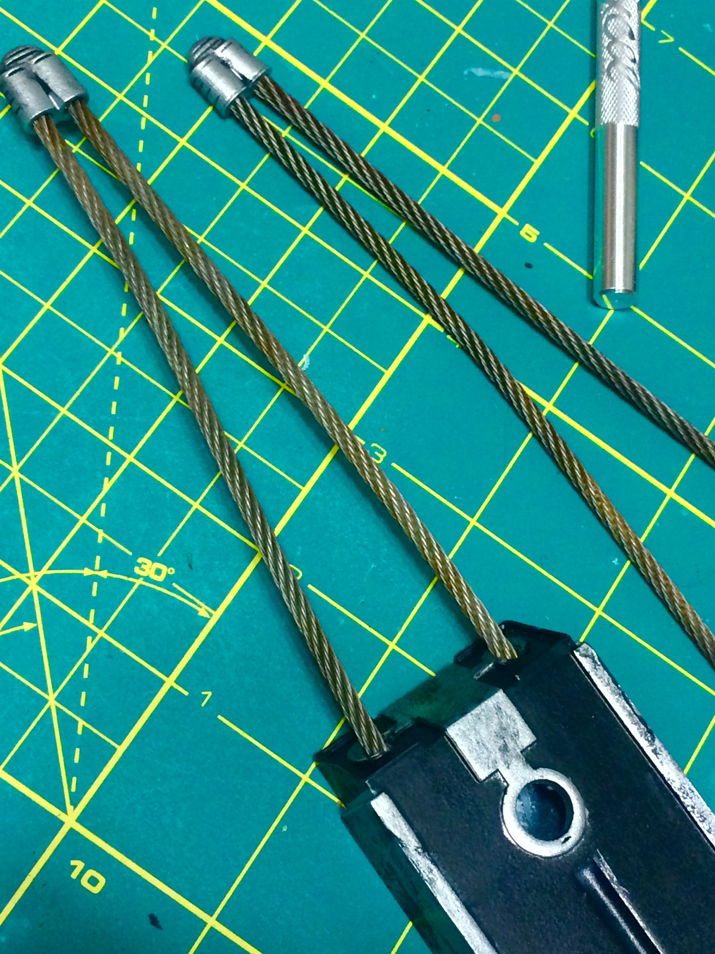

The 1/8 galvanized steel rope from Ace works great. I soaked these in vinegar/salt/hydrogen peroxide and baked in the oven to get a nice layer of rust and cleaned some away.

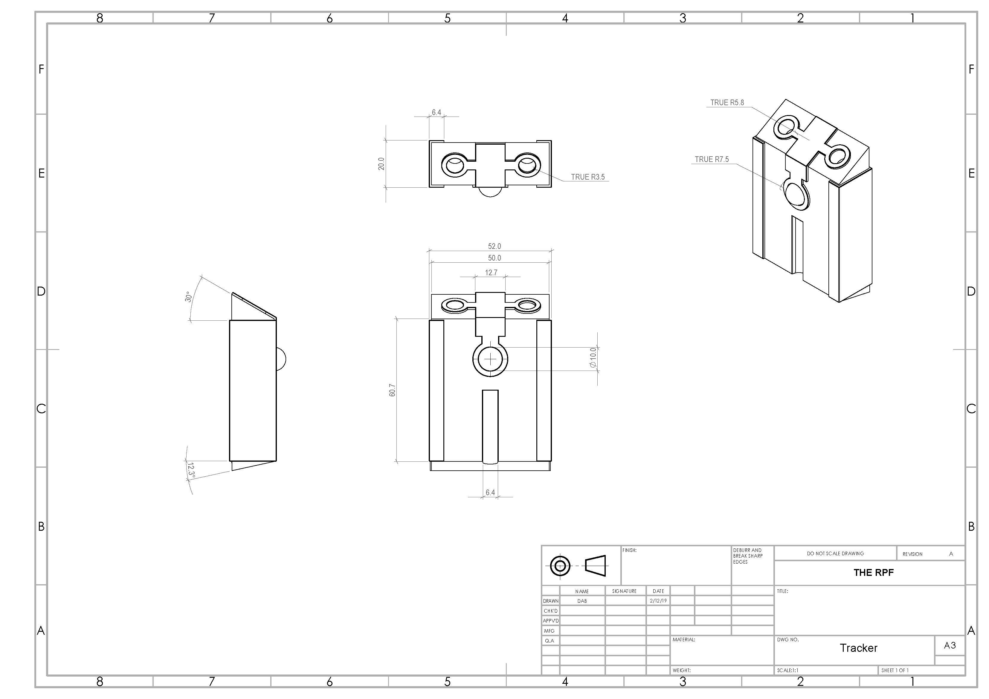

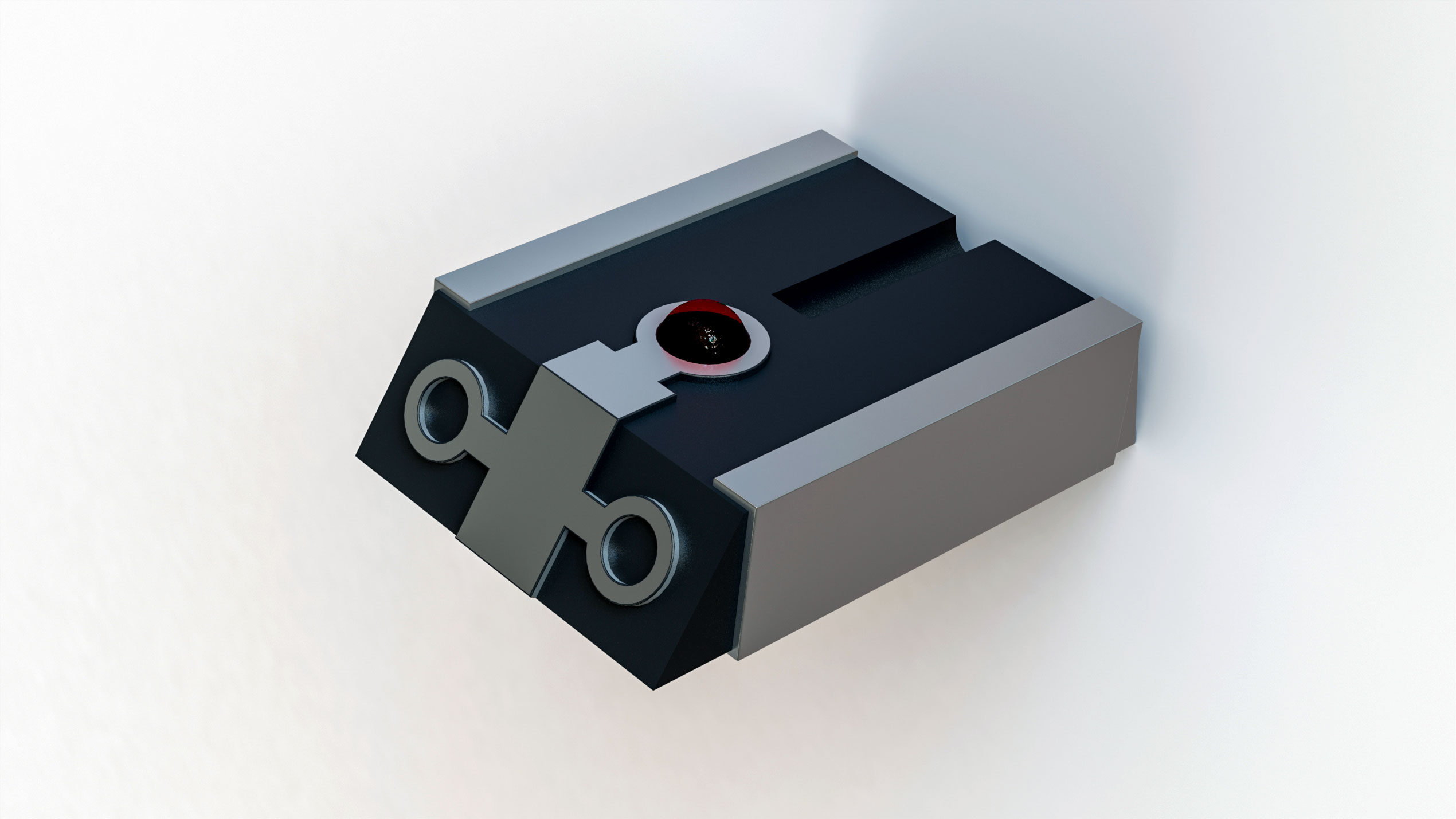

First draft with what I can see of the tracker at this stage.

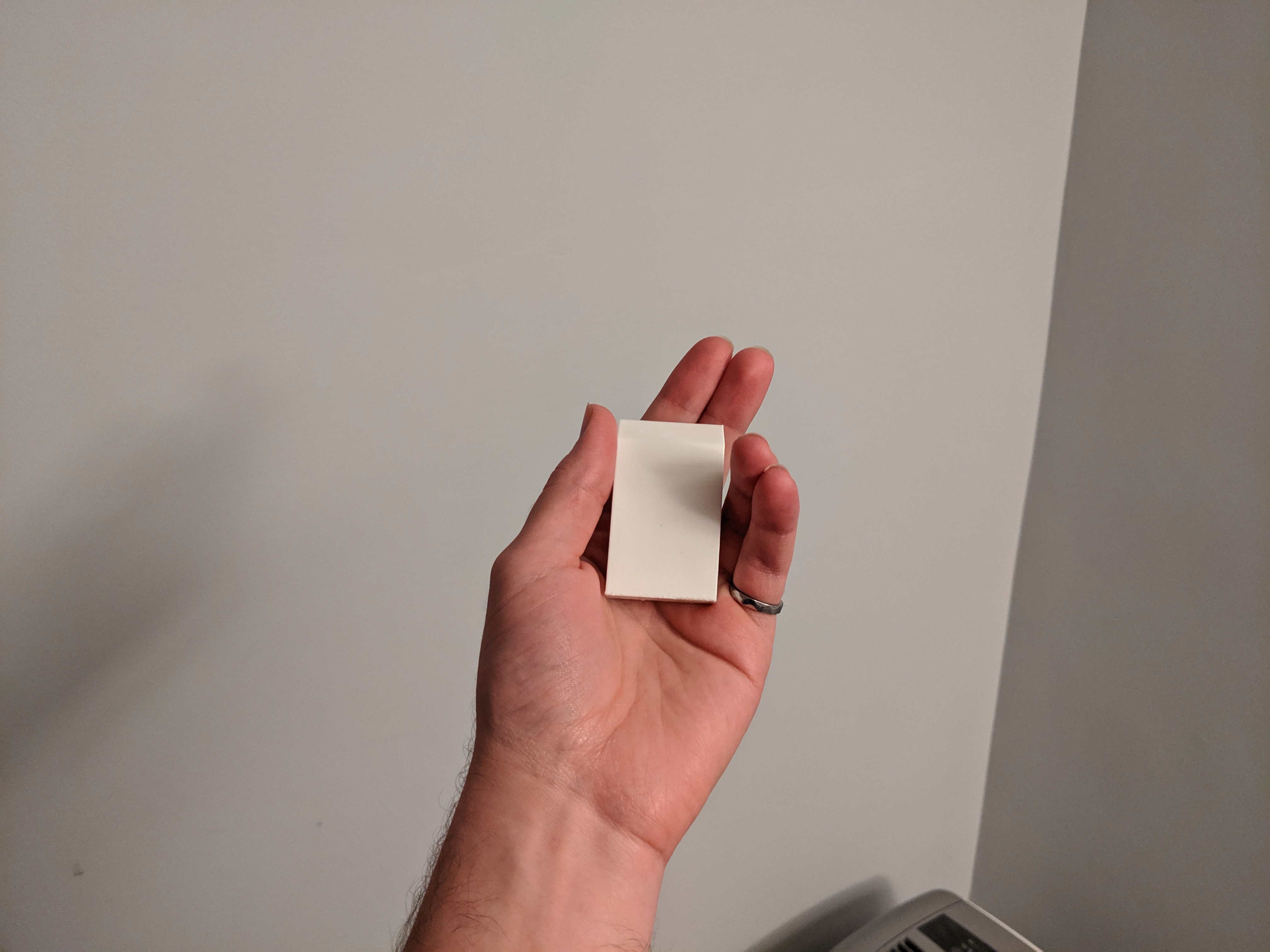

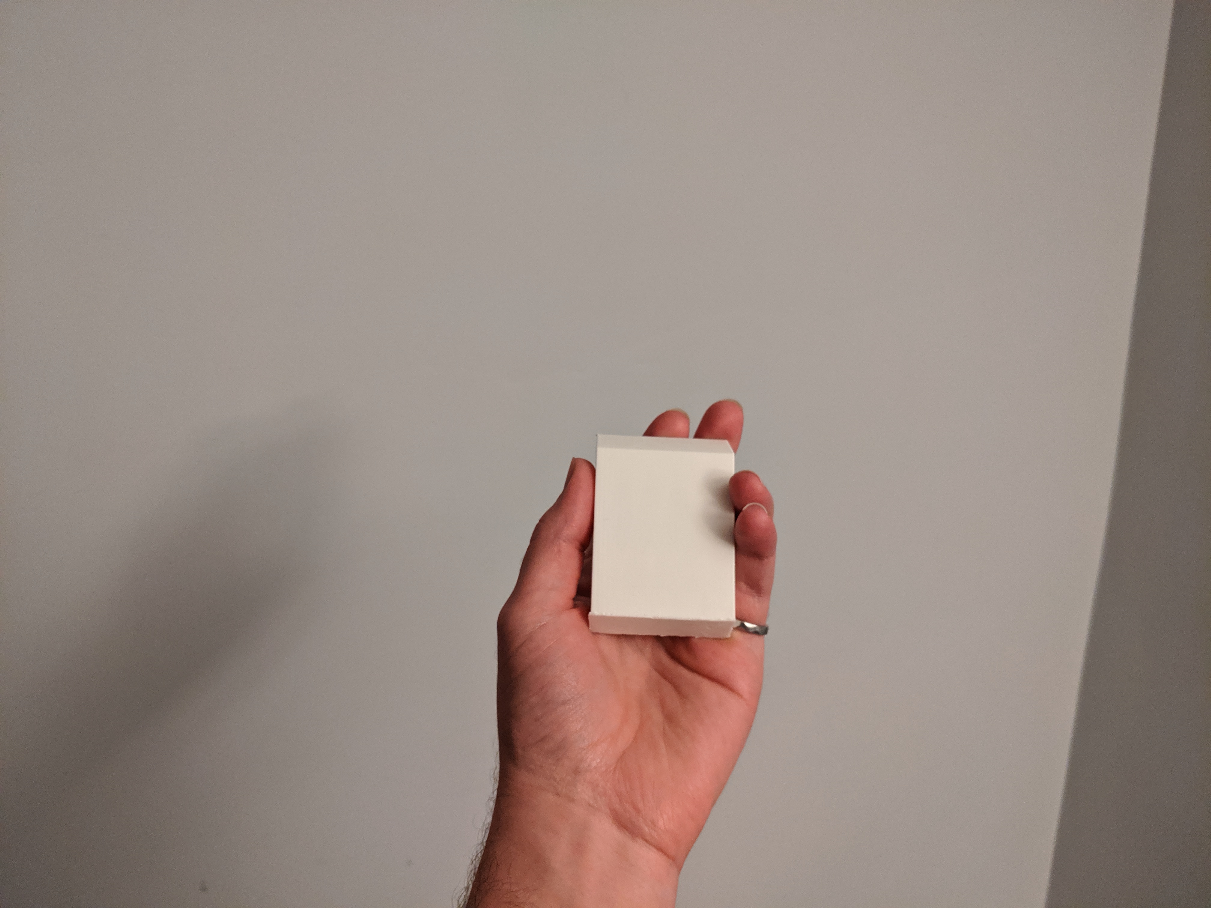

I did a rough block shape based off of your measurements:
My Measurements:
And reference image:
To my eye, mine looks way too small, and yours looks a bit big. But maybe Pedro Pascal has a bigger hand than I do.
