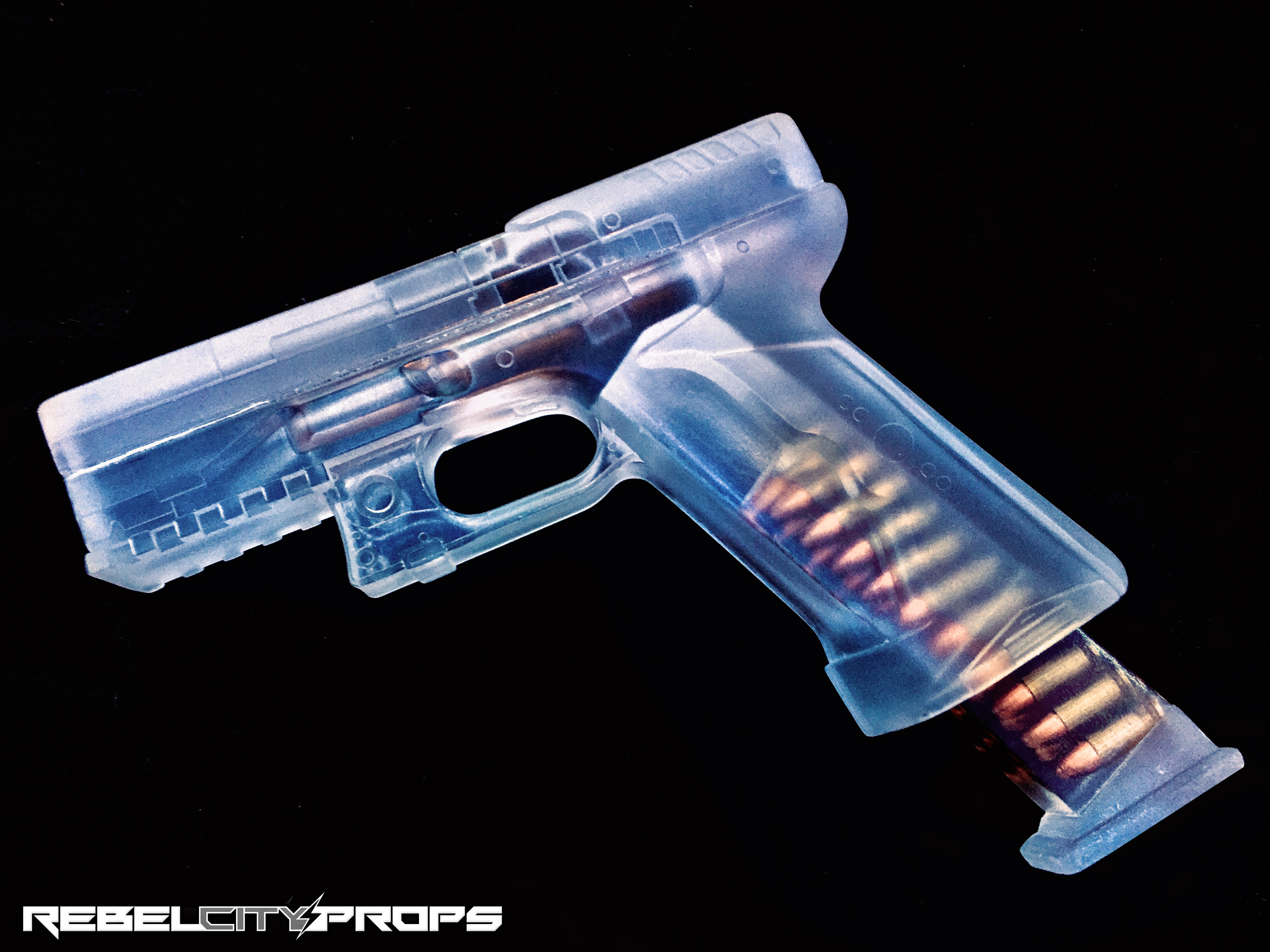

Limited Run 'Major's Thermoptic Pistol' (2017) Ghost in the Shell

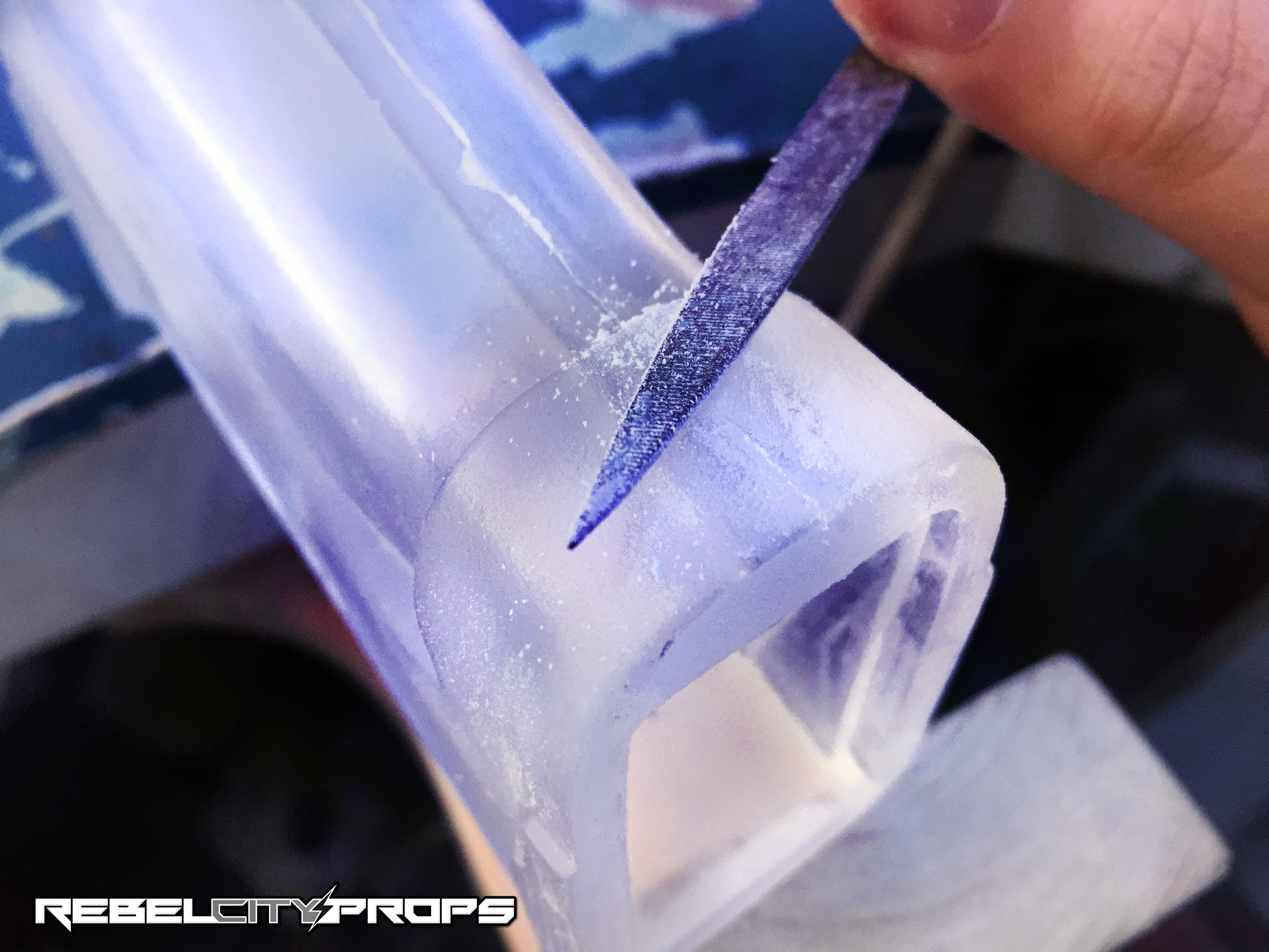

Basically the biggest task to I've been trying to check off the list is sanding off the seams from the castings. This normally wouldn't be such a big hurdle but because these seams run along areas that have to remain perfectly clear and can't be painted over. Due to this the clear areas have to sanded, wet sanded and polished without causing any damage or scratches... not easy.
Thankfully I have access to very fine grade diamond files that have made the process easier but still time consuming. Using a flat edged fine file, i began by removing the excess resin bleed and flattening out the surface.
When everything is evened out and smooth, next came the wet sanding with an even finer grade file. I would add a small drop of water and sand away until the water became milky and then wiped off the surface, replaced the water and repeated. I did this to prevent any material build up under the file that could have led to scratches developing.
This was a very slow and laborious process but necessary to achieve the desired results, especially since i had so many to do, I wanted them all to come out as good as the first.
