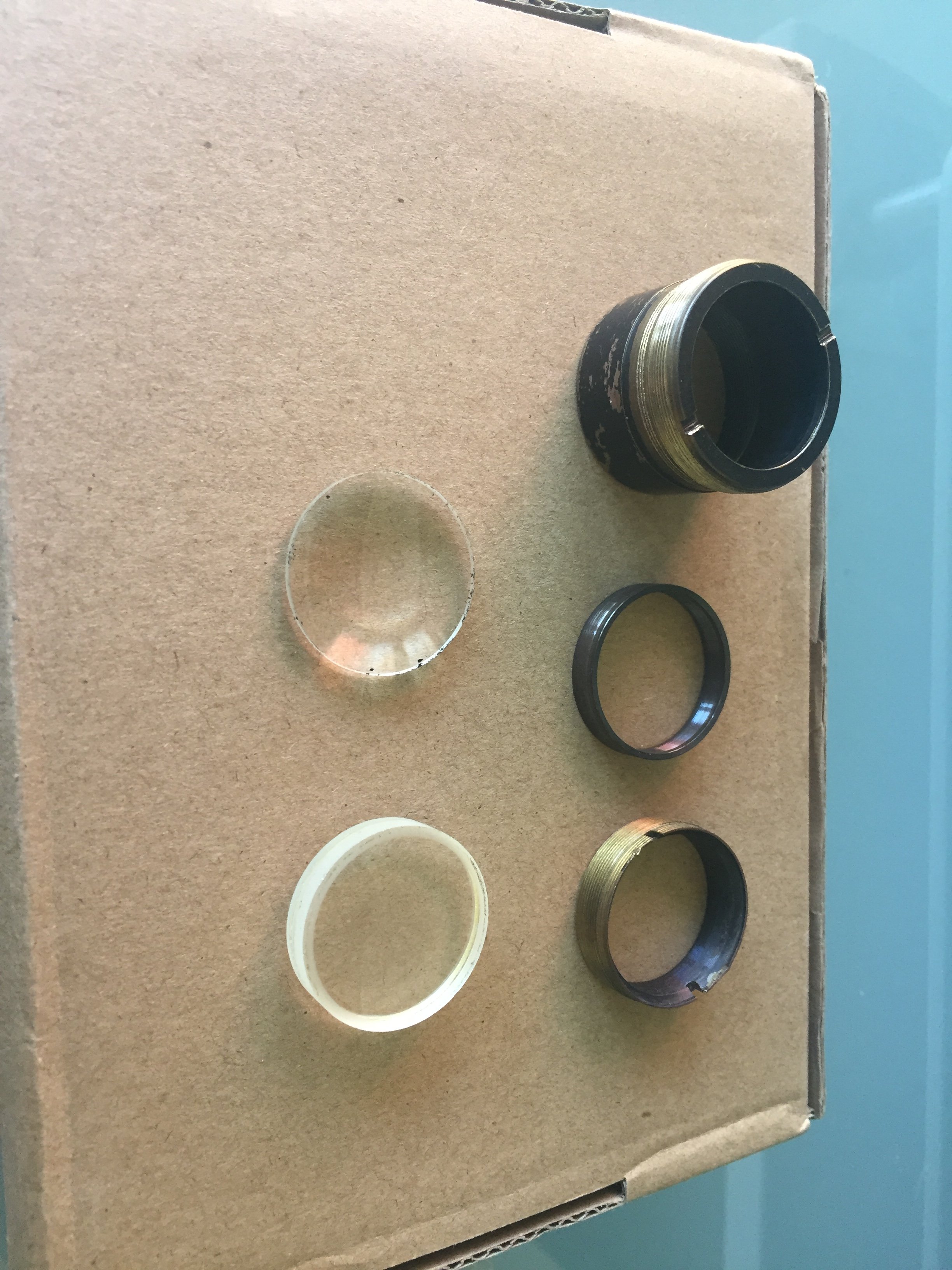

I disassembled my scopes so I could cast them part for part. Maybe edraven99 wanted to clean the lenses. I would agree it can be a risky job if you strip the notches while unscrewing the rings plus if you don’t re-assemble it correctly (fully taking out the prisms and central reticle) you can alter the optics. I have one scope I will never take apart and preserve as a collector’s piece.
Ok.. now what lol
Ok.. now what lol

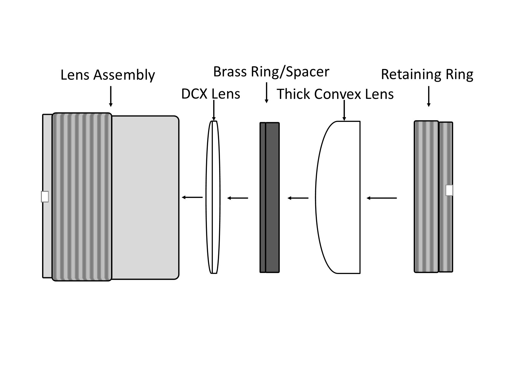

To put it back together , first the double sided convex lens goes in the large lens assembly/holder, next the plain brass ring/spacer, then the thick one sided convex lens- convex end facing the brass ring, and lastly the retaining ring with the threaded end screwing in -notched end facing outwards. It should fit together nicely once it’s all packed in there. If you need a video or photo reference let me know and I can send you something to help you out.
and for the direction of the brass retaining ring, I think it’s the single grooved end that faces in first. Hope that helps.

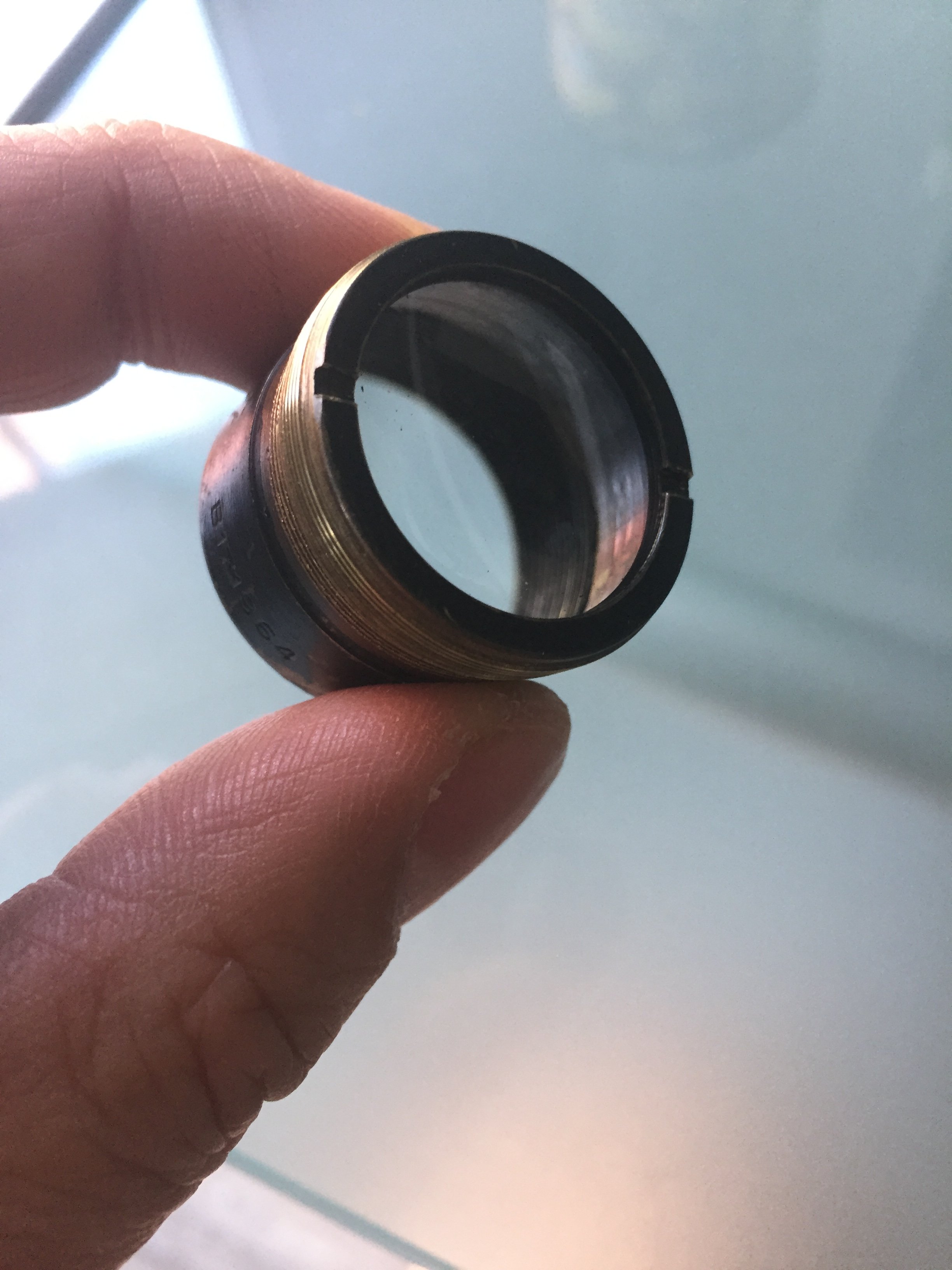

Ok, but the problem is, the large assembly with the double sided lens is still the end with the threads. I thought the threaded end was supposed to be front facing when screwing by the assembly back into the body (thanks for al of the help btw... very much appreciated!)
Hope this helps. I will make a short video if you need one when I get home tonight. Let me know if the diagram clears things up.

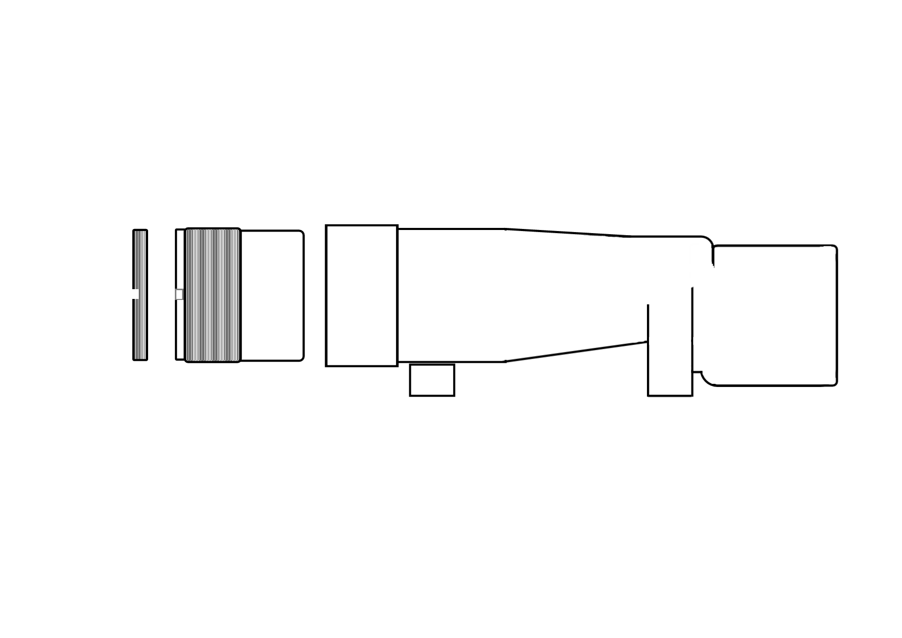

Yup! That’s how I have it! It when I screw the assembly back into the body, it gets stuck with the end with the retaining ring hanging out like before.
I think you are putting in the lens assembly backwards. After you have the lenses all installed in the lens assembly then it should be assembled like this. Screw in the lens assembly first, non-threaded end first(end with the inner retaining ring ). The notches on the front face ring of the lens assembly are used to help screw it back into the scope tube. Then the outer retaining ring gets screwed on.
