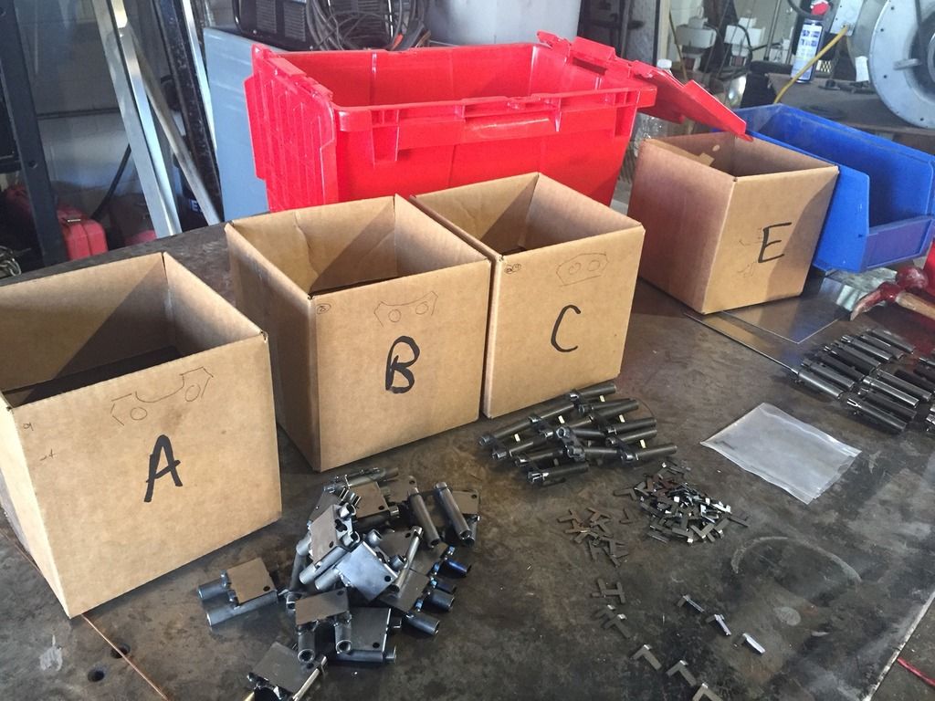

Had a chance to catch up on some power cylinders this weekend too....
Brackets after tig weld,,, waiting for grinding and deburring
