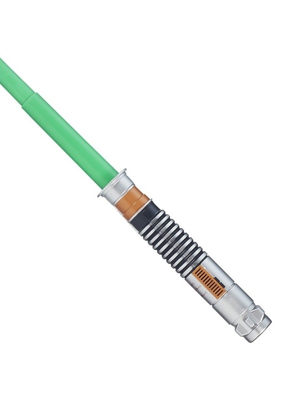

Anyway, enough of that. Since I couldn't really afford one, I decided to pick up the cheapest lightsaber off the shelves, the basic electronic lightsaber.
Yes I bought the Luke Skywalker blade builder saber in all of its glorious plastic parts, extendable blade, and a decent soundboard. I would have never considered the plastic ones simply because they were oversized. But this one is close enough as a cheap replica. It also helped that I was desperate.

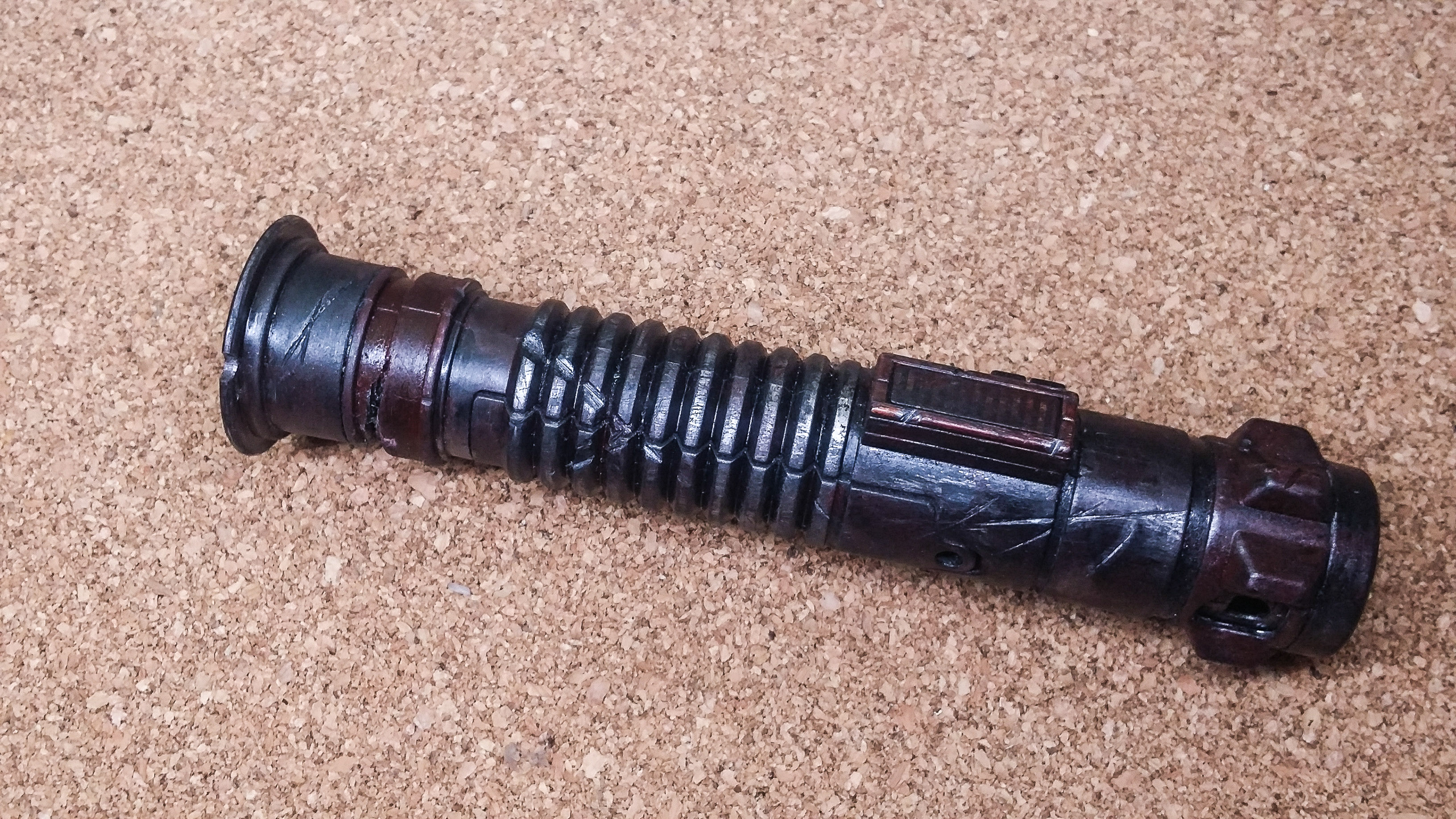

I decided it was time for its mod. I was going for a battle damaged version as you can see.
Nothing fancy. Sandpaper the saber, black washed it a couple of times, used a file to put in some scuff marks and damage. I also removed the blade through a very unconventional way Then added 'rust' to it by mixing a bit of black to a mixture of brown and orange acrylic paint. Messed around with it a bit till I got the colour I wanted. As you would know, the colour in the photo would appear slightly different from what it really looks like. But you get the idea. When that was done I added a tiny bit of metallic silver by dry brushing.

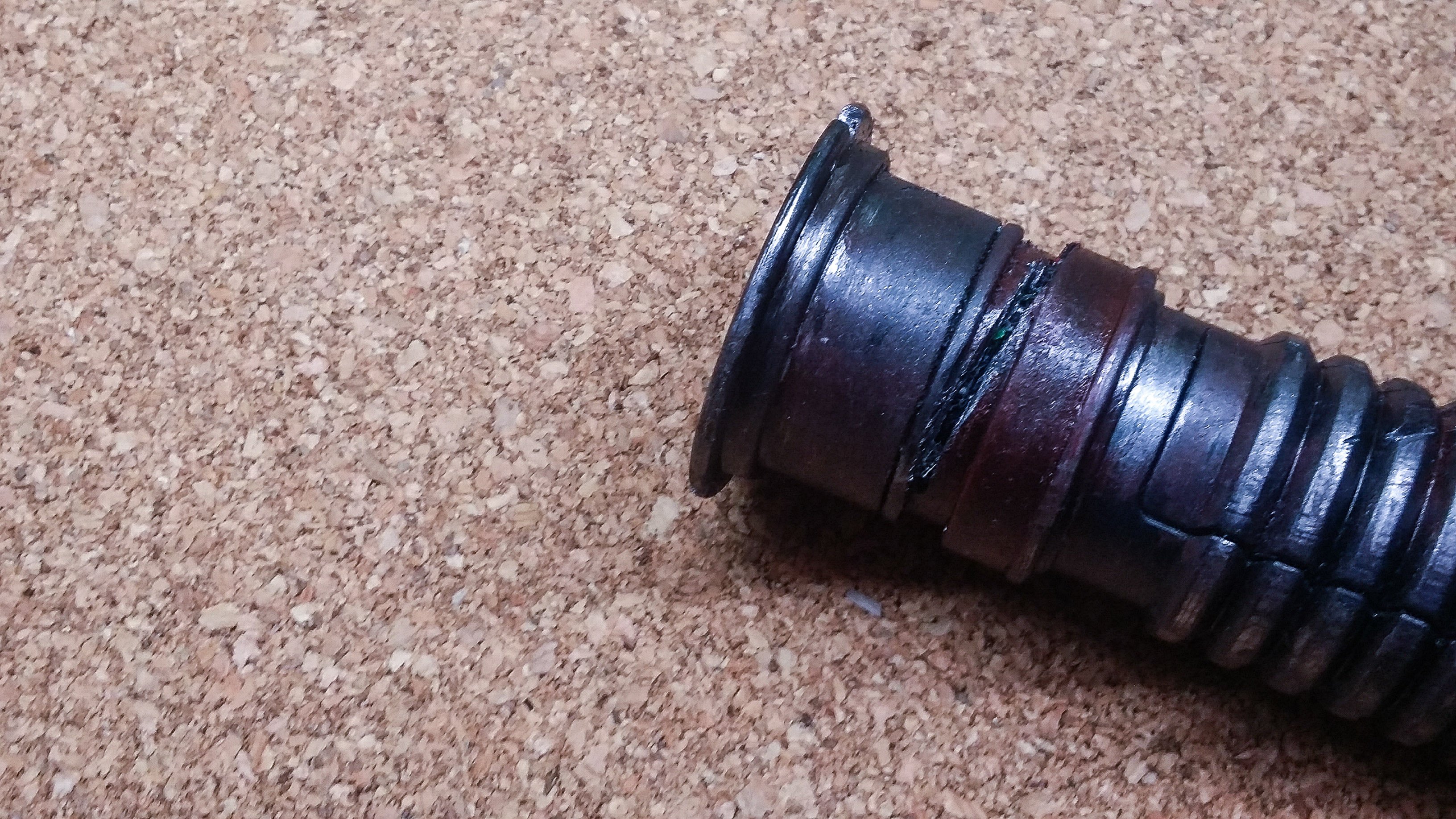

You may also notice a deep gash over the neck of the saber. That's where I intended the light to leak out like it was really damaged.
Another plus point, left unmoved the lightsaber would flicker and with a cracking sound that makes it seems damaged and slightly unstable.
So cool. Blends right in with the change I made to the blade. You can watch the video to see what I mean.

Here's the problem. While I was able to file my way through the neck, I found another plastic piece that held the blade in place between the inner wall of the emitter.
I could easily work that out with more filing but... The led is white and would not be bright enough to shine through the crack. Here is where I would need some help and advice. What can I do about it?
A green plastic tint may do the job just fine but I won't be too satisfied about it. Plus, it would only make it dimmer.
I was thinking of changing the led but I wouldn't begin dismantling it if I didn't know how to piece it back together.
Also, I might plan to find a way to attach a polycarbonate tube into the hilt and make it detachable since there is already a nice housing in which the blade can sit flush. I am aware that it would make it unbalanced, but it's fine with me.Advice?

I can tell you this...those things are NOT easy to cut into or work with at all. I recently cut a luke version for the t tracks I needed. I used a Dremel to cut it in half and then cut the tracks off. There is some serious plastic (and even metal wire) in these. You are going to have to get creative. Good luck!
Thanks, Lotustar! I appreciate the pointers. These things are indeed not easy to cut or work with at all. The plastic is thicker and sturdier than I thought it would be. I just need to figure out how to get to the electronics without destroying the saber. The white light is just embarrassing. It's essentially a torch light at this point.
Indeed as Lotustar suggests you need to think like a propmaker ... could you use a piece of green glass from say a bottle to alter the white into green inside? Or perhaps some fake plastic green jewelry crystal, which can be found in those vending machines for cheap?
Think green translucent ... it doesn't need to be matt, which indeed would make it dimmer :)

You're absolutely right. I was thinking more of a plastic gel they use for photography flashes. It's a thinner material that can easily be cut. Sort of a temporary fix to the problem until I've figured out the internal workings of the lightsaber. I would very much like to have the led changed. Will be looking into making a blade plug too. I came across some acrylic tubes in an art store that I could use. I'll try to keep this thread posted on my progress.
Odds are you have a 5mm LED in that saber. A 10mm would make a HUGE difference. It wouldn't need a heat sink and the board could handle it no sweat. I ordered 10x of those for $3 USD on fleabay from China for a DL-44 build. They have green so that might be your most economical option with the greatest impact. You would still have to get the saber apart to solder in the new LED. I don't envy you that :/
I hear you on your first saber. Finally got my first (a Force FX) this year and it was magical. Good luck with your build man, and kudos on your English.
