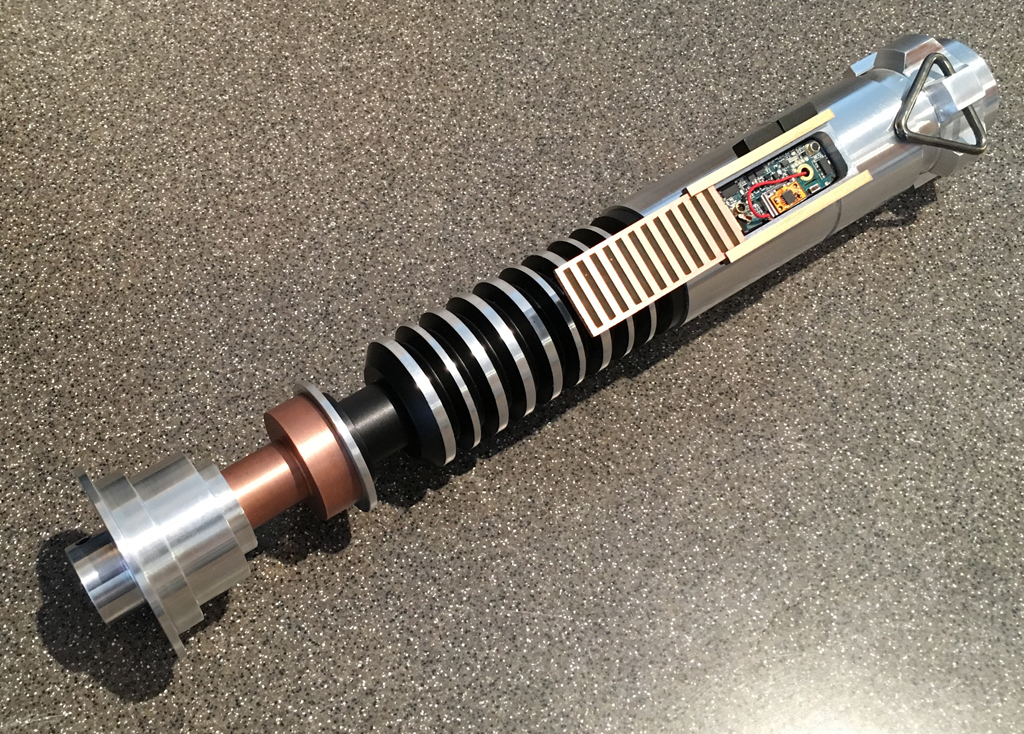

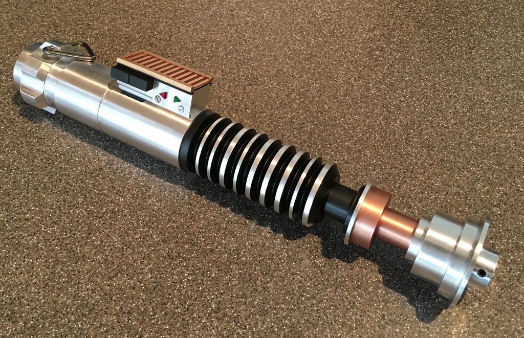

I thought I was done, but I couldn't leave well enough alone.

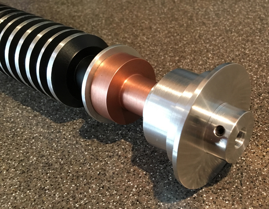

I had always planned to paint the "windvane" gold, but after I saw it, I hated it.
I stripped off the gold paint and then left the copper part in ammonia fumes until I liked the shade. After that, I polished it a bit with 0000 steel wool and put a coat of Krylon "Matte Finish" to preserve it. MUCH better.
Secondly, I wanted to add some detail to the emitter, so I finished drilling the hole in the "nipple" all the way through with a 9/64 drill bit and then tapped it for a 8/32 set screw. I also drilled the central hole in the emitter all the way down to the threading. Technically, this could hold a blade rod now but I'm not going to try it - I just wanted it to look right.

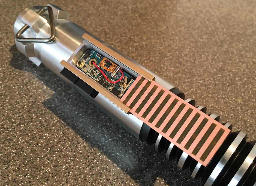

Lastly, I made a circuit board to go in the control box out of some cellphone bits.
I'm calling it done now:
