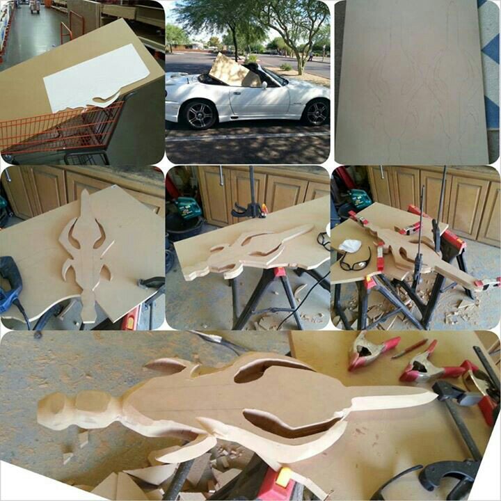

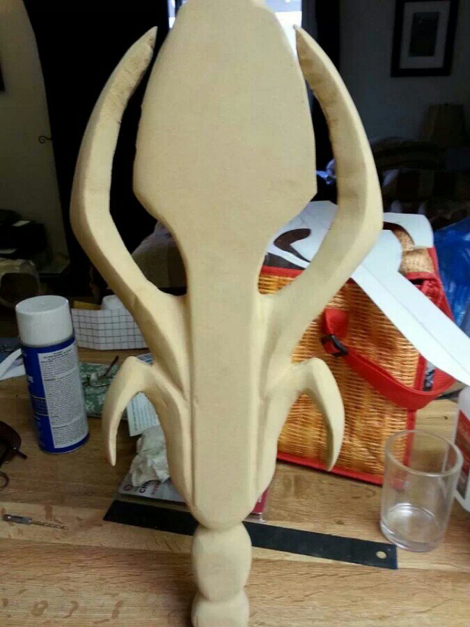

I am also making the Odin Spear. The spearhead is mdf. As you can see, I still have a lot of work to do.

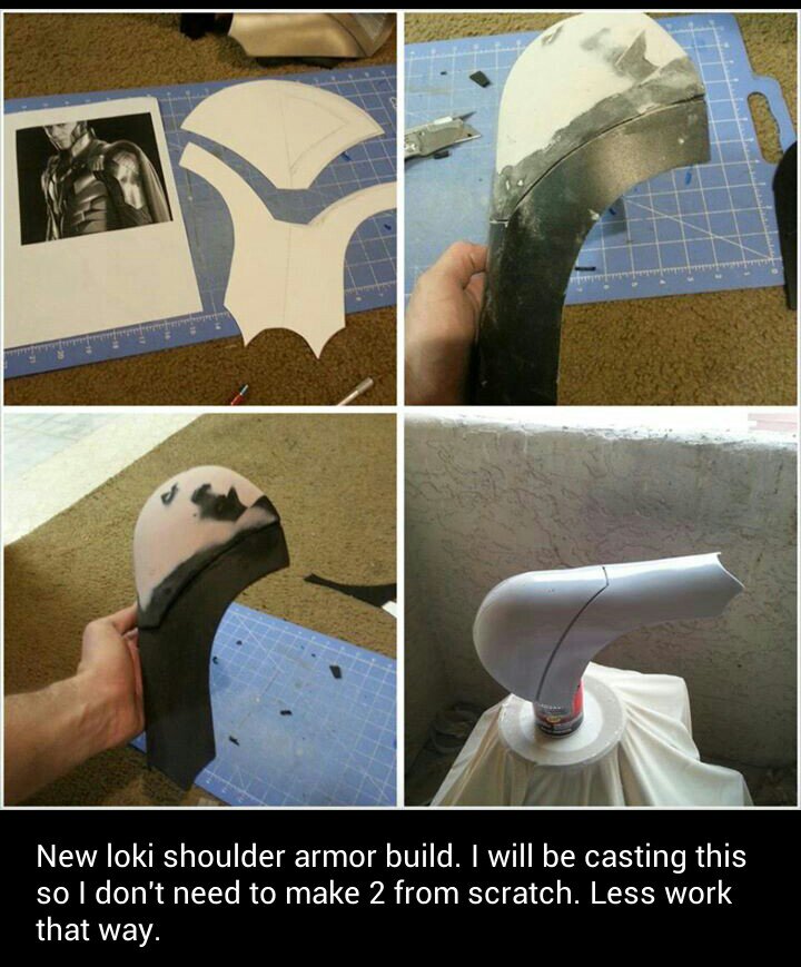

Started with a paper template, used 3mm sintra with Bondo

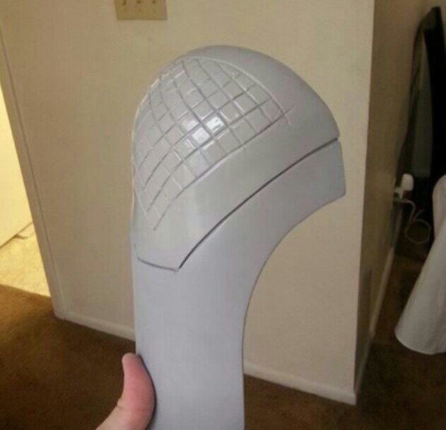

Added detail

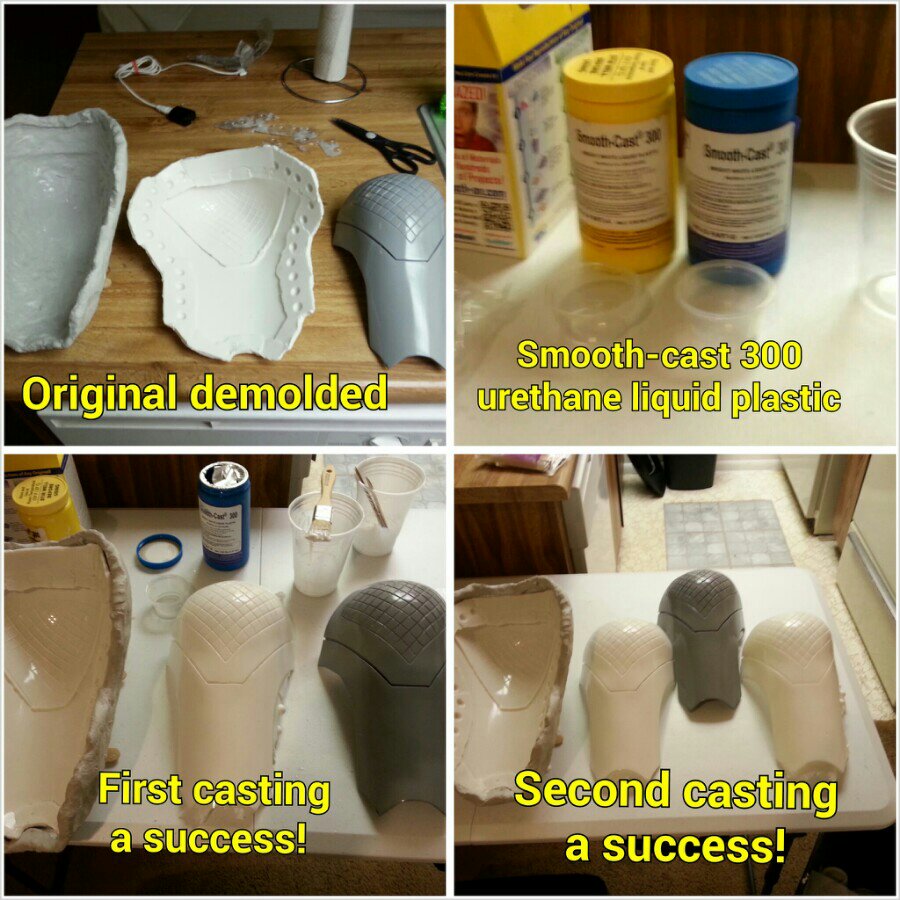

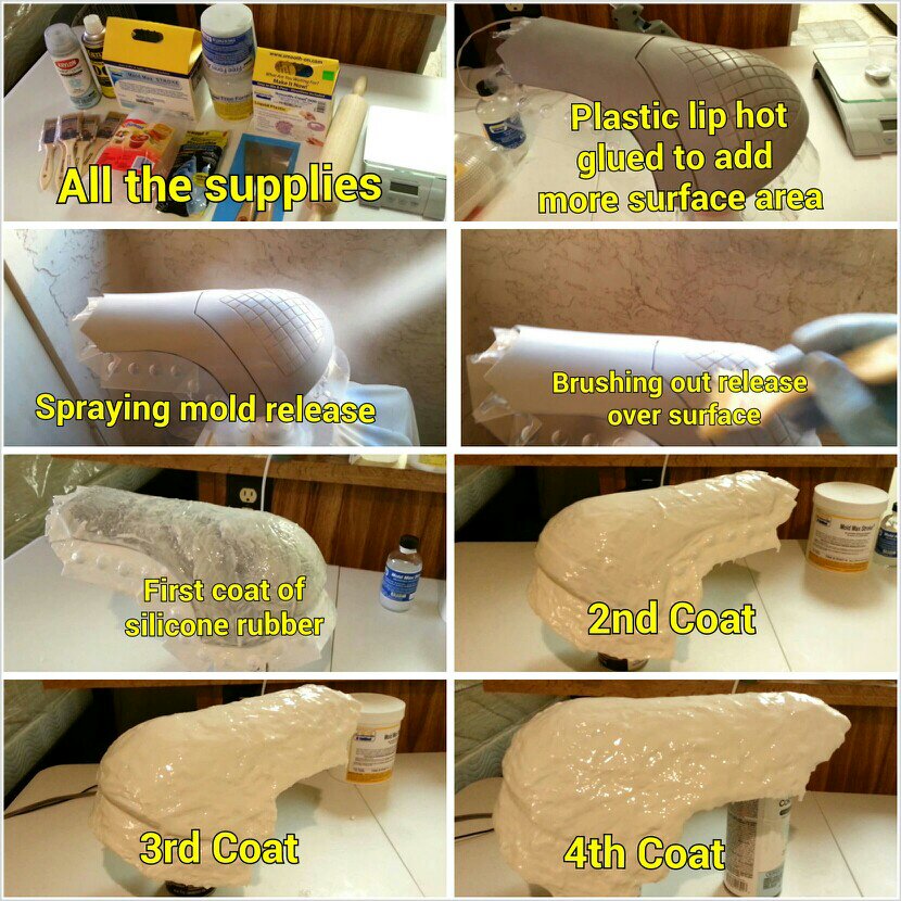

Picked up all the casting materials for the shoulder armor

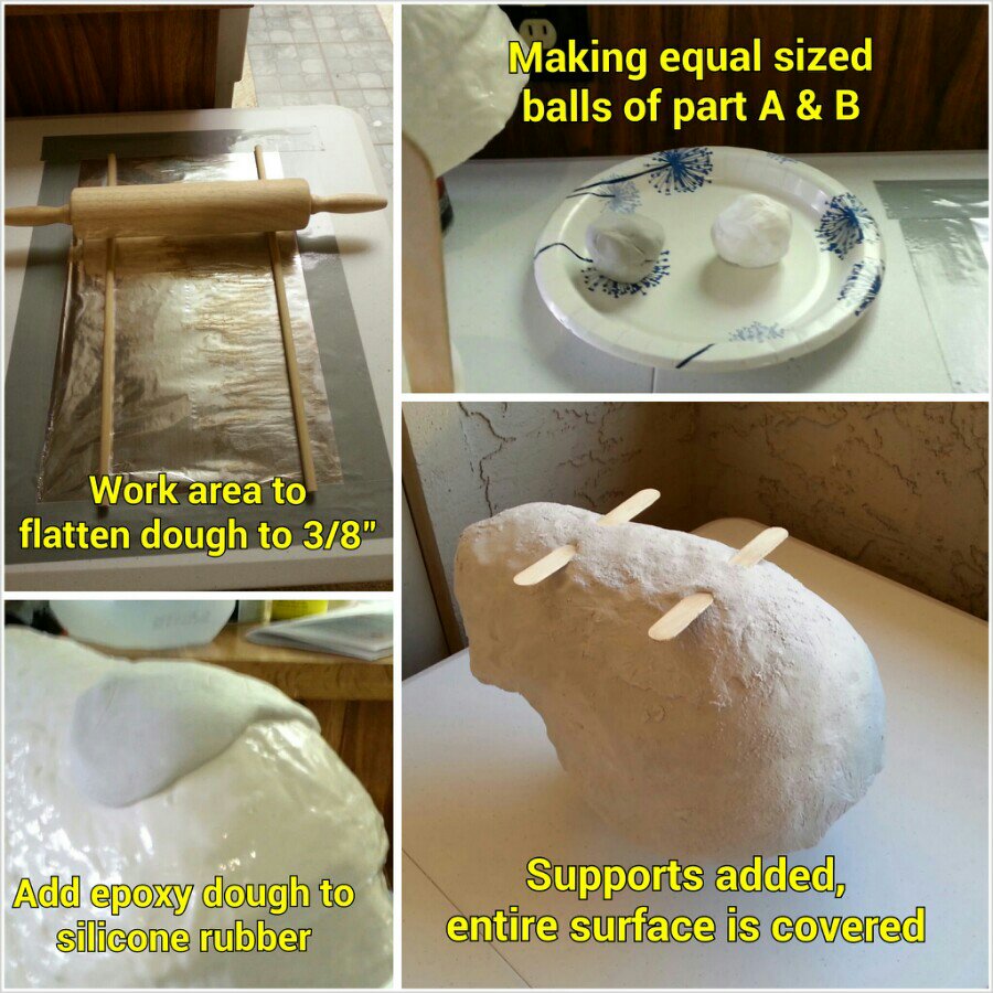

Outter shell made from Smooth-On Free Form Air epoxy dough. Upside is that it weighs next to nothing and works like soft clay or playdough. Downside is that it takes 24 hours to cure.
Using smooth-cast 300 to cast the loki shoulder armor.

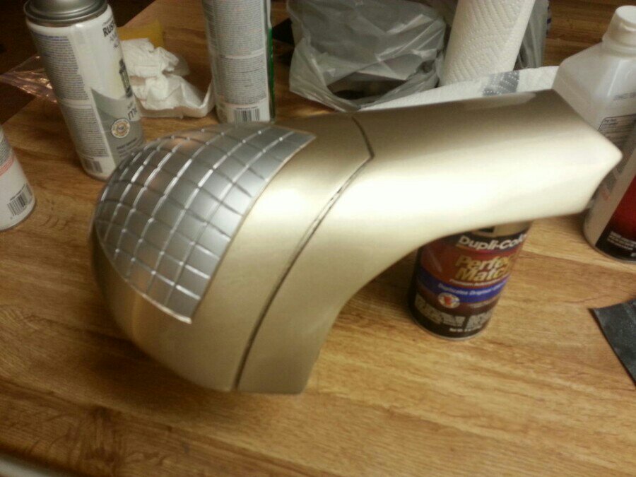

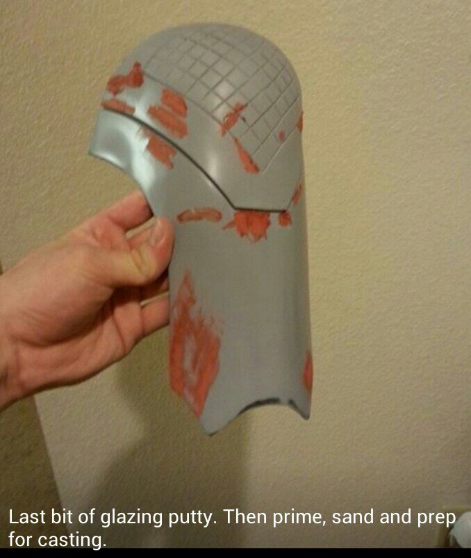

First shoulder painted. The silver area is in a satin finish while the bronze is in gloss. After it's fully cured, I will sand with 1500 wet/dry, then polish and wax it to a glassy finish. I am leaving the silver area satin.

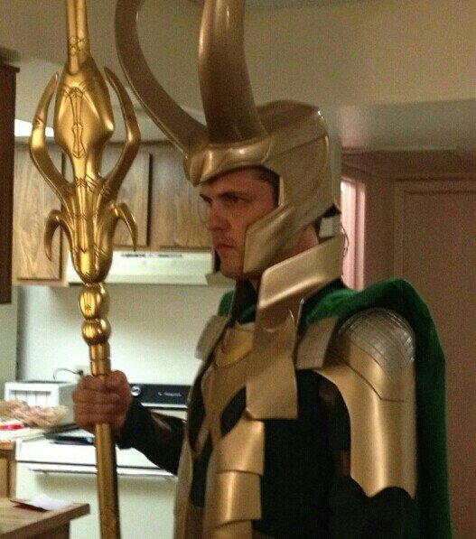

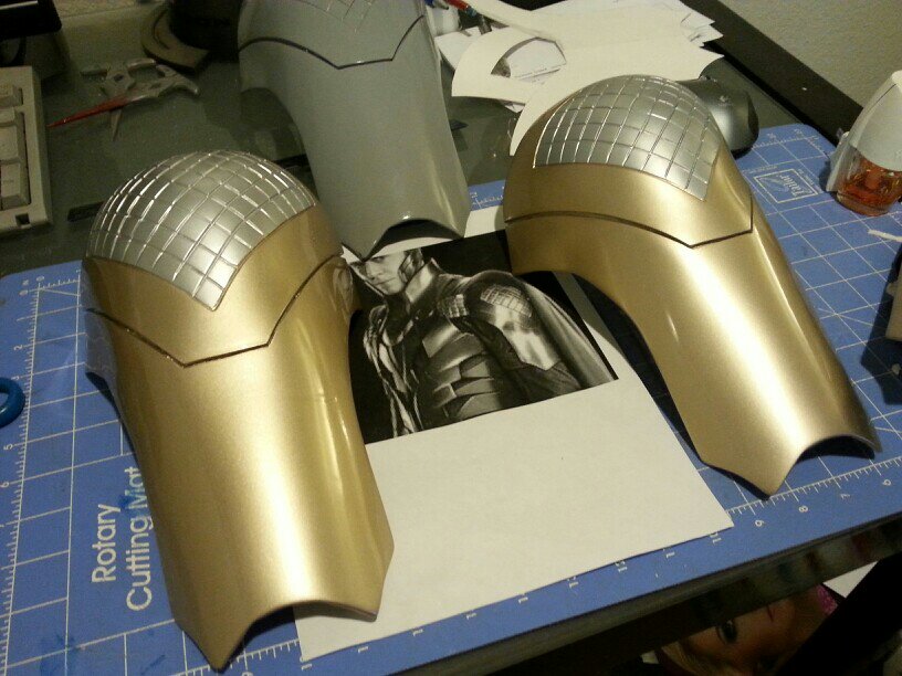

Test fitting all the new armor parts and Odin spear
