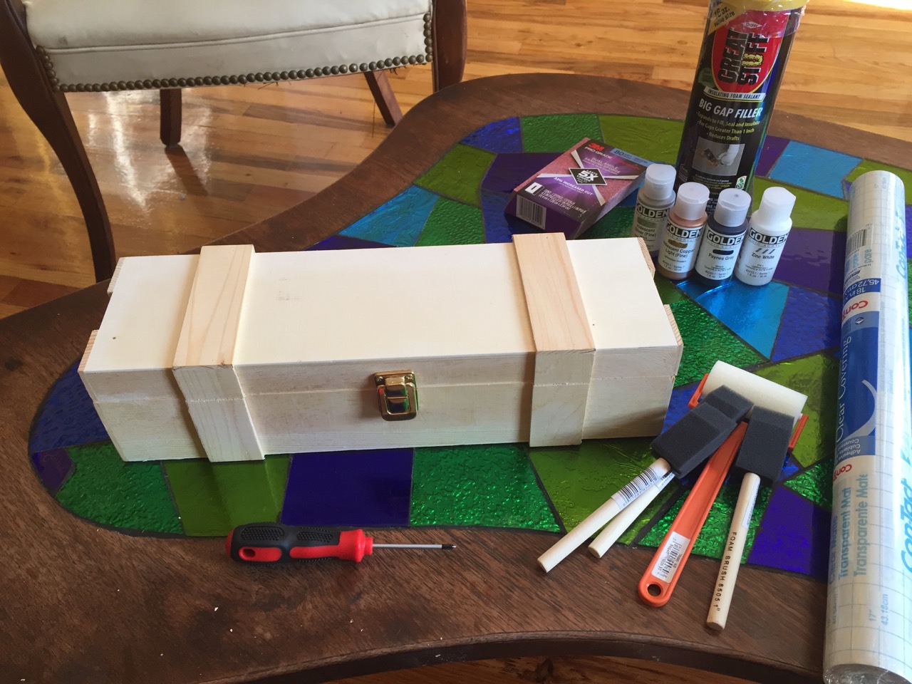

Anyway. Started with a hinged wine box, ten bucks on the ol' Amazon:

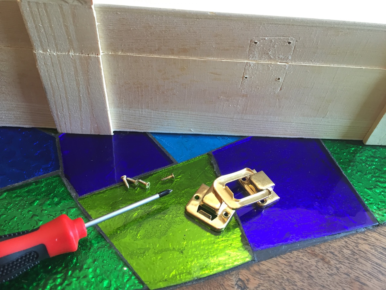

Got rid of the lame clasp on the front, to make it easier to open with the Force.

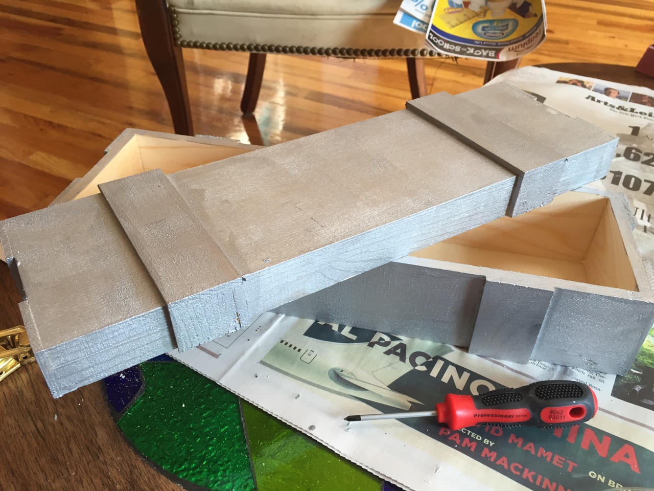

Put down a base layer of silver, since my plan was to make it look like a beat up painted metal box:

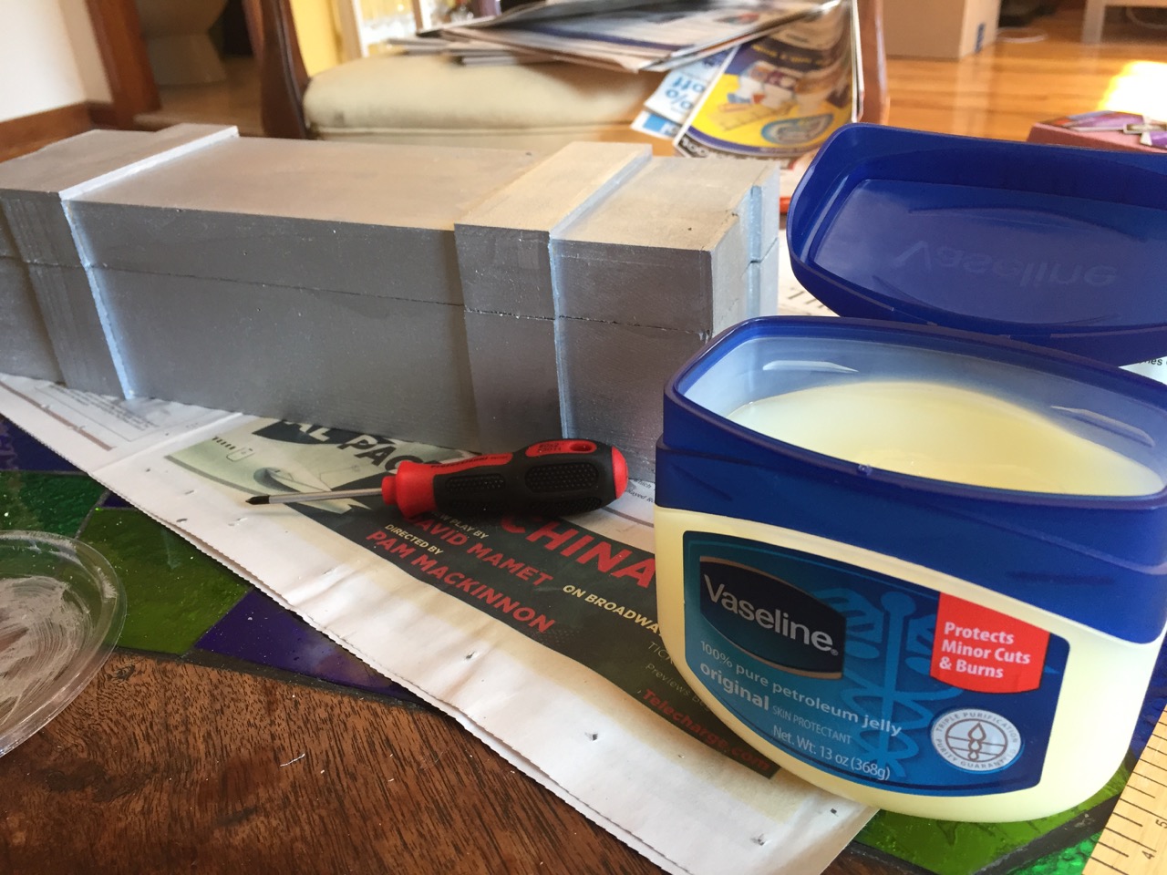

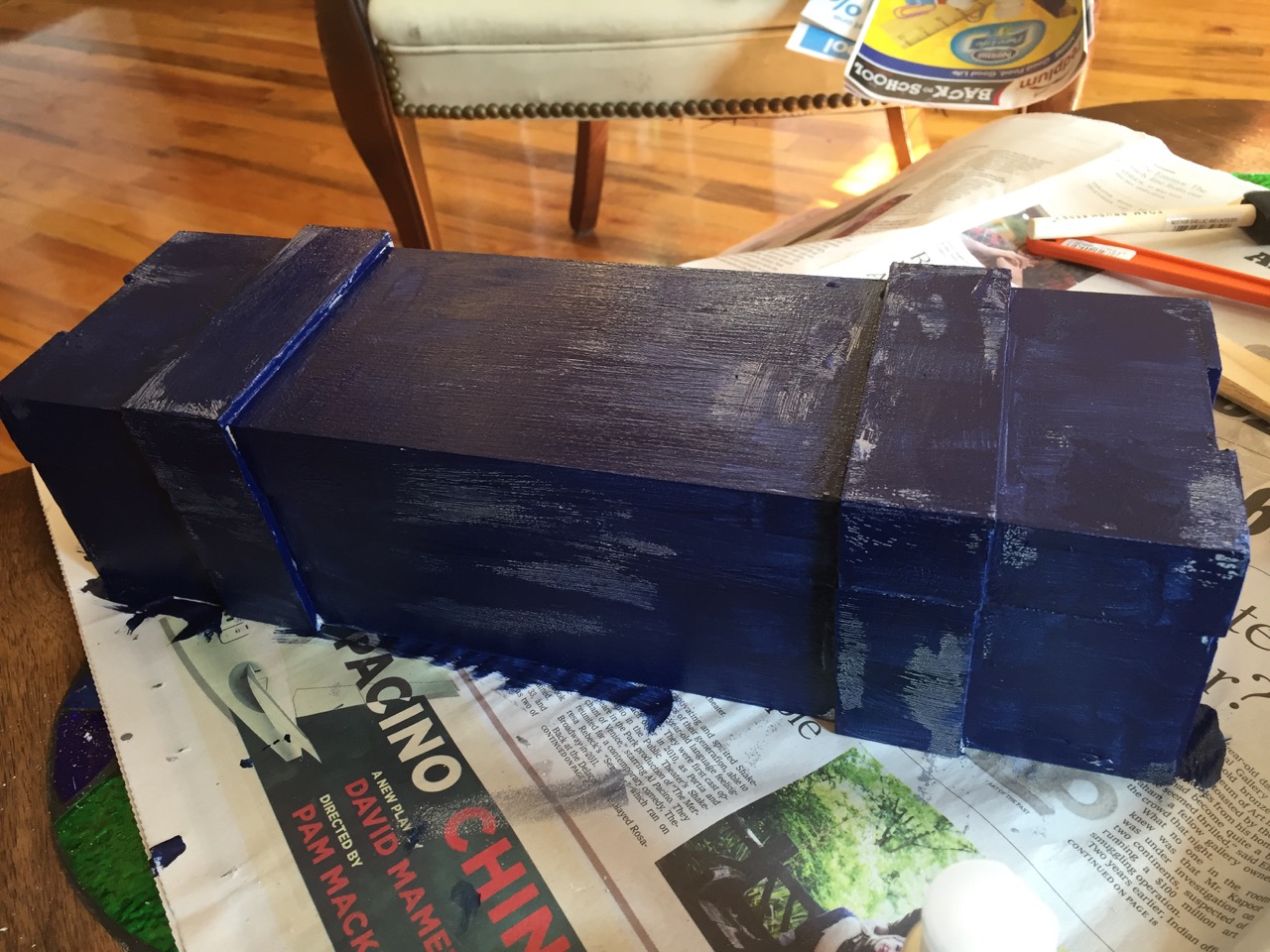

So I read somewhere about weathering with Vaseline and I was skeptical but intrigued. Greased up the corners and the raised areas like Lunchlady Doris greasing up Groundskeeper Willie:

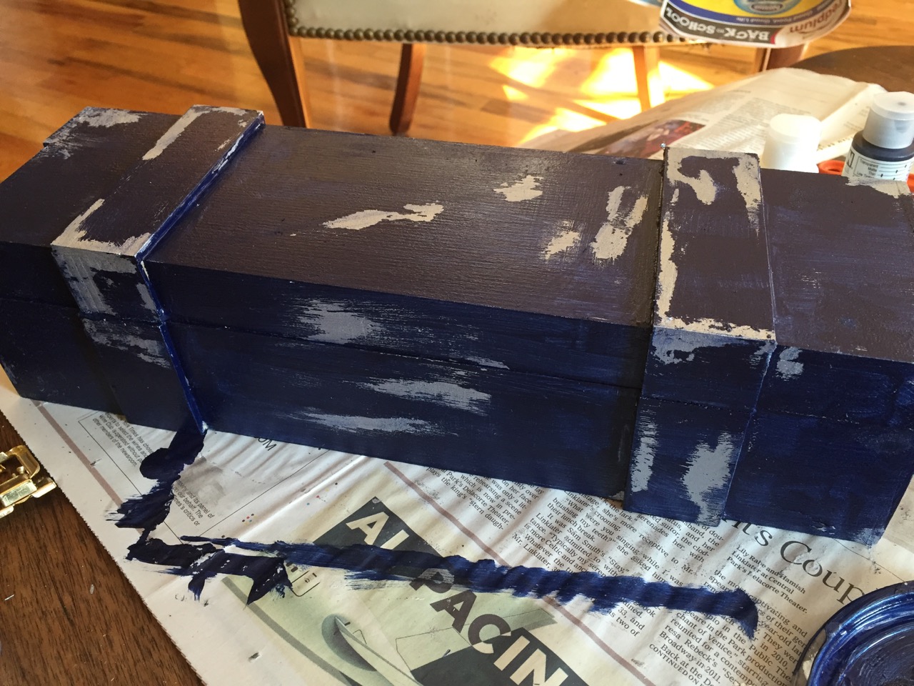

Slapped some dark blue paint on (you can already see the paint beading up where I applied the Vaseline):
The same tutorial I read suggested sandpaper, but it just sorta smeared everything around. I found that the Vaseline keeps the paint so wet that wiping it off with a paper towel was actually way more effective.

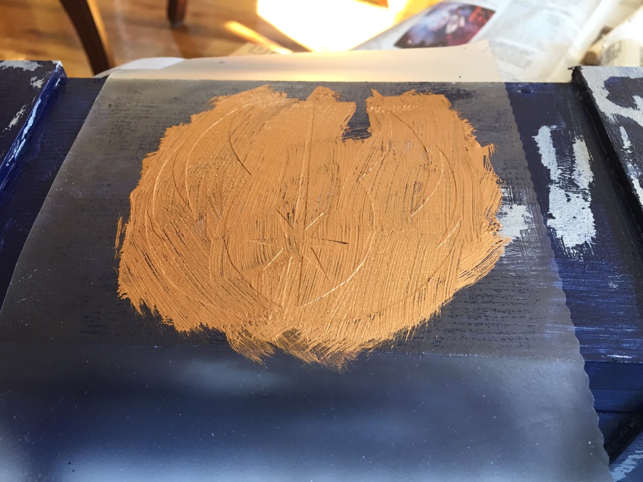

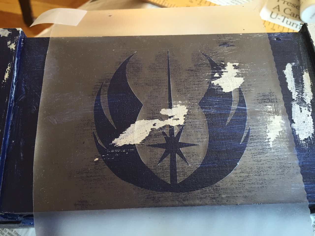

Applied the stencil to the top and slapped on some more Vaseline where I had already weathered on top, then applied a coat of copper paint:

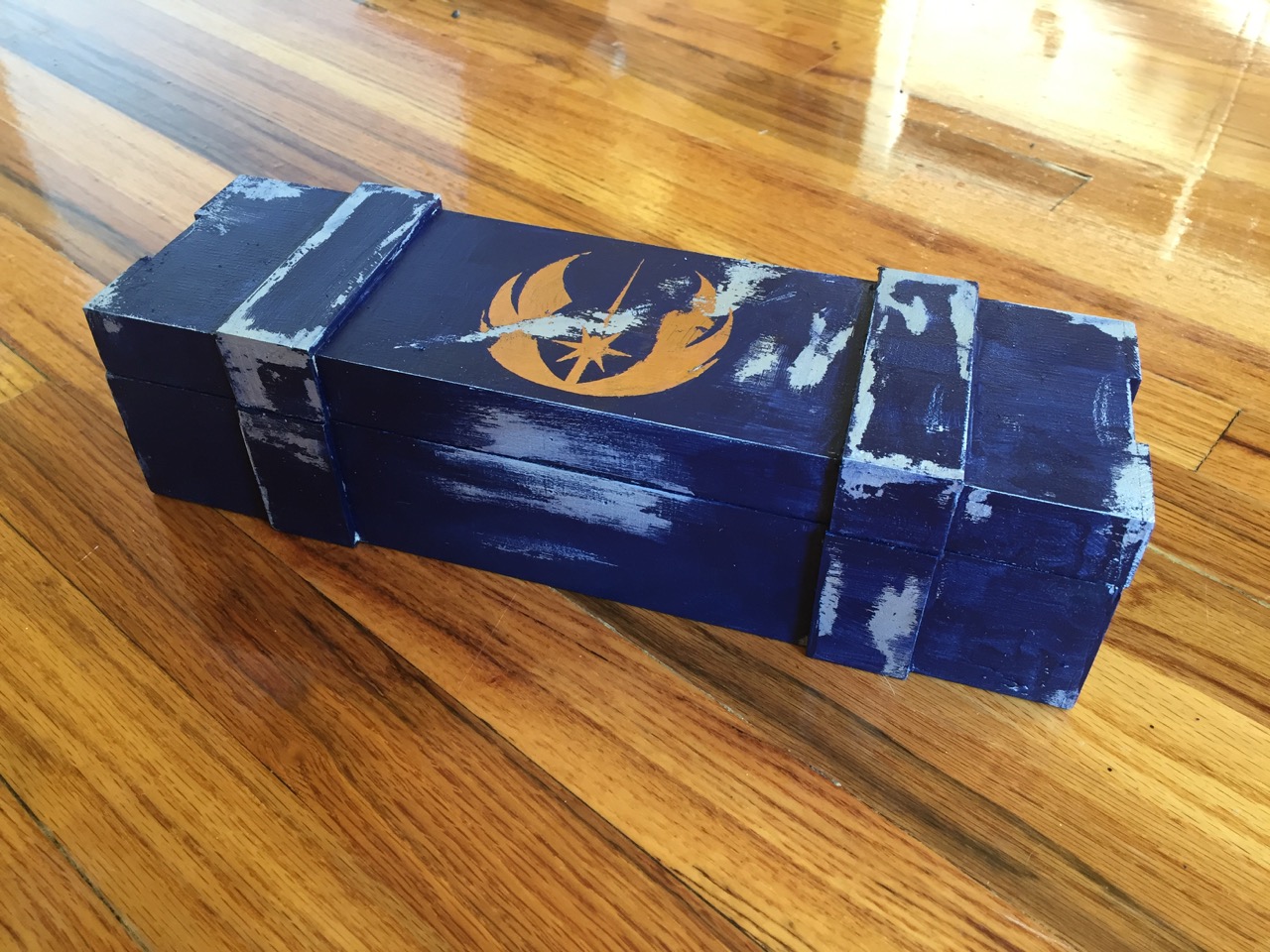

Dried, wiped off the same portion of the copper, did some additional detail work with an Exacto, and voila!
