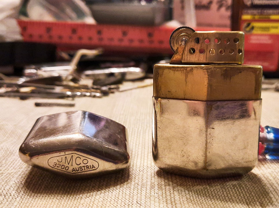

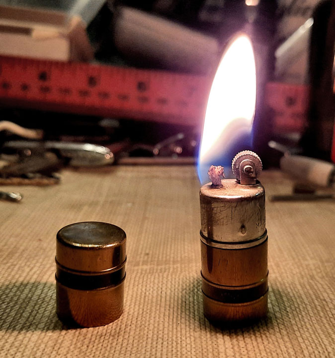

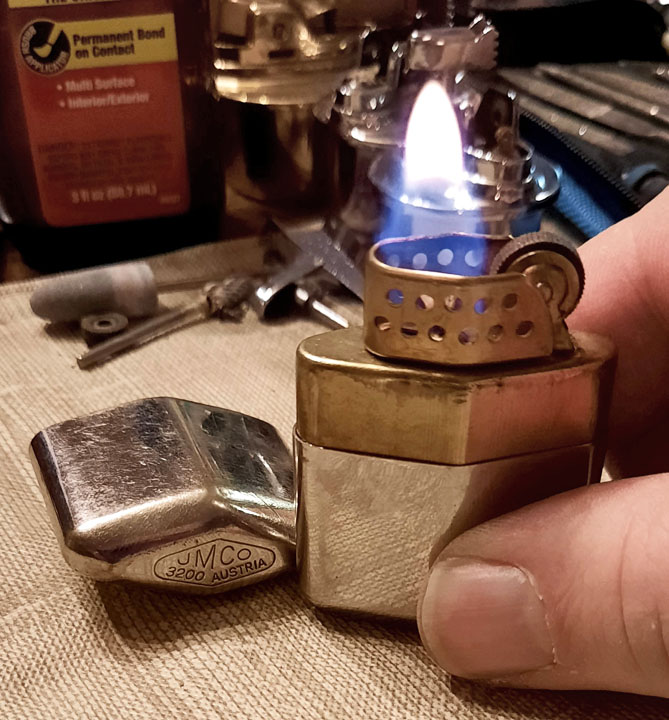

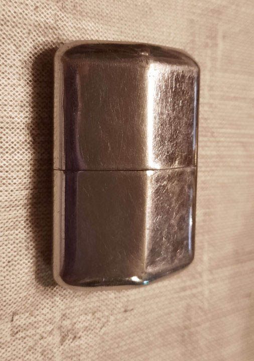

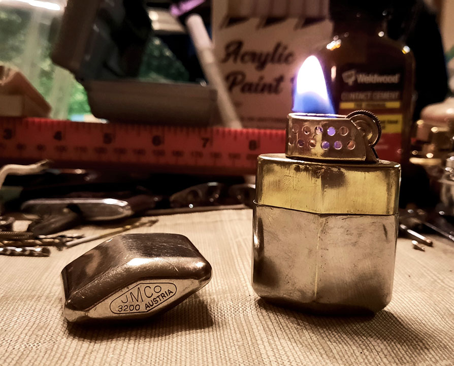

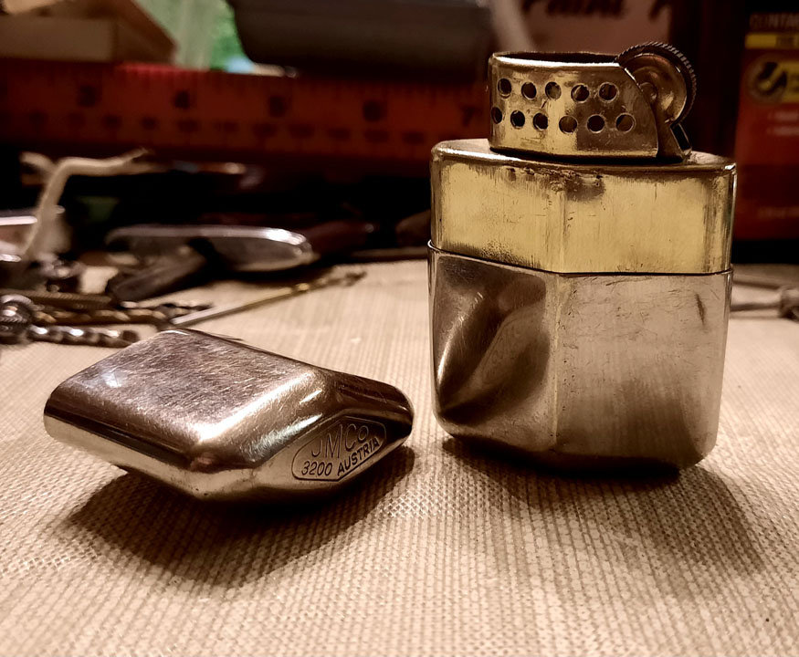

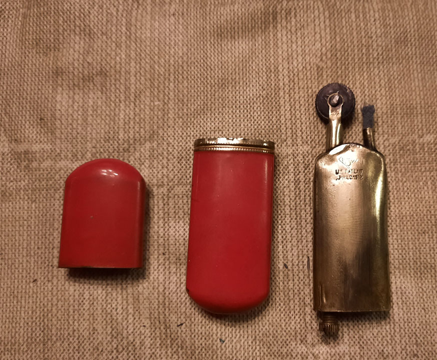

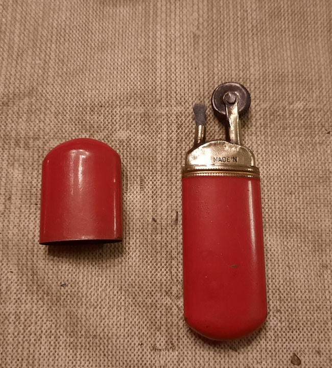

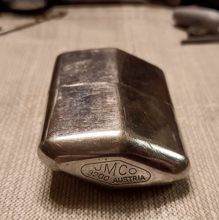

JMCO (i.e. IMCO) 3200 (1934)
A more "normal" looking pocket lighter compared to their more common "tube" style designs, this one is much harder to find. I'm not certain why only some early IMCO lighters are labeled JMCO. I'm guessing the "i" in IMCO stands for international while "J" is Julius in JMCO (Julius Meister & Company) as it does seem as though the models that were exported around the world were marked IMCO while early and more rare models meant only for Austria seem to be JMCO, but that is only a guess/observation. It seems surprisingly difficult to find out why they switched from JMCO to IMCO. This one is from 1934 (16 years after the company was founded in 1918) and many were already labeled IMCO long before that.
A very tight fit in the sleeve, this lighter pulls out similar to a Zippo and has a little drain screen on the bottom so you can just fill the outer cap half up with lighter fluid and insert the lighter into it to fill up (no velcro to pull aside like on a Zippo). Otherwise, besides the lack of a hinge to hold the top on (friction fit), it operates very similar to a Zippo style lighter with a little windscreen and a slightly different body shape.

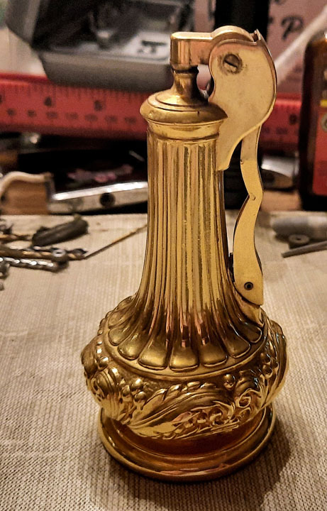

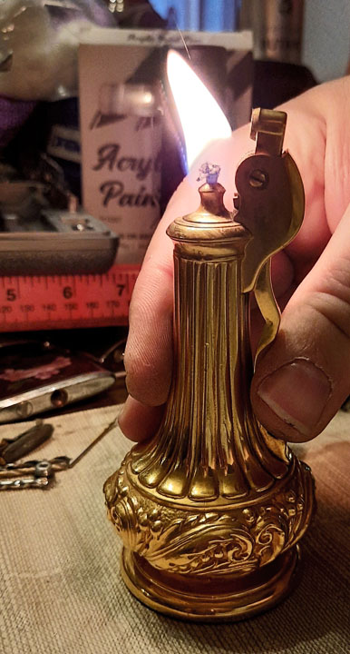

Ronson Savoy #2 (1954)
This took about an hour to fix. It had a stuck flint and needed a new wick and packing. But I only paid $100 for it. It's supposed to be worth $400-600. I don't know if the photos will work beyond the thumbnails right now.

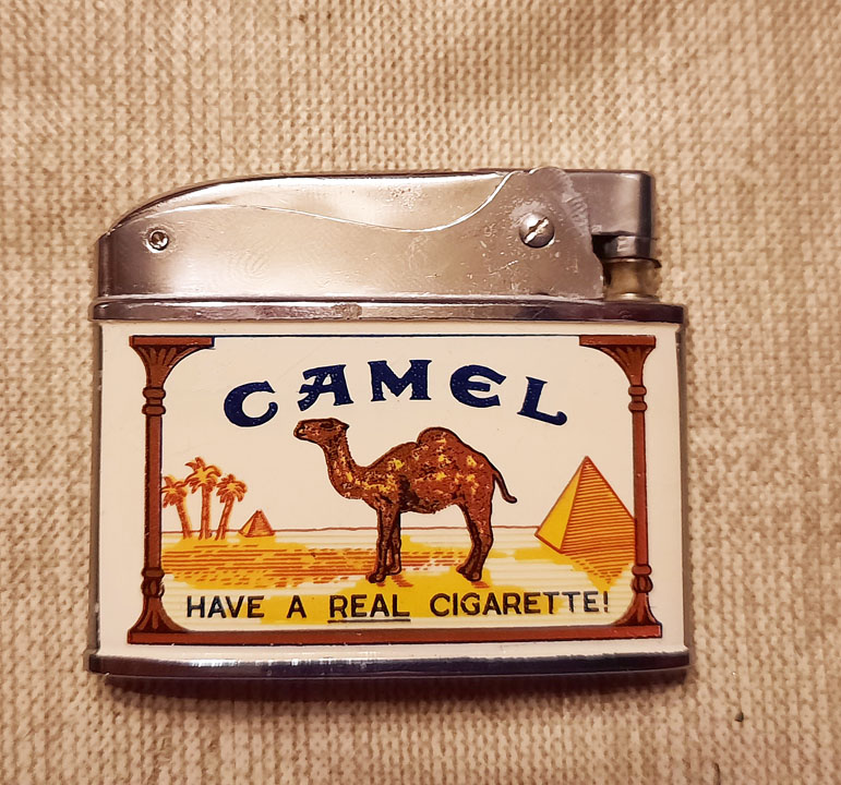

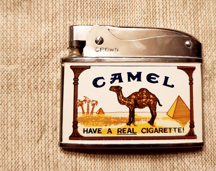

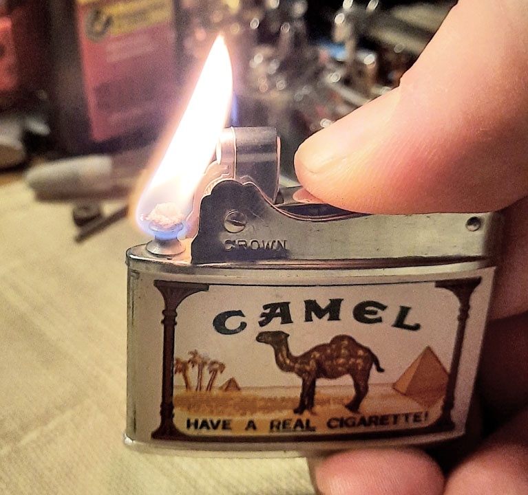

Crown Camel Advertisement Lighter (Japan 1950s)
I picked this up at a nearby antique store for $10. They didn't have a good selection, but I figured what the heck. It had a stuck flint. After clearing that, it works fine.

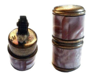

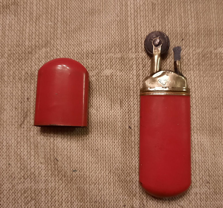

I found and ordered another incredibly rare IMCO lighter from Poland. The sad thing is I cannot find out its name/model. No one seems to know this information, not even collectors that have it (it only says "IMCO" on the lighter and "Austria" on the bottom cap).
It's similar to this one with a different almost "carpet" like wrap (missing from the bottom half so I might replace both with something else):
There's a few other "tube" lighters like that as well.
Check Al Kranebitter's IMCO collection out (yowza). I guess it helps to live in the country of origin for most IMCO lighters. ;)
Specifically, this one shows several of the ??? models from the image below:
Note that he has the lighter in question above in there with the "carpet" wrap on both pieces (bottom row in link above next to the tassel one).

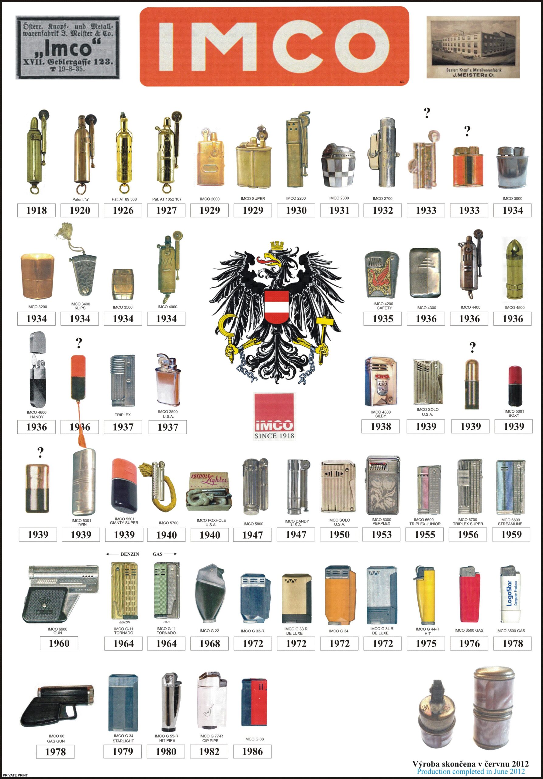

Below are most of the IMCO models and names, but some are still "?" unknown names/models. I've marked a RED DOT by the ones I own a version of or have it on the way. As you can see, I'm not even close.

I did a little polishing of the JMCO/IMCO 3200 (1934) lighter with Flitz™ metal polish....
Click for larger view & slideshow:
Lighter In Case
Before + 2 After (Facing Right/Left)
JMCO 3200 02.jpg IMCO 3200 Polished 02 Face Right.jpg IMCO 3200 Polished 03 Face Left.jpg
Before/After Lit

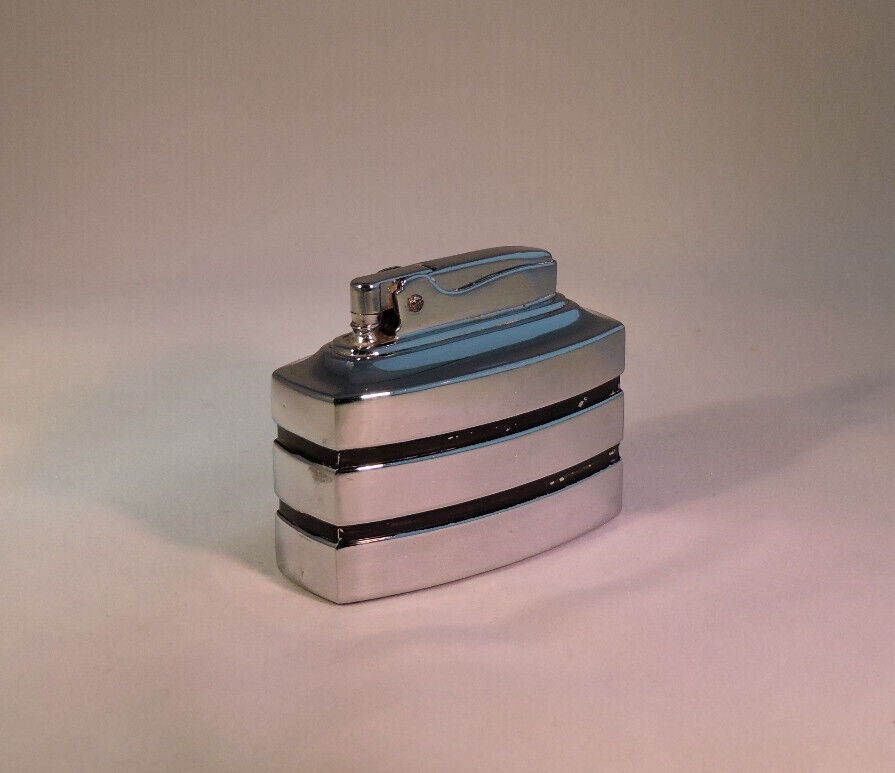

I finally found a good closeup of the lighter on Klink's desk in Hogans Heroes from s01e14 (Oil For The Lamps Of Hogan). There's no doubt in this snapshot. It's clearly a Ronson Spartan lighter from the 1950s, not German and not period accurate.
Click for larger view:

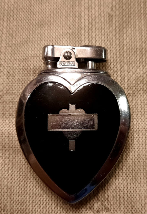

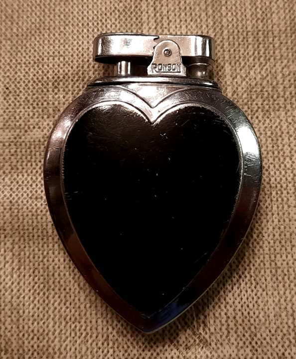

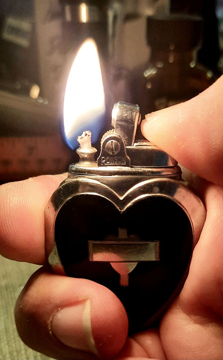

Ronson Heart Shaped Lighter (1937)
These are supposedly favored by collectors and thus are hard to find. I'm lucky to have gotten one for not too ridiculous price without any monogram and in reasonably good condition. First, the flint was stuck so I disassembled the lighter (it's an insert in the top) and cleared it. The lighter worked, but didn't have a very large flame. I had to replace the wick/packing to get the wick to a decent height and trim as the old wick was packed in so tight, it couldn't be lifted upward. It's a very small lighter, so that normally wouldn't take very long except the wire wick kept getting stuck around the flint tube (lack of space). I ended up using a non-wire wick (the smallest I have) to get around it. It works well now.

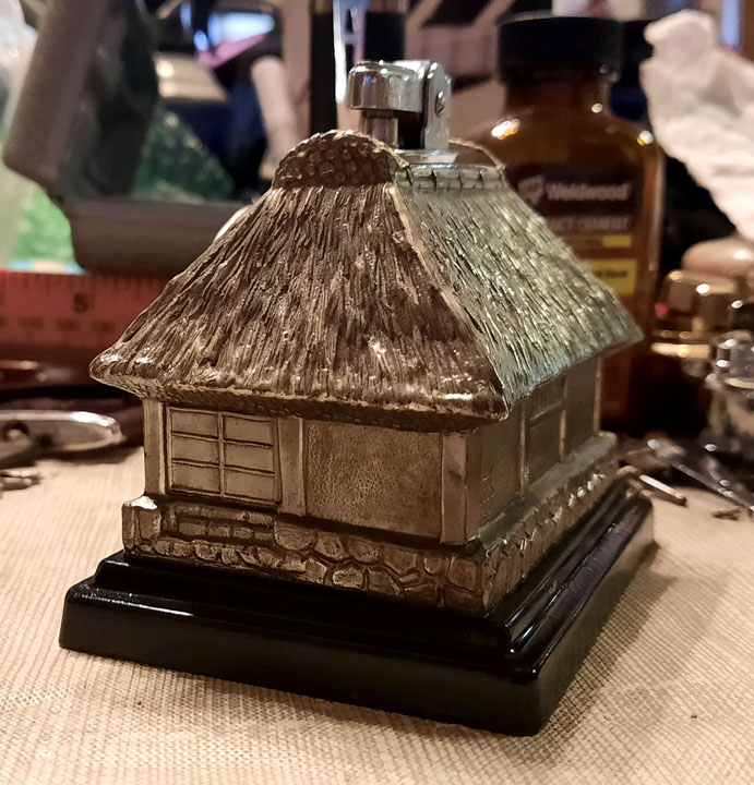

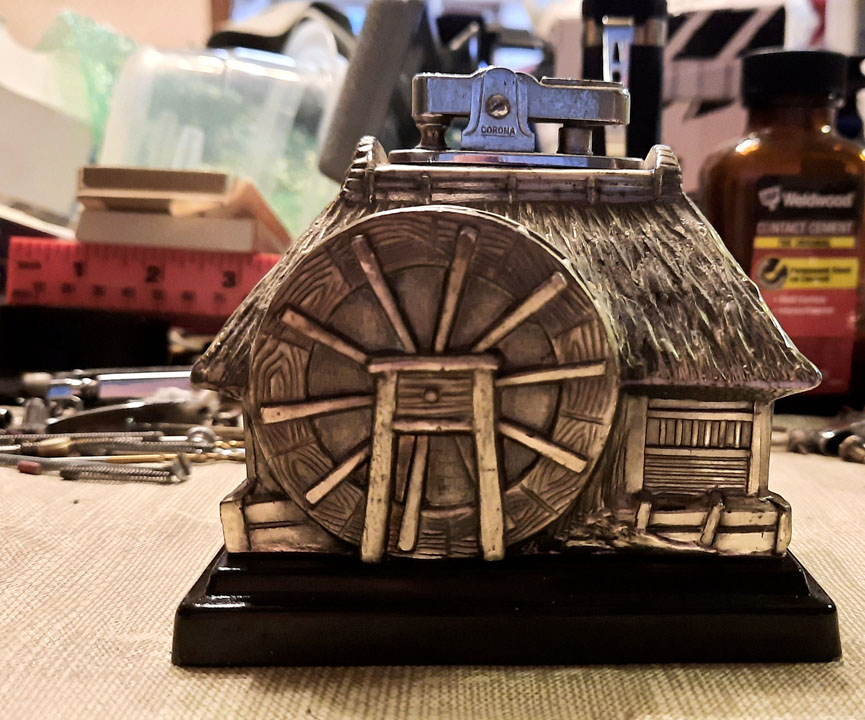

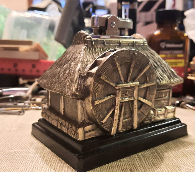

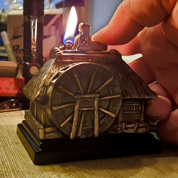

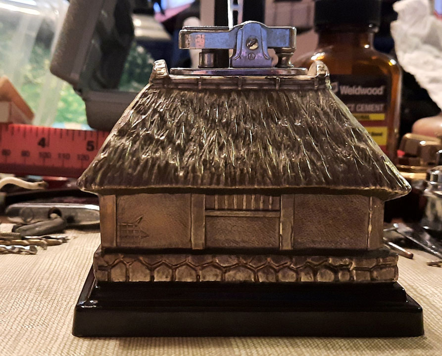

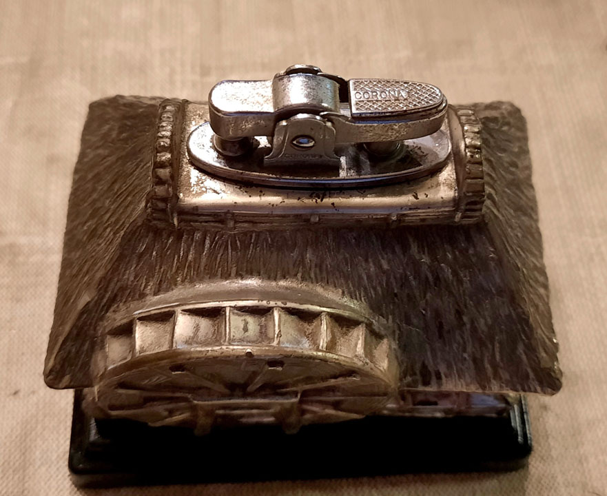

Corona Cottage Music Box Lighter (Year Unknown, probably 1950s or 1960s)
I have seen another one of these lighters for sale with a different lighter insert that wasn't a Corona so it's hard to tell if it's a replacement insert or they simply sourced the lighters from different suppliers. Corona is well known in Japan and around the world for their pipe lighters so better to have a Corona brand insert than a more generic one, I suppose.
The lighter insert works like any other and once cleared of a stuck flint, it started working great. The music box, which plays Für Elise by Beethoven was playing too slow so I oiled all the gears and it now plays at the correct pace (the winder is on the bottom and you can access the gears to lube with the lighter insert removed from the top without disassembling the house (screws on the bottom to do so, however). Overall, it's a pretty neat looking display quality table lighter.

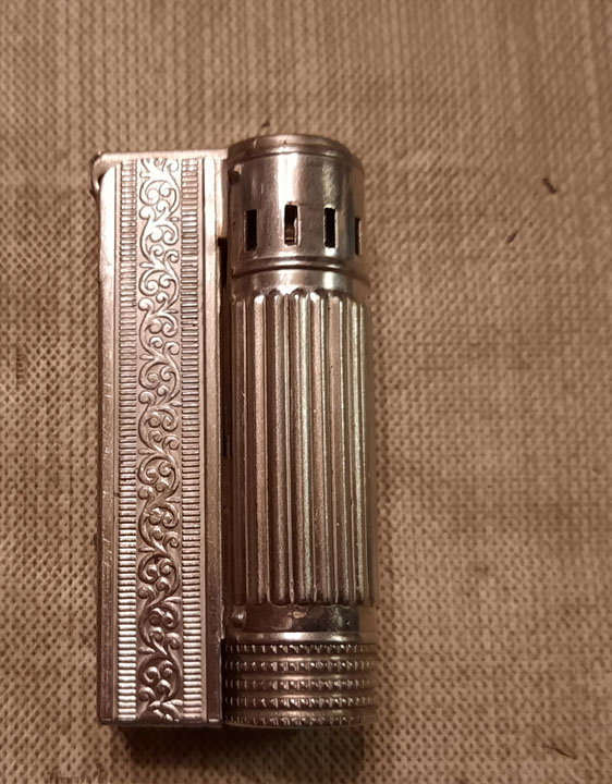

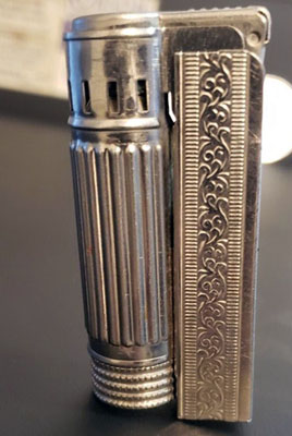

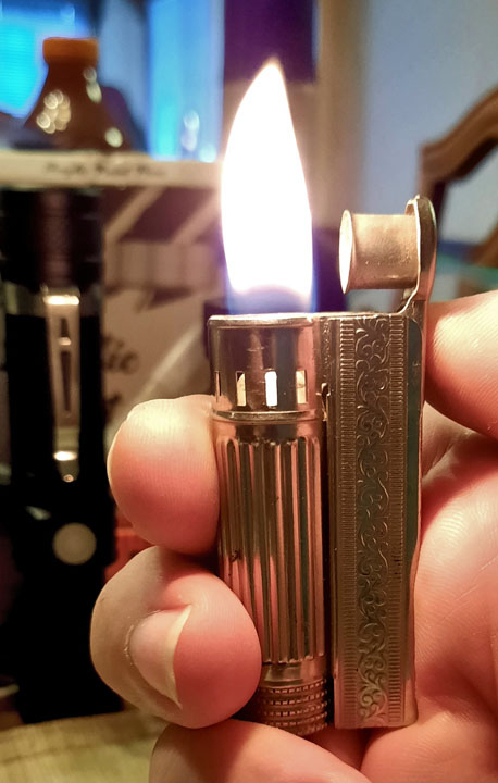

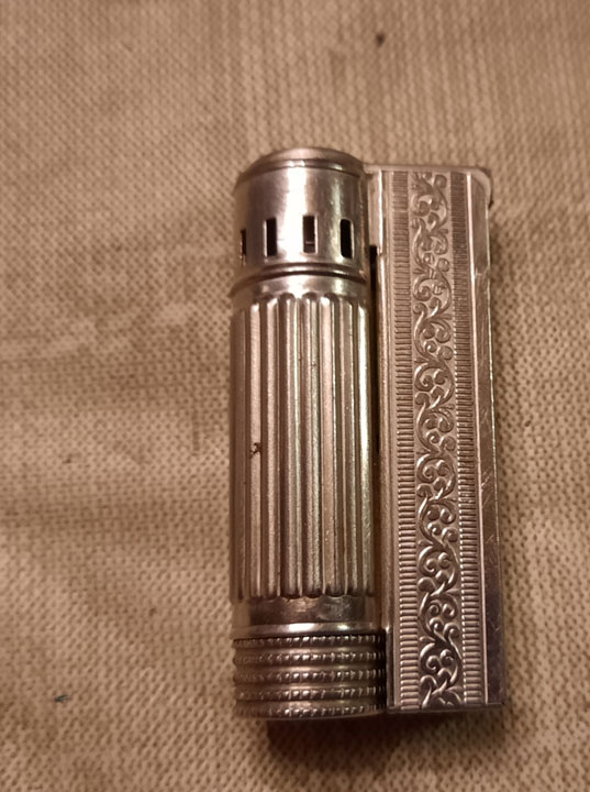

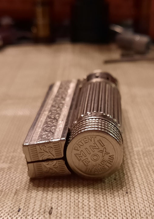

Mini Fox Lighter (1950s)
I'm not exactly sure who makes this lighter. It says Made In Austria and closely resembles an IMCO 6600 Junior, but with a fancier body.

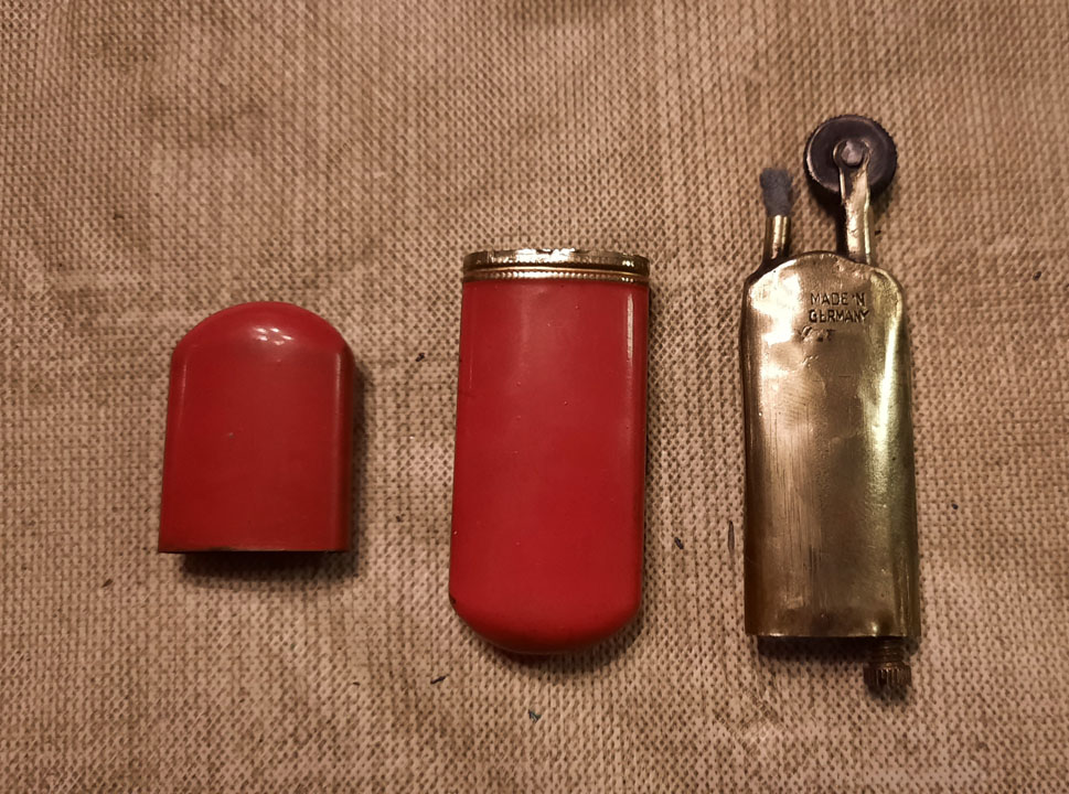

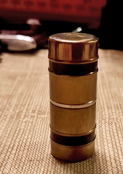

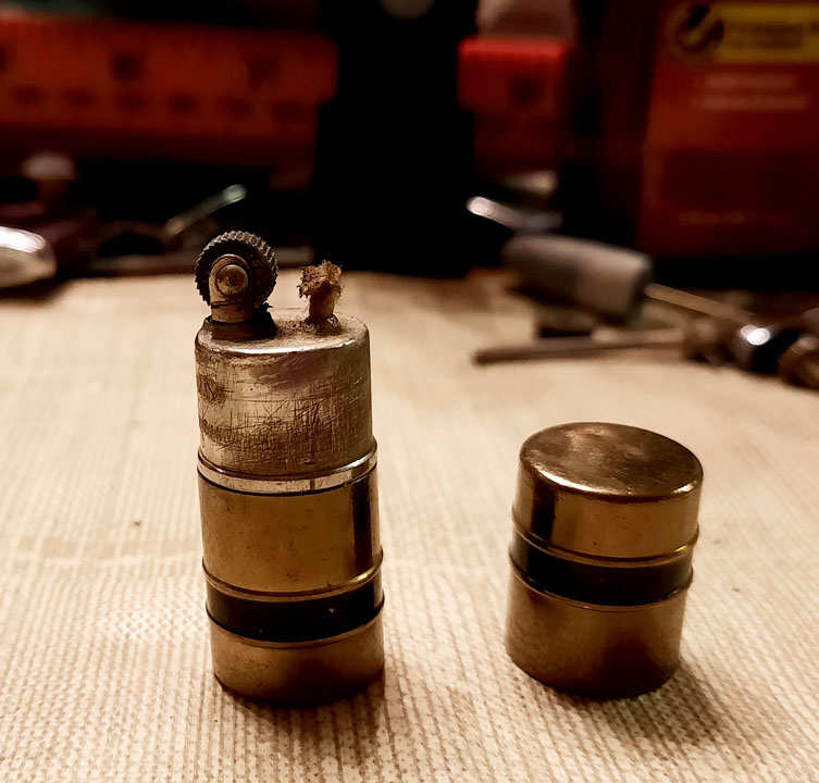

Germany Made Lighter imported by and branded "MEB" (Max E Bernhardt) (Presumably for US Sale) "Tube" or "Wheel" lighter (1912)
This one is pretty old. I just looked it up after polishing the brass and I could see the MEB logo on one side and Made In Germany on the other. According to the VCL site, it was imported in 1912 by MEB. I cleaned it up, installed a new wick and packing and it works great.

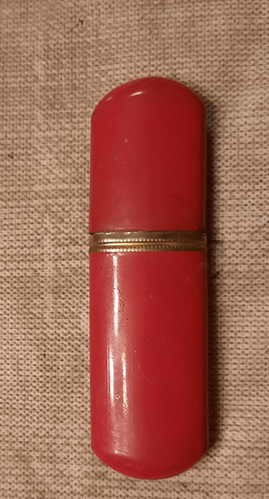

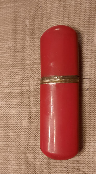

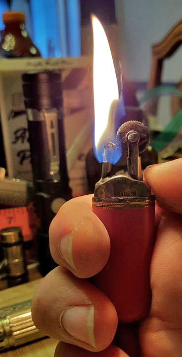

Neldun "Lipstick" or "tube" lighter (1940s).
This appears to Neldun's only lighter. Made in the USA. I thought the tube was kind of cool looking. It's tiny, but it works great.
