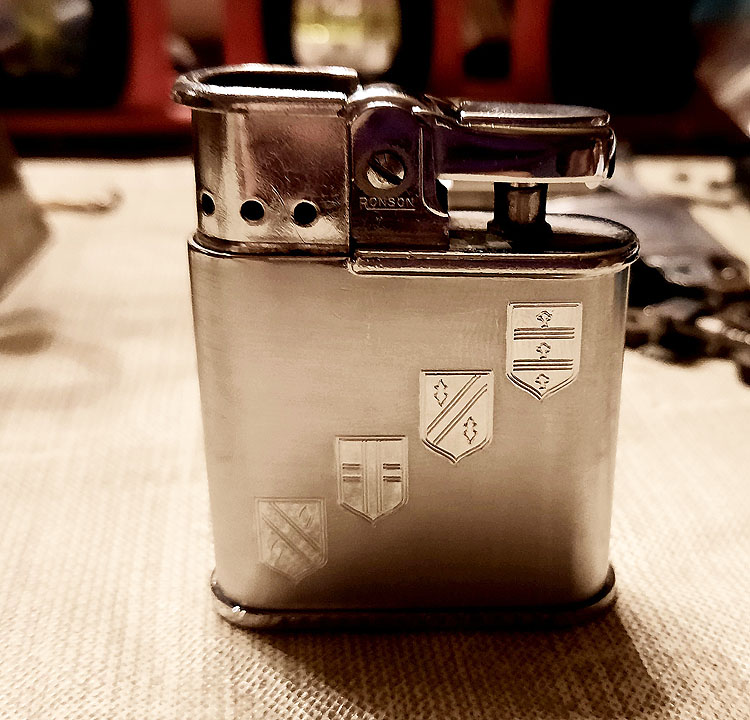

Three more lighters on the way.... (Banjo #3 I plan to add metallic blue leather to, a never used Spartan and a mint Whirlwind with coats of arms on it).

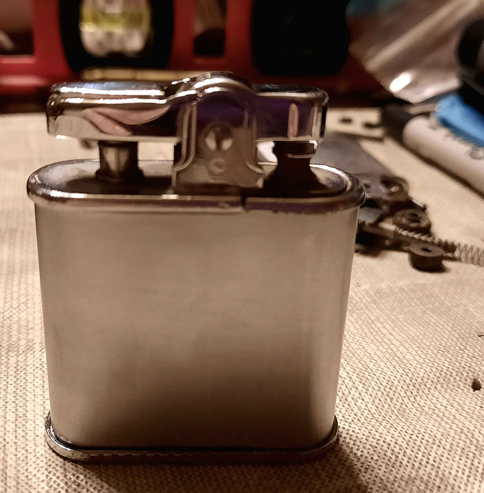

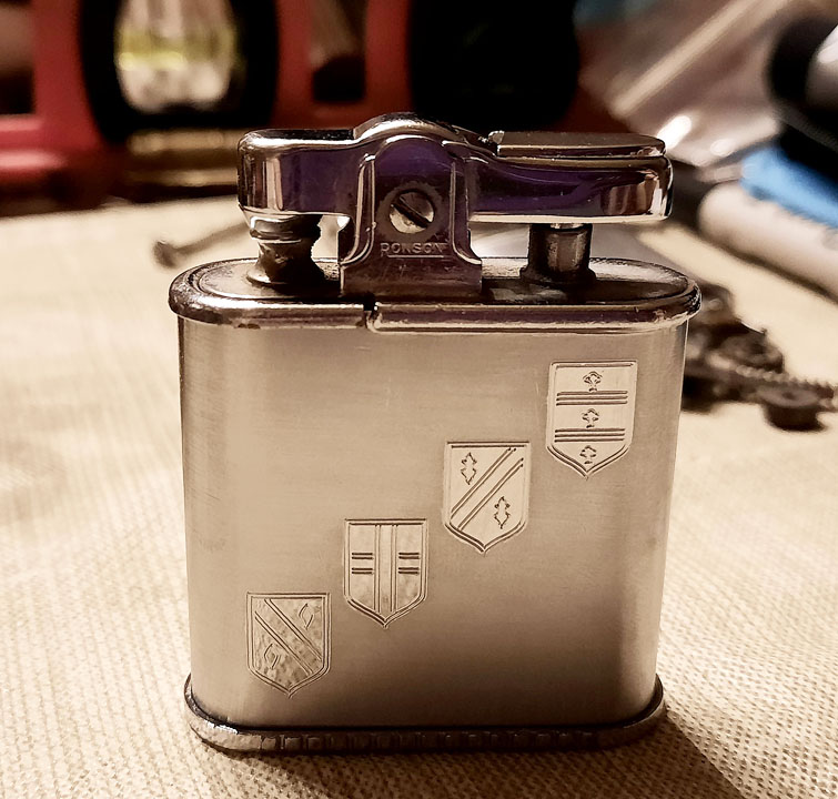

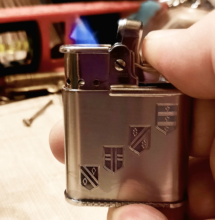

Ronson Whirlwind (late '40s or early '50s). The pocket lighter with a pull-up shield for the wind outside. This one is a newer one in that it has the pull/twist mechanism on the bottom of the lighter to fill the lighter (which then fills like a Zippo from below) rather than a fill screw. It's simpler, yes, but I think it evaporates faster than a fill screw. This particular one has a coat of arms design with brushed metal I thought was cool looking so I bid on it an won.
Click for slideshow.
Ronson Whirlwind Coat 01.jpg Ronson Whirlwind Coat 02 Front.jpg Ronson Whirlwind Coat 03 Front Shield.jpg Ronson Whirlwind Coat 04 Front Lit.jpg Ronson Whirlwind Coat 05 Front Shield Lit.jpg

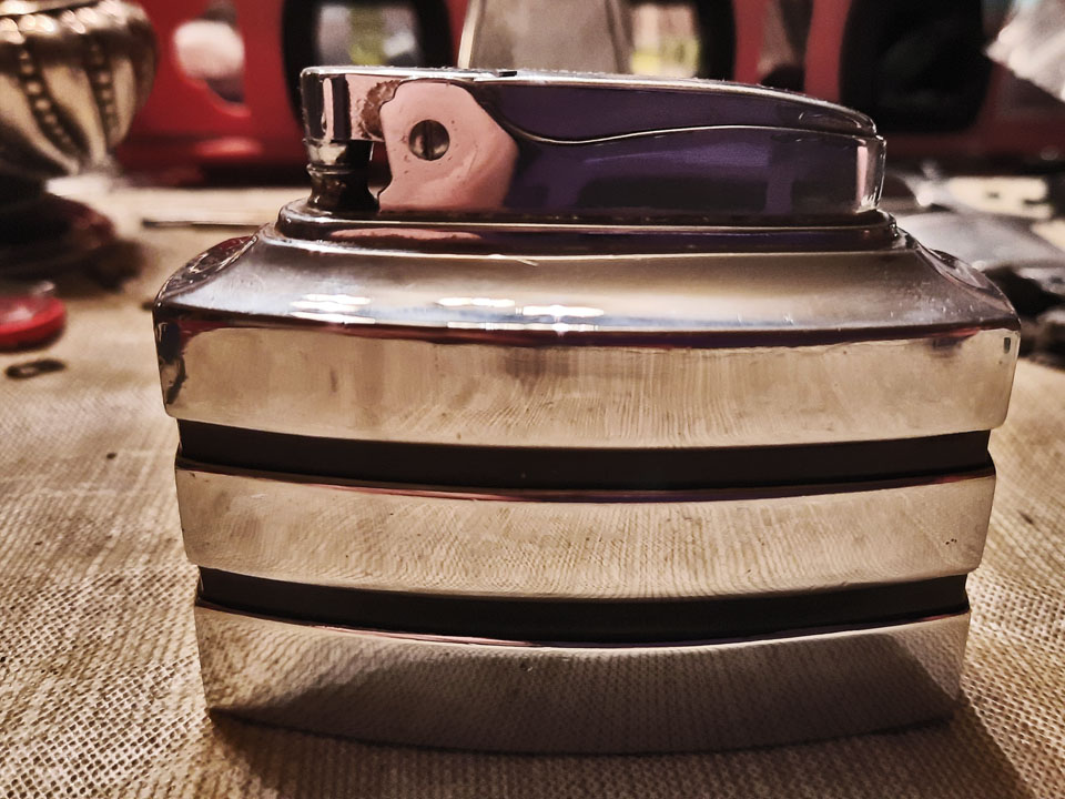

Ronson Spartan Table Lighter (1950). To me, it looks like a 3 story chromed building with blacked out windows. This one is in pretty good shape on the outside, with no major scratches, just a bit around the screws on the lighter mechanism. Unfortunately, the internals weren't as great. It had no spark. It wasn't blocked. No amount of fiddling would get it to move the spark wheel. So I changed the spark wheel and clutch/pawl with a set from another lighter and presto, instant sparks. I changed the flint spring (loose screw from spring that are a royal PITA to re-attach) and stretched it to get a lot more pressure (the key to getting it to light "every" time). It works like a champ now.

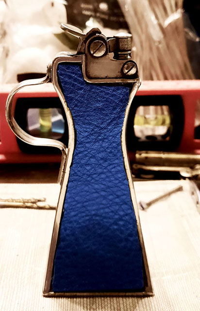

I bought another Ronson Banjo Table lighter in working condition (1927) and already mostly cleaned up, but this one has no leather on it unlike my other two (one of those is Ostrich Leather and the other Moroccan (cow) leather, both in black leather. This one may have had it, but came off and they cleaned it up at some point, although the book I have suggests some may have been sold without it, but the metal on the sides hints otherwise to me.
In any case, I thought it might be a fun project to attach some new leather to it and instead of trying for an imitation of one of the original leather styles (It supposedly came in Red, Green and Black leather in Moroccan leather, Alligator leather, Ostrich leather and Rattlesnake leather), maybe I'd try something a bit different, more modern and in a color it never came in. I had a hard time deciding between blue and purple (red looked great too). It's a metallic leather finish, but real leather. I decided on metallic blue. I've made my pattern cut and now I just need to cut the two leather pieces and glue it....(no pressure)

RONSON BANJO BLUES
This is my first attempt to add new leather to a Ronson Banjo Table lighter (from 1927) that probably once had it, but was lost, cleaned and sold without it. I decided to go with a modern leather that wasn't available in 1927 on this lighter to make it unique and frankly, metallic blue leather is just awesome looking....
I made a paper cut out and then a leather cut-out and refined it and used it backwards to create the other side. It still took a lot of fine trimming. It's not perfect, but I still think it came out pretty cool looking. I used Contact Cement to apply the leather to the metal surface as I've had good luck with it before touching up loose leather.
Getting started
