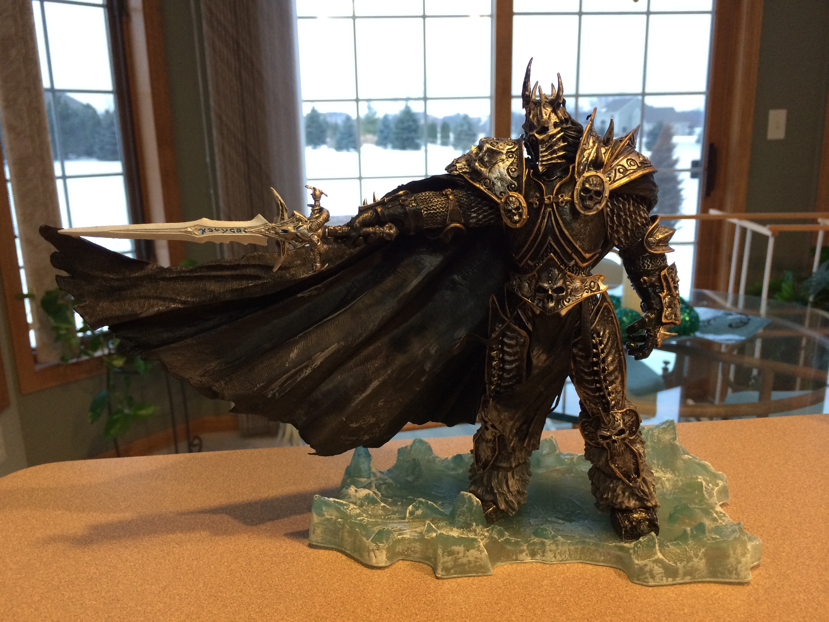

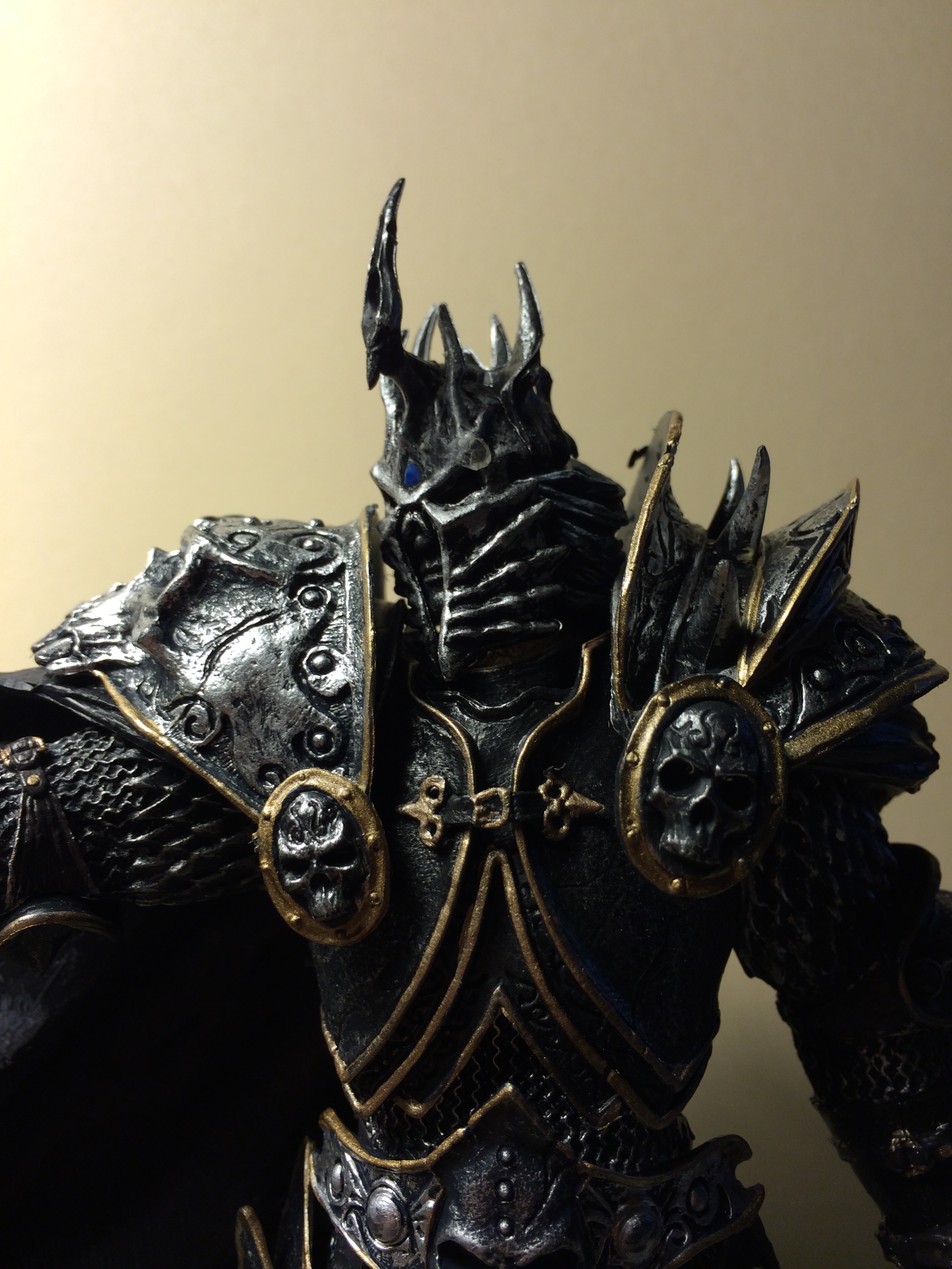

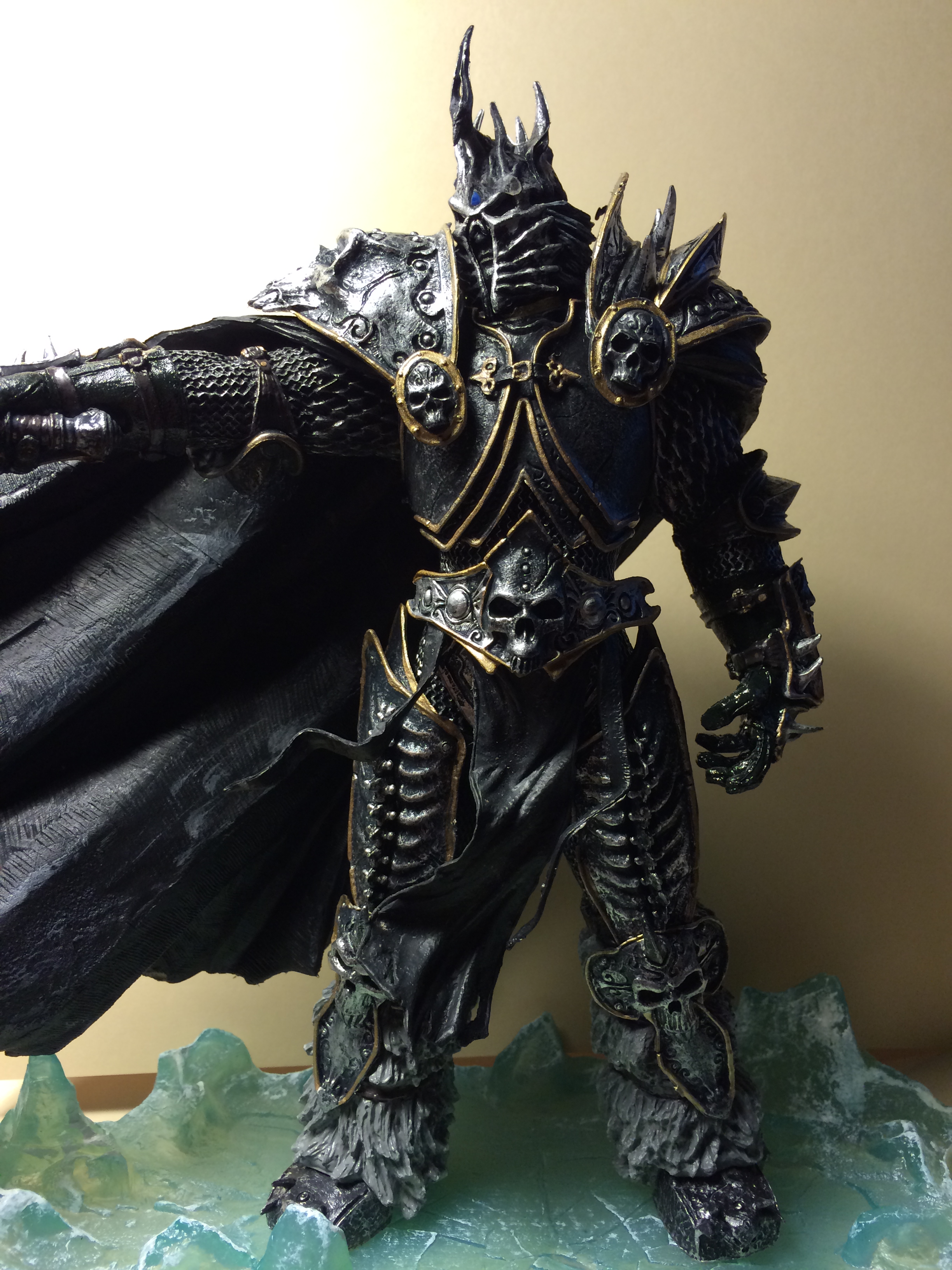

Here's some reference pictures of Arthas, the Lich King. He has very oversized armor, an intricate helm and a HUGE sword. The first is a computer render, the other pictures are of a model I have.

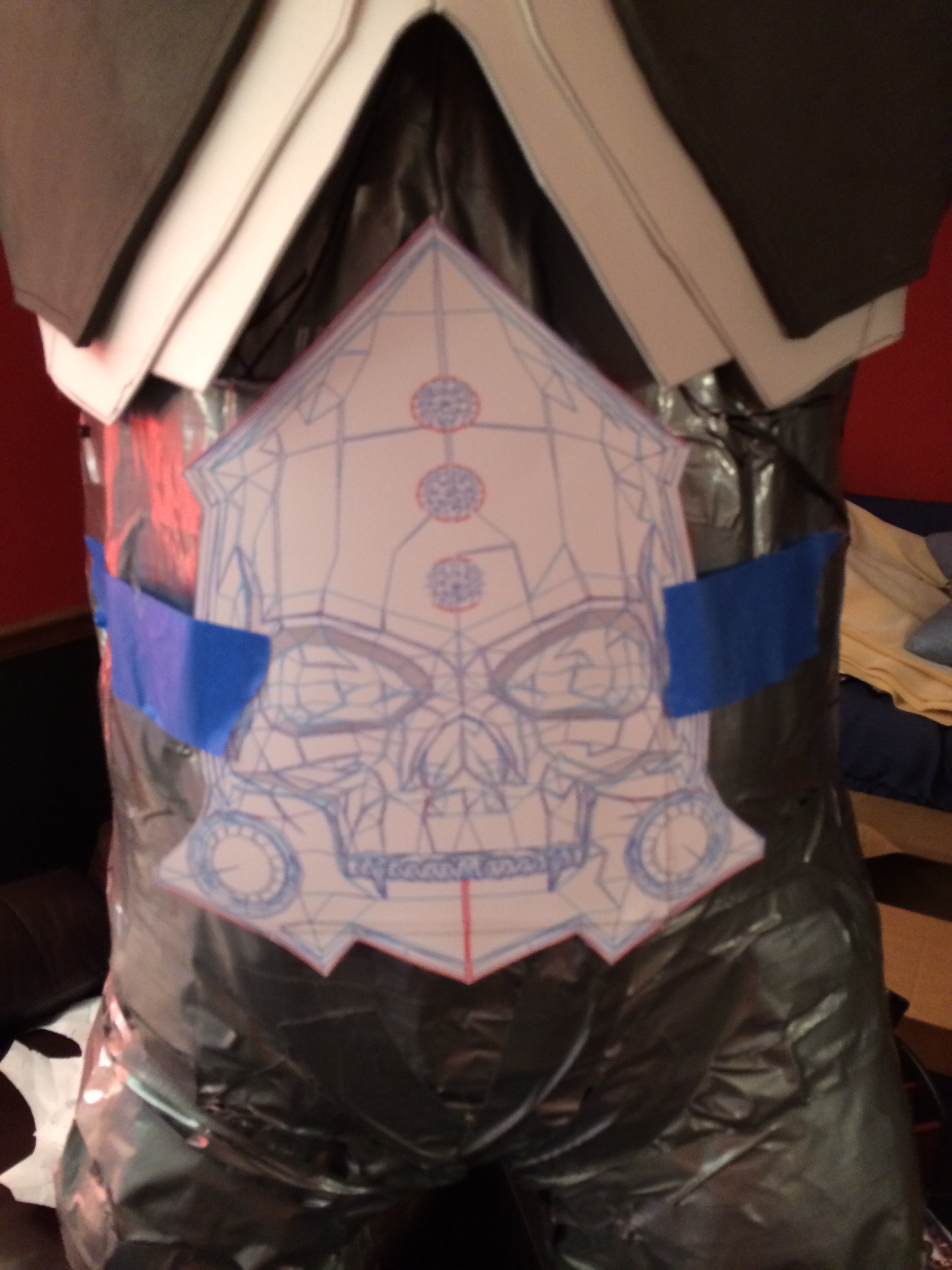

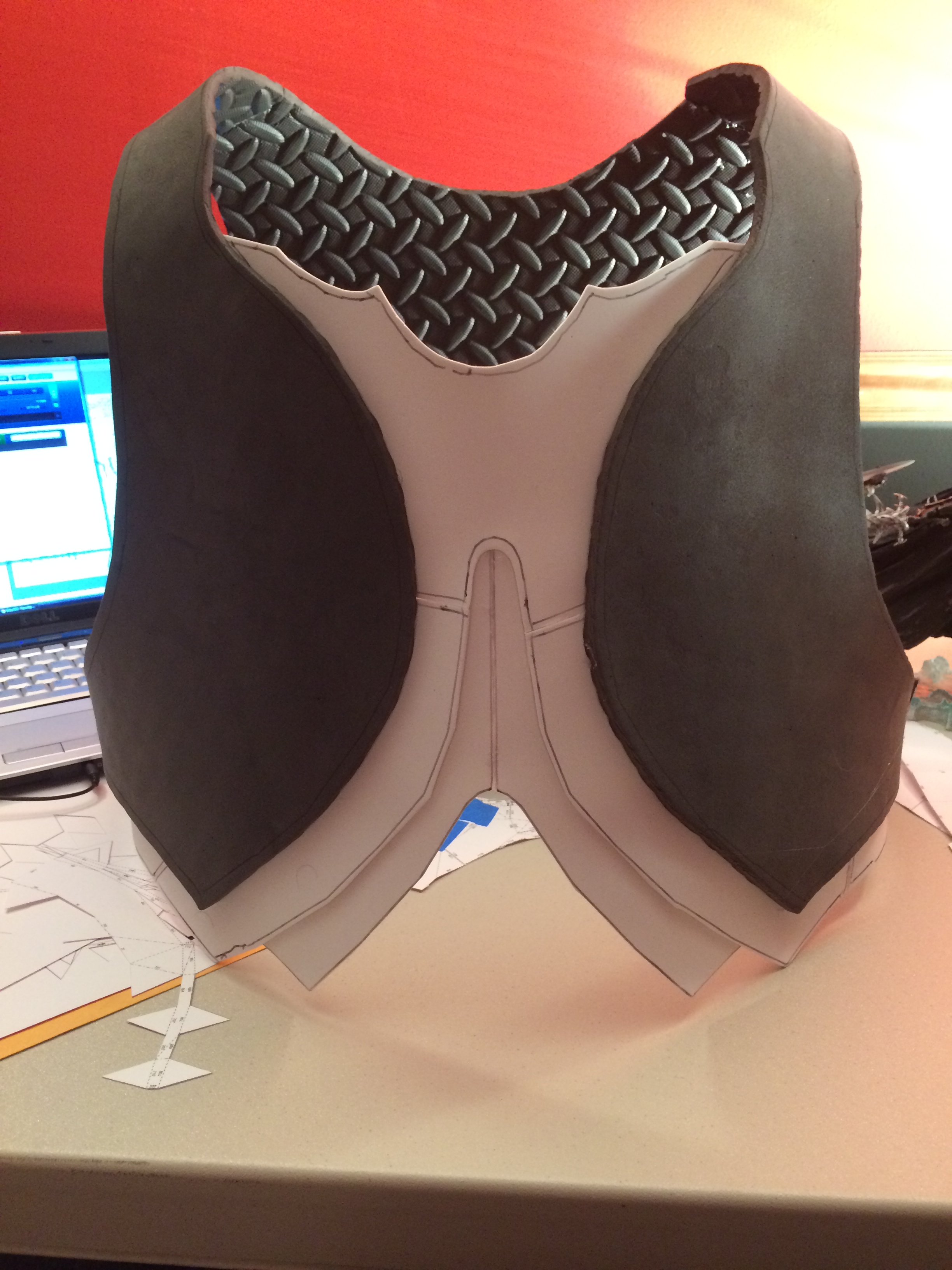

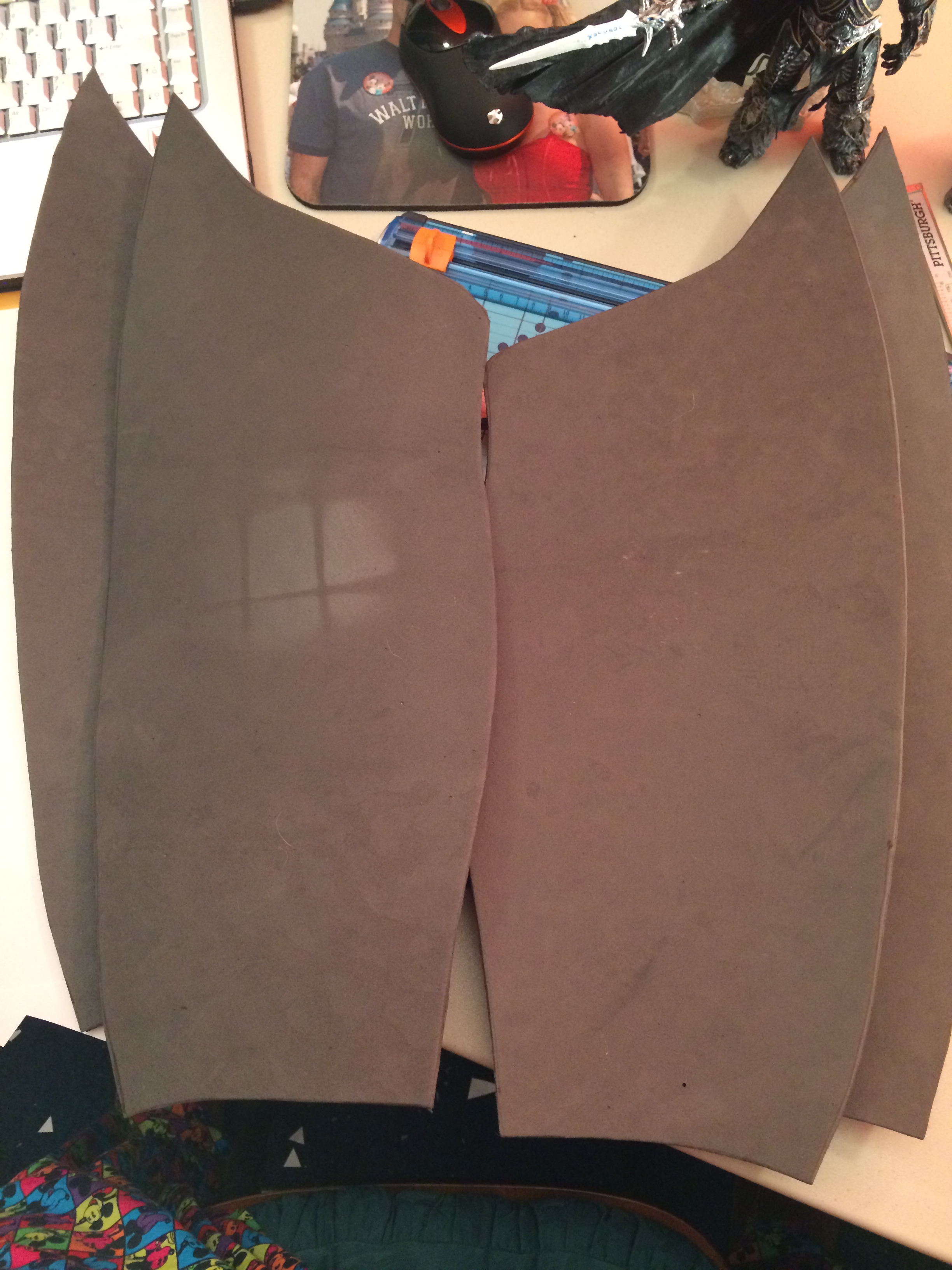

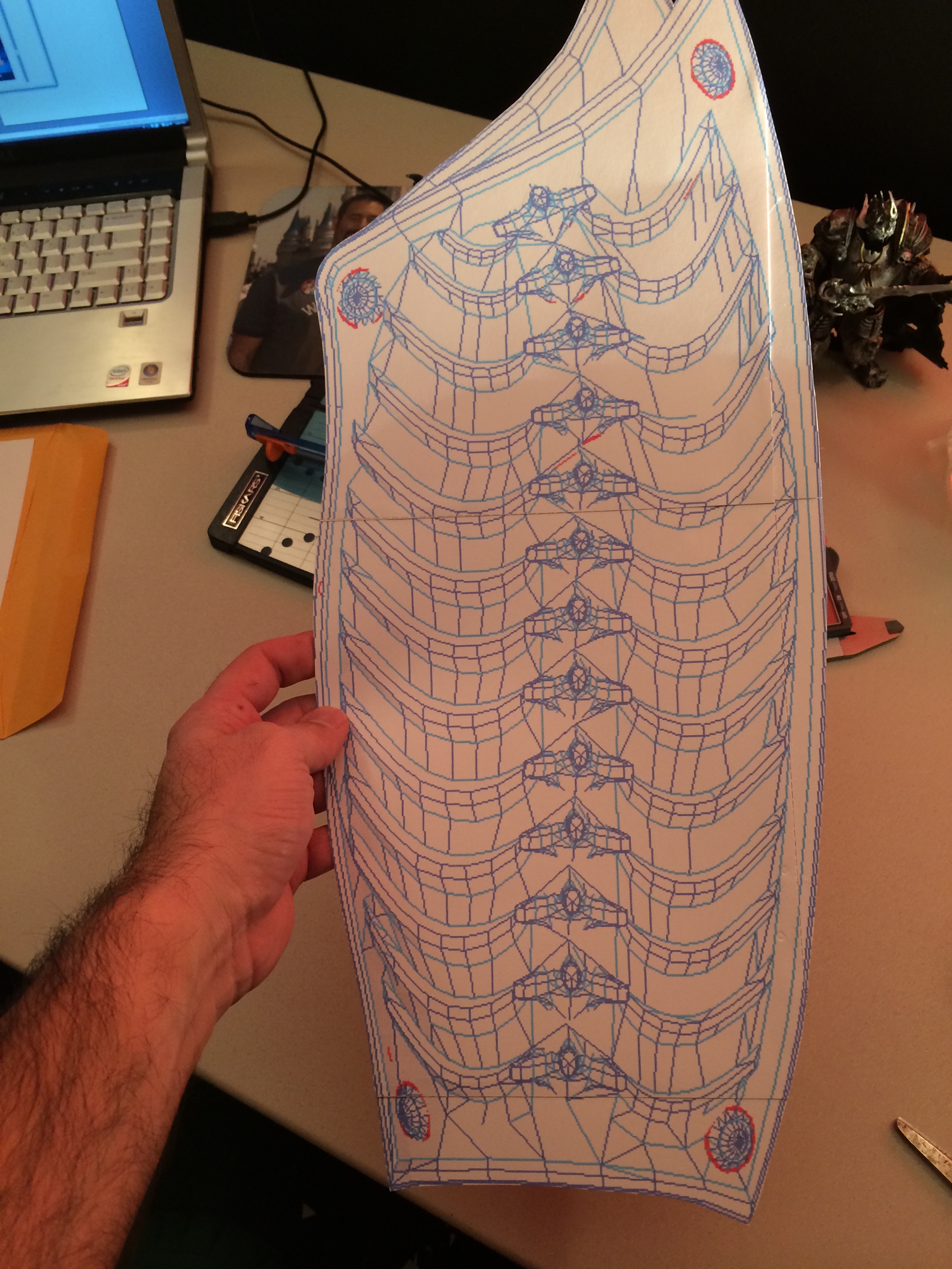

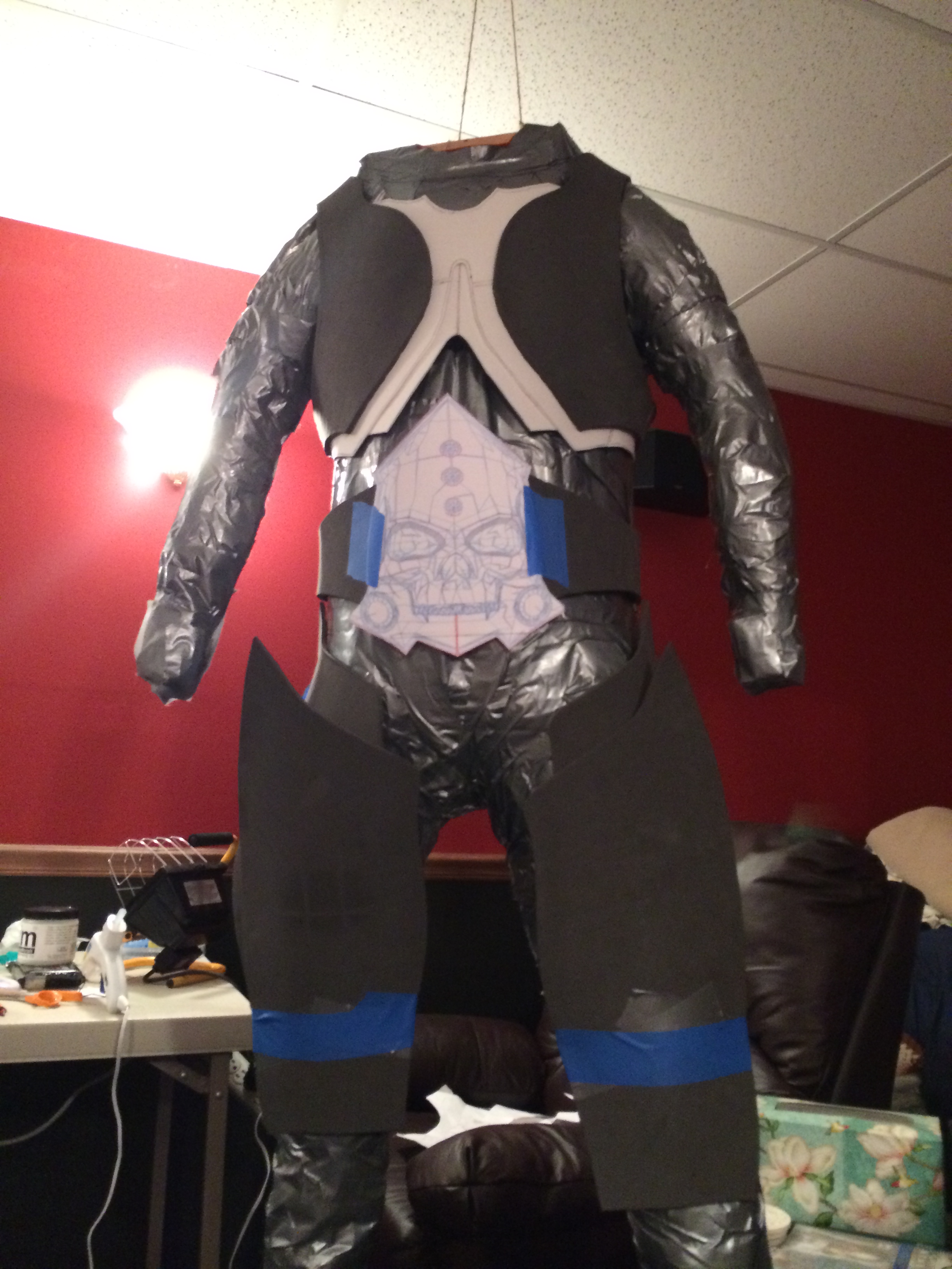

The build so far has been quite the challenge, and I haven't even started the hard parts! In the following pictures, you can see how I've done the parts so far. Mostly I have printed out the pep files and transferred them to foam. I have also printed the 3D pep images so that I can sculpt other pieces. I'm using foam mat for the pieces, which I'll be sealing after I add all the fine details.
My biggest issue is on making the shoulder pieces. They are just so big, and I'm not sure how I can shape my foam to make it say on my shoulders. Any suggestions?

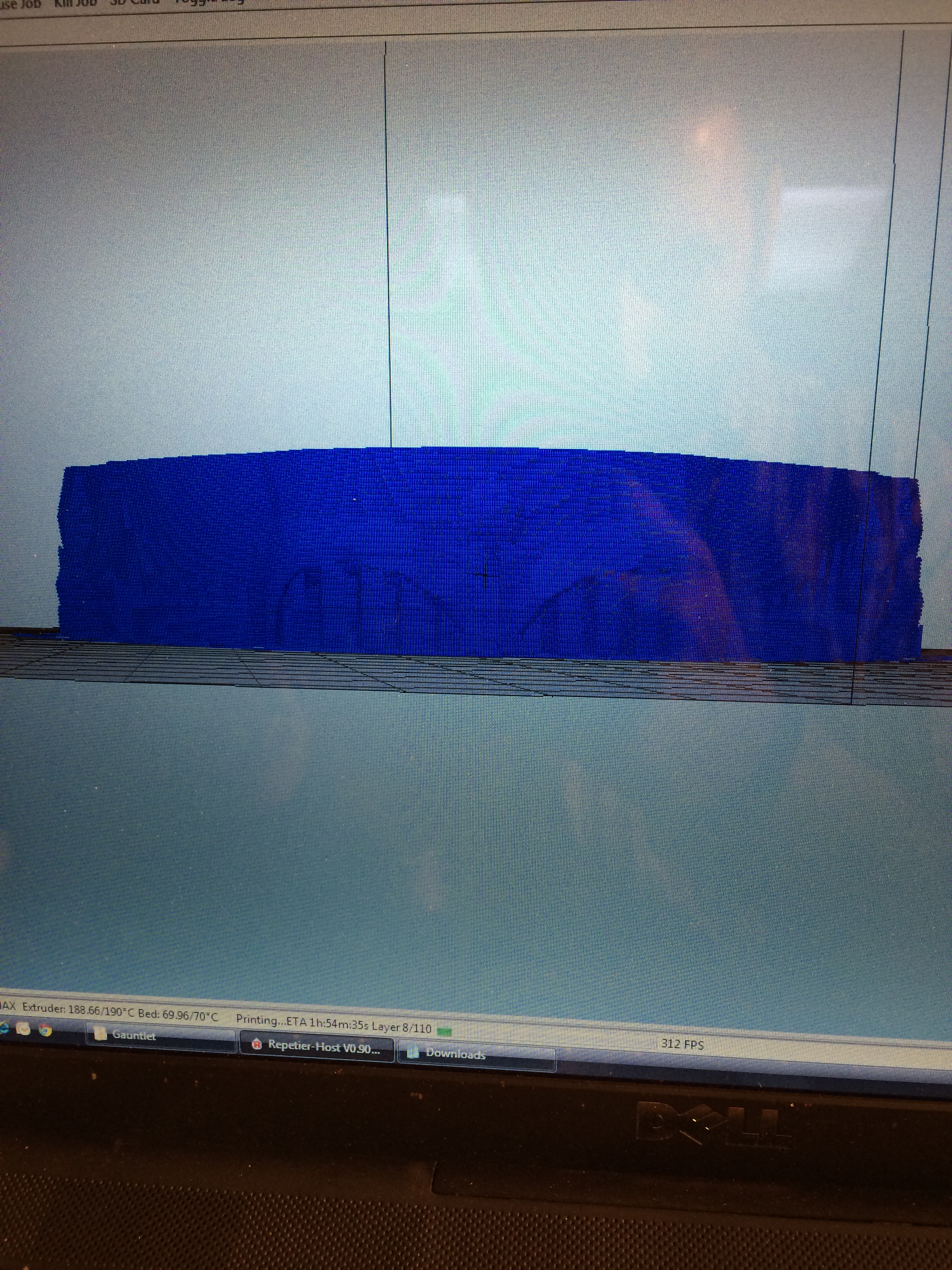

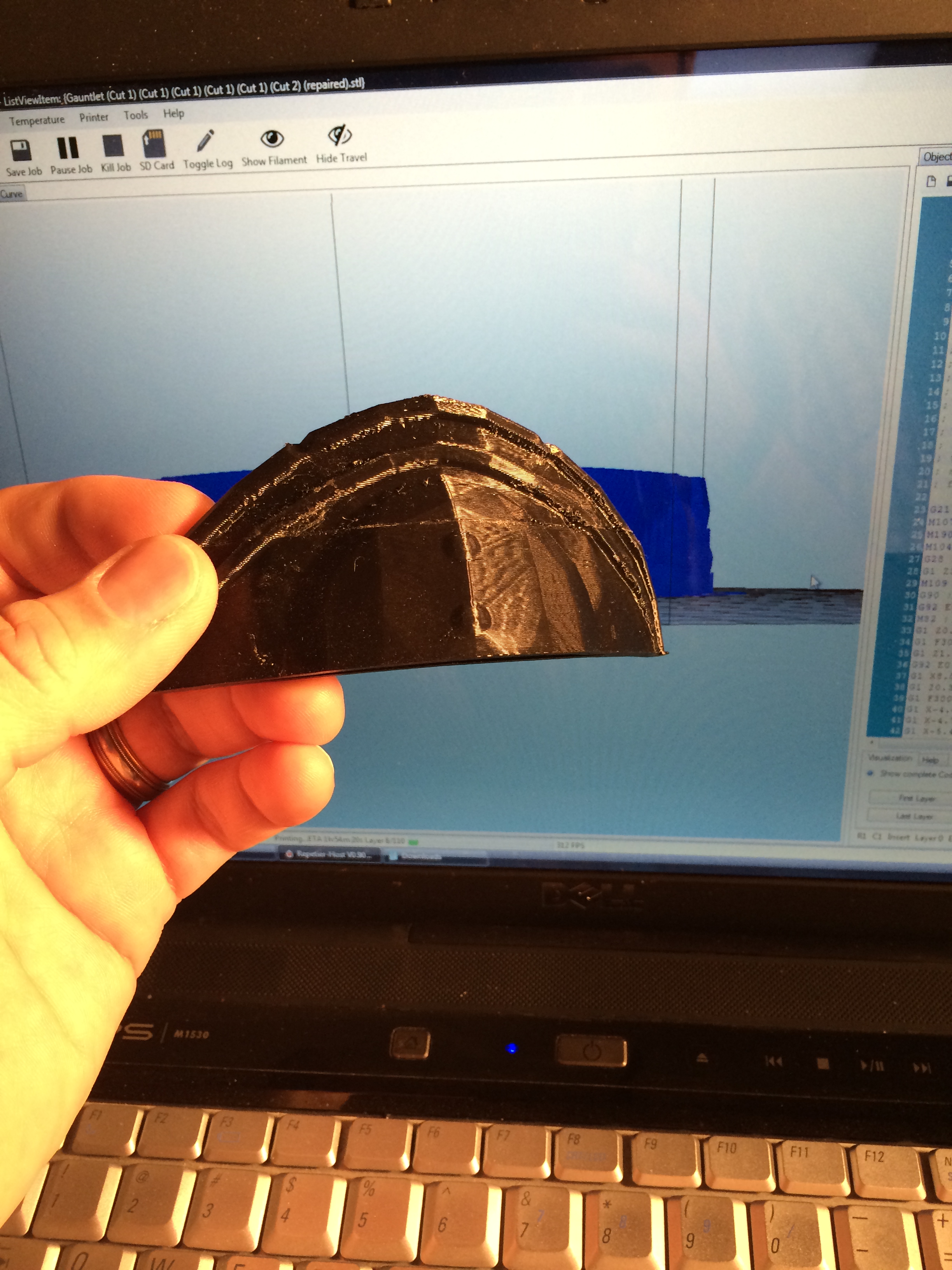

Right now I'm printing the forearm gauntlet. Here is what the "slice" I'm currently printing looks like:

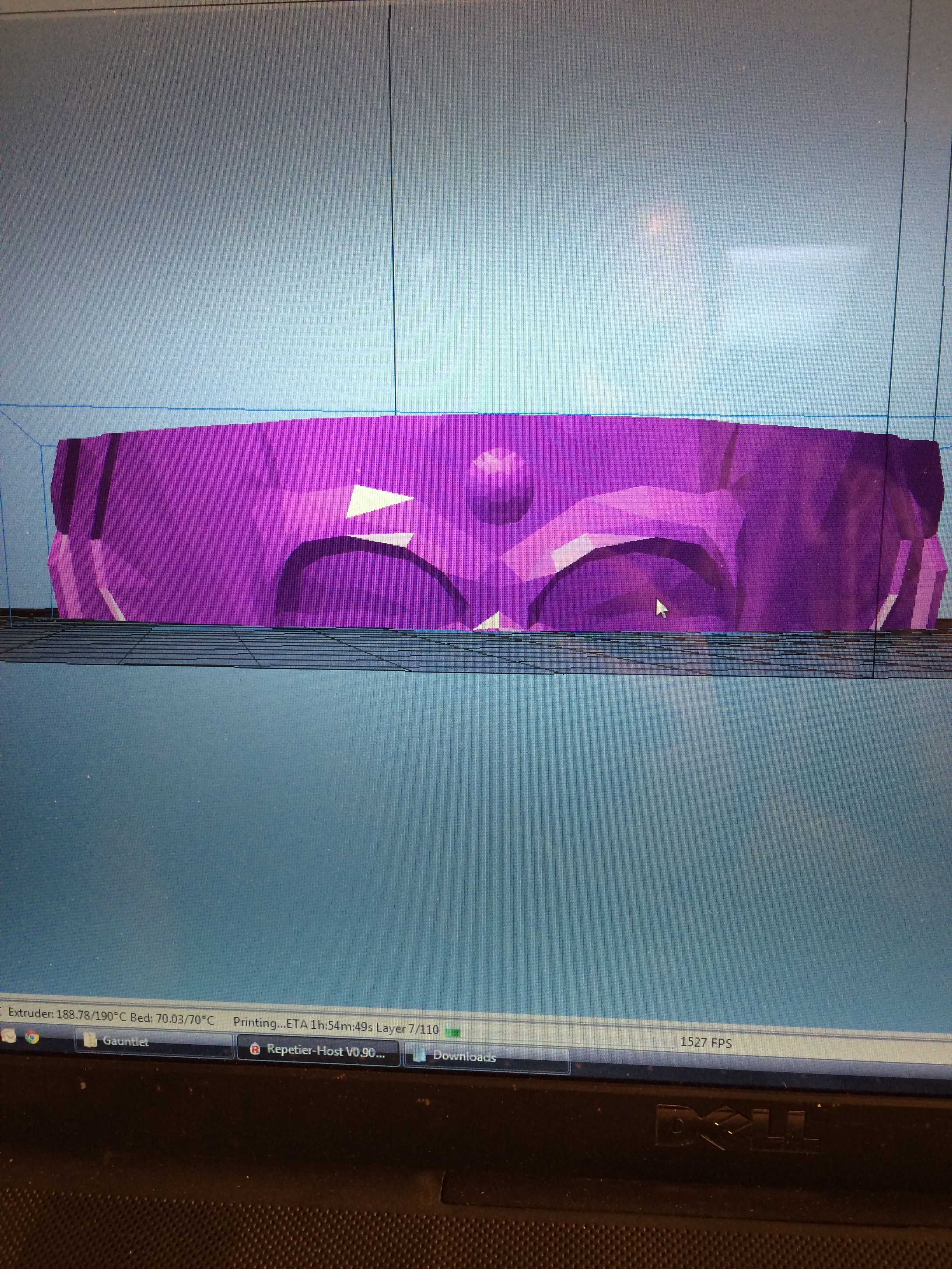

Next, the software slices the piece into .2mm layers for printing.

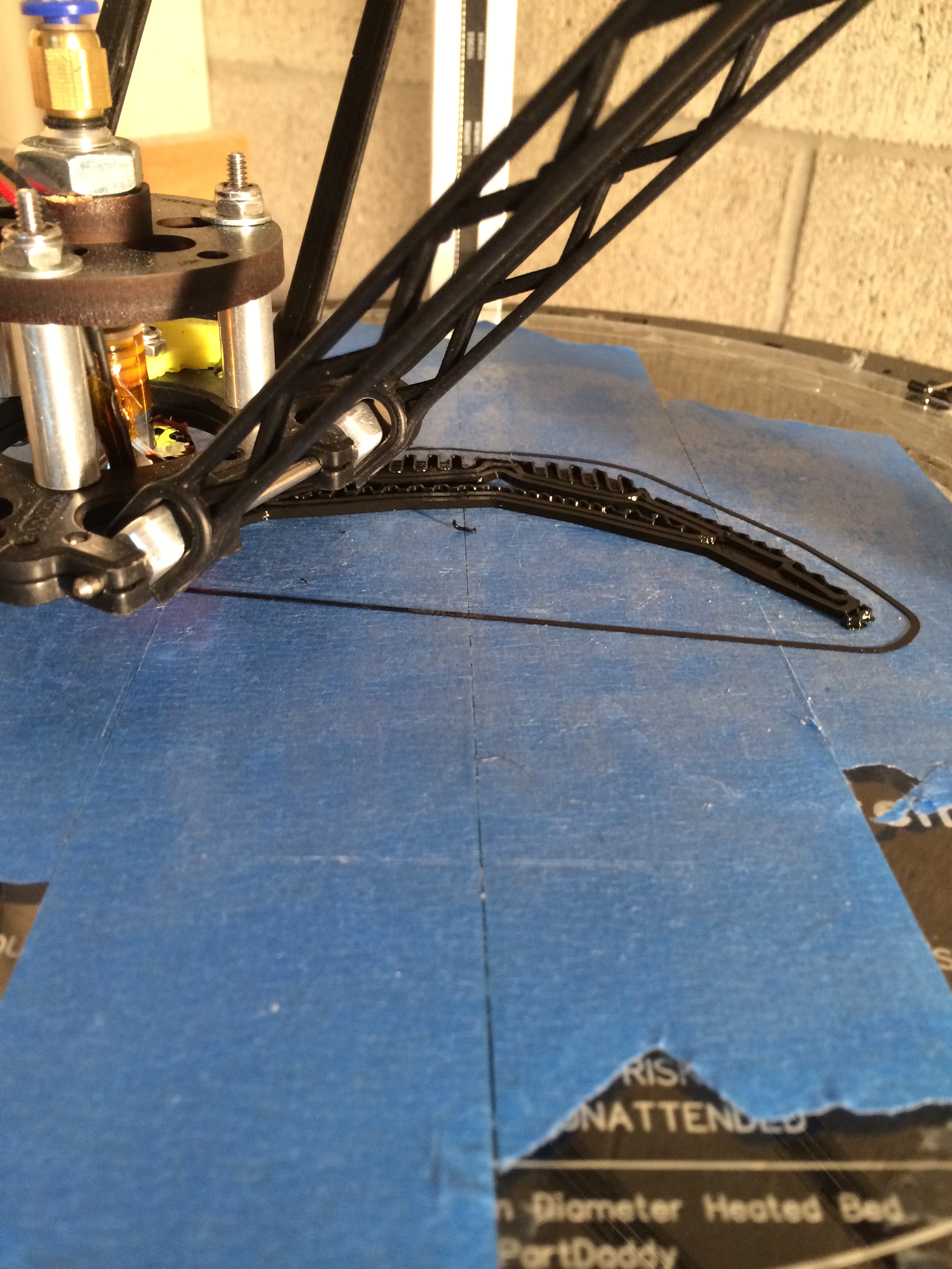

The printer doing its thing! I have a Rostock MAX delta printer. I'm using black PLA for this project, which is a bit cheaper than ABS. The prints are very hollow, since I'm not worried about the structure too much.

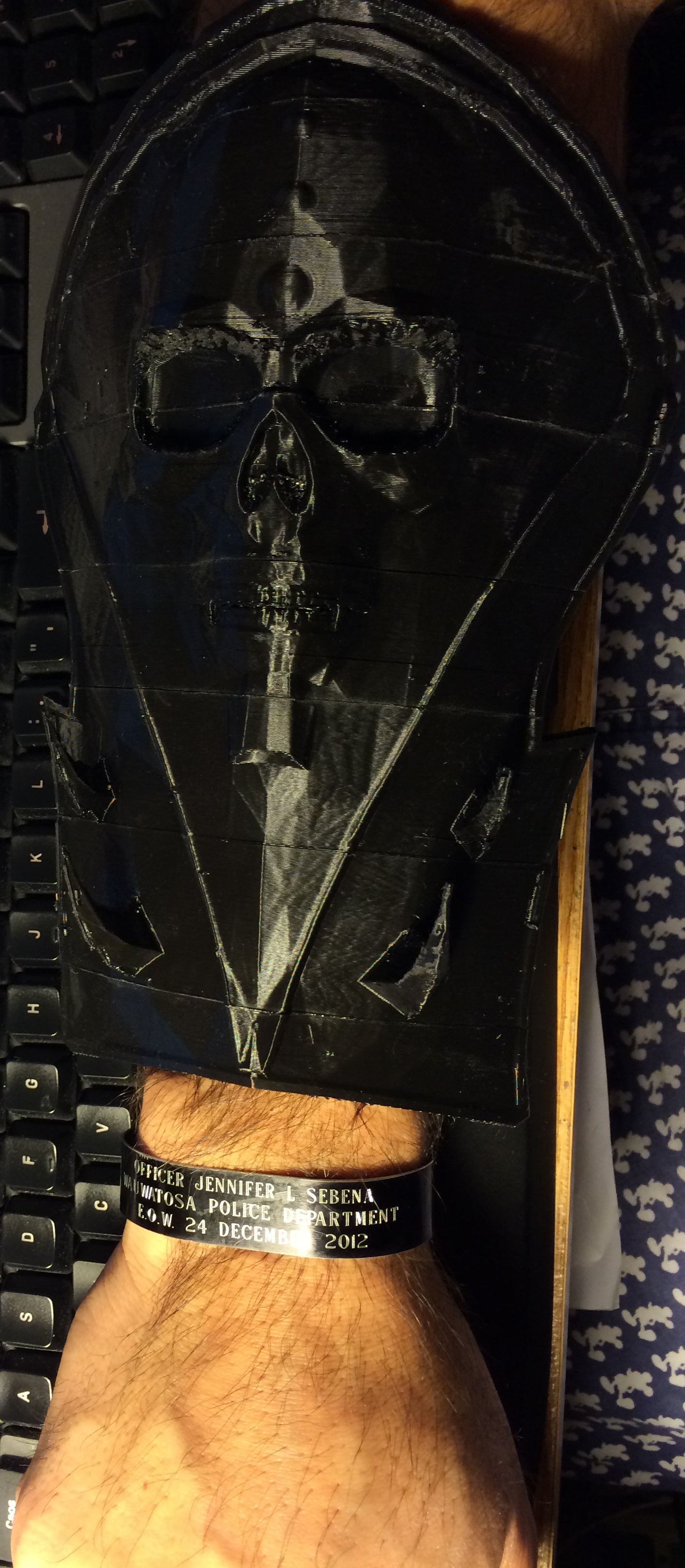

The first gauntlet has been finished! I have glued together all the pieces and this is the end result. I think it turned out pretty well for having been a converted pep file to 3D print. These pieces came out good enough that I may just clean them up and use them as the final parts. I won't know until I've sanded and smoothed the piece, then painted it. Anyway, here's the raw print on my arm so you can see the scale.
If you're familiar with this build, feel free to let me know if you think the sizing is right.
It's so hard to size since the characters are so disproportionate.

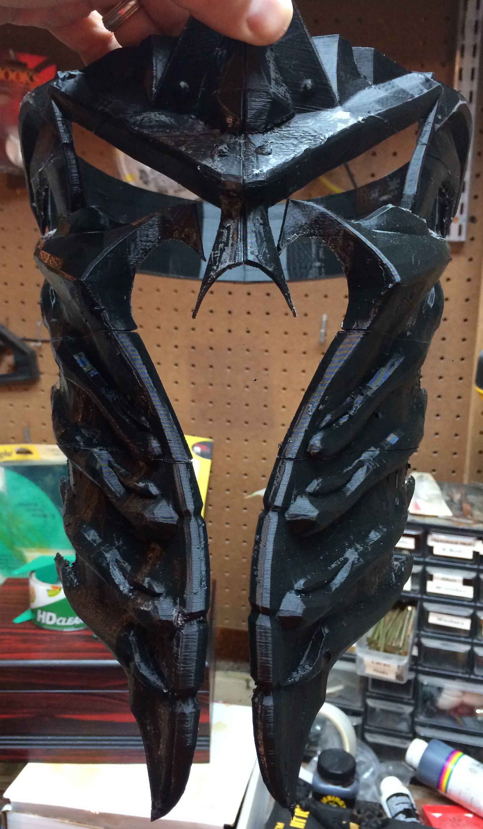

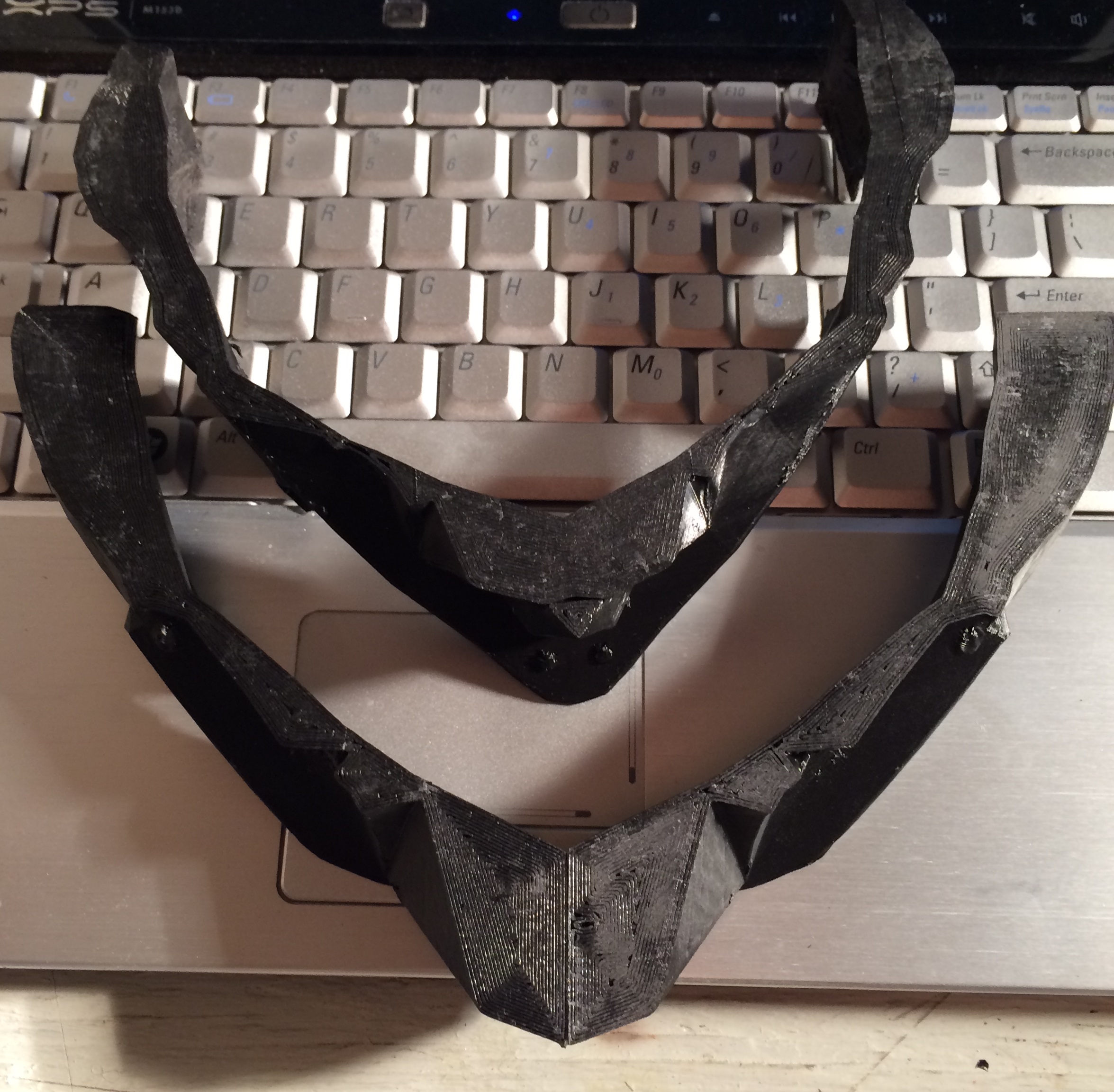

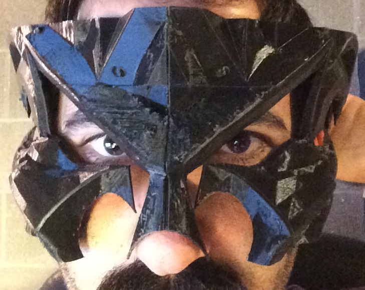

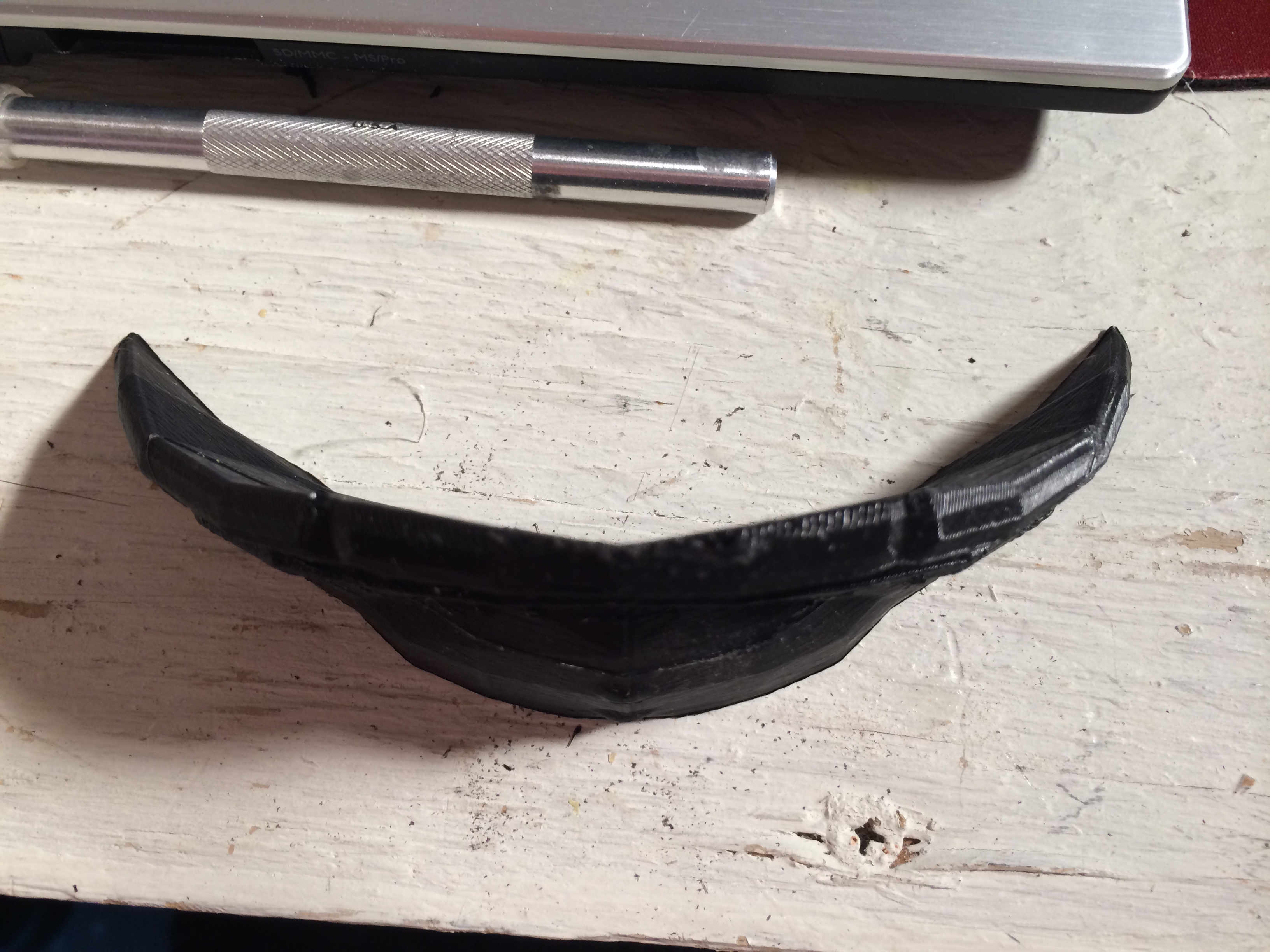

Well, after printing the lower part of the helmet, it looks like I didn't make it quite big enough. Yes, I can fit my face into it, but it's very tight and won't leave any room for my wig. Looks like I'll have to scale it up a bit.

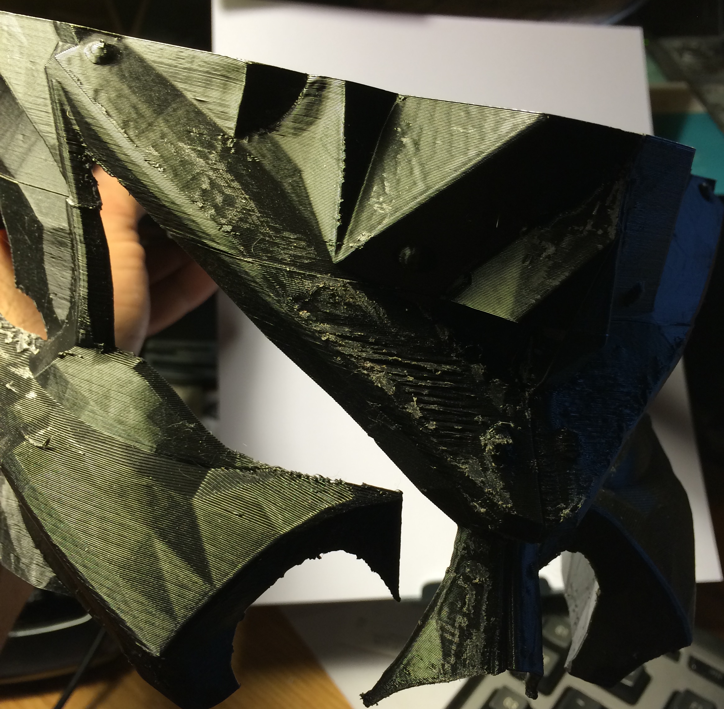

I've just about finished slicing and sizing all of the 3D print files. My printer has been running almost non-stop for the last few days, and it's dialed in perfectly. There are a few rough spots on some of the prints, but nothing that some sanding and bondo won't fix. I still haven't decided if I'm just going to wear the 3D printed helmet or cast it. I'll have to see how good it turns out when it's finally printed.

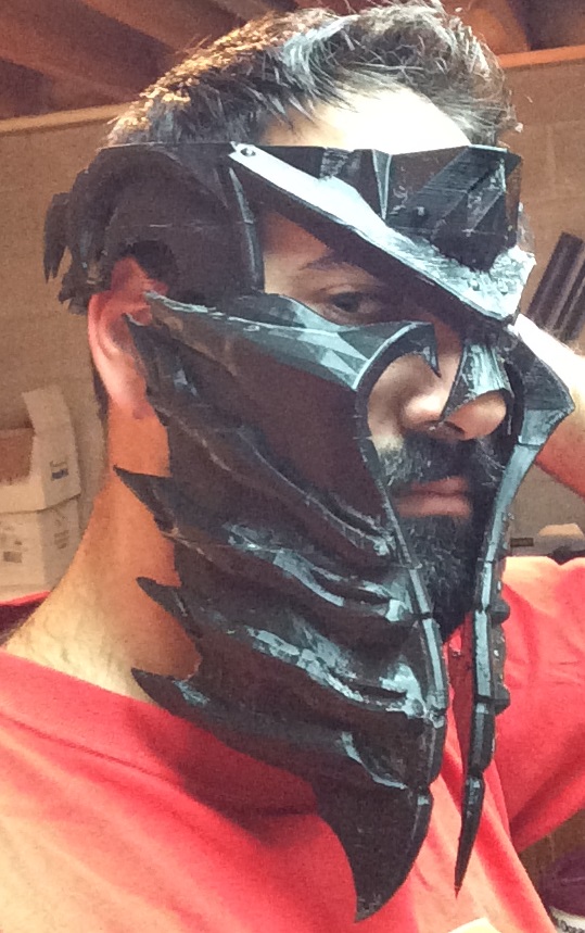

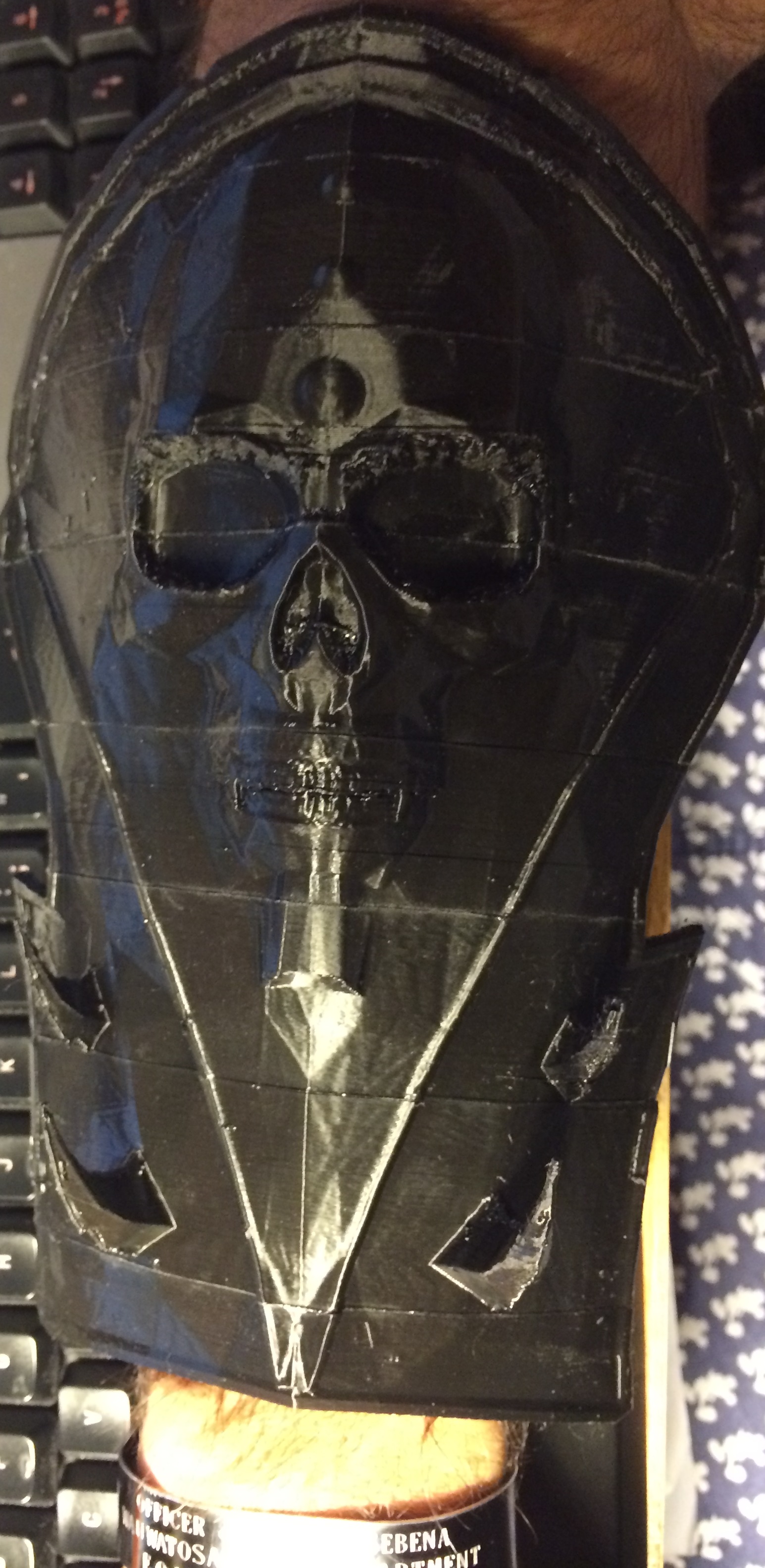

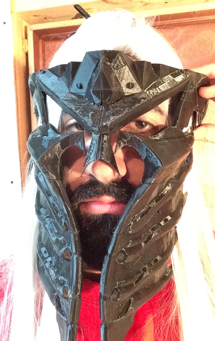

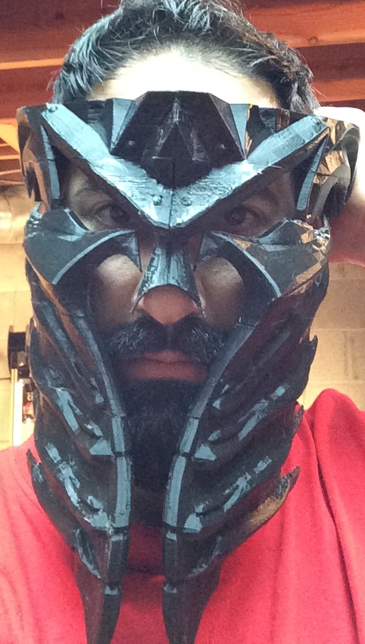

Speaking of the helmet, I think I've got the sizing just right. It easily goes over my head, and leaves space for the Lich King wig. I'd rather have it too big than too small. Anyway, here's a few progress pics.

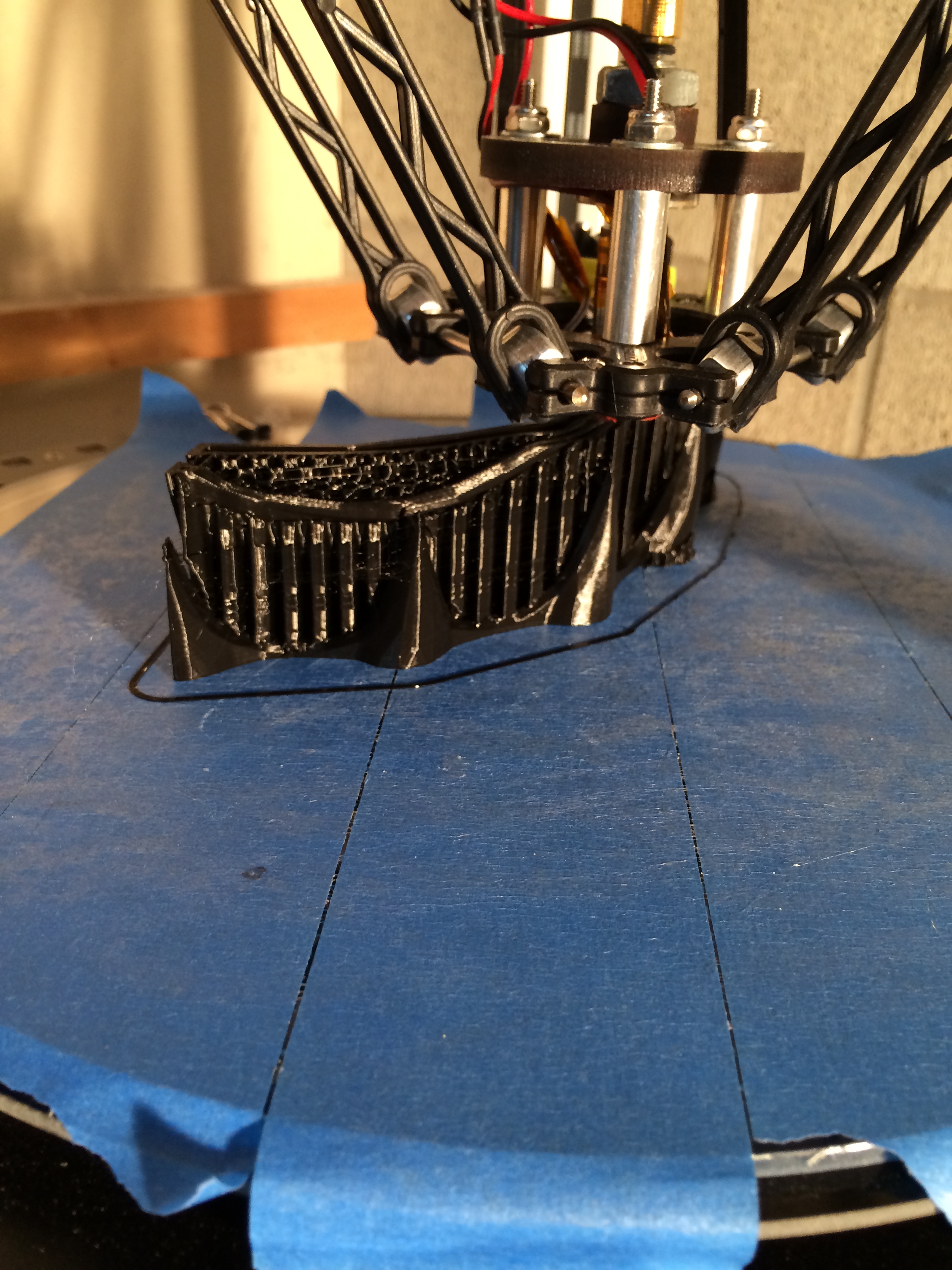

This is the 3D printer in action. Printing part of the back of the helmet. It's printed upside down because pointy parts are best printed with the pointy side up. I use blue tape when printing with PLA, and I coat the tape with a glue stick. No edge curl or lifting!
Sizing change from the one that's too small (left) to the correct size (right).
Another shot of the size difference.
Right side of the helmet.
Here it is on my head. I think it's turning out pretty nice!

The helmet is coming along nicely! Just finished another 5 hour print for part of the top of the helmet, but don't have a pic of it attached yet. Here's a couple of pictures of the helmet progress and of it on my head. I have to hold it on by hand, since there isn't a top yet. I also took a few pics with my Lich King wig. I think it looks like Legolas is wearing the helmet! :lol
Oh, and earlier I was asked about the amount of plastic it would take to print this. In that 5 hour print for example, that used approximately 110 feet of plastic. On a spool of PLA plastic, there is approximately 1000 feet of filament. Now, it does help that I am printing these pieces with 2mm thick walls, since that is plenty strong and it helps reduce the weight significantly. All of the pieces are basically hollow in the middle, except for structural support when needed.

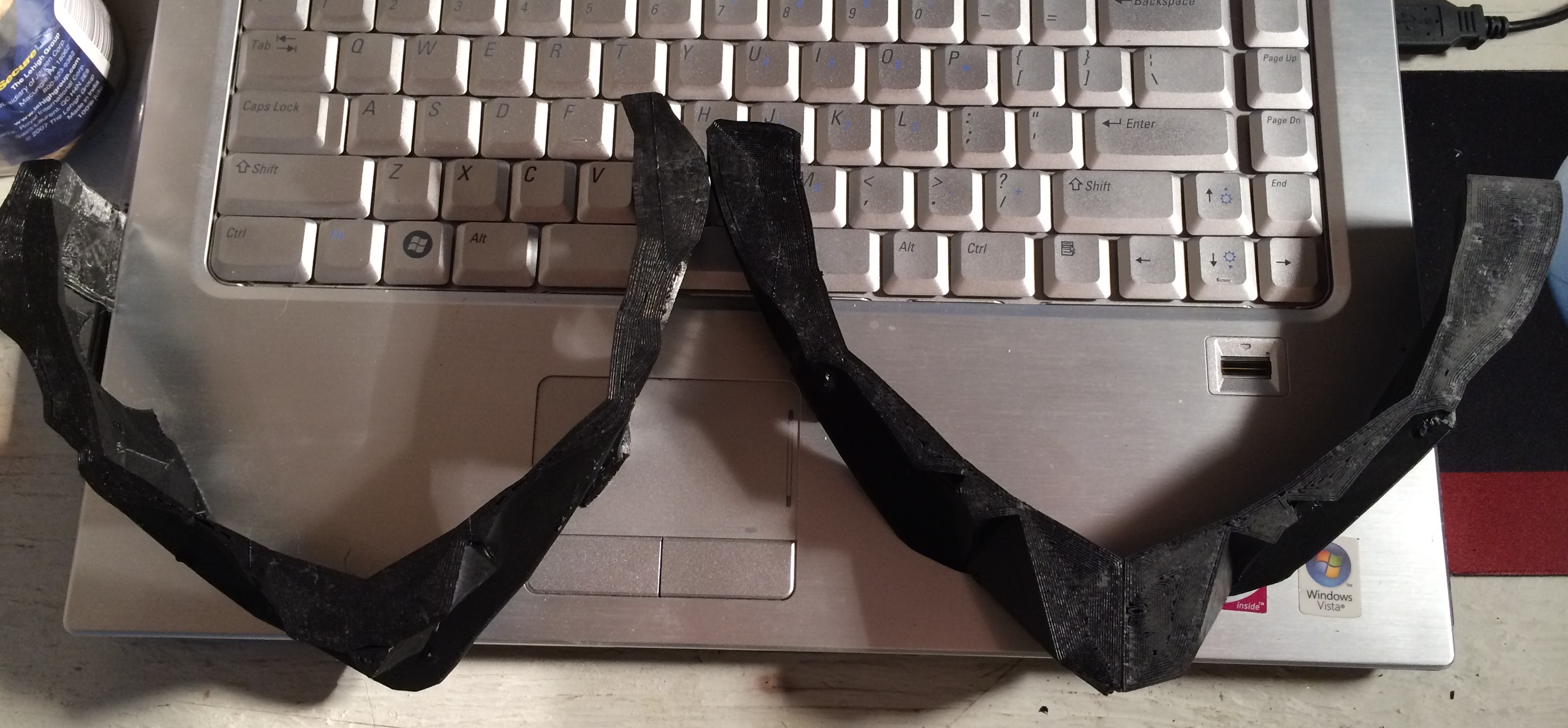

Thanks for the comments everyone. Should have more pics in the next day, including the chain mail I'm making for it (I need another hobby!).
