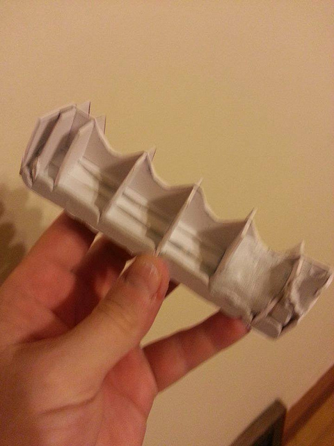

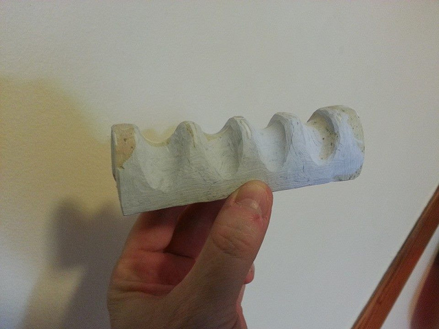

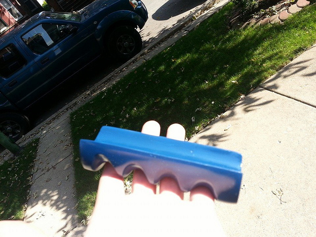

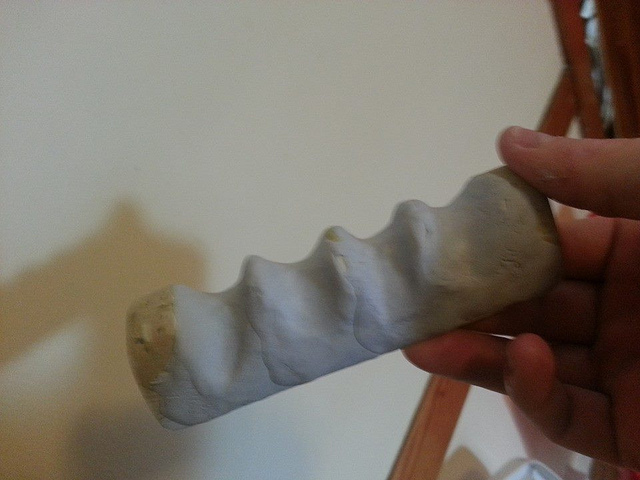

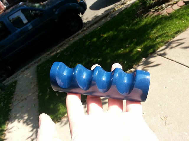

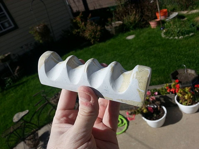

I made a skeleton for my gun grips and filled it with epoxy putty -

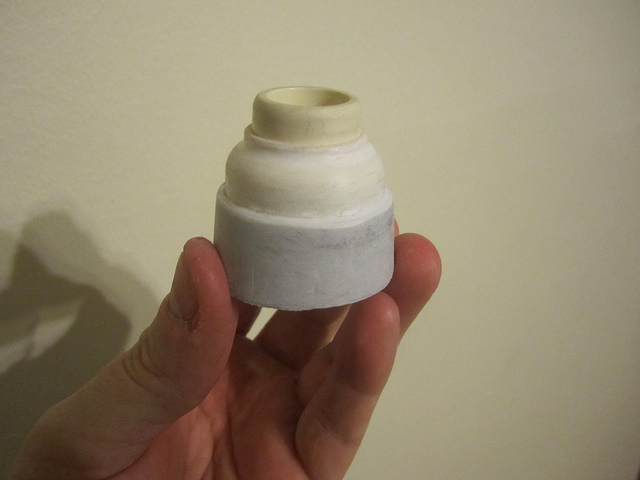

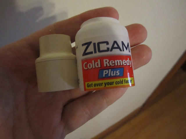

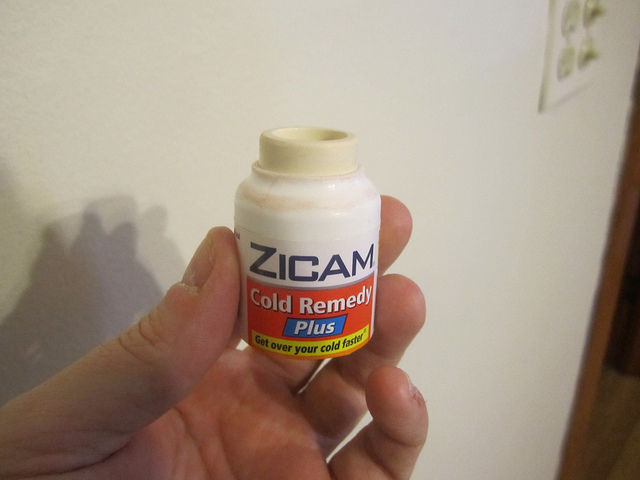

My leg hose clamp - (Found parts!) -

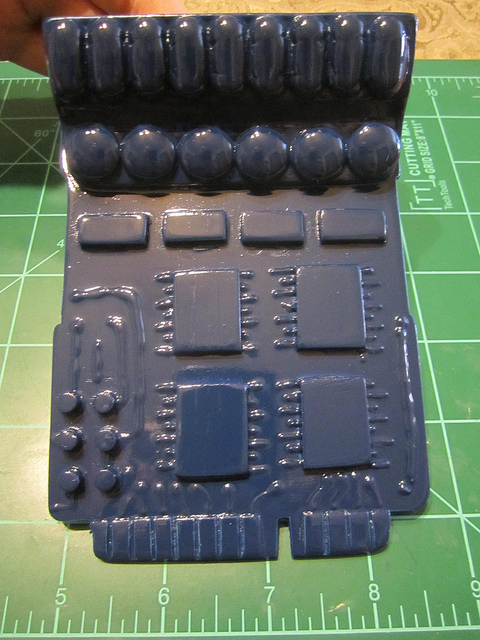

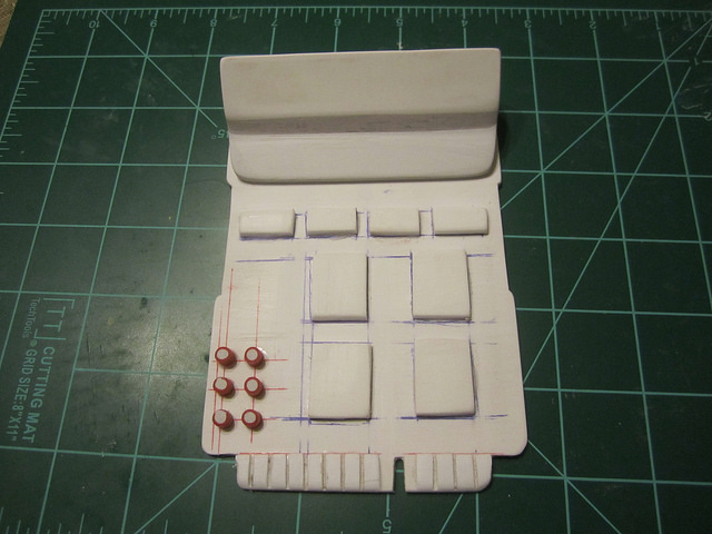

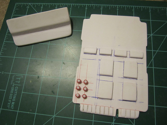

Belt Gizmo -

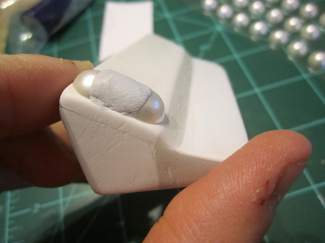

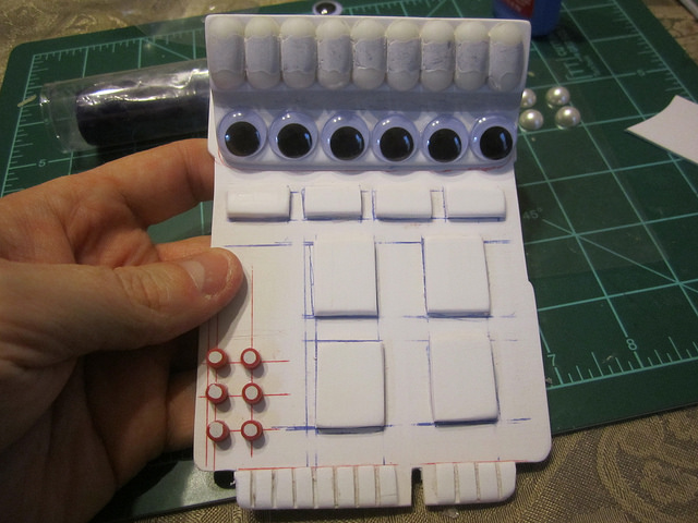

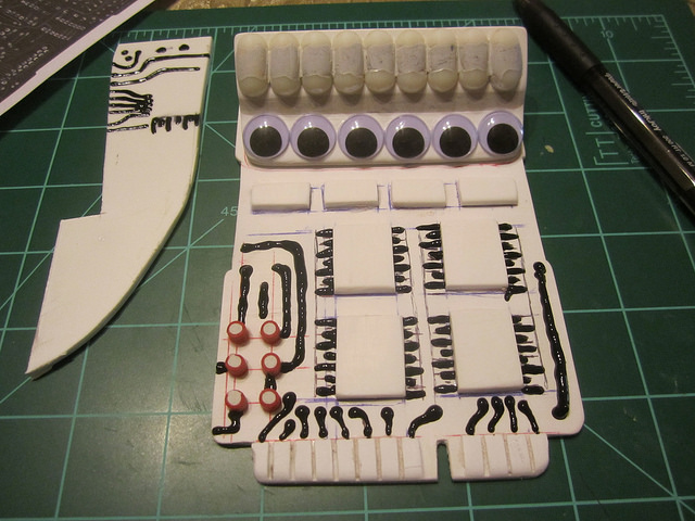

Stick on pearls and googly eyes. Both ideas I found on this site.
Dimensional fabric paint for circuits. It's... LOOKING at me Ray.

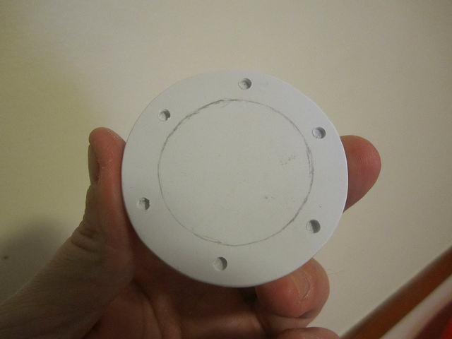

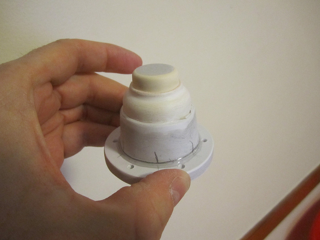

My first mold was my leg clamp. I picked what I figured would be to easiest to cast and pull. I built a box from some art board held together with regular hot glue.
To figure out my volume so that I would not waste silicone I got a few bags of Lentils from the store. and poured that into my mold box with the buck already in it.
Then I poured that into a red party cup and then halved that. Which gave me a good approximate or how much OOMOO silicone I would need for this pour.
This stuff is CRAZY easy to work with!
I got a few bubbles in my guild holes but those get drilled out anyway. There it is! My first mold!
Used my Lentils again to figure out my inner volume.
This stuff is amazing! no bubbles on my cast at all really.
