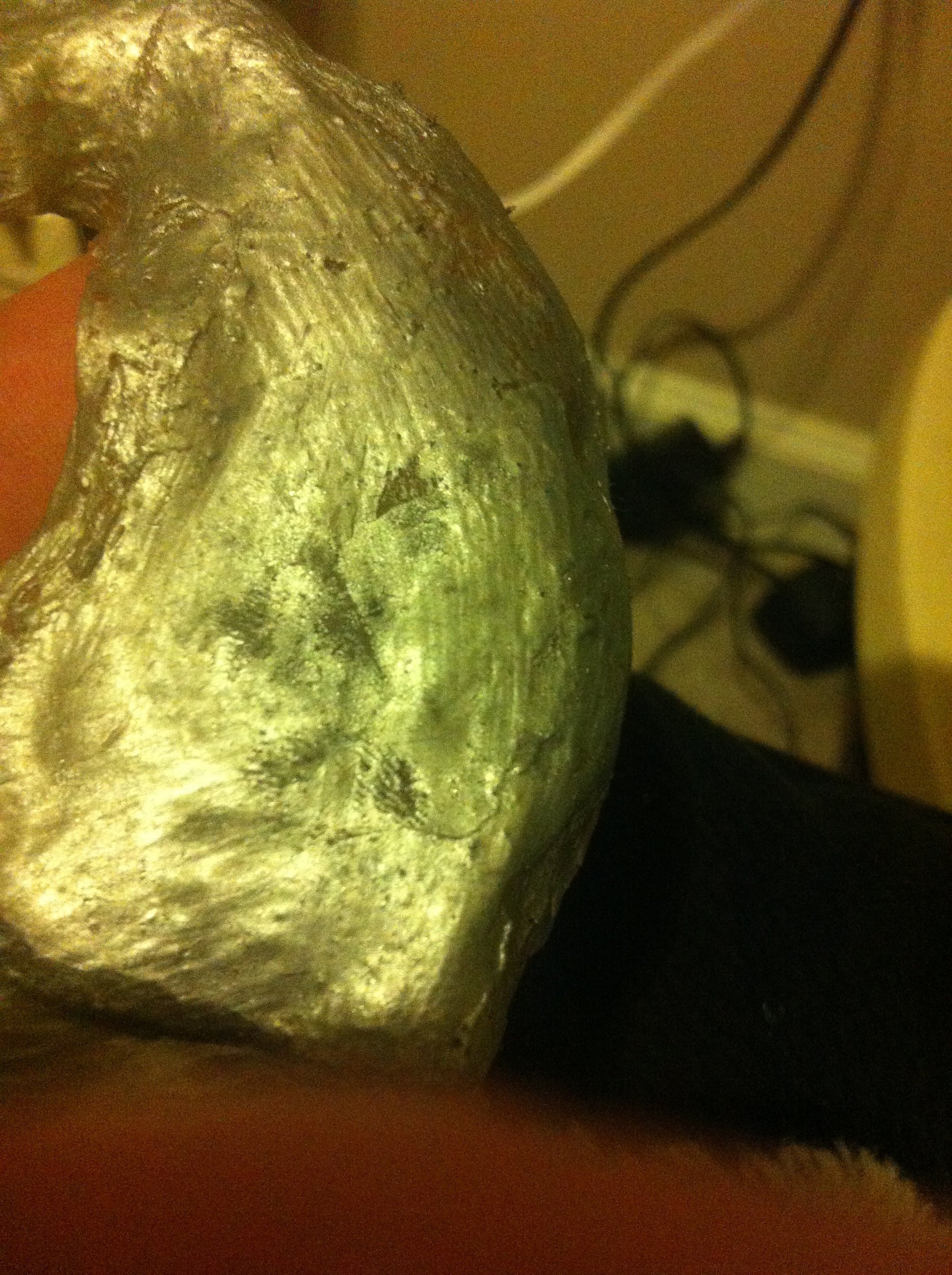

Listen to usurper man. A couple of years ago i tried this method for a small face appliance, it was terrible. It ended up all bumpy and the original sculpt was ruined. i would not recommend this at all. it held no detail whatsoever an ended up being a waste of my time and money. Just to show you what I mean, here's a picture of the texture I got and ended up with all over it.
