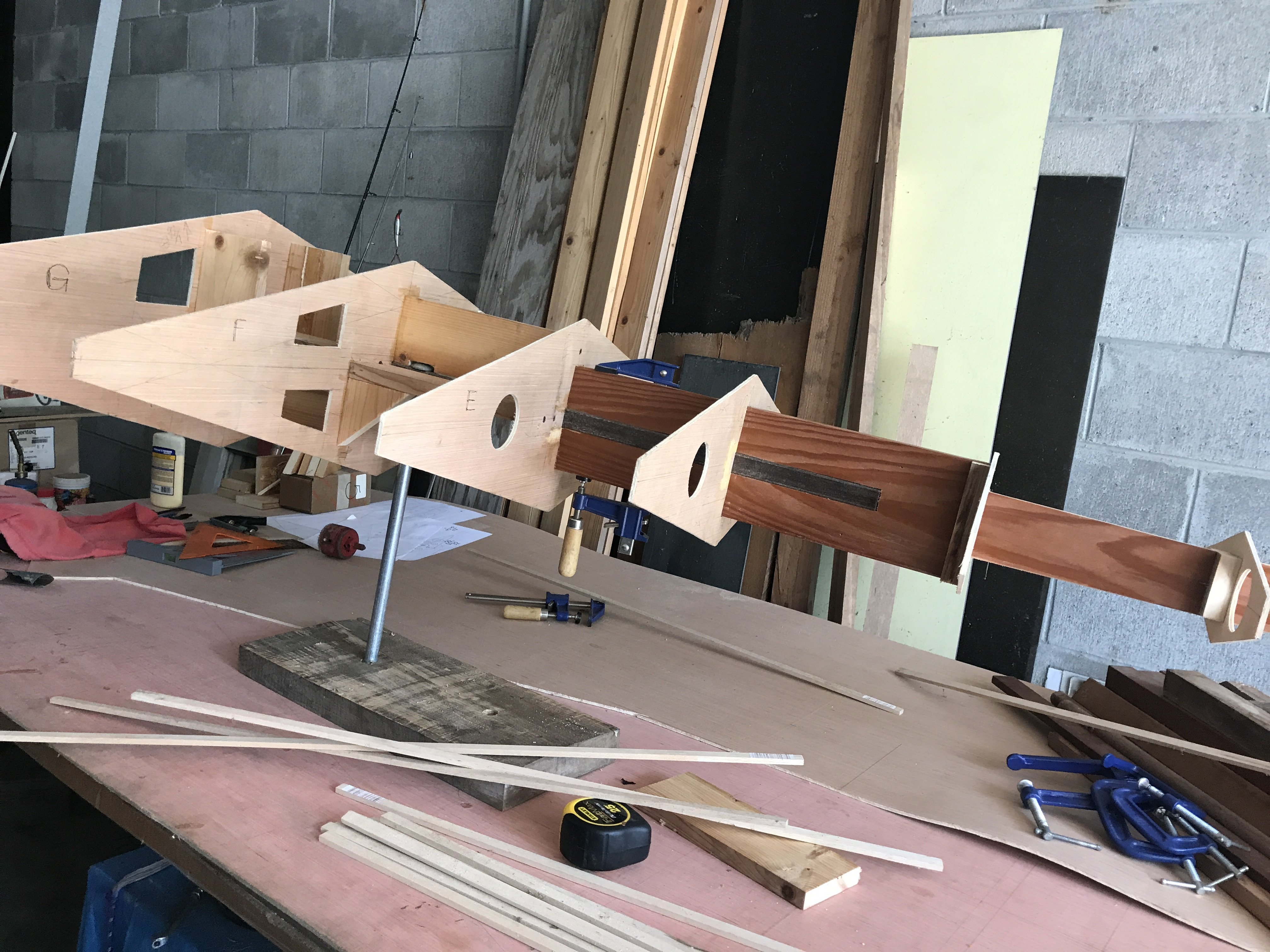

Hey all,
Ive just started work on whats going to be a little bit smaller than studio scale Avenger SD and i was wondering about sheet goods for the main hull shape. where do you get it, what would you use? Since I cant afford or am in the mood to collect all the models required to bash this thing to studio accuracy, Im going to make as many of the parts as I can ( or close replicas). Some of the places on line that have sheet acrylic have prices that are crazy high. 48x96x1/8" for 400 bucks? uh, no. Im an architect and we used to build models out of strathmore board and paper.

thanks tazman and angrytrooper. I'm in the florida panhandle. i was thinking id need only some 1/8" sheet stock for the hull. theres a good bit more bracing that need to be added between the frames, and screws were already in the plan. and I'm trying not to block out the parts where id need lighting to pass thru. I think I'm going to use a string of exposed leds on the inside and illuminate the inside of the hull and out thru the drilled openings. i don't like the billion hotspots that fiber optics tend to give you.
I've also been flip flopping on the method to detail the panel lines. in the production books and a lot of the pict available, most of the lines seem drawn on in pencil, while some other builders have chosen to score the plastic with a razor knife for the affect. I'm thinking of going this route. but i will keep you guys posted on progress it'll be just under 7 ft stem to stern when done.

I did find full size sheets of 1/8" + thick sheets of acrylic and lexan at my local store and they were still $220 a sheet, and I need two to complete both sides of the hull. I had planned originally to try and get away with scoring it with a xacto to save some time and any difficulties involving gluing sheets to sheets. I had done this before for a architectural model once, scored joint lines for a cement block wall and spattered color and texture over it with a tooth brush - worked great.
Thanks for the tips star-art. i found some interior wood paneling that is 3/16" thick and stiff. Much like Masonite tempered on both sides. it remains very stiff between the 10 inch frame spacing. it also has a very low expansion rating, so Im pretty confident after sealing the whole superstructure with some West 105 it will remain stable enough. I have a feeling that the 105 will slag any plastic I try to use it on, so finding a suitable adhesive to apply the styrene to the paneling without worrying about build-up underneath will still be the challenge.
I have one frame that is out of alignment with the others, so gotta fix that bit first, then get the plywood for the sheer strake cut and glued, then its big wedgie time.
