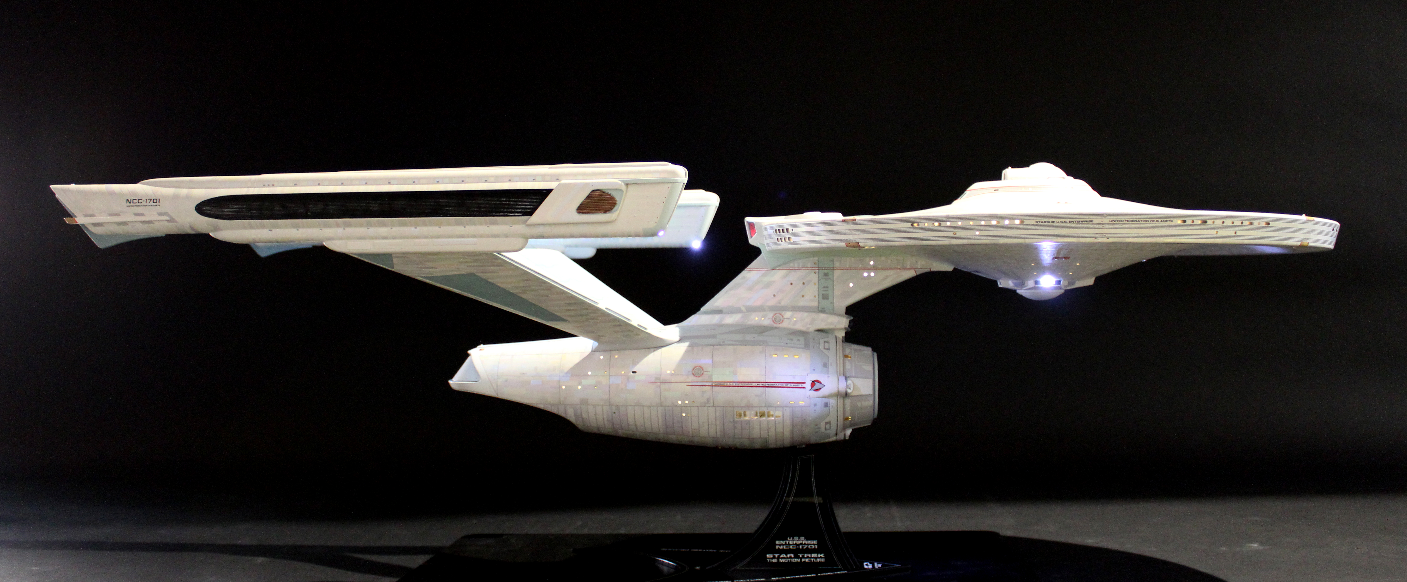

Here is a final image of the ship. One thing of note which really made my day was Paul Olsen letting me know how he loved this. If you dont know who Paul Olsen is, he's the guy who painted the pearls onto the original 1701 filming miniature. It has been great to touch base with him, and to get such an endorsement on this. I feel i can relax about this one now.
