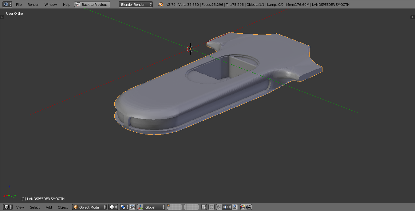

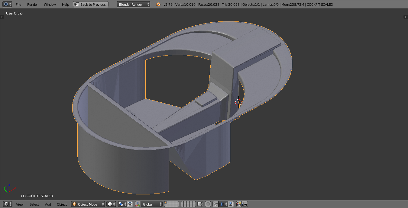

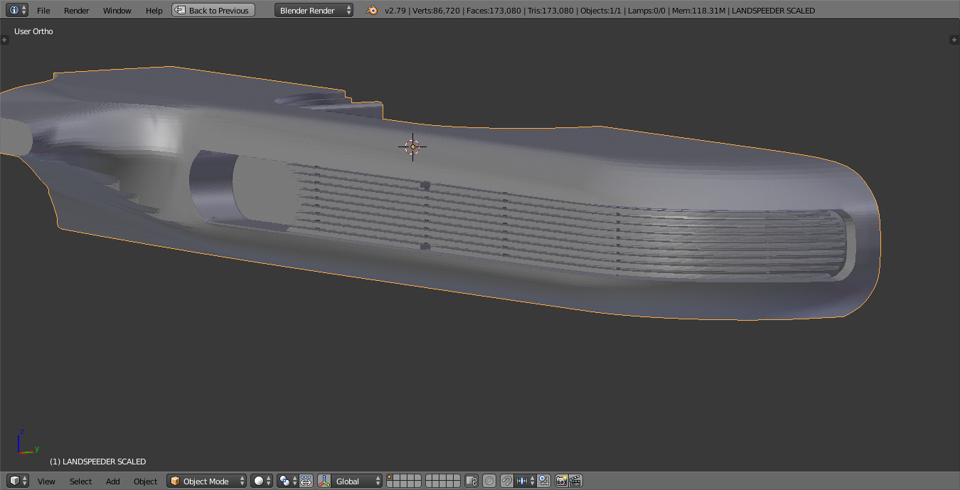

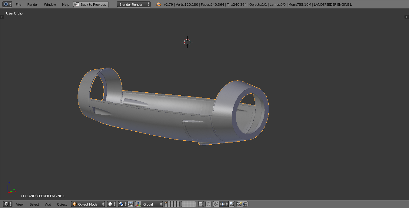

I modelled the whole thing as accurately as possible from all available source material but there seems to be no definitive measurements for most of the car dimensions. So no 2 cars are gonna be the same. Here's mine
The basic shell
The grille
the cockpit

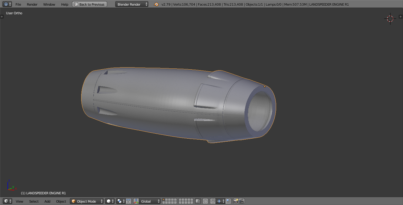

and the engines
Obviously there a few other bits to model and print but this should keep me busy for a wee while

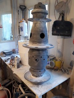

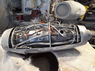

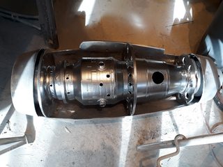

Derwent flame tube for the 'open' engine

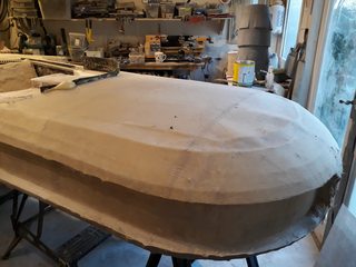

I'm using my own Geekbot printer and a couple of CR-10 S5's. No doubt, it's a shed load of printing but once I have the basic form then everything else is fibreglass and bondo. The method is to print the pieces with a 10% infill and then fill the cavity with expanding foam, then Gelcoat/resin/chop strand/resin/topcoat bondo the whole lot once assembled. Marine ply top and bottom with wooden struts and joists for the wings/engines/seat. It'll be heavy, but it is a car.

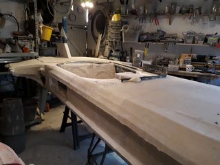

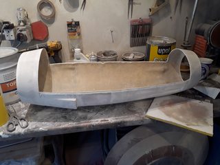

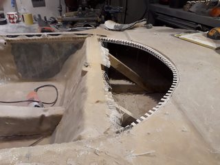

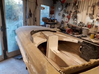

Now that the shell is complete it's time for phase 2...adding the secondary components/details etc

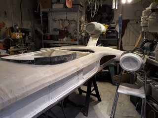

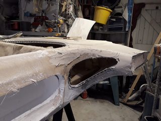

cutting out the wing nacelles ( it's not the right word but I like it)
inserting the insteps
wooden bracing for seat/wings

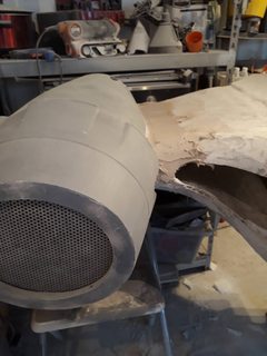

fitting 'open' engine

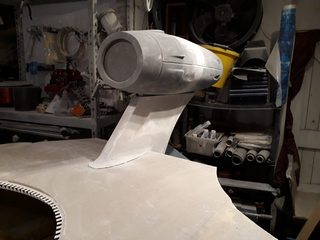

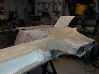

fitting tail engine and fin

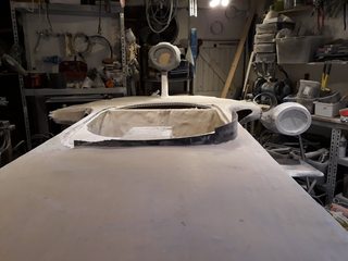

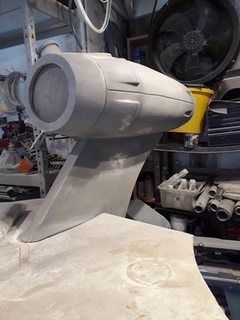

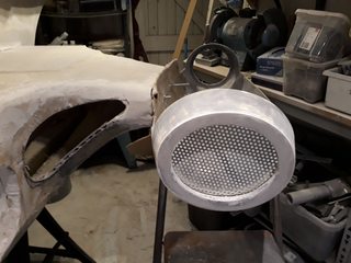

Got the right hand engine fitted
The tail fin fixed and finished

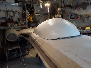

Made the former for vacuum forming the windshield...still more to do
Installed the flame tube turbine in the open engine bay...will probably give it some sand weathering as well when the whole car is done
