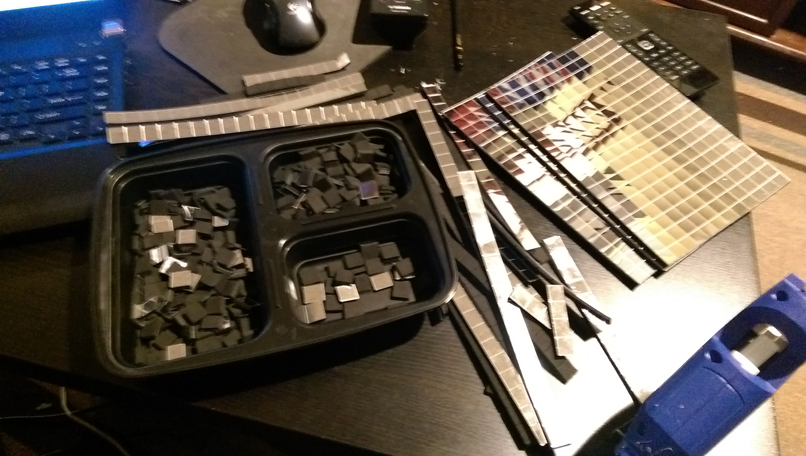

Hand made tiles, I used plastic mirror sheets glued to foam core boards and then cut into 1/4 inch pieces. this gave the same thickness of glass tiles. otherwise the plastic sheets are too thin and I assumed it wouldnt look as much like a mirror ball as it could. good call in hindsight.
first tiled the middle diameter but realized that when I cut my tiles I broke them all off and threw in a big pile to take from, unfortunately my cuts werent perfect so the tiles were all different sizes, this made for a sloppy first run.
I corrected this by not separating the next tiles right away and working off rows instead since they all matched. When they were cut with an exacto knife they remained intact and had to be "broken" off the sheets.
