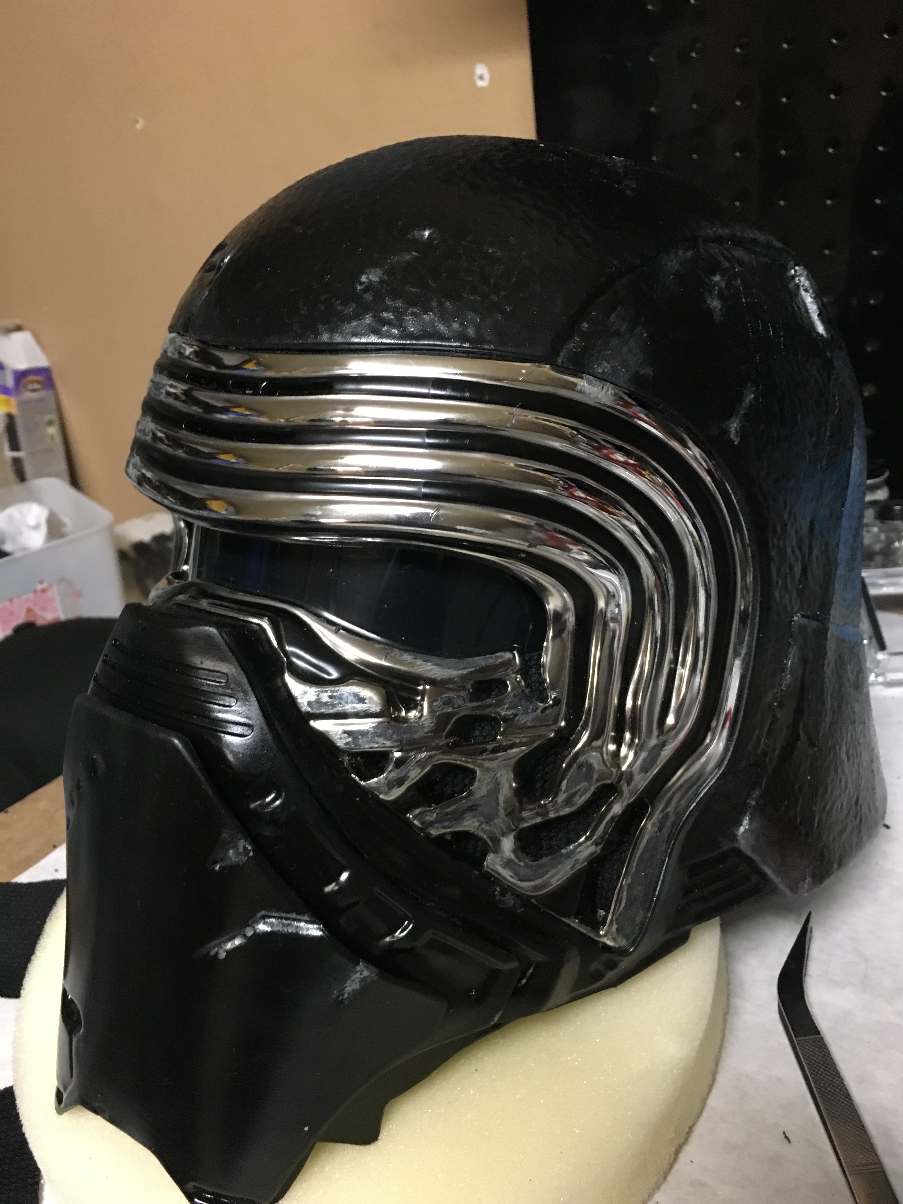

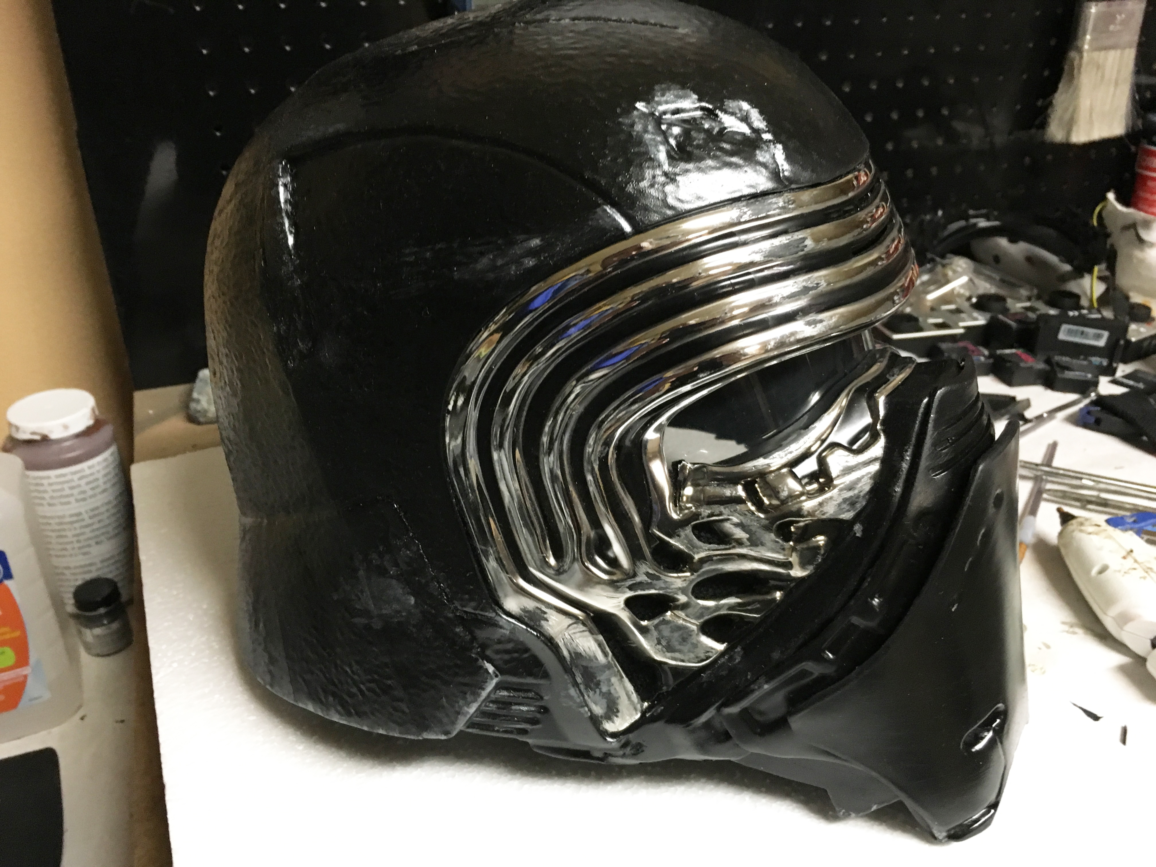

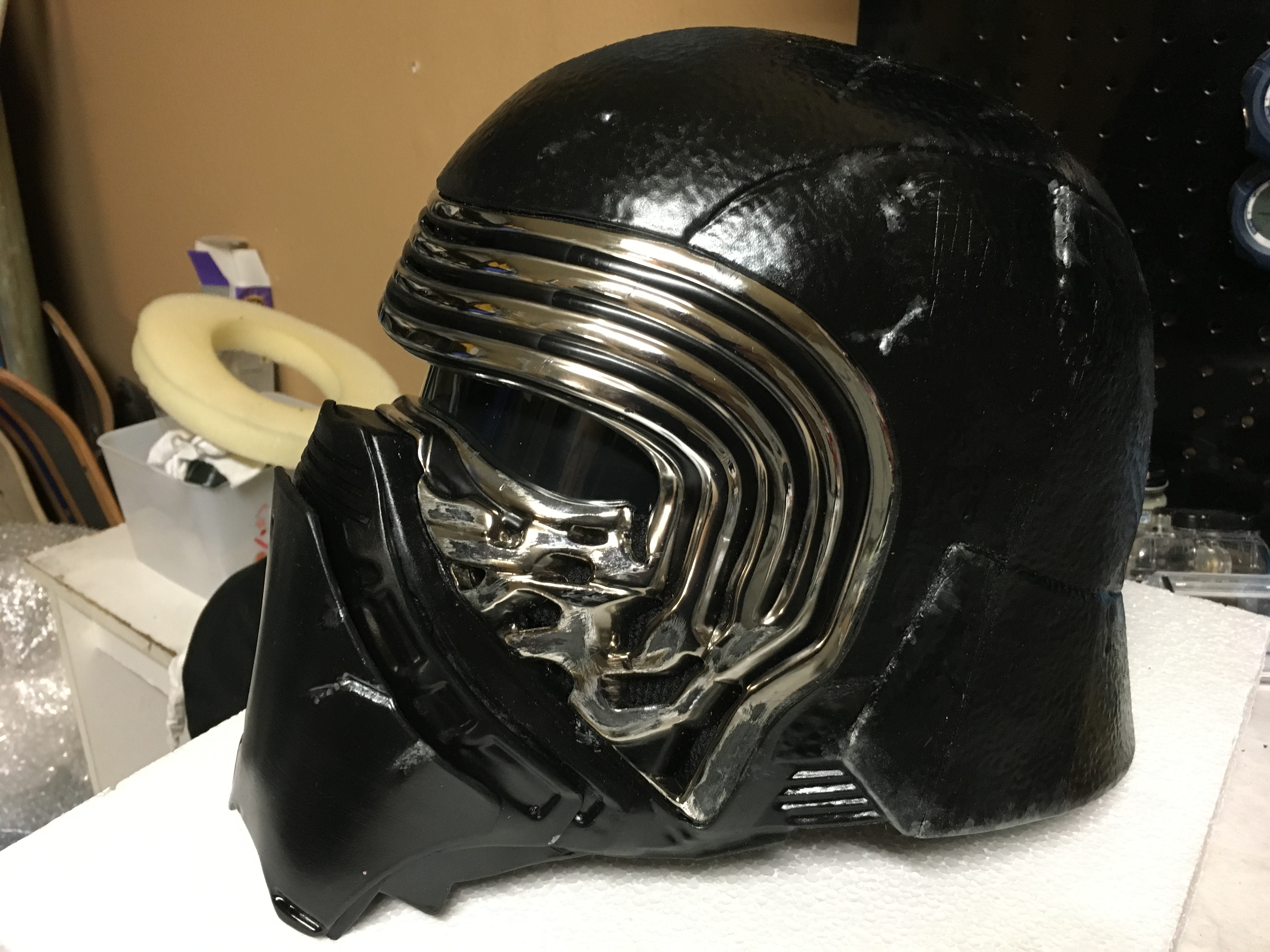

Here are the finally pictures of my bucket with the weathering. Really happy with how it came out. If I ever do it again, I will definitely use fiberglass to reinforce it.
View attachment 571540View attachment 571541View attachment 571542
Looks good but that plate sticks off the face too much in my opinion.

Also have you considered wetsanding with 1000 grit or just scrubbing with 000 steel wool to matte it up a bit?

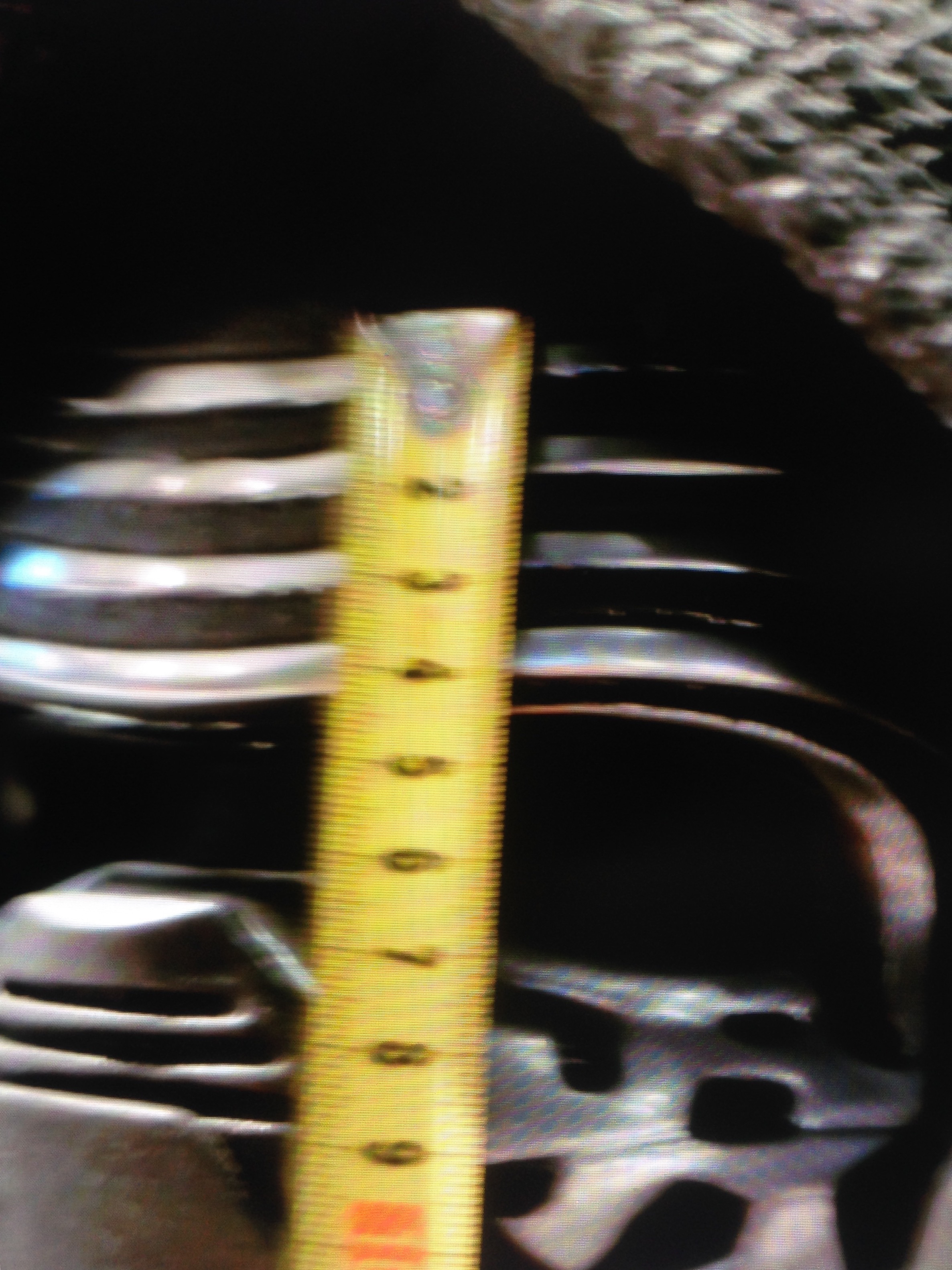

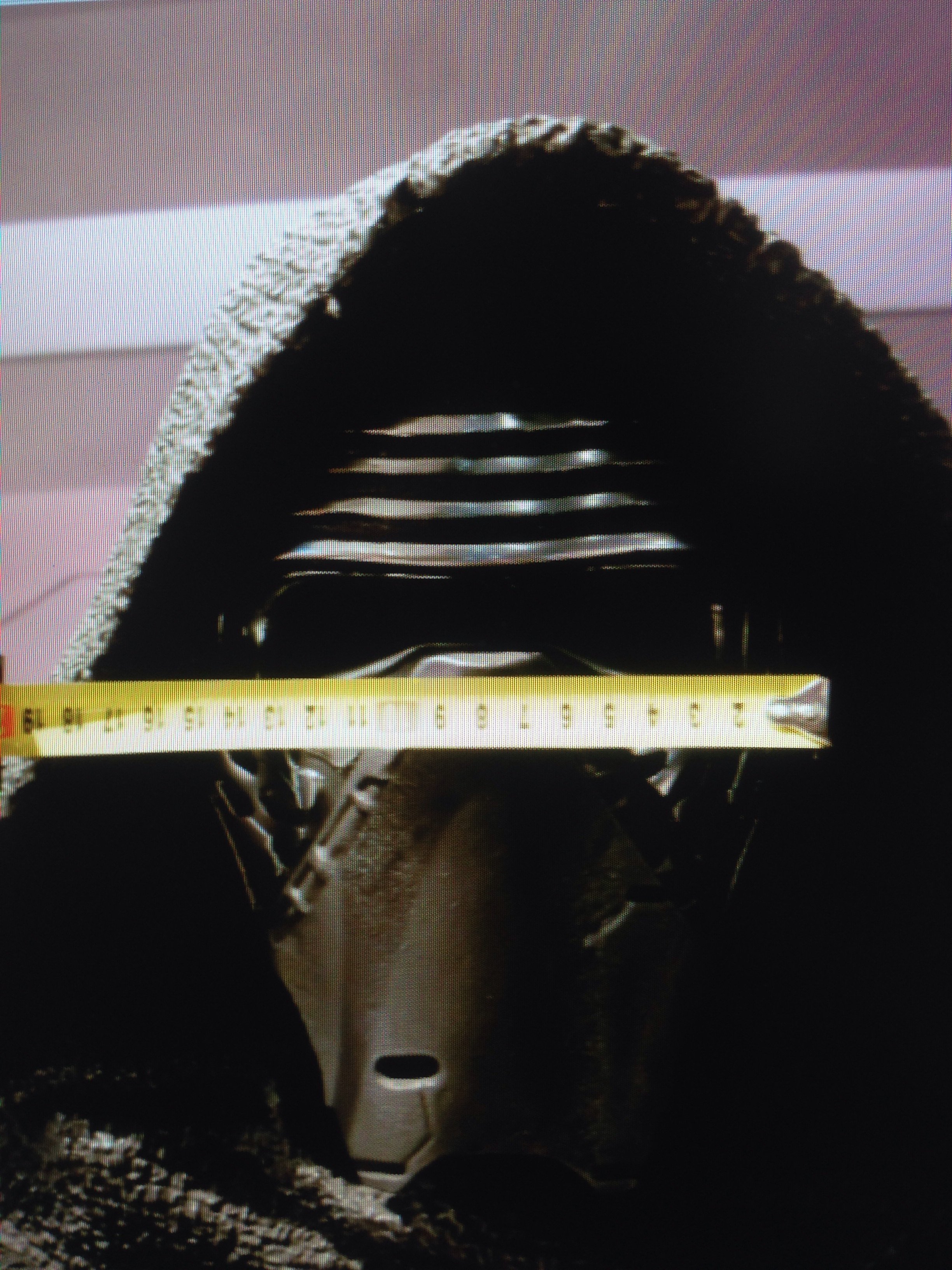

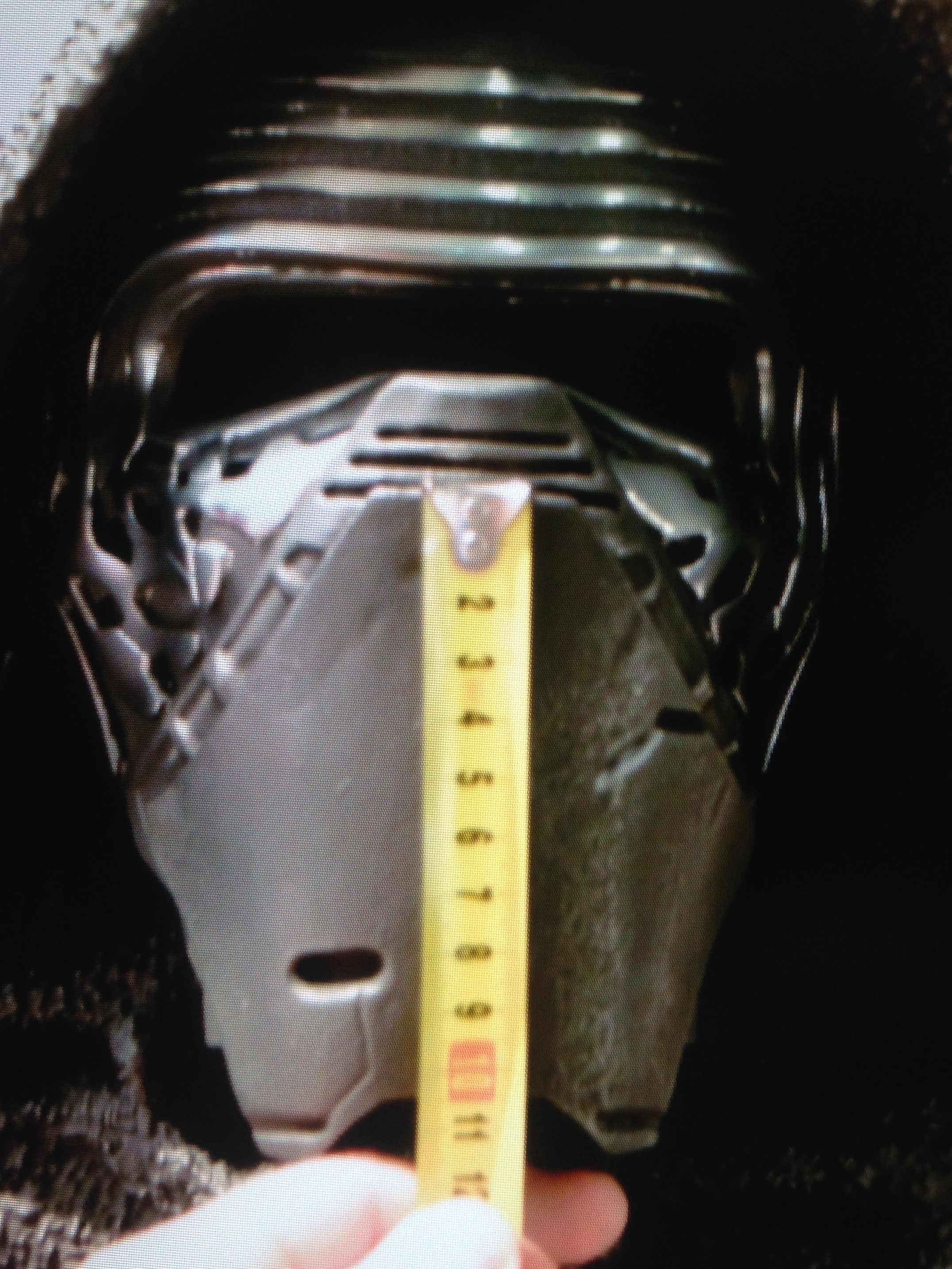

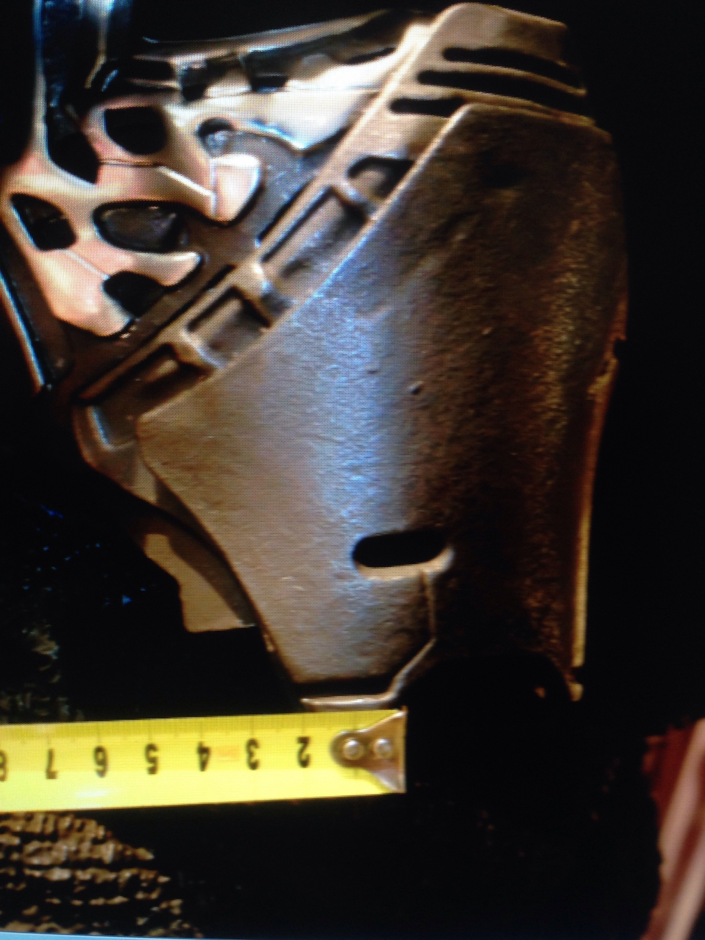

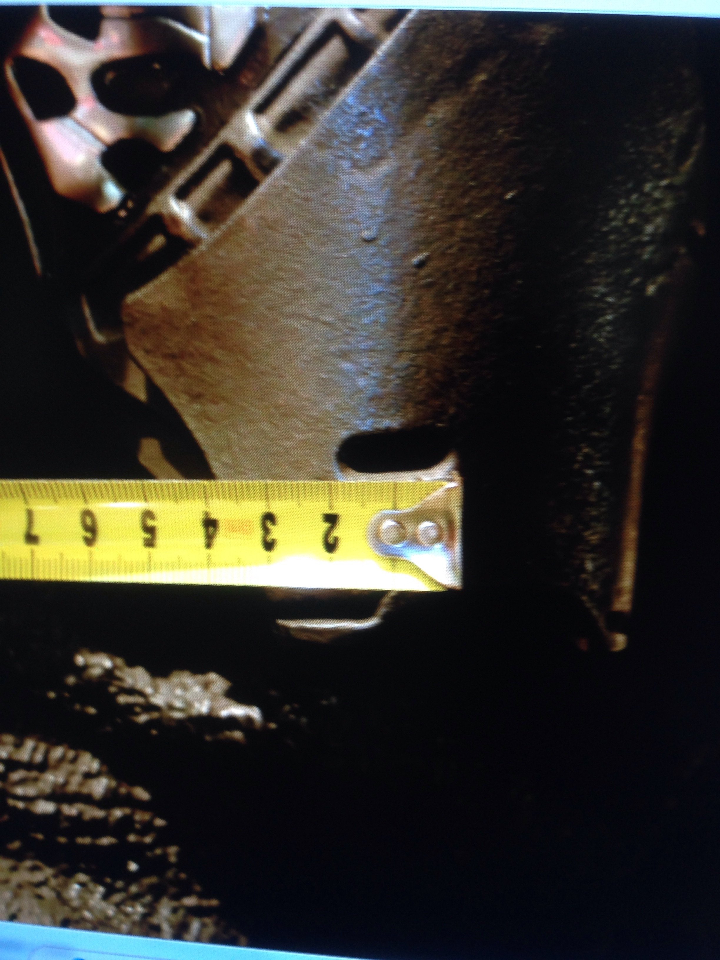

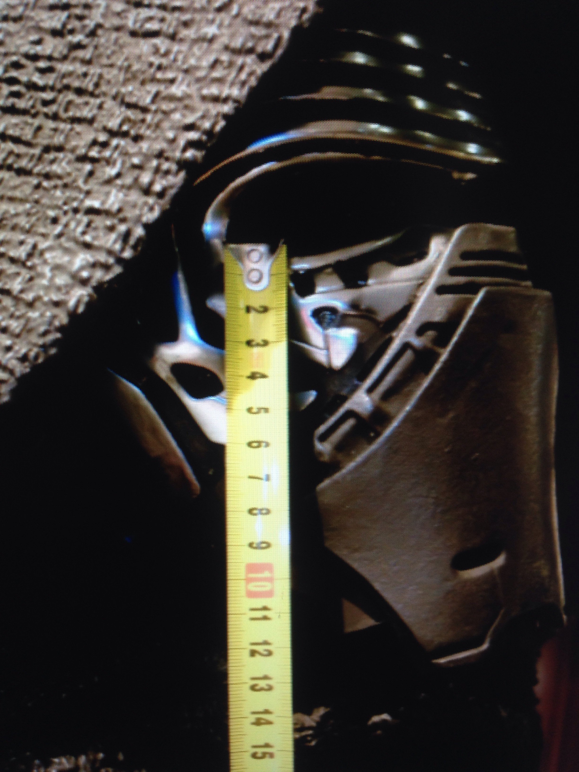

For any one who wants to know there efforts of nosing there black series isn't going to be waisted when then Anovos comes out and we find out how undersized the Hasbro is, turns out that it's the same as the real helmets,
i took 100s of shots at a S.W 7 promo display and as you can see the tape is right on the pieces so the results are there, also the tape is in Metric of cause

I measured against my Black Series and it is exactly the same, just as I had been saying all along. Glad to have some hard measurements to finally back it up!

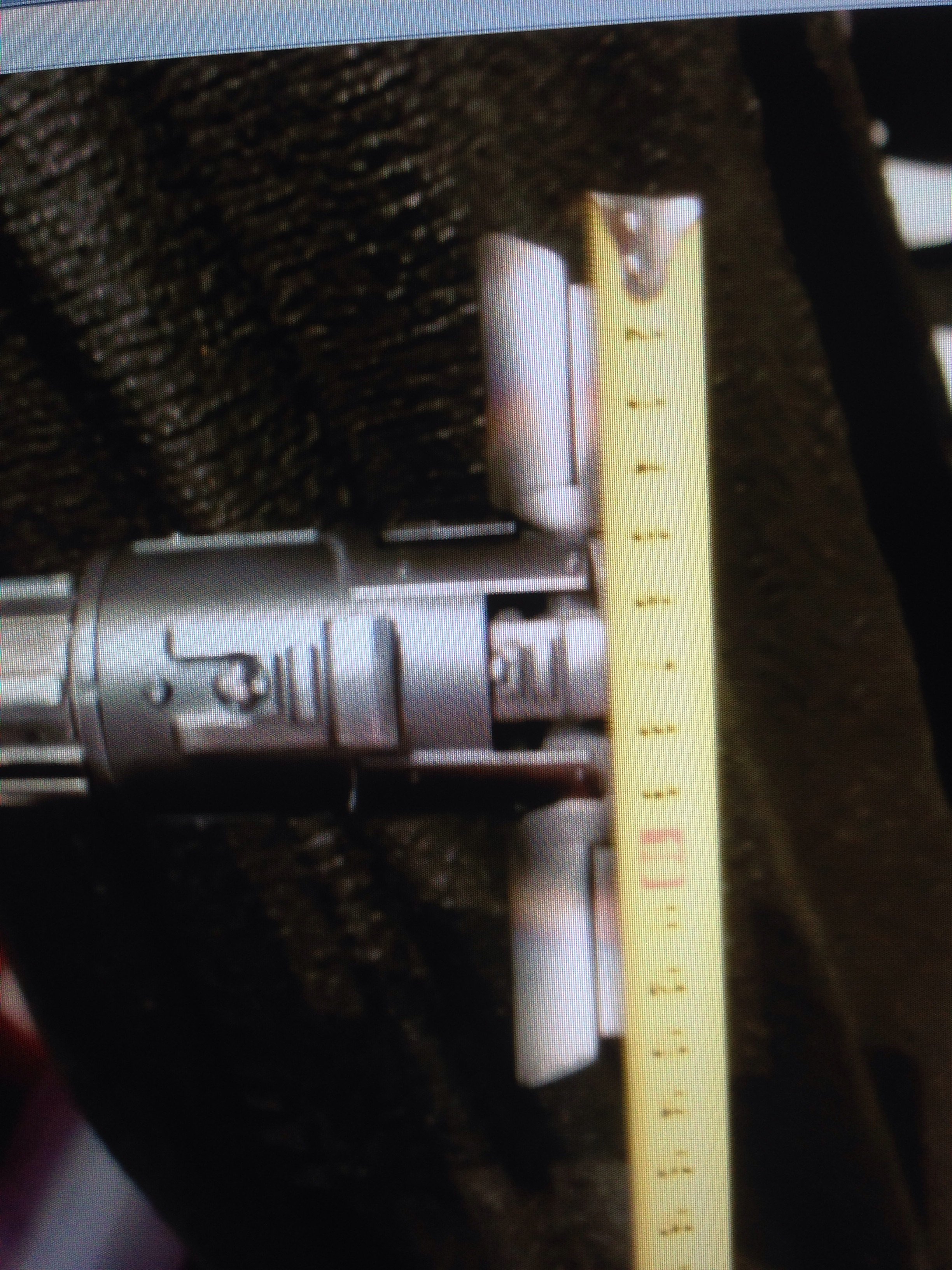

I'm currently with out Internet so only using my phone but I can take iphone shots of my display screen I'll add a few more now but Ill load the rest later, as well as Kylo I got Phasma and blaster,( and behind her cape) Rey and a couple of bb8 and the stormtrooper,
I hope this helps some, I've been sculpting a Kylo helmet and its be a big help for me,
Enjoy,
Once I get my internet sorted I'll post high def versions of these and many more,

Holy force ghost!!! If these measurements are right, the black series is as close to 1:1 scal you can get! I just measured mine and it's spot on.
The measurements are right! So yep turns out hasbro must have had a very nice starting point, I joined so I could share these, I'd originally planned just using them to make my sculpt as accurate as possible but figured is share the info

Absolutely. I've said over and over the Black Series originates from scans just as the Anovos helmet does, and people were acting like I was crazy.
My BS lid is just a touch too wide as I had thought, but that's a very easy fix.
Enjoy,
Please, share more of hilt's photos if you get this.
It will be perfect if quality will be better, than on phone camera now.
